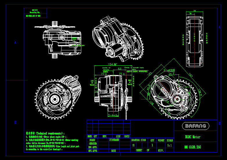

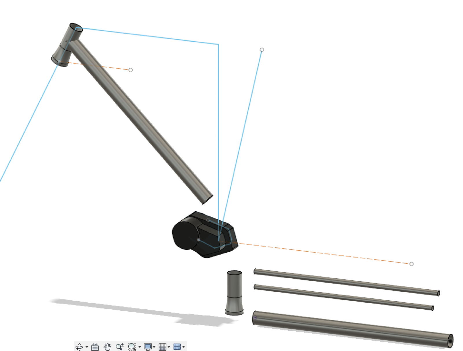

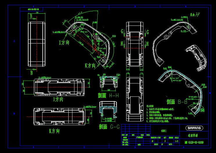

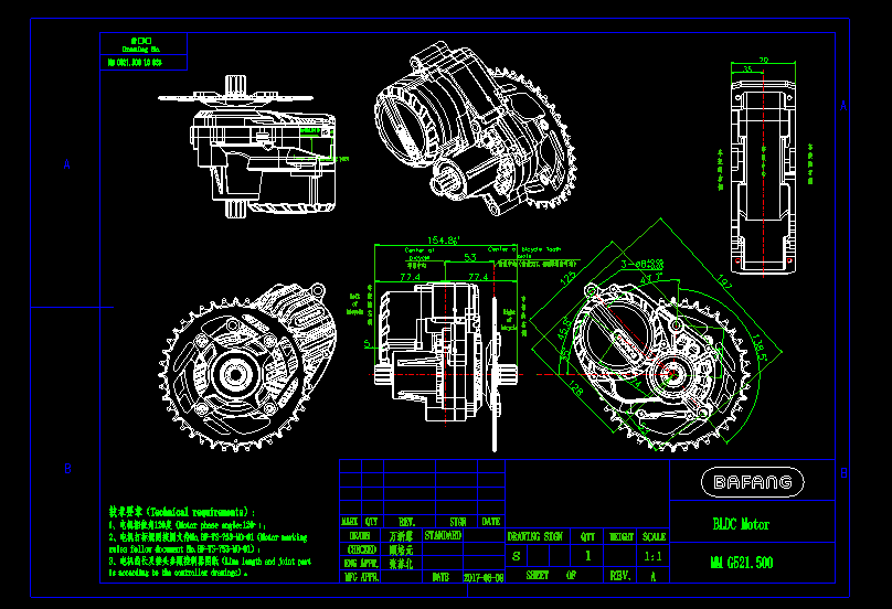

Hey, I'm planning on welding up my own frame to put either an m510 or m600 in. Does anyone know where I can get the specs/measurements for the mount for this motor? I can't find it anywhere on the various Bafang websites and when I try and contact their sales I never get a response. I made this rough black stand-in from pics online.
Frame info: Steel front triangle, aluminum rear triangle. 160mm travel full suspension, single pivot. The mount onto the steel main triangle will be generic/agnostic, and I'll machine an aluminum insert/cabinet to allow for the potential of different motor mounts. But I need to know what the mounts are for the Bafang system first!

Hi Abordo, there is a communication or language barrier with the suppliers you are talking to. The M500, M600, and the new M510 all use the same mount and will all fit in the same frames.
