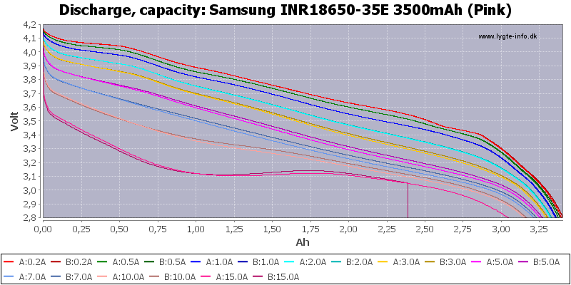

But good news, when it limits power on lower SOC %. Best would be, if user can set also cut off voltage, like on UART motors.
Helo Theaber.
Will try that new firmware 3.2
It would still need like another 3 firmwares, as usually.
I did a long test ride to monitor cut of Voltage, and found it is 41V. This means 3.15 V per cell, a good value in my optional. If You go lower, You don’t get a remarkable additional capacity due to rapid Voltage drop at the lower end, and there is a risk of low voltage damage on one or the other cell if not well balanced. To drain the remaining 10% SoC was hard work at 200W support only, I did about 10 km and 300hm that took me one hour 😬
Thats right, last 10% hard to get devastated with M600.
You are right, under 3V there is not much capacity left. But on races I am going usually to 2.7V.
I dont care about battery cycles or if I damage it, I am changin batteries every year. ;))
Theres no problem with balancing when you going to very low cut offs.
3.15V is too soon for cut off.
Let me check what capacity you get when cut off is 3.15V for example for Samsung 35e and 5P.
It is around 2.8Ah (4A draw). Way behind "nominal" capacity (somebody is stating 3.5, somebody 3.45 or 3.35 and that number is measured with very low current draw - 0.1A, full full charge and down to 2.6V)
Cut out should be 2.8 v
and if you reach 10% than max output should be around 350 400w.
We have 5 cells in parallel and 400watt is around 11ah which is around 0.6c 0.7c.
The cells are rated at 1c discharge up until 2.5v for 500 cycles.
If we make around 70km with one charge you can reach 7000km for 100 cycles. So i do not care for the battery.It is really cheap to change the cells.And this is not shimano bike where the bms will die immediately if you disconnect it from the battery.
That is why i like the bafang.
If you look at the integral below the Volage at 5 A, and compare the remaining capacity between 3.15 Volt and 2.7 Volt, it‘s almost nothing. If You draw more Amps, it‘s even less. No reason in my opinion to risk battery health, for a couple of additional km / hm. With the power cut it‘s no fun to ride anyhow, below 10%. If You are racing, may be You see it different 😊
Mate, 0.45 Ah is no difference? And yes, on race u need every mAh. ;) Just Bafang motor is against and limiting at 48V, which is crazy! So I have put 43V firmware and u going much lower then.

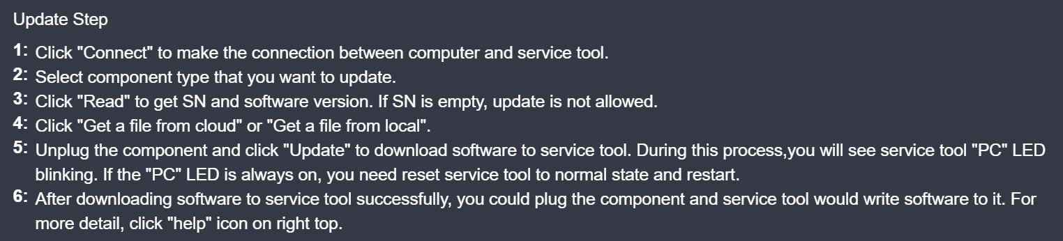

Is there an actual step by guide the correct process to updating the firmware anywhere?
i managed to upgrade the engine with the FW @Rob Rides EMTB gave us. I tried 500 meters down the street. I have a feeling the start is a little softer. I think I'll be driving tomorrow so I'll know more. there is only one strange thing. the battery at 53v shows 70% on the screen, at bms it shows 99%, a bit strange. @Rob Rides EMTB do you have readings like this?
No, mine seems normal
Rob, what u mean by step by step? Over Besst?
1. Select Controller and input "CR" into serial.
2. Load firmware into best by click upload button
3. Plug connector facing motor.
4. Wait till beep and done.
5. Then hit reset in besst software. (It would reset basst)
Or official in picture.
