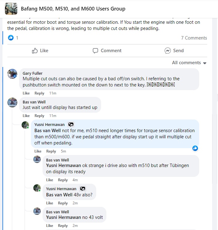

The strange behavior of the motor definitely has something to do with switching it on. Today I tried @ficorama version, unfortunately without success. Then I only switched on the motor after starting to ride under load with the result that the motor did not provide any support at all, regardless of the cadence or level.
Then I waited about 1 minute after switching it on and drove off normally and there were no more cut-off‘s. Someone should make sense of it 🤷‍♂️
wait time needed before use after ignite, for torque sensor calibration ?
Ok i'll try this tips, maybe engine need times for torque sensor calibration.

Thanks for the tips, Today I did it twice. Turn on switch power then wait for 1 minute, and second one wait for about 30 seconds. And magically the motor can give assist more smooth on light pedaling or light uphill. just a little on off assist when speed below 10km/h.
I think @KaroKönig was right that M510 motor need more time to auto calibrate torque sensor than previous M500 or M600. Big Thanks for the experiment.

Glad my remembering about the calibration routine on startup is working. I from habit tend to start the motor up before actually getting on it to eliminate the bizarre but almost uncontrollably need for one to rest one foot on the pedal if you are sitting on the bike. Must be something to do with ergonomics and the human brain.
I always stay away my foot from pedal when turn on motor, but this M510 need more time than M500/M600 to calibrate. M500/M600 can use straight away after turn on :ROFLMAO::ROFLMAO::ROFLMAO:
someone on FB group use M510 43V and do not wait for 30 seconds or 1 minute to calibrate. no problem persist like us which are used 48v version. anyone here use 36V version???
I also only observed minor drop outs with my M510 not waiting for calibration. Like @ficorama. Not a big issue. But with correct start up procedure today, the motor worked without ANY drop outs or other strange behavior. Like my M500 earlier, but much more power and support.

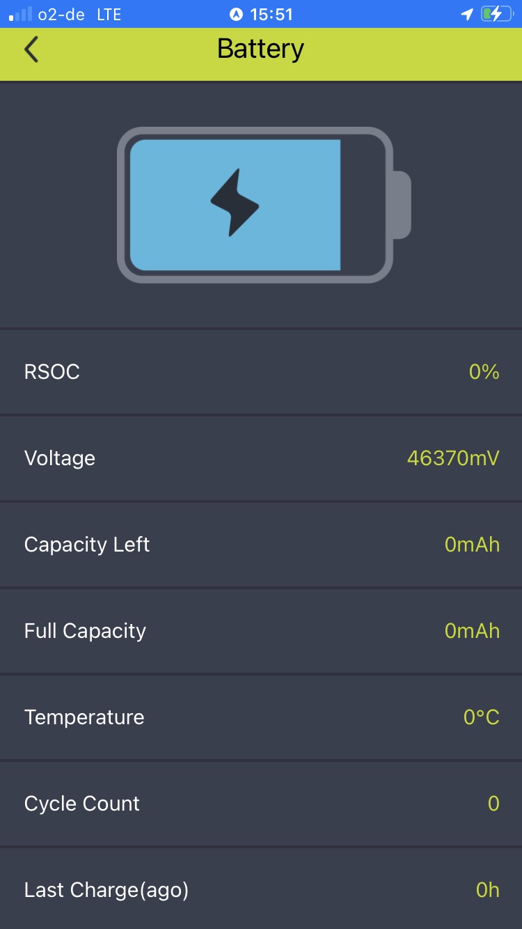

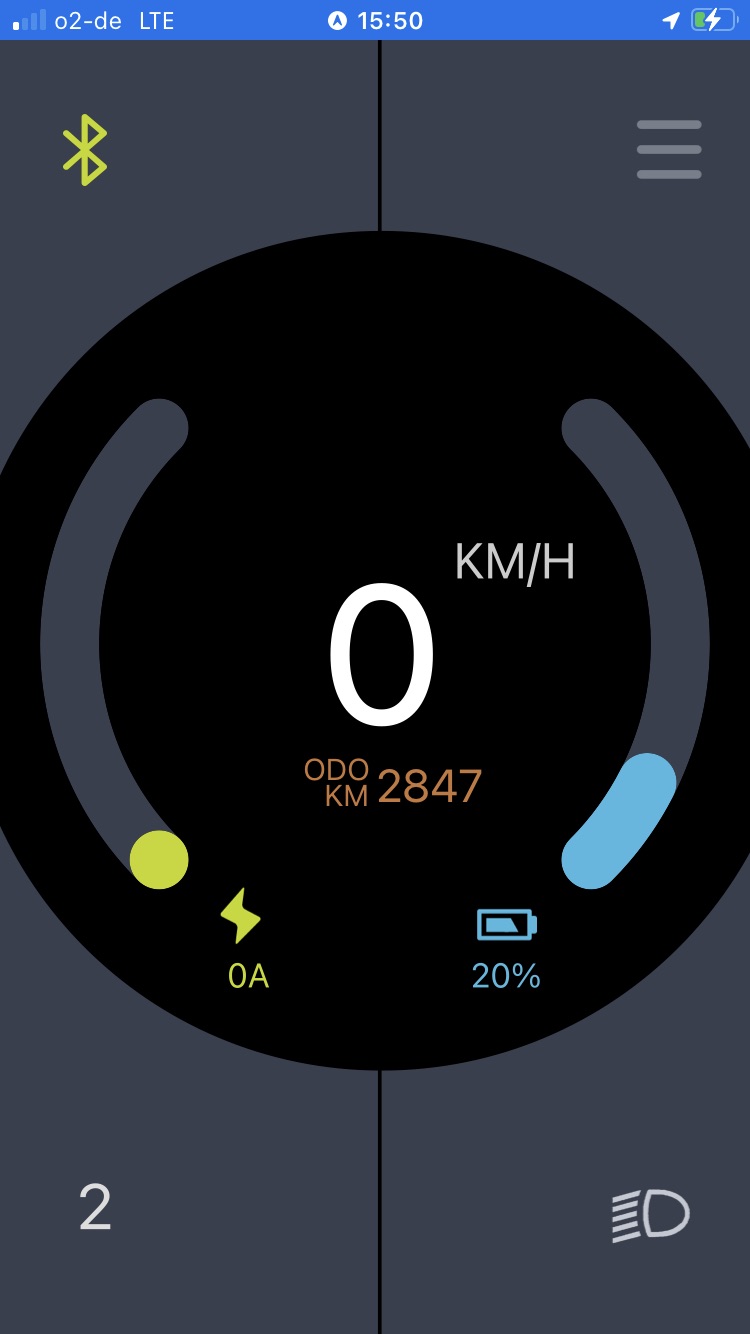

Yesterday I did a longer ride an checked Voltage level at 20% SoC. I still found more then 46V, while riding the Voltage remained at 45+ Volt. This means, the SoC calculation (remaining battery) is very pessimistic. There is still lots of life left, and the motor can pull full amperage without the risk of hitting the low Voltage cutoff of the BMS. Looks like there is a major difference to the Bafang battery that @VMG Chris is using, with more realistic SoC, and therefore „earlier“ need of reducing Amps allready at 30% SoC. 2nd takeaway: You can drain the Dengfu 840Wh battery completely without risking battery health. Next time I‘ll try that.
