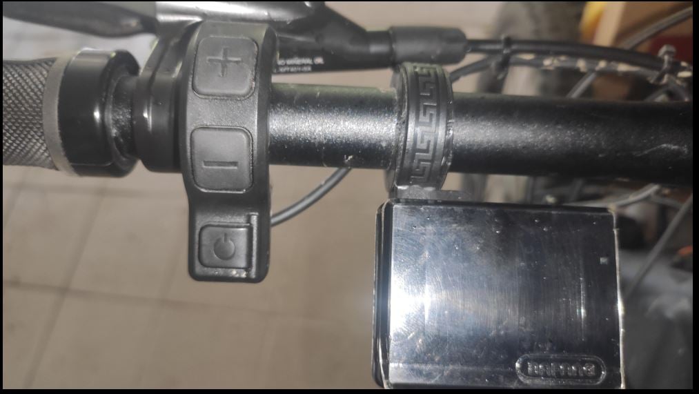

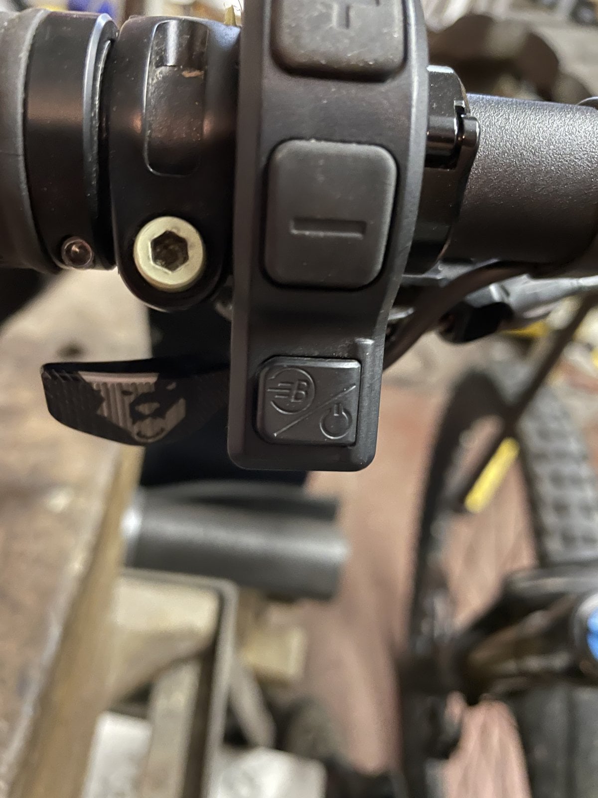

How do you enable the boost feature? I have DP C241 but there is no "Boost" button, only power button.

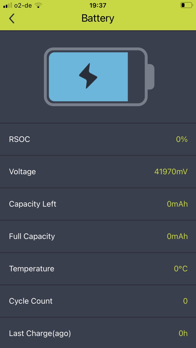

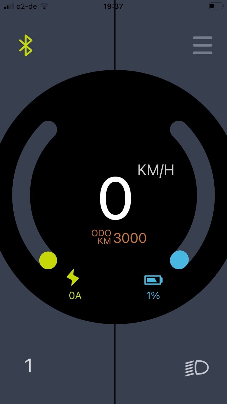

Today I rode the bike until the battery died. That was a real challenge, because between 10% and 0% the motor only provideed 200W. That’s enough to climb additional 300m and ride 10km. Another hour for me. The battery cut off at 41V. So overall, I‘m very happy with the attenuation. Attached 2 pics of the SoC and related Volt at 1% SoC. I had to stop for the pictures. So Voltage was appr. 0.5 - 0.8 Volt lower under pedaling.
your M510 already reach 3000 km?
