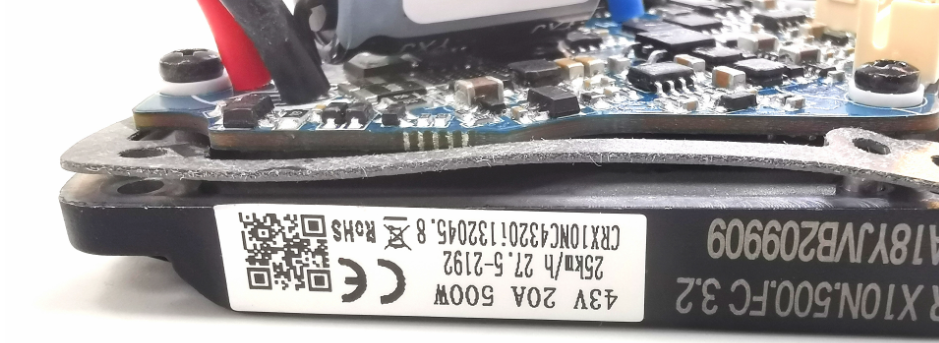

Hi, is FC2.0 the latest one? I see everywhere FC3.2 for sale.
M600 FC3.2 and strange here, also new M600 contriller has same label (and is not compatible with old M600 firmwares)

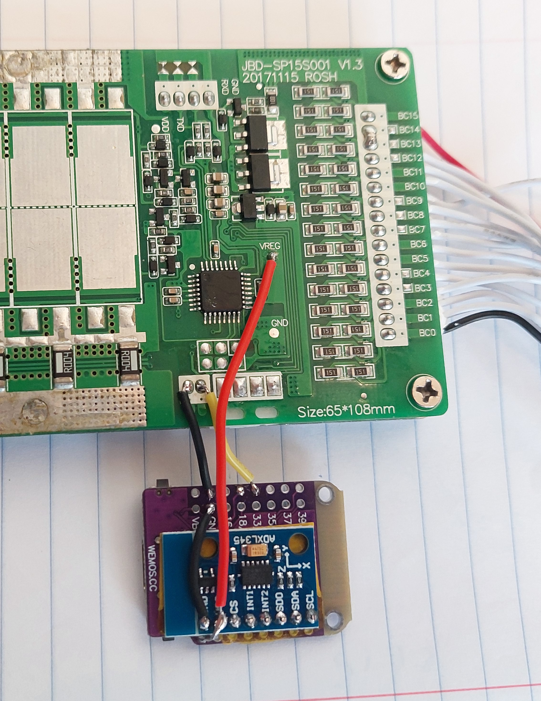

As I am right now installing the VESC + EBike/EScooter board on my Xiaomi M365 stand up scooter, I also need that button switch but there is no such thing on the M365 scooter (well, there is but can not be used on the BMS). I came up with a solution that may be useful for everyone that uses a JBD BMS on his EBike/EScooter:
What: a small DIY board that automatically switches ON the popular JBD BMS, effectively switching ON the EBike/EScooter, when there is motion / vibration. Automatically switches OFF the BMS after a timeout without motion, like 20 minutes (configured).
Avoids the need to install a mechanical switch and also adds the safe timeout that automatically switchs OFF the EBike/EScooter.
Project page repository with all information: GitHub - OpenSourceEBike/Automatic_Switch_Anti_spark_JBD_BMS: A modular DIY automatic switch anti-spark using JBD BMS
Features​
  • Switch ON the EBike/EScooter by shaking: JBD BMS switchs ON when there is motion of the EBike/EScooter.
  • Automatic switch OFF the EBike/EScooter: JBD BMS switchs OFF after a custom timeout like 30 minutes, when there is no more motion.
  • Ultra low power: espected to use only 0.007 watts when JBD BMS is switched OFF (will take 8 years to discharge a 500Wh battery).
  • Cheap and easy to DIY: costs 5€ in materials and needs only soldering 8 wires.
  • Wireless communication with other boards (planned, optional): an EBike/EScooter main board can communicate by wireless and switch OFF immediatly the JBD BMS.
