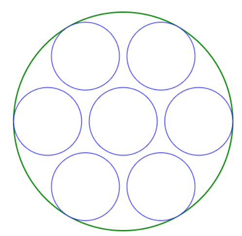

Not my scene, but lying in bed last night I thought about the downtube cells. if they used 18650 format you could fit 3 side by side (you might have to V them slightly, depending on the V you might just squeeze in 21700's) with two stacked over and 2 above. which would fit into a 60mm round downtube. So 7. Think Darth Vader Advanced TIE fighter shape stuffed into a tube :
It has to be limited to about 50cm length for the smallest sized frame, so with connectors and end caps you can fit 7 length ways - giving you space for 49 cells. No idea how you get around squeezing that into a 13s4p (which might not even be correct) configuration, because you can't, so we'll ignore it and use it as an approximation.
I think the existing Amflow 600wh battery has 52 cells, but rumour has it that will be increasing in capacity in the gen2 batteries.
Therefore, assuming someone can work around the problems of turning fiction into something workable, then you're looking at a 630 (wild)-700wh (limit pushing) battery at a wild guess at the top end of wild guesses.

OK so if you use 21's you can only get 5 into the tube, but 18650's gets 7 still (58mm inner diam).
I forgot about the BMS. so only 6 lengthways, not 7, but possibly 7 if they use a really small bms with the 18650 cells. therefore max of 42 cells with 6 or 49 with the 7 compared to 40 for 800wh battery with 21700's.
But a 21700 is 5500 mah or maybe 6000 for the next batch of amflows.
18650 is only 3500 mah so a 49 cell (if you could make one) would give about 640wh.
Using 6000 21700's would maybe give you something similar within the space available. 4680's would give you less I guess as you'd be wasting more space for something with about 5x the capacity of a 21700 - if you could make the voltages work.
Feck knows, maybe they've managed to squeeze a longer one in and end up with 800ish.
Maybe the downtube is wider than it looks ?! 63mm internal would give you space for 6*21700's, so then you're up near 800wh. 64mm internal and you're upto 7*21700's (this ignores relevant things like packaging).
Oooh, if you bump up the tube a couple of mill, we can get 8*7 18650's - so in the 700wh area.
So basically, I haven't got a clue ! :)
Current Avinox batteries use an older 21700 LG 5000 mah cell. 20wh per cell. 600wh is 10s3p, 30cells at 20wh = 600wh. 36v.
The packs are laid out in blocks of 6 cells stacked(2*3). With a custom battery using newer 6500mah cells in a 5 cell block Atherton's could do a ~720wh pack in a length just one block longer than the 600wh battery. The 5 cell cluster will fit in a ~65mm round downtube.
6000mah cells would be 666wh.
I am betting than DJI easily gets their hands on the latest 6500mah cells and it a ~720wh pack.
