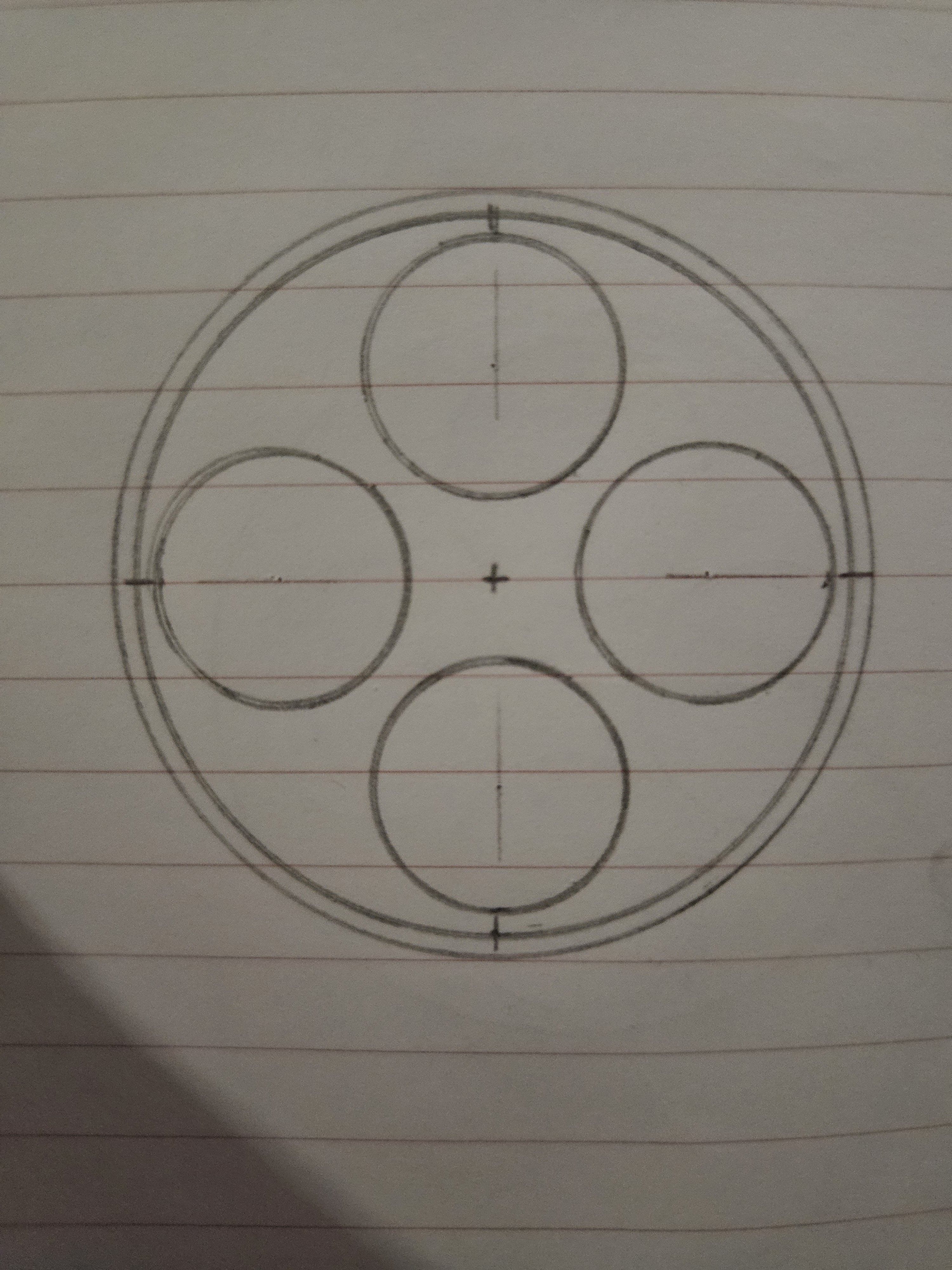

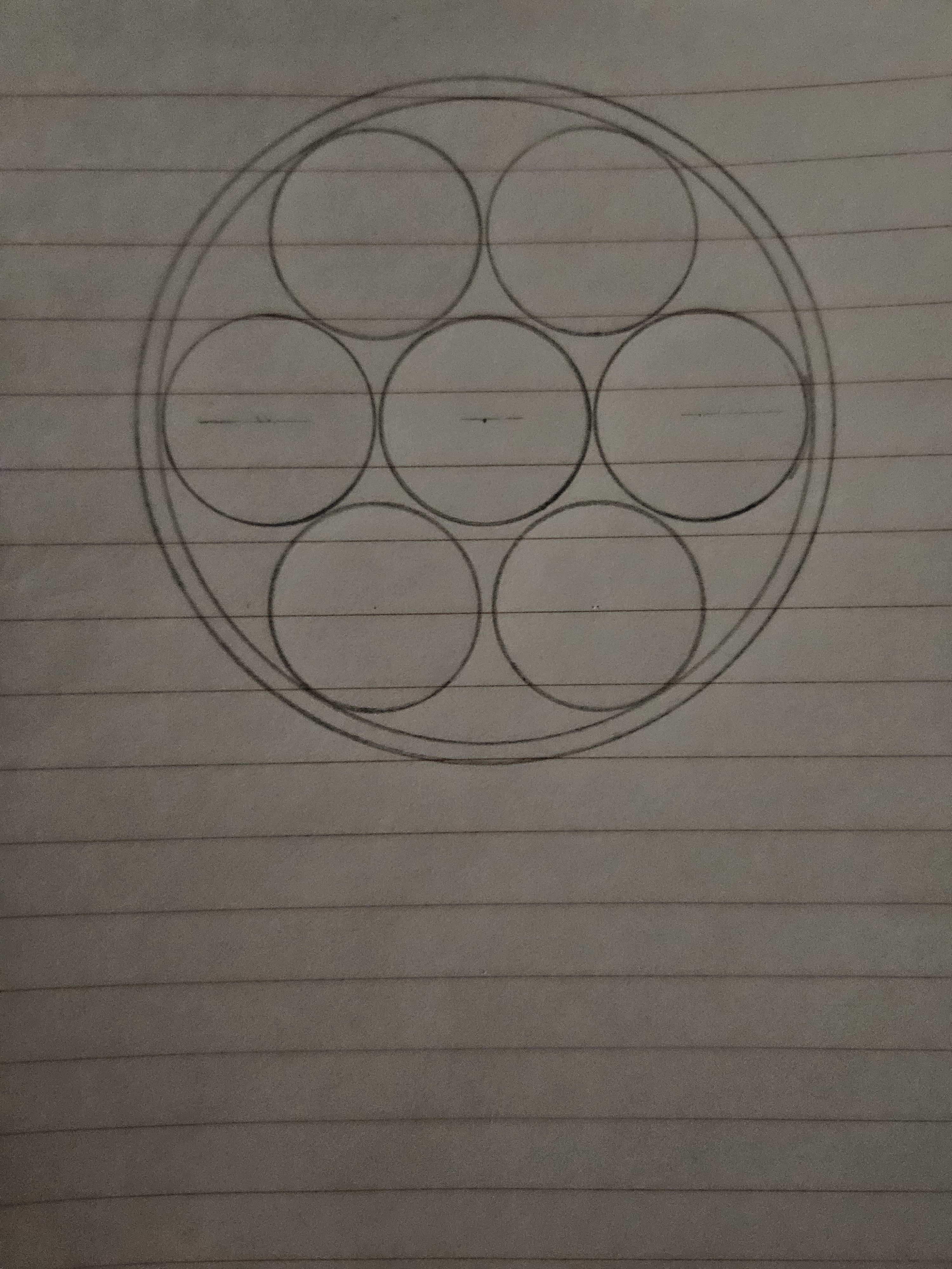

Did some sketching with the 21mm cells also, the first is what fits into a 6cm internal diameter tube and the second one is where I increased the internal diameter to 7cm.
The downtube length would need to be around 56cm to comfortably fit 7 cells in a row along the tube + 3cells in the next row to complete one 10 series group and so on and to have spare space left for the BMS.
I also think the downtube is closer to 7 to 8 cm in diameter as if we use the 6cm it just falls short for a 10S3P configuration by two cells(fits comfortably only 28) we need 30. It would be possible to squeeze in the extra two if the downtube is slightly increased say to 57cm.
So in your suggestion of 50cm length /6cm diameter IMO only a 10S2P configuration is possible cca 470Wh with the best avaliable cells.
For comparison in a 7cm internal diameter tube there is space for 49 realistically and 56 max cells, for a 10S4P pack we need only 40 cells, so with 9 to spare there is also plenty space for the BMS etc...
So with a 56cm long and an 7,5cm diameter(increased for insulation wiring etc) downtube new 21700 6,5Ah cells, some smart wiring and packaging IMO a cca 930+Wh pack would be possible.
If the tube is indeed a bit shorter than my base of 56cm the next lower pack would be a 10S3P with cca 700Wh.

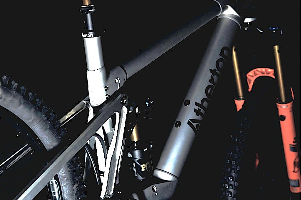

ok, I found a different image. Using the bottle cage bosses (64mm) as a closer size guide, I get the downtube external measurement at 66mm (can't vouch for my accuracy though :) )
Length of 54/56 might be possible, it's difficult to tell how far they'll run into the headstock area and how low it will actually go.
Doesn't look like the cables will run via the top tube/seat tube, so some space will be lost there, but the battery unit might not be 100% round, it might have a slightly flattened top (depending on sell choice/size/layout....) and those cage screws need some length/space.

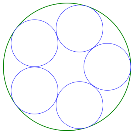

Interesting. You could get 5 21mm cells in a 57mm bore but guess you'd need some room for insulation, or a carrier, etc. Those bolts/bosses look quite large maybe they are dual purpose for securing a battery and have a thread for a bottle cage. Did you consider Endoriums question about 48v?

I think the can on a float X2 is 60-65mm and the down tube looks slight thicker than that so defo 65mm+

You should be able to fit in a 10sp3 - 30 cells (ergo 700wh) ?? 6 long and 5 in profile - then just be creative on how you connect them all together to get the 10sp3 ???(which will cost you some length)
5 fit into 57mm - giving 9mm for the tube and battery case. Don't make the case perfectly round (think star nut shape) and you have space for bottle screws and cable runs.

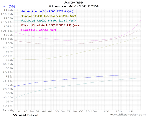

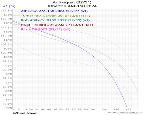

While Atherton has been tight-lipped with their kinematics, here are some graphs of DW6 I found on the AM-150:
As you can see, anti-squat diving about half way through the travel.
And on the anti-rise front, it's high enough to keep the active geometry intact, but low enough to keep suspension active during downhill braking.
