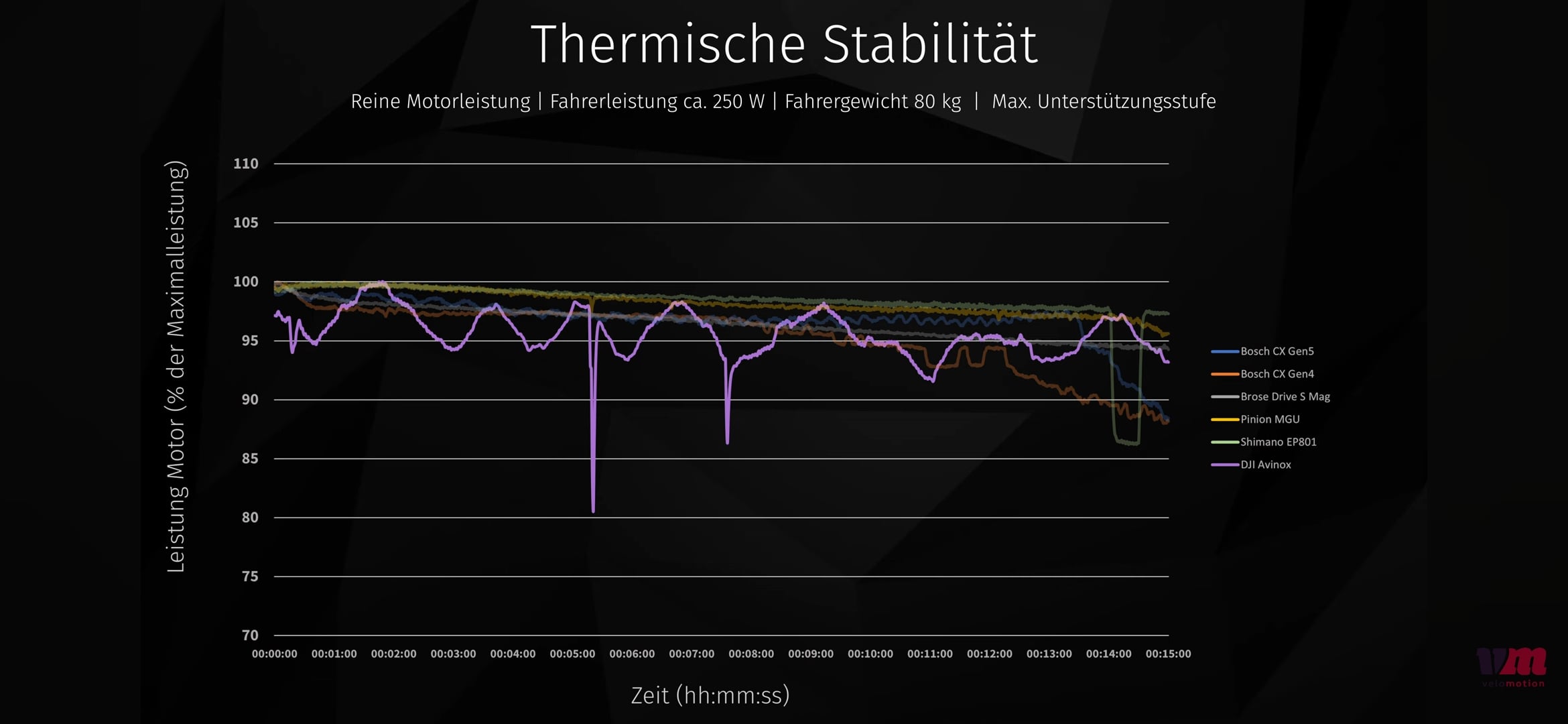

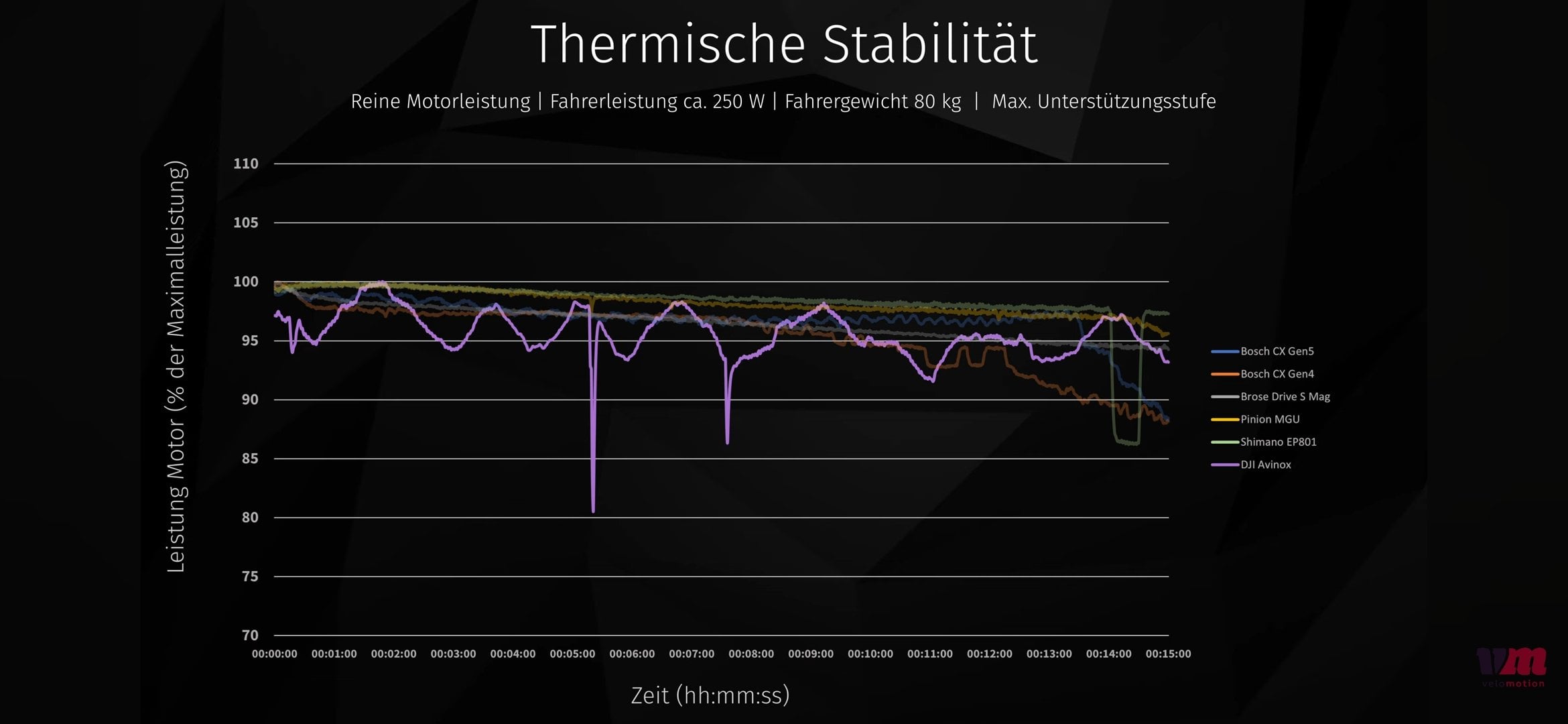

I don't think 36 vs 48 V makes much of a difference in this application. In most cases, the power wire is very short so increasing the gauge doesn't carry much of a weight penalty.
Interesting graph, did they make one that shows Nm rather than percent of max output too? And it would be interesting to see how things look between 15 and 30 mins. The Pinion seems to do well, but it makes sense that a bigger motor with more mass requires more time to reach the temperature threshold. It's not necessarily down to efficiency.
Edit: Found the article, the DJI did cut completely after about 20 mins, too bad they didn't extend the run for some of the other motors too.
