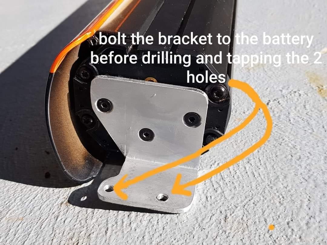

I saw this guy had removed the entire battery lock and saved 360g weight from the rail by removing the mechanism.
Anyone here done it? I don’t like this key mechanism, seems a bit flaky and although the RIB removal is good if you need to remove the battery, I’m interested in removing it completely.

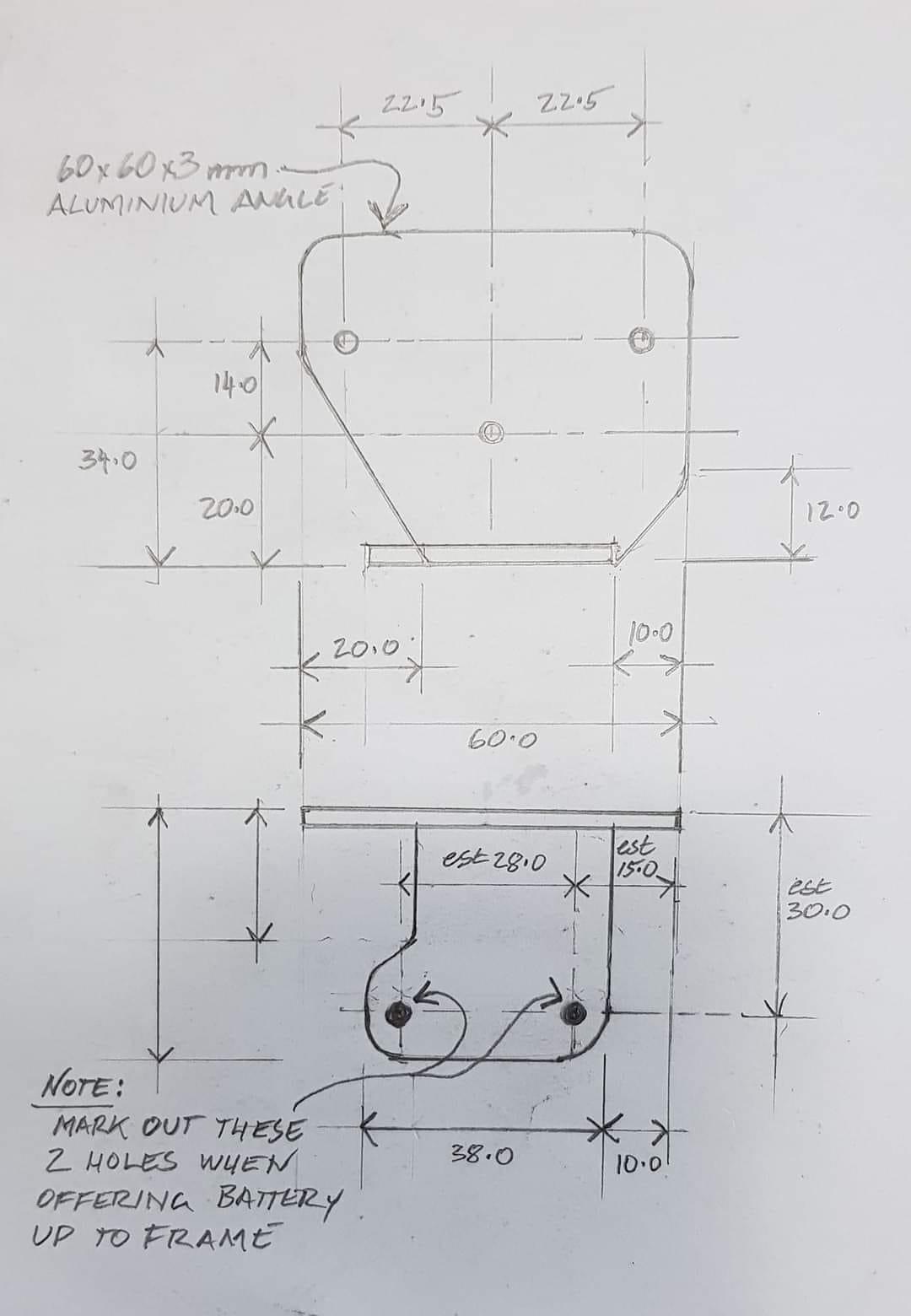

Another option instead of angle Aluminium is Carbon. You can buy the carbon angle off the shelf (easy to cut than Ali and easy enough to trim with dremmel or similar)at reasonable price, use floating anchor nuts (can be glued or drilled to fix) instead of tapping and even lighter weight. Just a thought

Hi mate, would you be happy to post a pic of the dimensions so i could maybe knock some up.

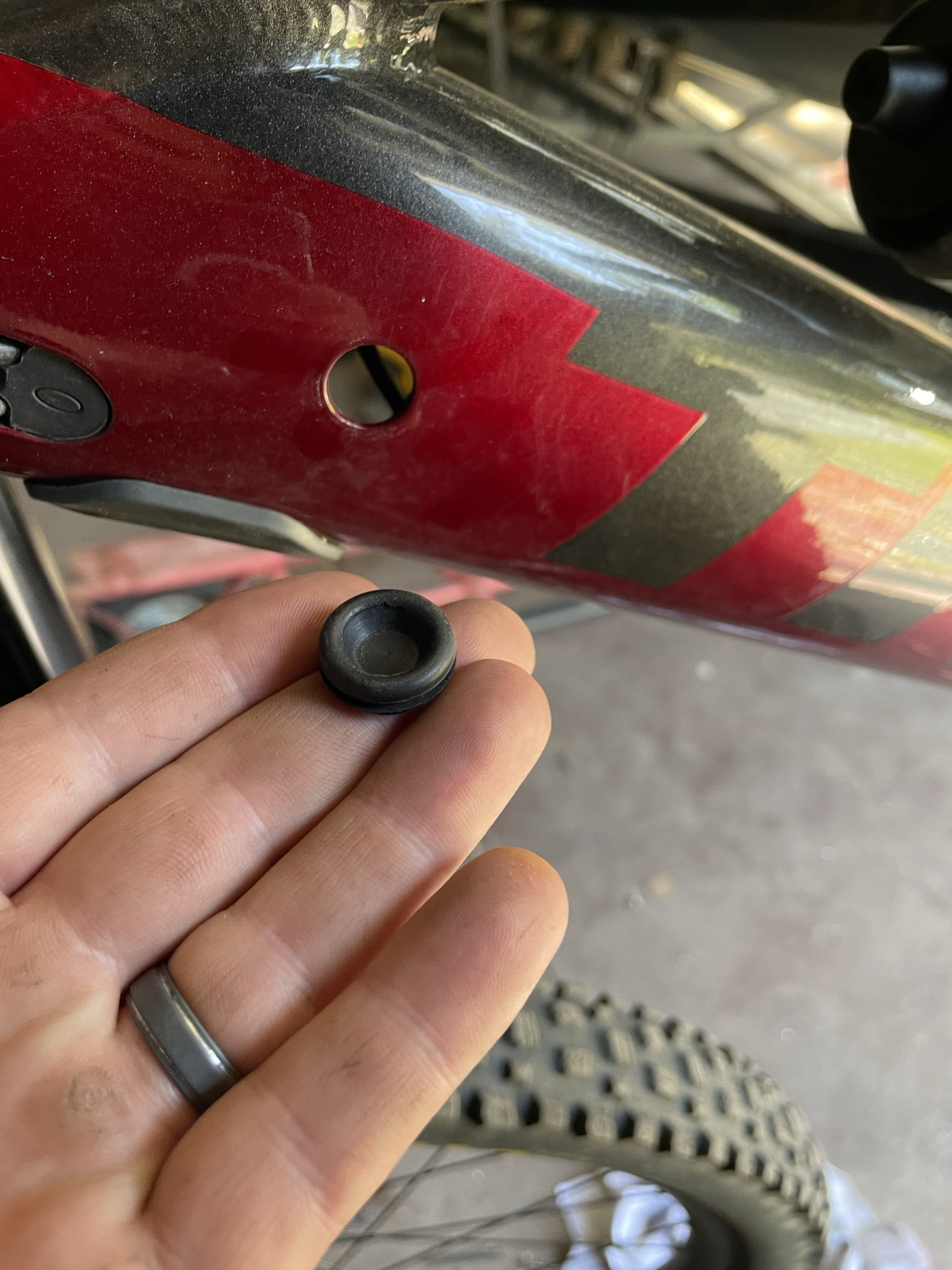

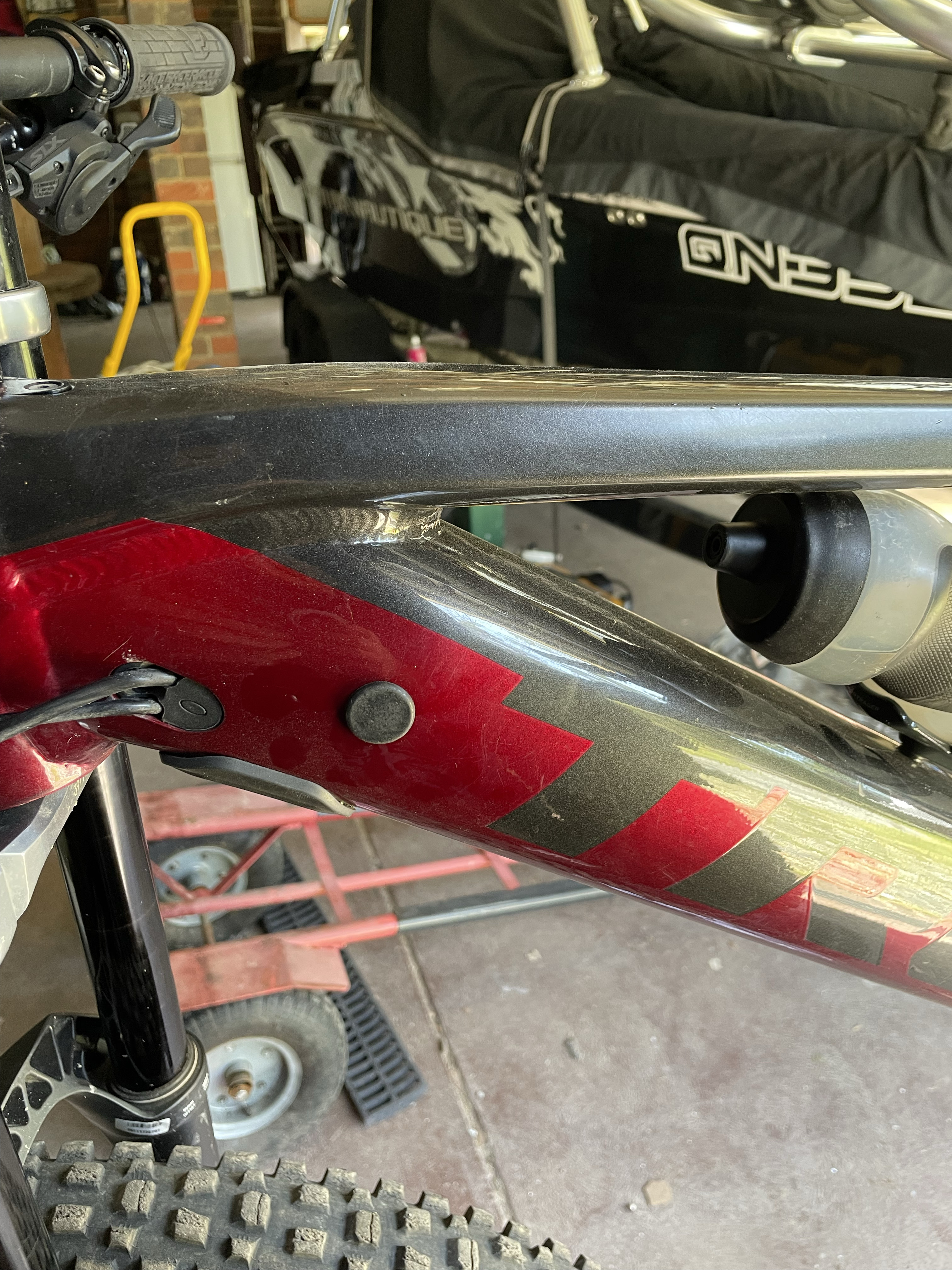

PS. You have a key grommet just like mine LOL
I'm not finding a good key grommet for my bike. Where did you find yours? Is it off of some common household item?
5/8” rubber grommet, should be able to find at your local auto parts store and possibly hardware store.
Finally got around to fitting mine today, also fitted one of the foam Bosch terminal pad (things) super happy with it. Battery cover to frame alignment fits better than it ever did. Cable routings now easier to access, 500g removed (obviously added whatever the bracket weight is) I’m well happy. Thanks Aaron
Bracket weight is about 48g

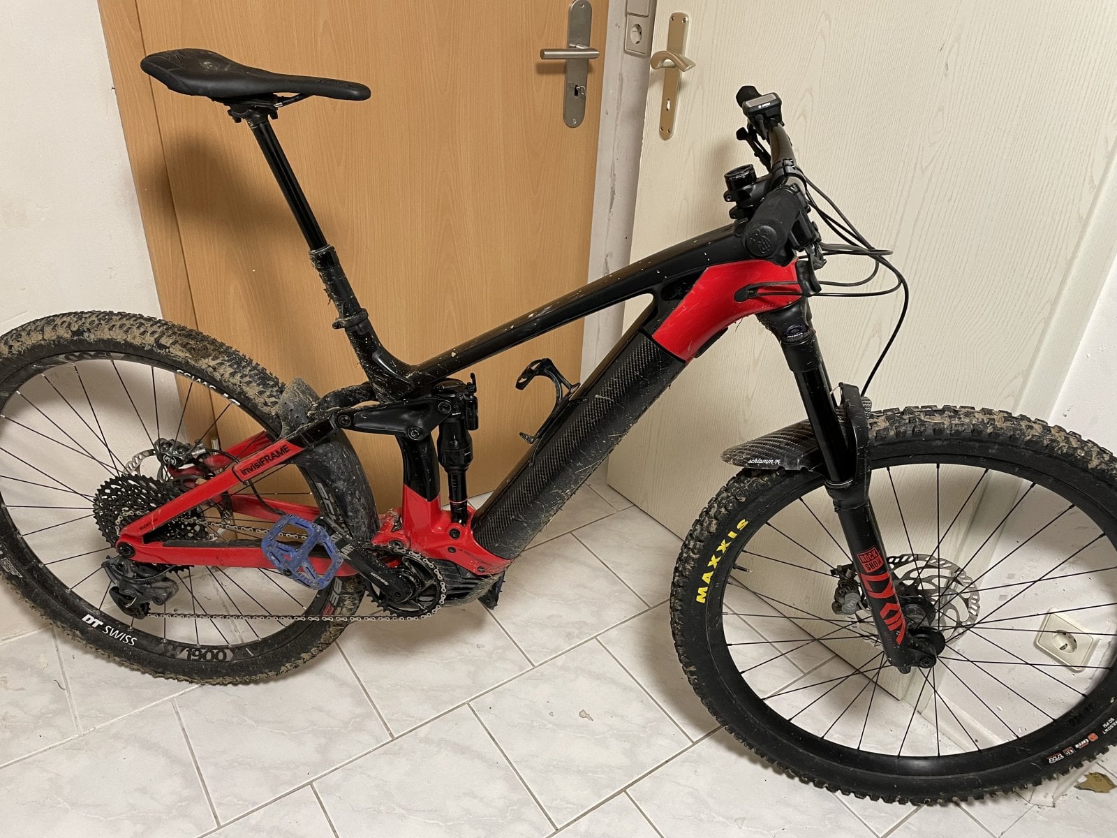

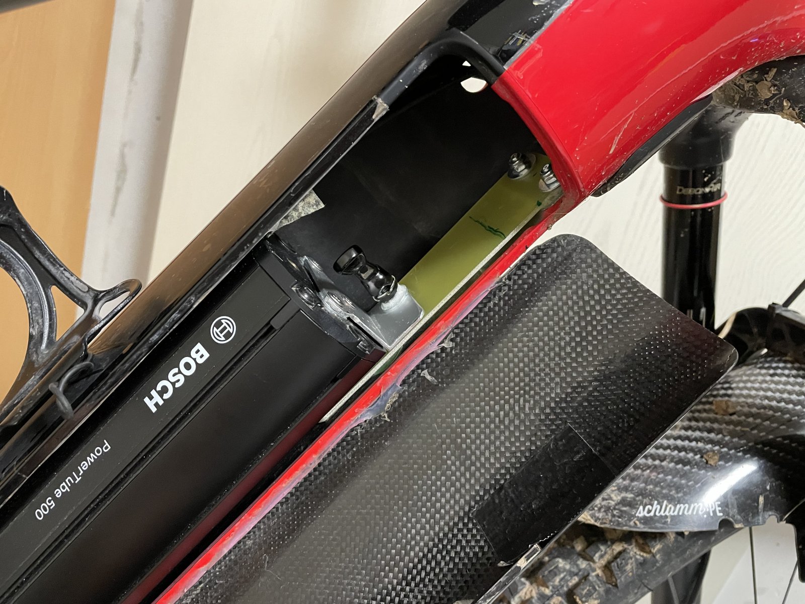

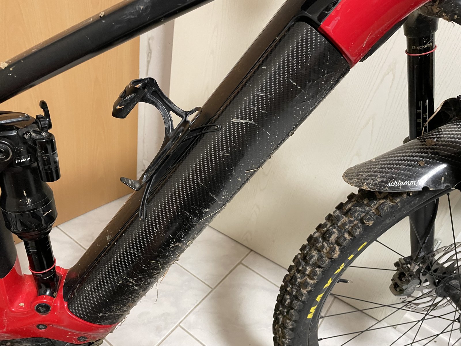

Hello
this ist Chris from germany.

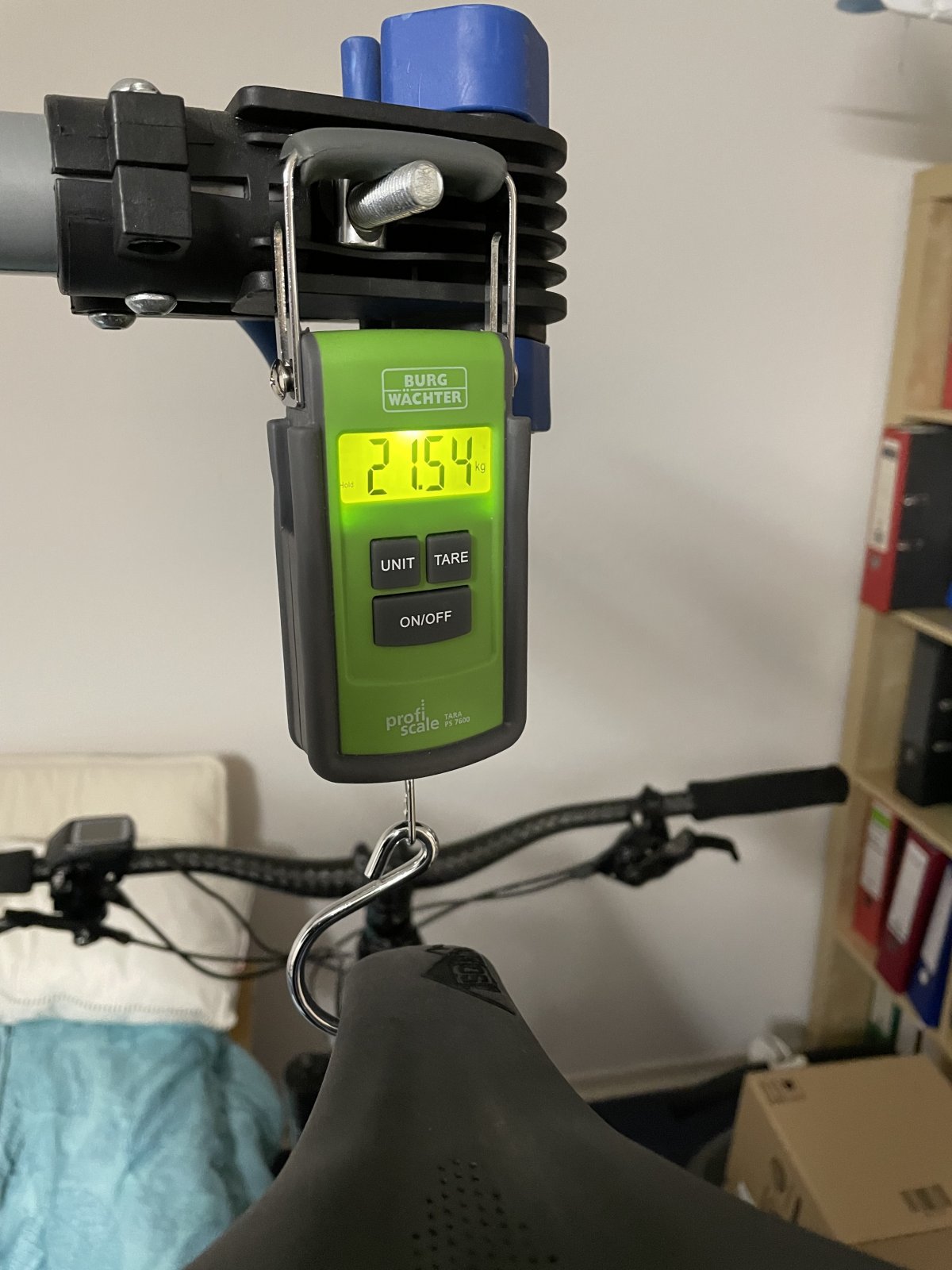

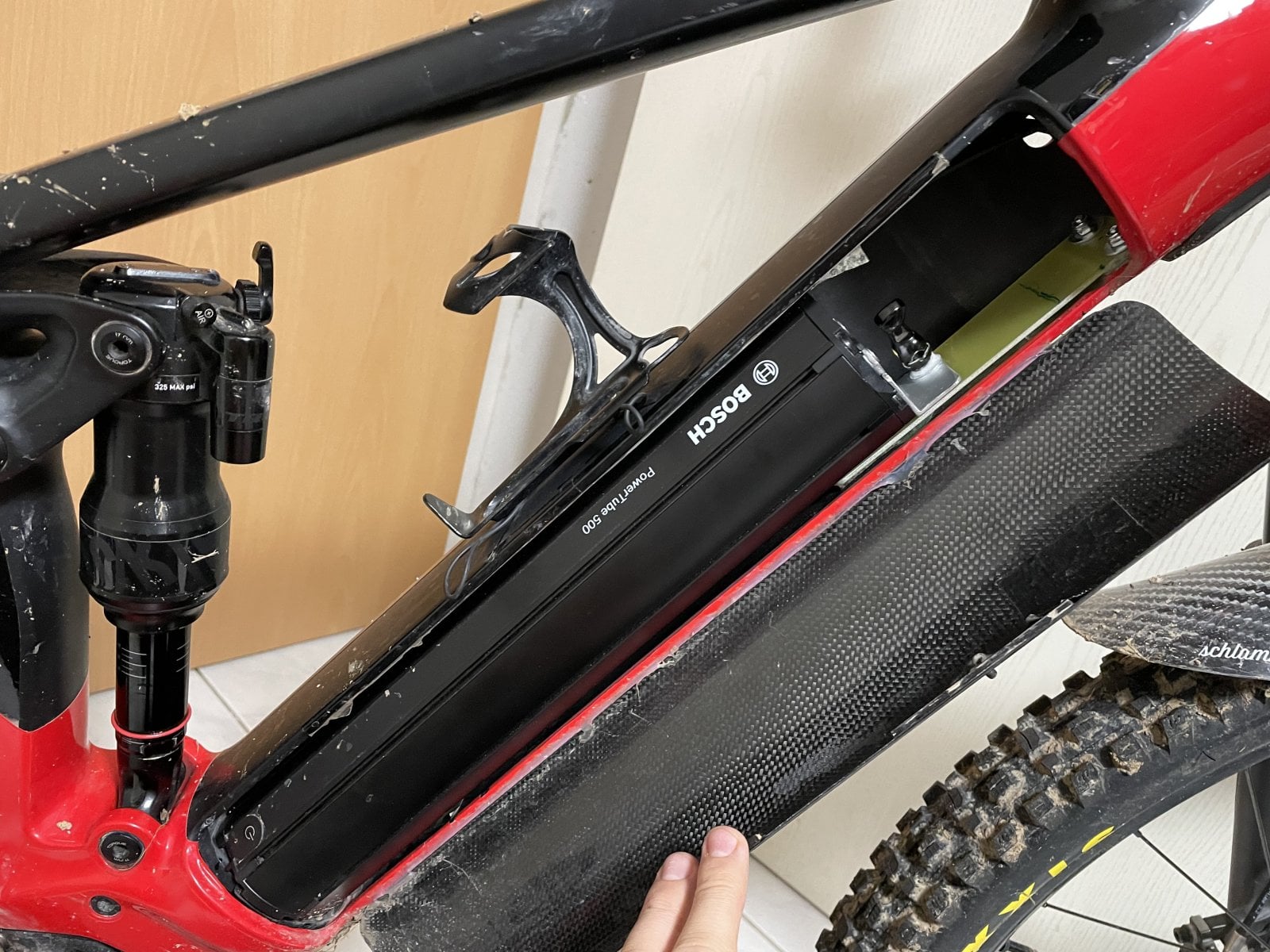

I´ve made some changes to my rail 9.8-2020. I remove the battery lock and buildt a plate with a quick release. So changing the battery is done in 30s. I use 2x 500wh battery, but it will also fit with the 625wh-tight but it works.
The cover ist carbonfiber hinged with silicon at the frame.
I saves a lot of weight (alltogether ca.650g) and improve the usability. Only painting need a little improvement.
Overall weight is 21,5 kg with 500wh an DHF DD rear (some other changes done)-with pedals.
