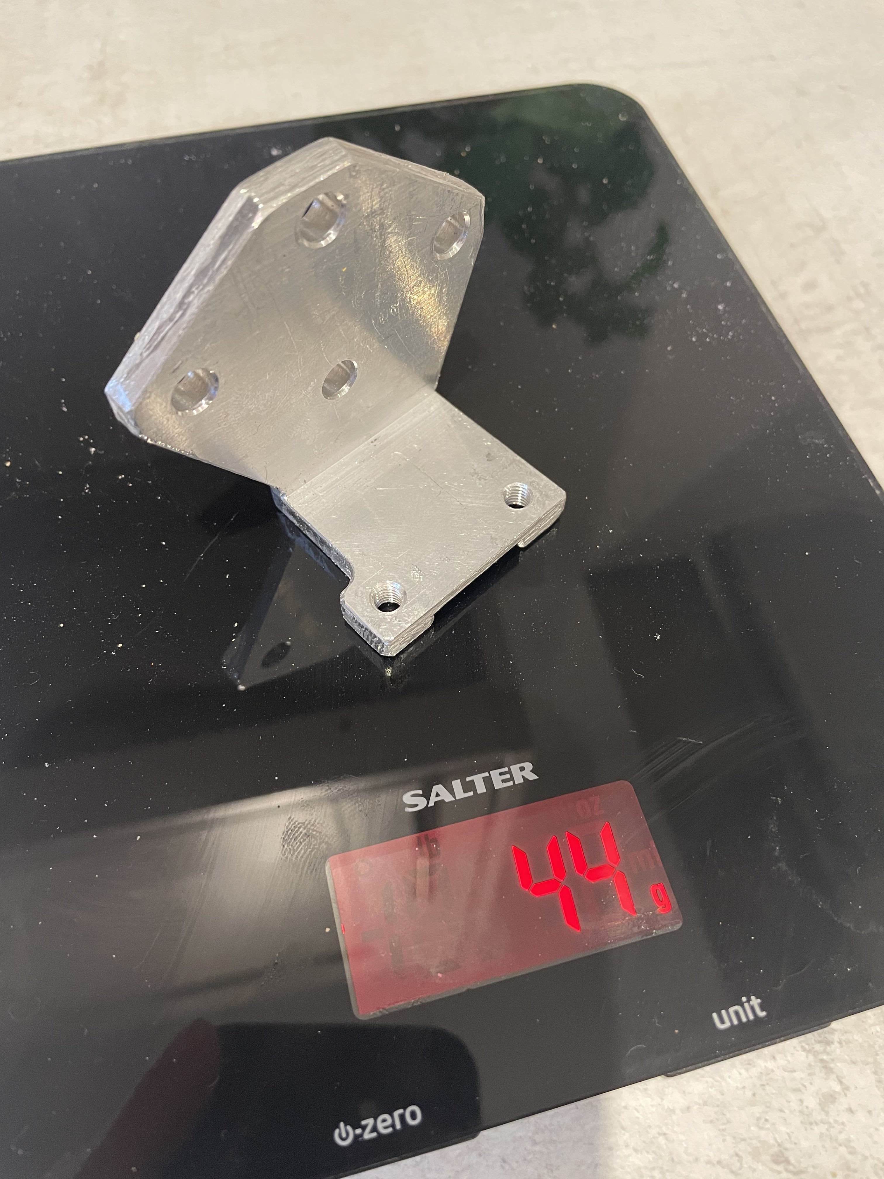

photos to follow im already on version 3 but my interest in this isn’t for the trek really it’s for my focus Sam I just happened to have my mrs Powerfly lying around so in for a penny as they say

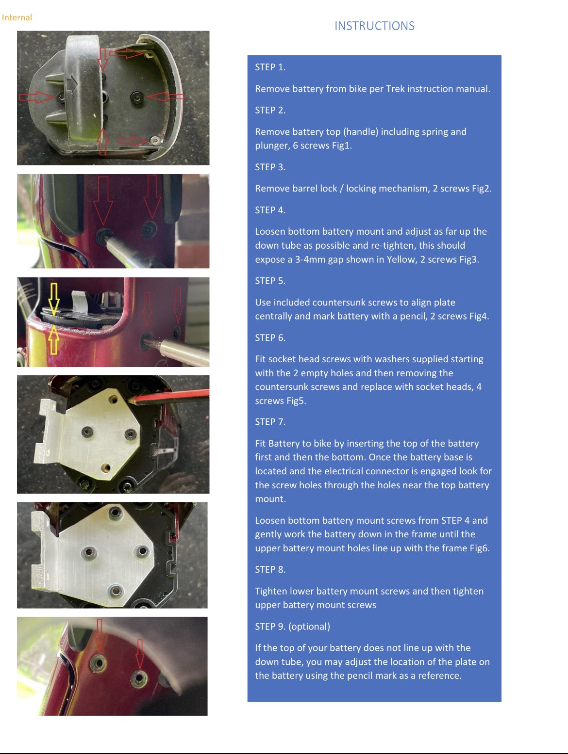

@Arron M did your bike have the battery plate? I presume for newer bikes that do, we need to remove the plate assembly completely?
[mention]Dave_B [/mention] my bike does not have the additional plate, and an earlier post indicated that it would be removed. I can’t be certain of the compatibility if wanting to retain the plate.
I can’t see any issue with removing the plate. It’s purpose was only to dictate the distance between top and bottom plate.
I have not looked how the plate connects to the battery plates? Im not yet even sure how to remove it and once removed if spacers are required to return the bottom battery plate to the correct position?
No doubt we will with through this together once we all start fitting the bracket.

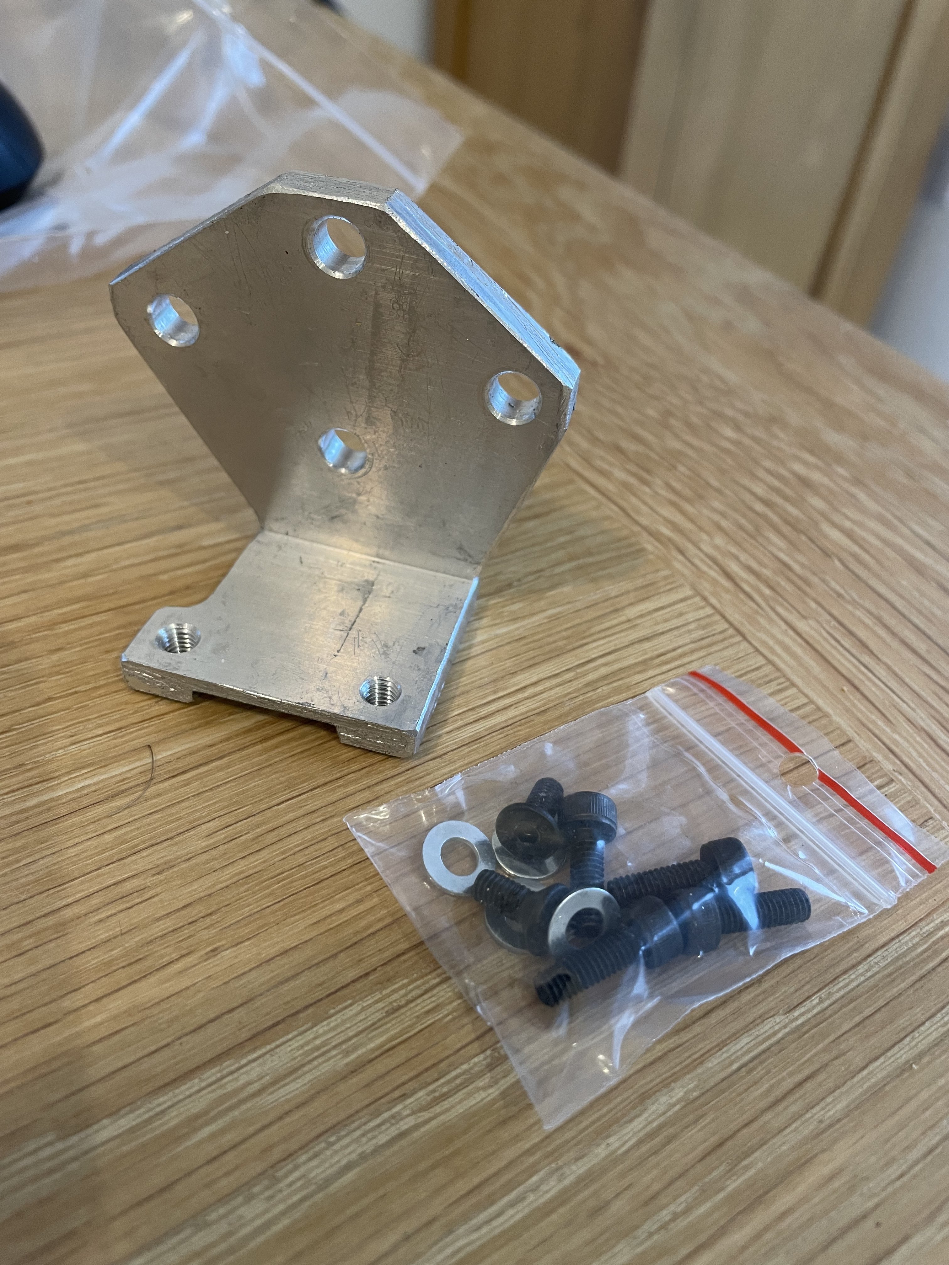

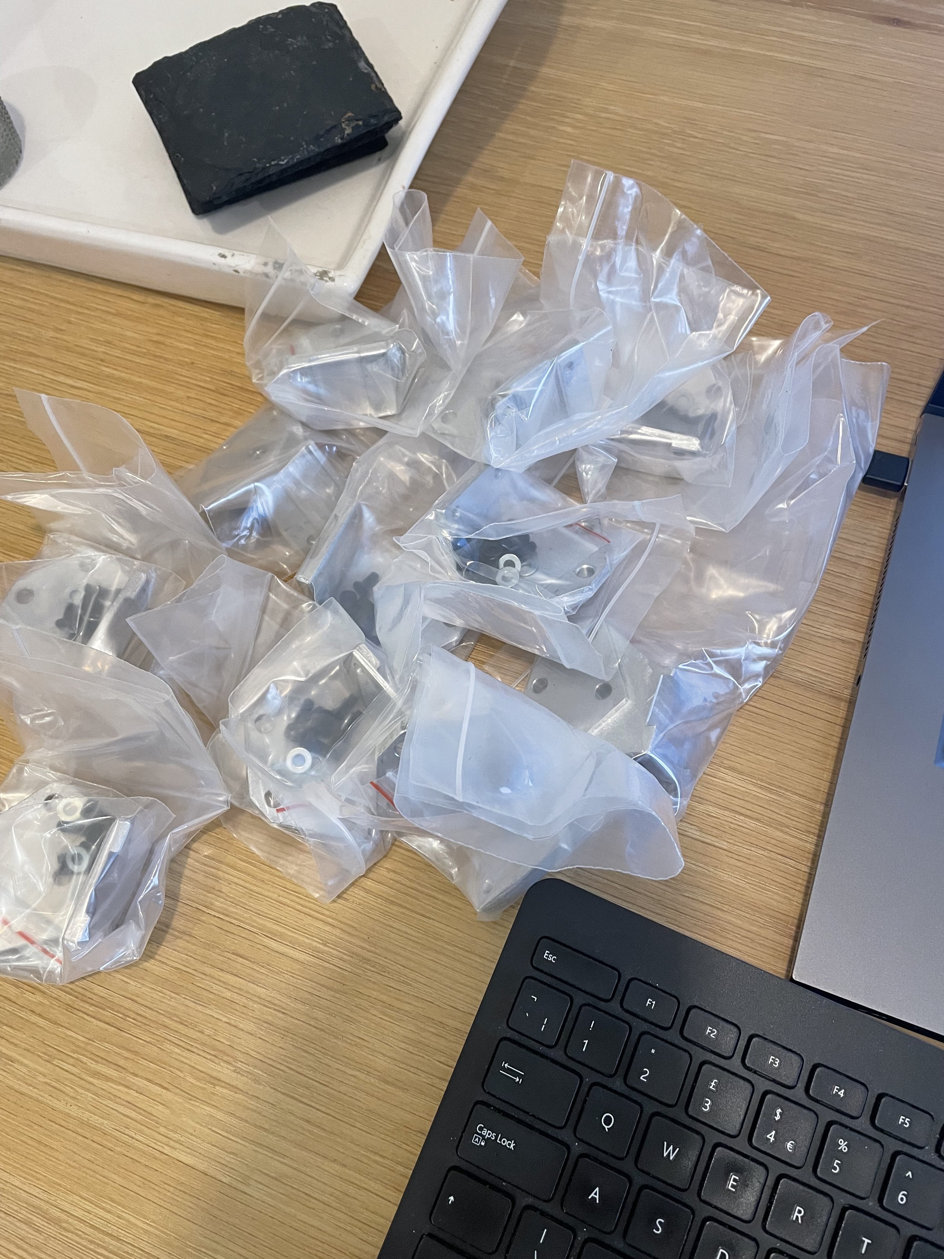

[mention]Rob Rides EMTB [/mention] would you mind confirming these fit the 750wh bikes once you get yours as I’ve had a few people ask
That’s mines fitted now, I didn’t have to bother about step 9 on the instructions as the fitment is perfect on my bike..
Big thanks to Arron for making them and shipping to the other side of the world and Dave for organising the group buy…. Thanks guys 😃
Mines is the 625, the battery is solid, I can’t feel any play in it at all
