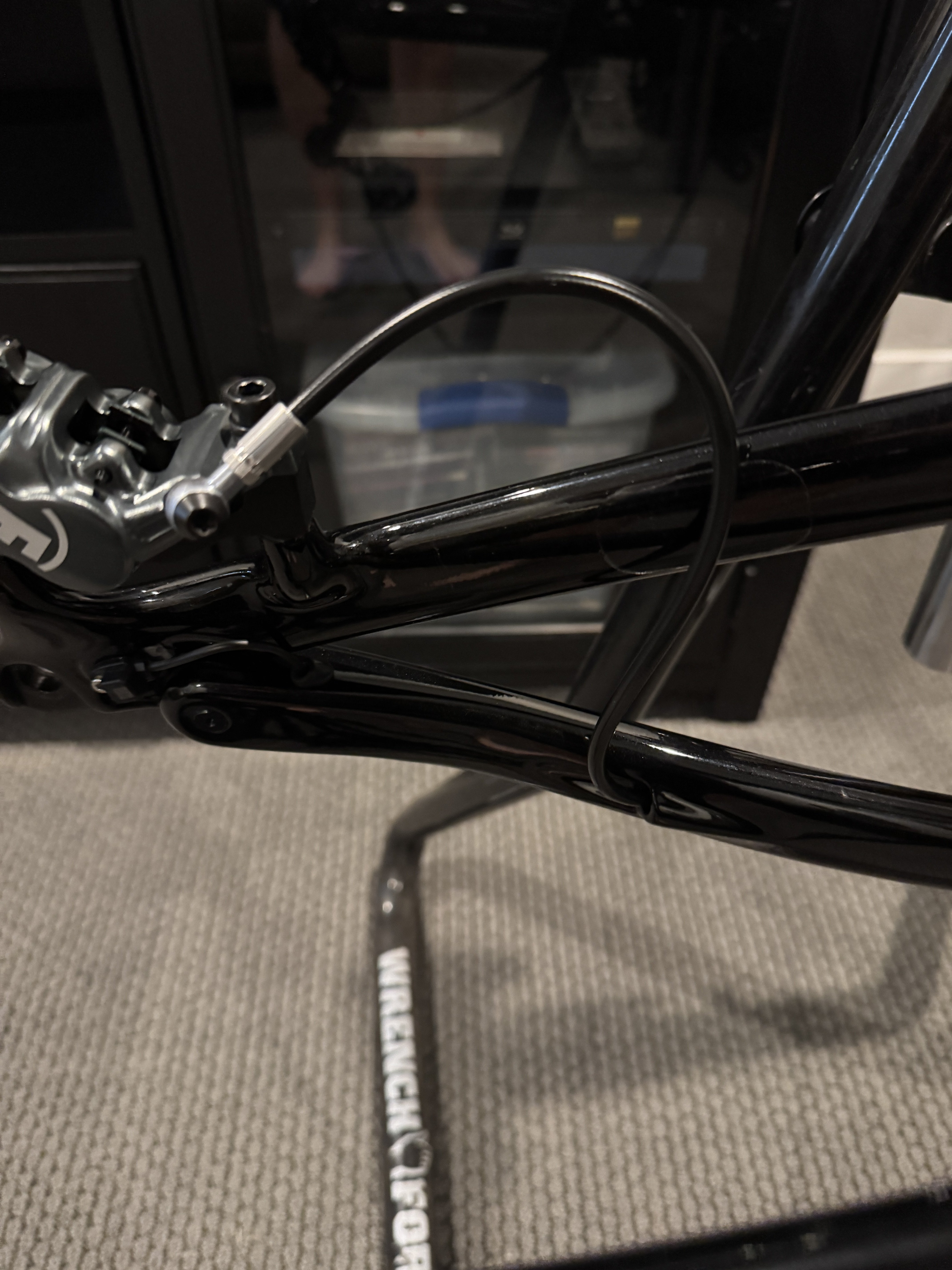

@Amflow_Support Question & Build Feedback
How do you change from 24 hour to 12 hour time on the display?
The charge port door isn't that robust. My fell off when I first opened it. It's only held in place with a spring bar like a watch band.
The USB plug cover above the display doesn't fit well. It really has to be pressed in hard to make seat.
The bike was packaged amazingly well and easy to assemble.
The rear axle was so tight the person almost stripped the head. You can see the bite marks in the bolt. It's only 10 Nm boys and girls. :)
Is it really necessary to have the large bend in the rear brake cable? It seems the banjo bolt could be loosen and rotated down to have a more linear path.

As for the rear brake cable routing, your observations are duly noted and will be conveyed to our engineering team for further technical evaluation.
