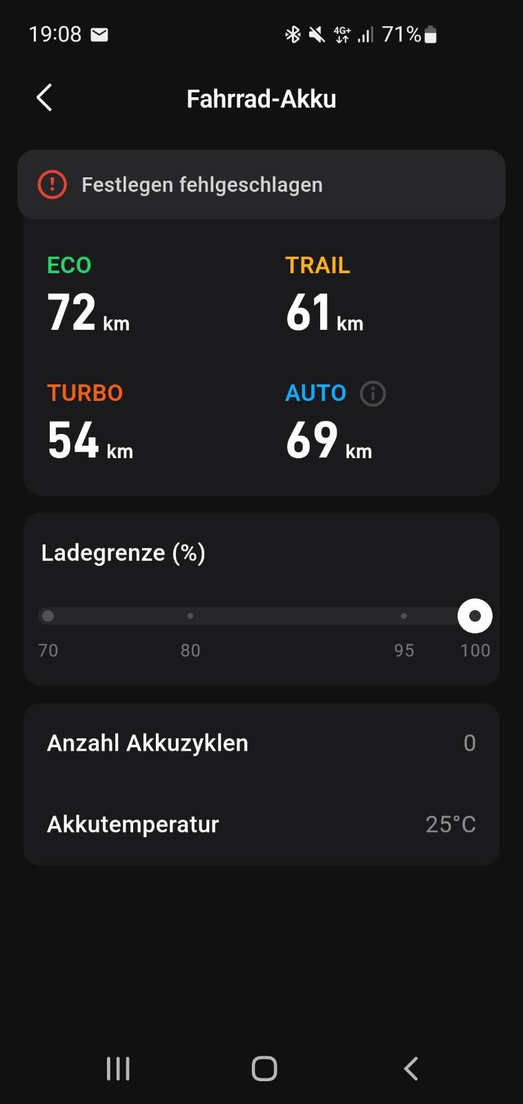

What could be the reason why the charging limit can't be set? When I try to set the charging limit, the message ""Festlegen fehlgeschlagen" appears, which means "Setting failed."
Some ideas?

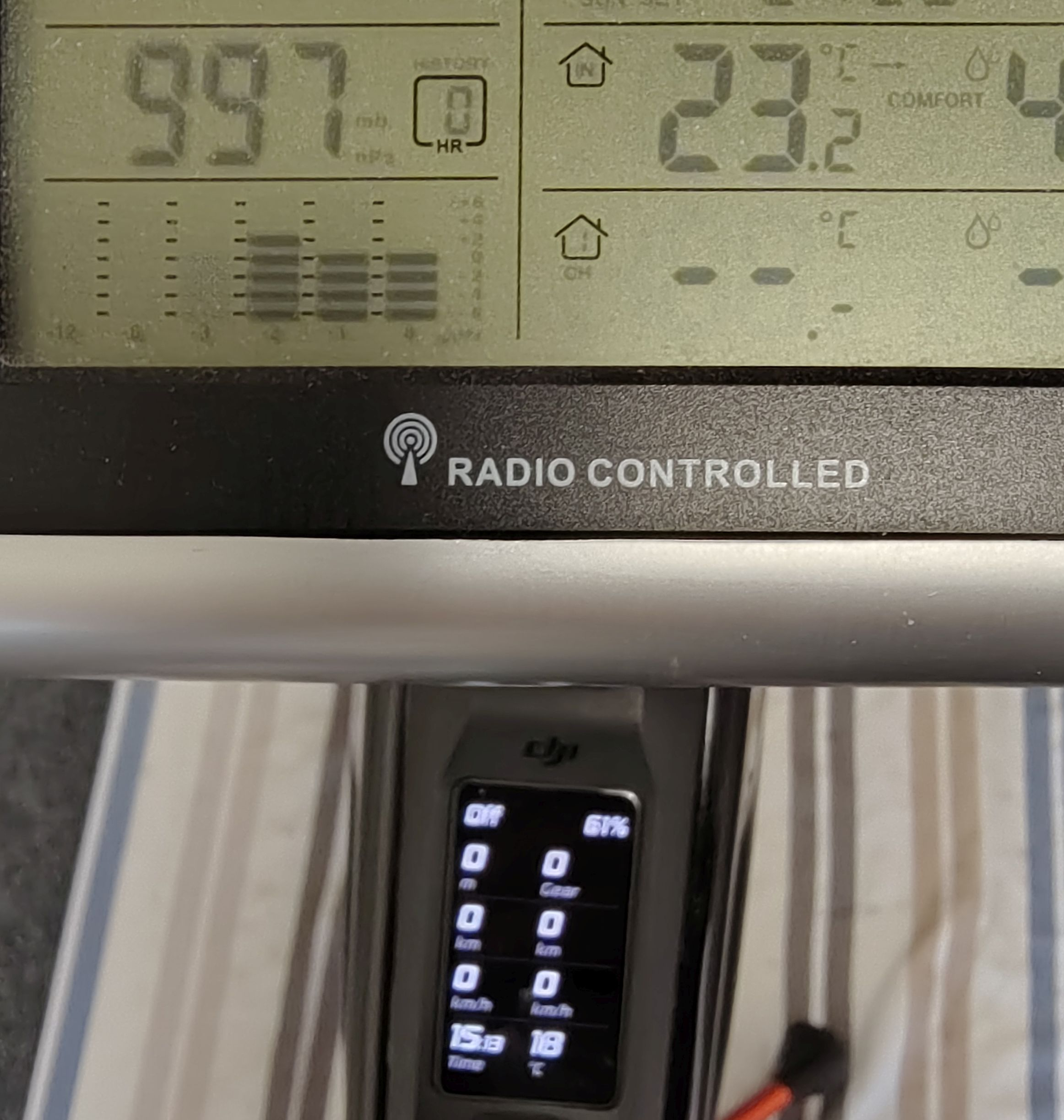

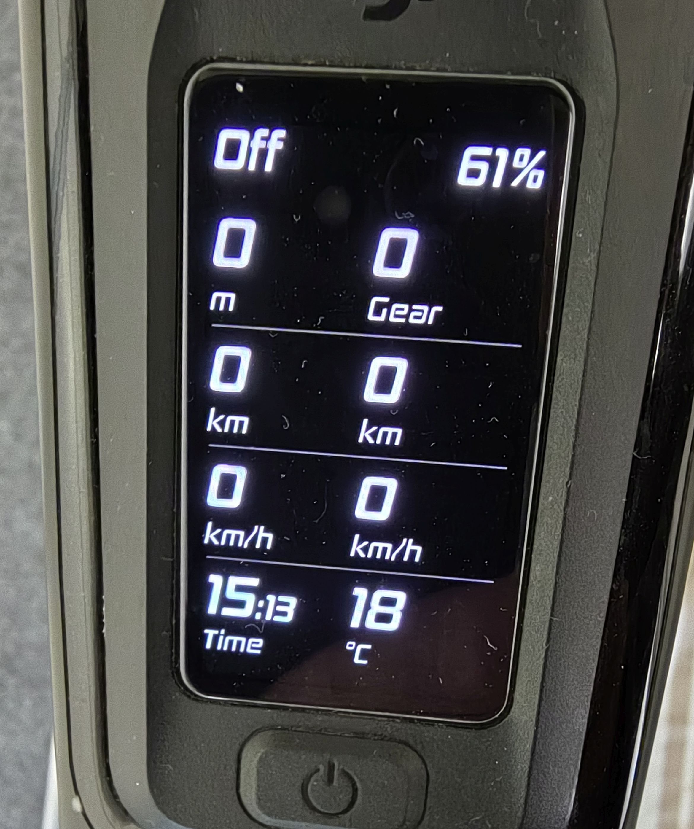

Thanks for your reply. I mean ambient temperature, of course. For example - bike stays at my home, for long time, ambient temperature is about 23 degrees (celsius). Same for a long time. And bike shows 18 degrees only, again, same for a long time. Difference is 5 degrees.. Outside on the trail is the difference usually more, around 8 degrees. Possibility to make a calibration would be highly appreciated...
View attachment 164435 View attachment 164436
Hi Thank you very much for your updates.
The environmental temperature data is measured and synchronized to the central control screen based on the Avinox wireless shifter MCU module. However, since the temperature measurement inside the shifter's MCU can have a certain degree of error, the displayed environmental temperature may also have some inaccuracy.
We understand your feeling and apologize for any inconvenience this may have caused you. We will continue to provide feedback to the relevant team in order to strive for optimization in this area in the future.
Thank you for your reply and explanation. My last post to this - if the difference to reality is 1-2 degrees, it is "inaccuracy". OK, this is not measurement device, but indicator only, so this error is acceptable. But - if the difference is 8 degrees (almost 30-50%), this is not "inaccuracy", but big disaster. In this case temperature measurement makes no sense..
Again - if there is a possibilty to calibrate the temperature sensor (set the current temperature), problem is solved...
maybe do one battery cycle first?
nope, cycle is @ 1 now --> still ""Setting failed.""
Have you powered the bike on before trying to set the limit?
You get a different message if you have done that.
i tried: with power on, power off, power on while charging, power off while charging --> ""Setting failed.""
@Amflow_Support any ideas why i can`t set charge limit?
Some ideas?
Thank you for your inquiry. We regret any inconvenience you may have experienced. We would like to confirm whether the firmware version of your bike has been updated to the latest version, which is as follows: Firmware Version: 00.12.05.07, App Version: 1.3.22. If you confirm that the firmware is up to date, please attempt to unpair the bike, then power off and restart the bike before re-pairing. Should the issue persist, please contact us via email at [email protected] for further assistance.

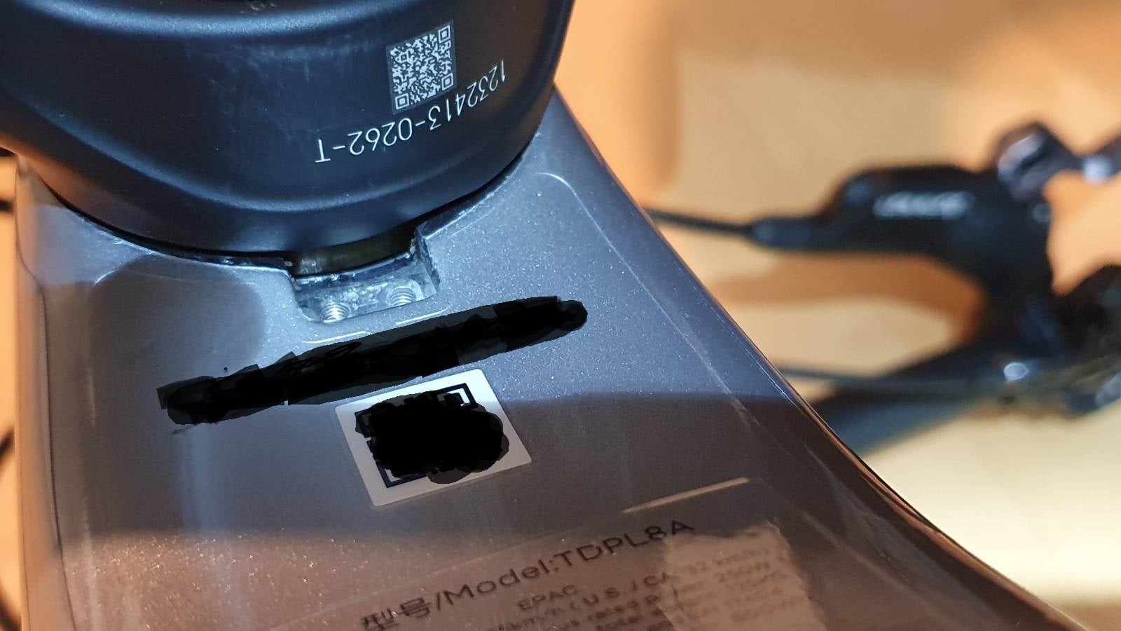

Hi there!
This is the location for installing the knock block. However, this component has not been released yet. Please rest assured that, based on our testing, this will not affect the frame's use or your riding experience.
got the latest firmware and everything is fine now, thanks!!
