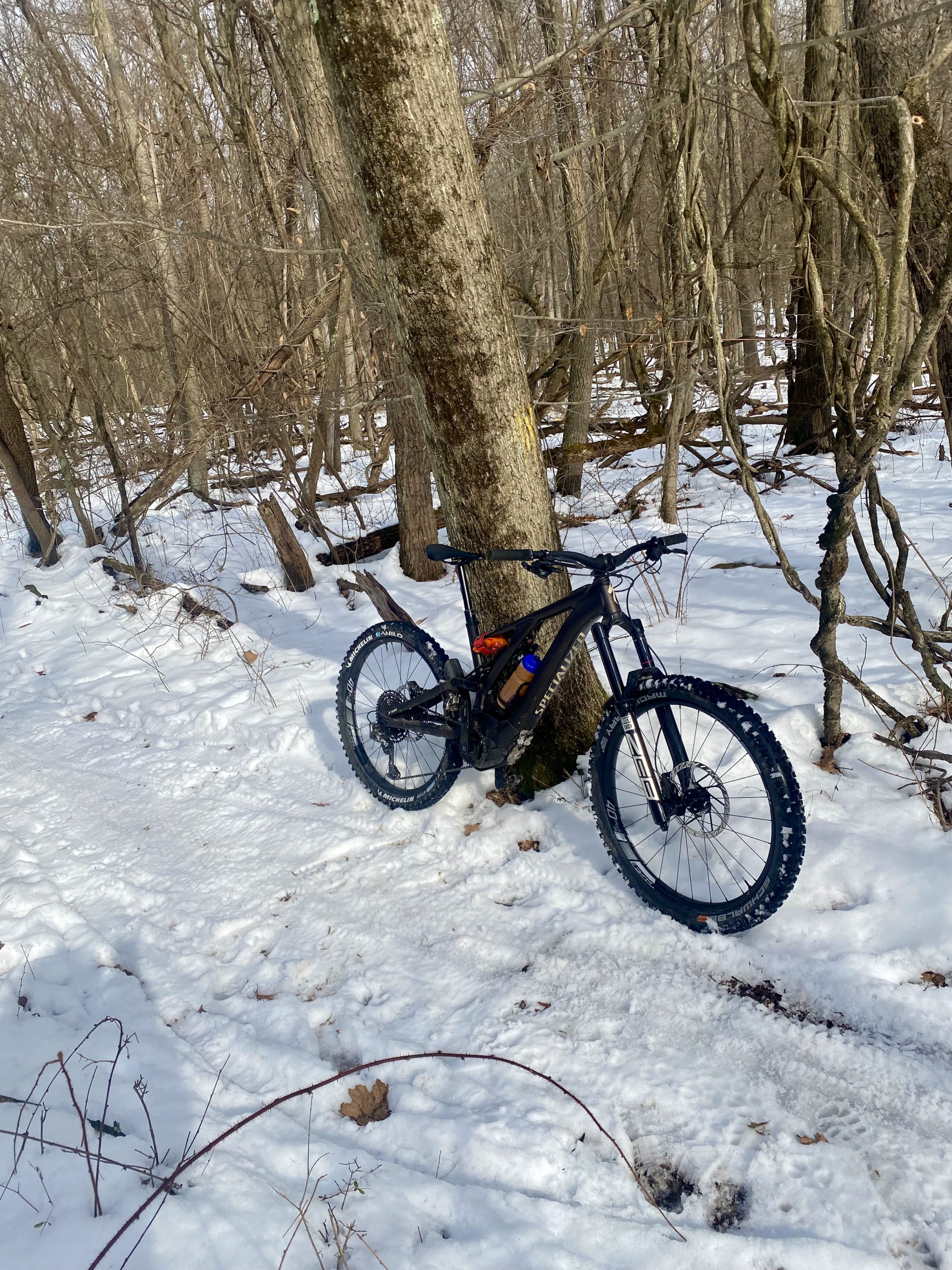

On the Kenevo full 29er build
To test concept has anyone put 29 lowers on the boxxer and just switched the wheels to 29
Seems like a cheap route to see if I woukd like the setup before Fox 38 /x2 etc ???
Yes works fine if you can find a set. I had to import them.

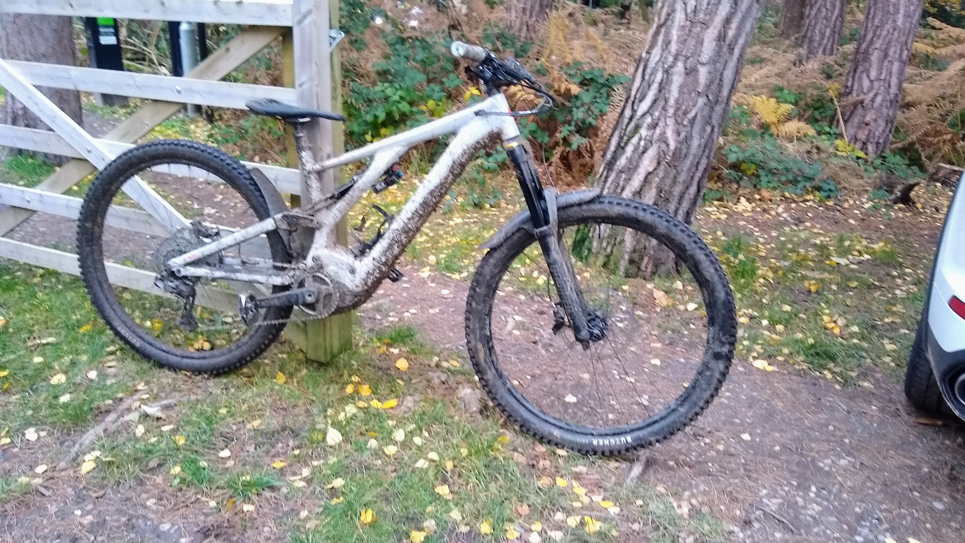

This is my offering so far..after going from a gen1 kenevo it’s very different. I might try a 29 rear wheel as it feels a bit wild like this. Anyone else tried ZEBs in their quest for the MX set up?

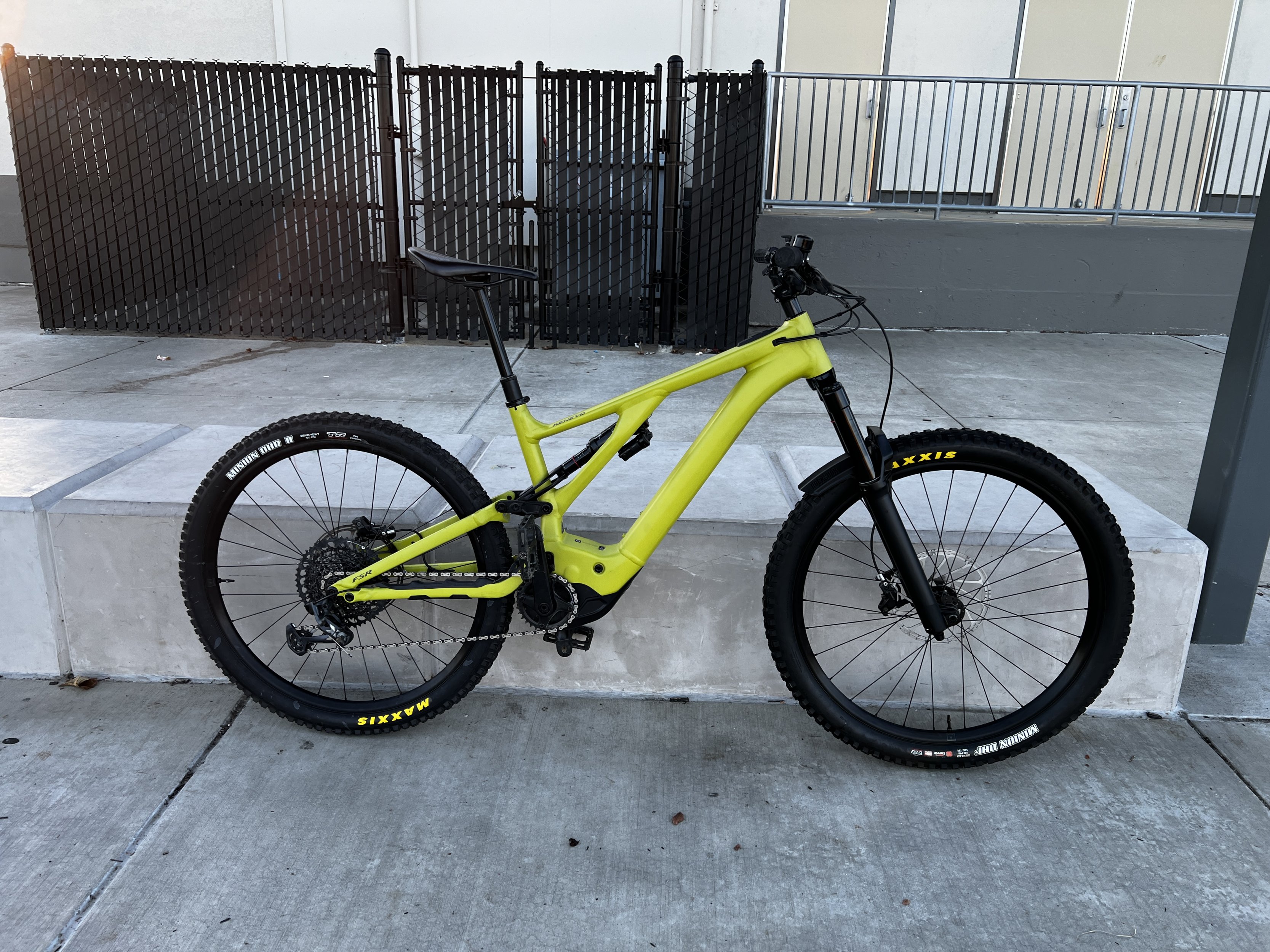

hello, after 2 years of good and loyal service, I finally upgraded my Kenevo to a full 29. A zeb 180 mm and 1 bos syors to glue all that to the ground. the bike rolls everything up, zero regrets... if perhaps not having done it sooner 😁
