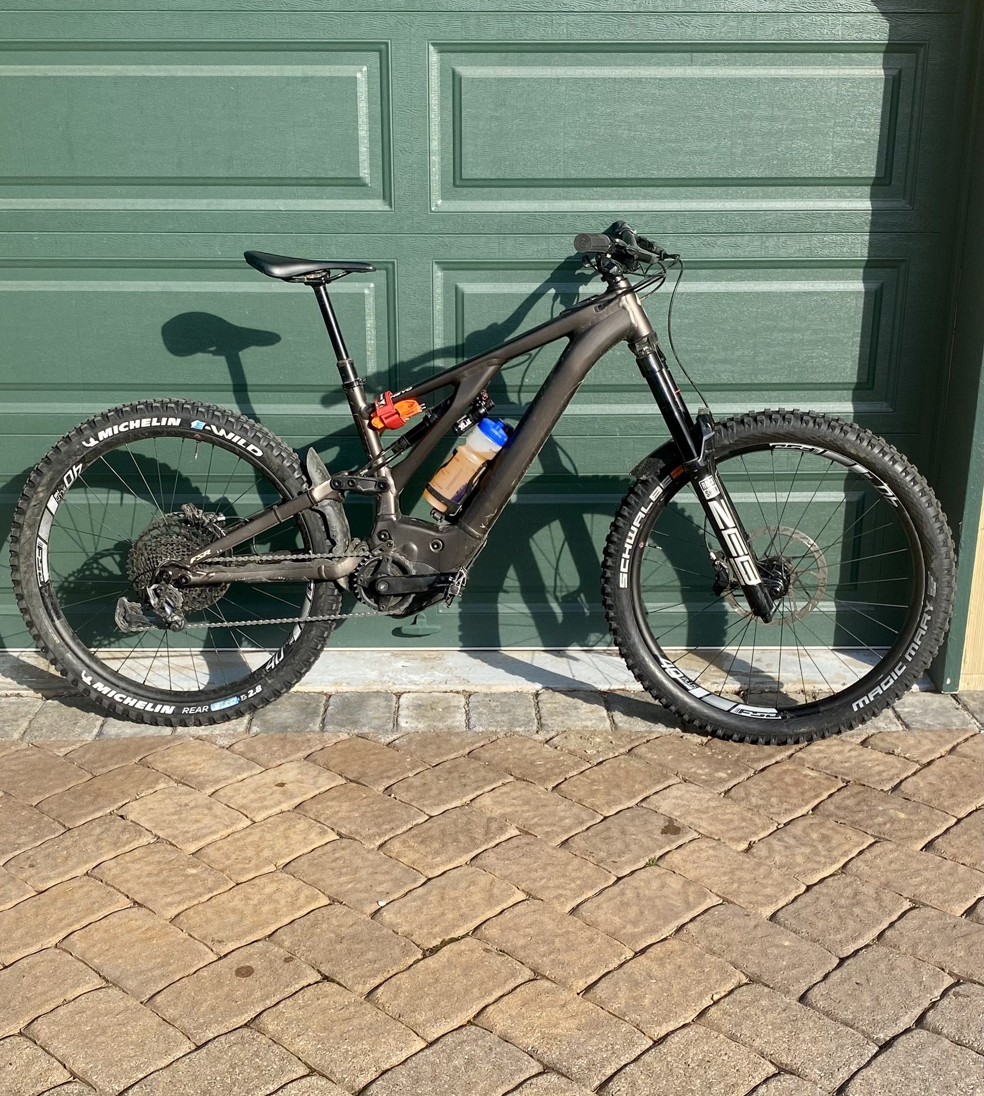

This is my full 29 in Finale

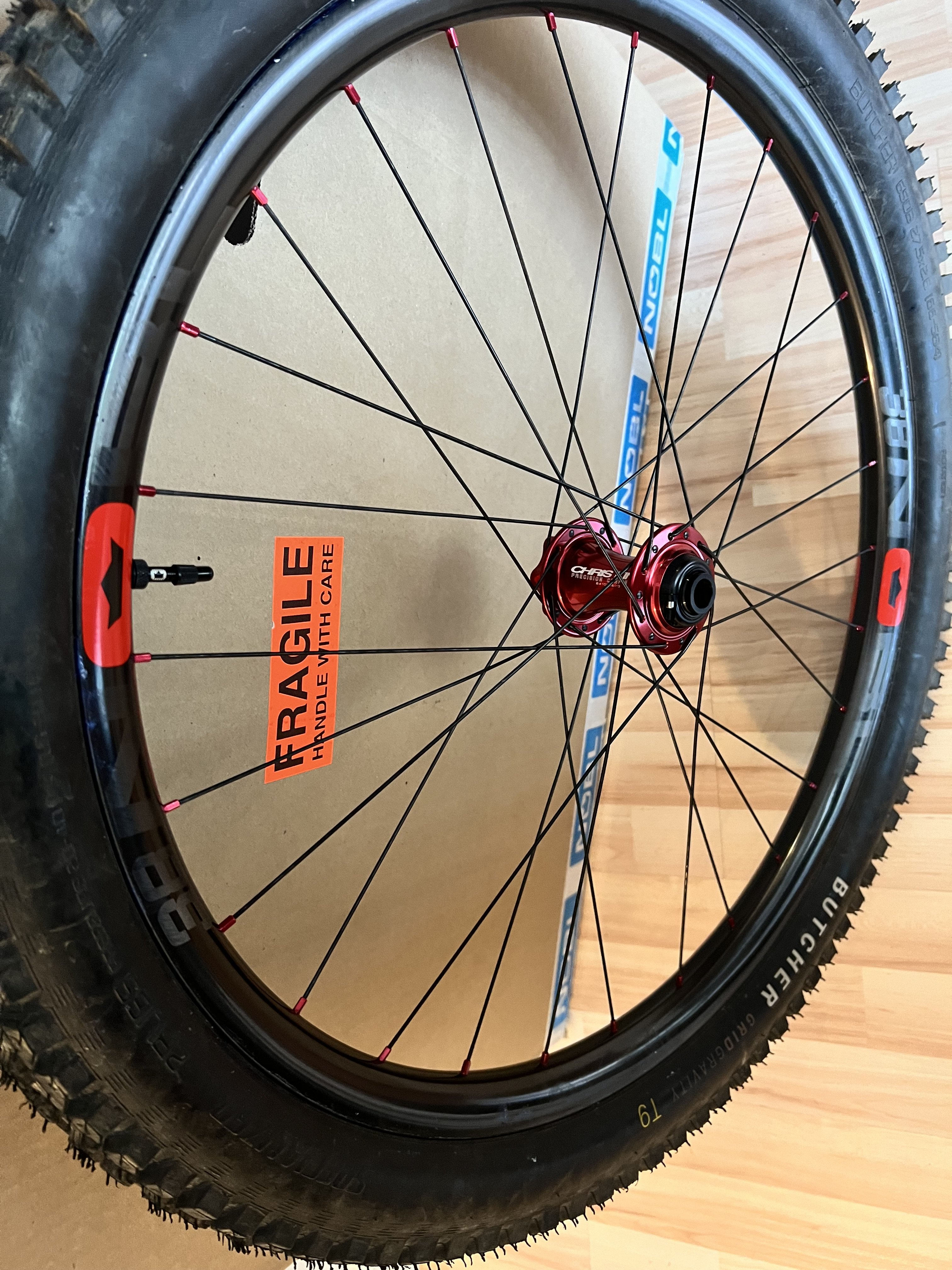

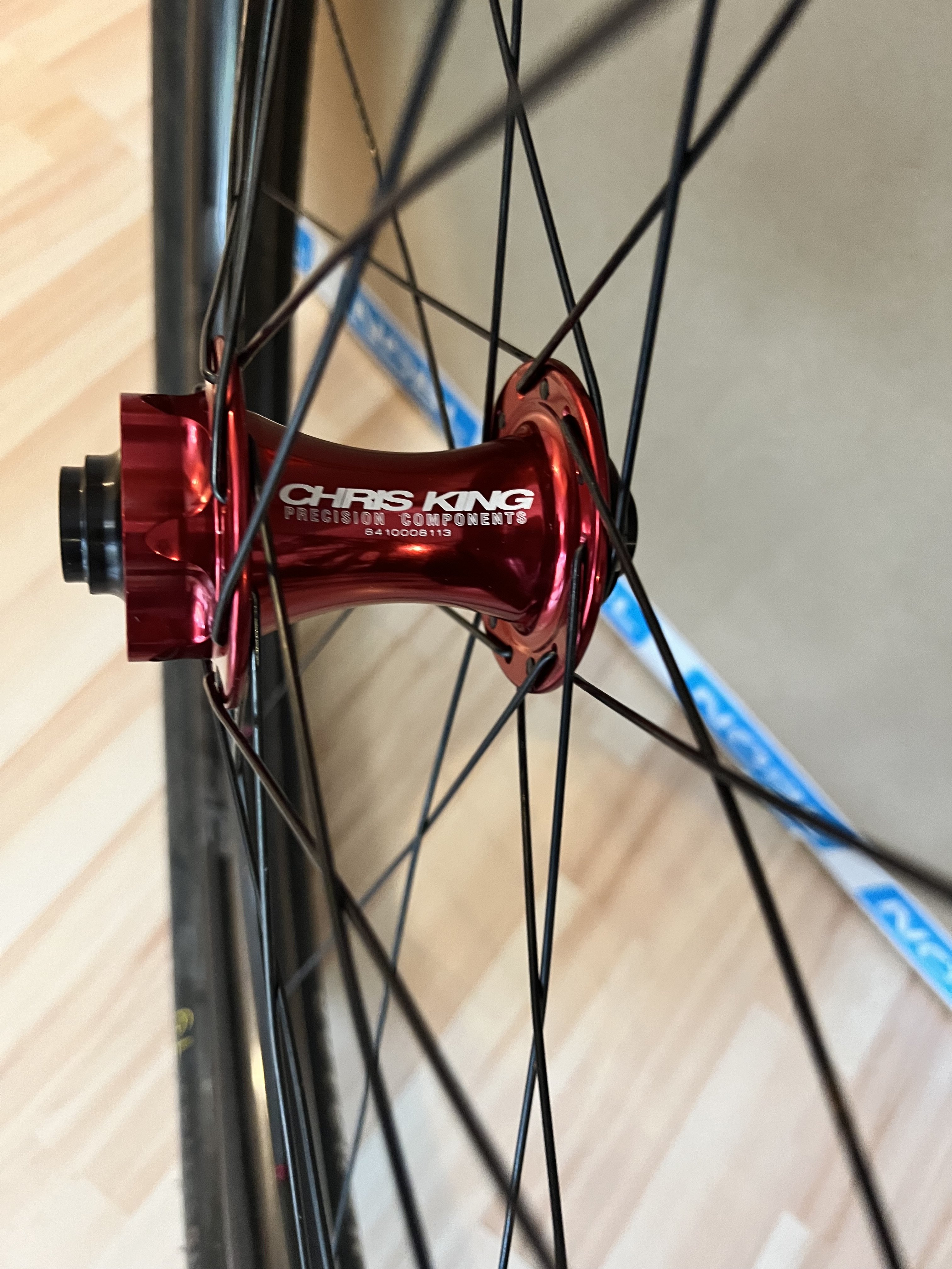

How is the lever pull on those, I tried a set and they felt kinda stiff. I also saw the a video by Dale Stone.
I find this to be a non-issue. The initial pull is harder, but I only notice it during a 'parking lot test'. After the initial pull, the lever moves more easily. When riding, I don't notice it at all.

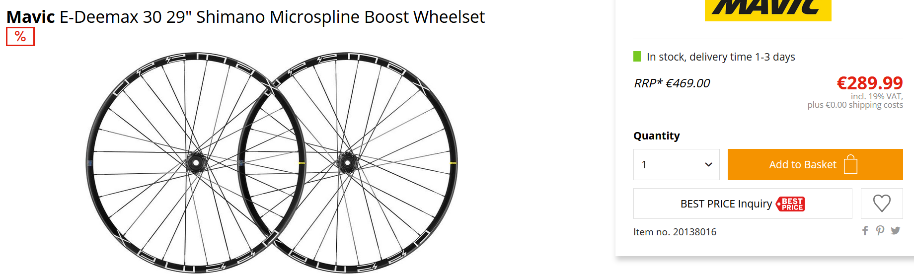

How about this mavic 29 wheels:

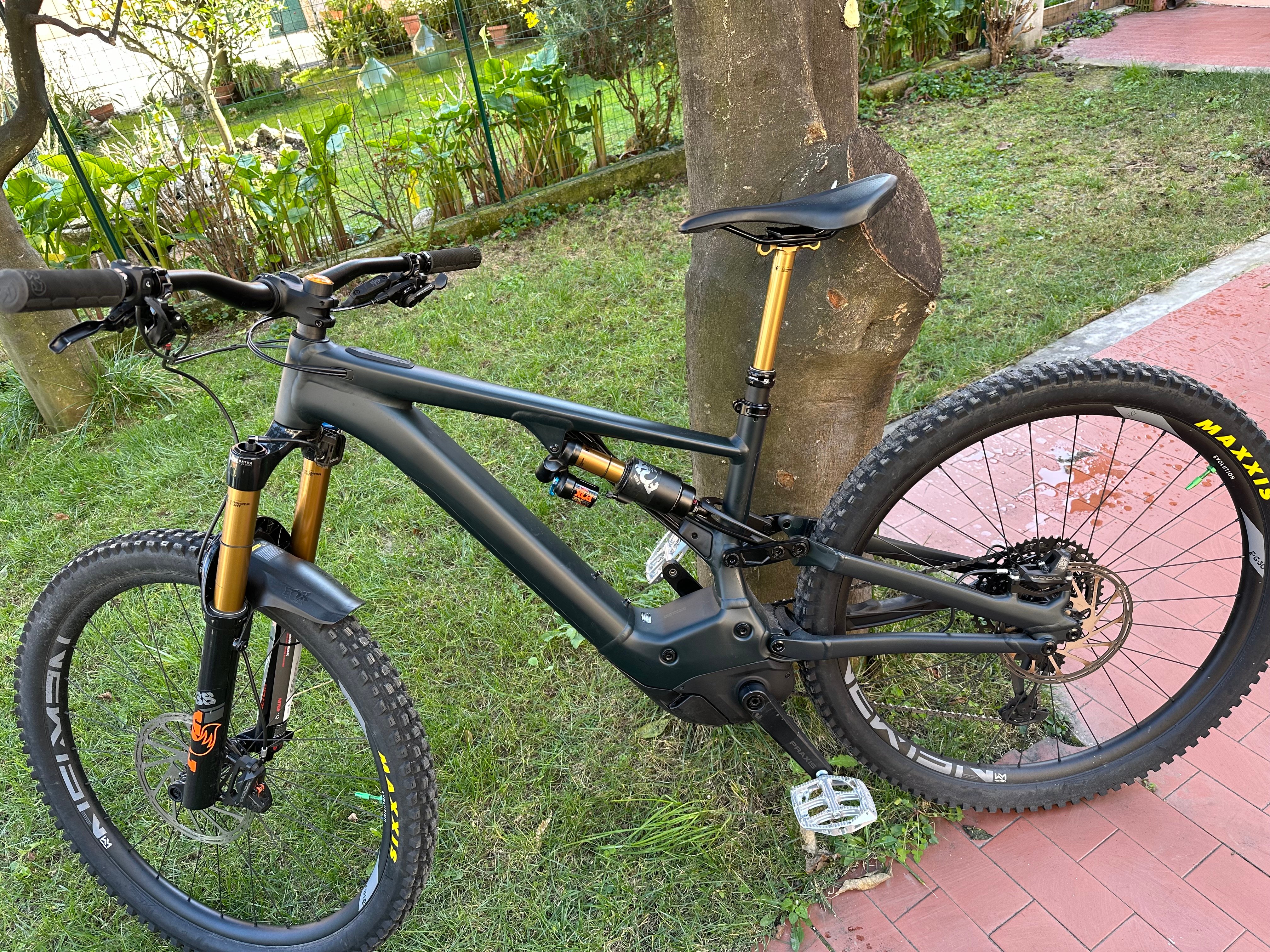

That front end looks way too high and slack and also the BB is to high, you want a 29er fork with a low axel to crown measurement, there’s a table with fork measurements further back in this thread.
For you?
For me it’s perfect and is an absolute ripper. Oh and it can’t be setup that bad - I’ve had a KOM and 6th overall at Degla on some of the DH / Jump lines in just the last week alone.

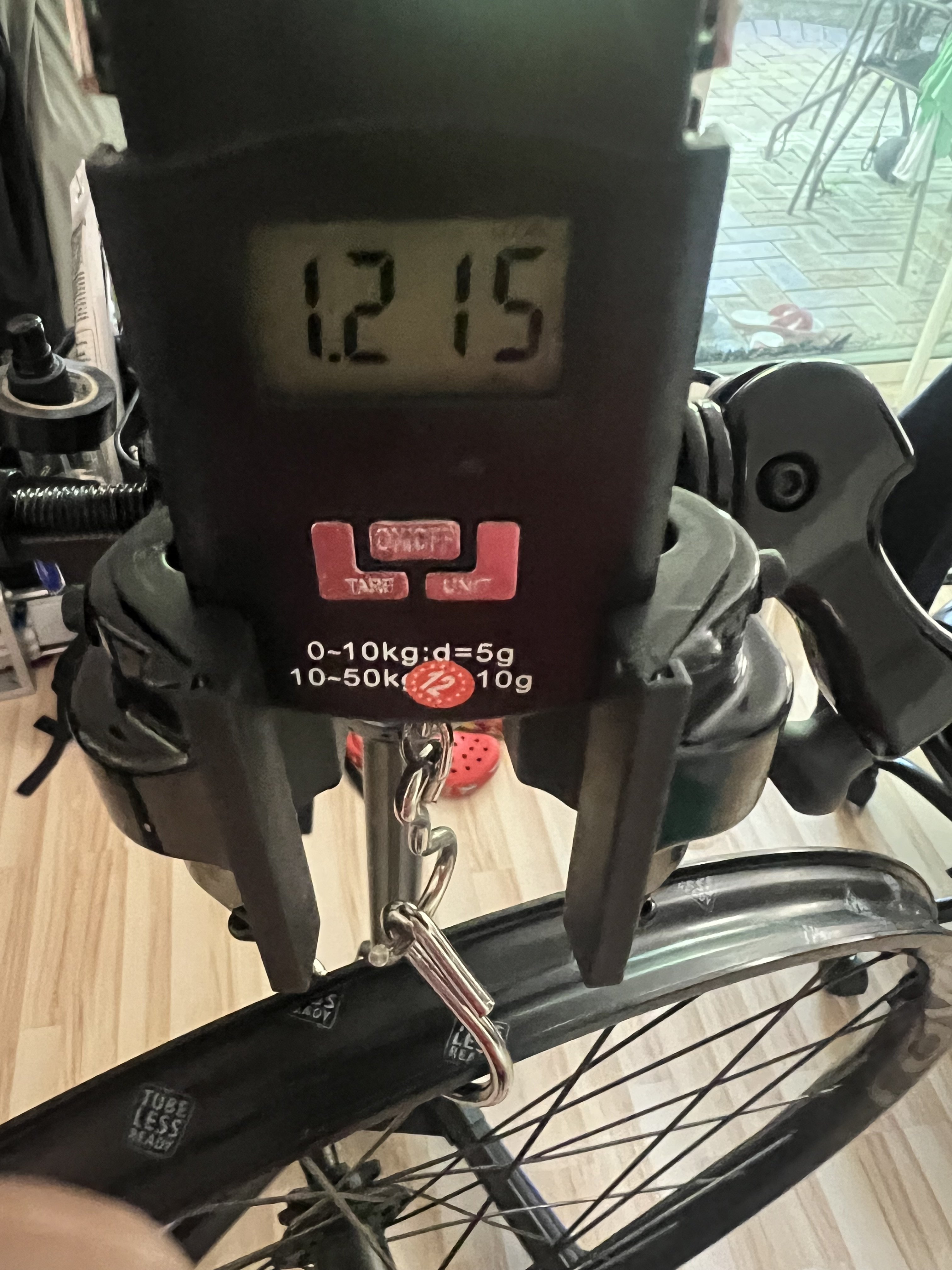

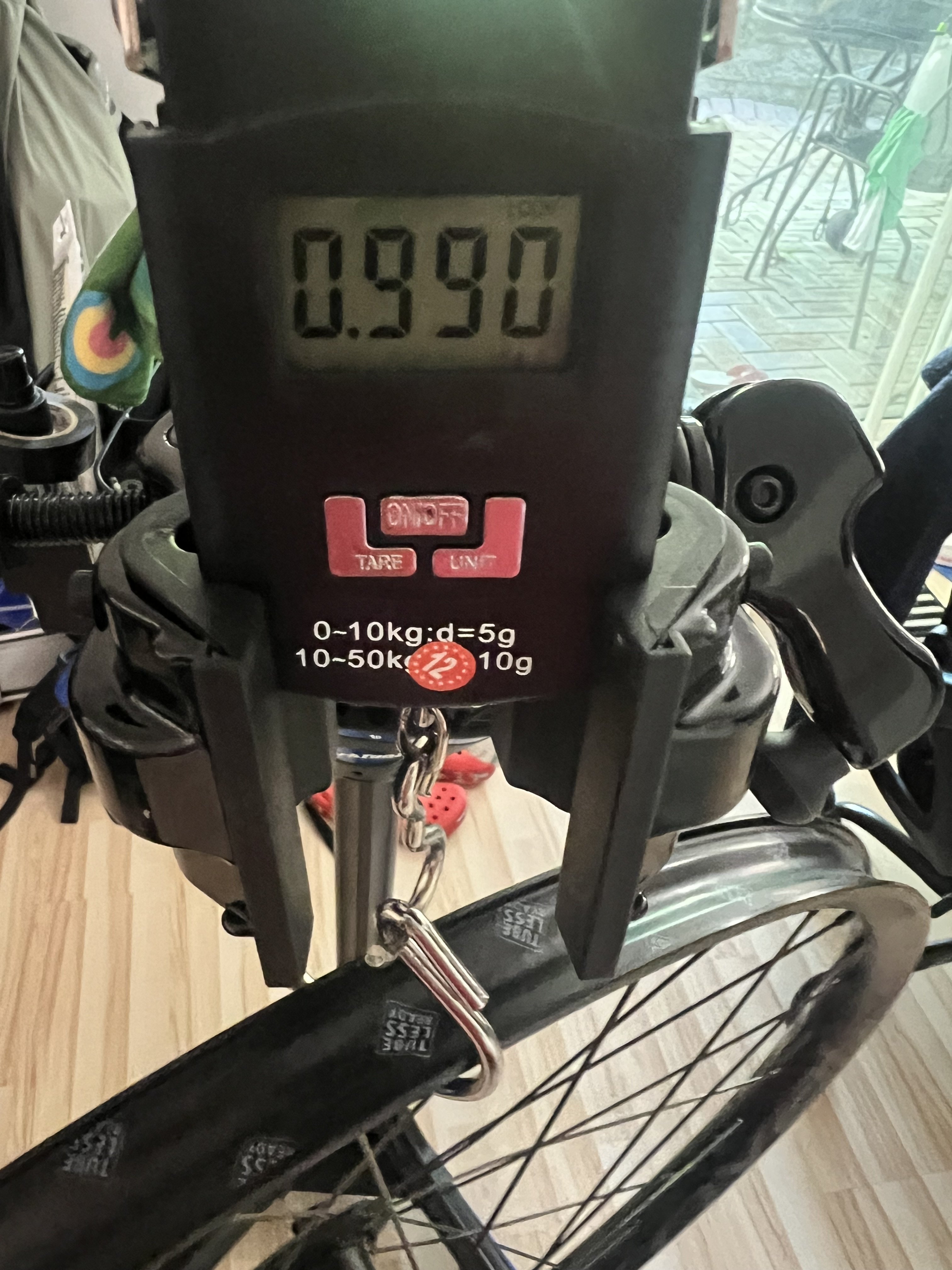

Does anyone have the weight of the Stock Roval 27.5 Wheels? I am thinking about the 29er upgrade on my beloved Kenevo. And a little bit of weight optimisation. I did buy it in 2019 and still love the bike. And i think this bike is worth an upgrade rather than buying a new one... since it is still a great bike.
i can weigh my set for you. just the wheels no tires.
That would bee great. Yes just the Wheels, no Tires, casette or breaks would be perfect. Thank you

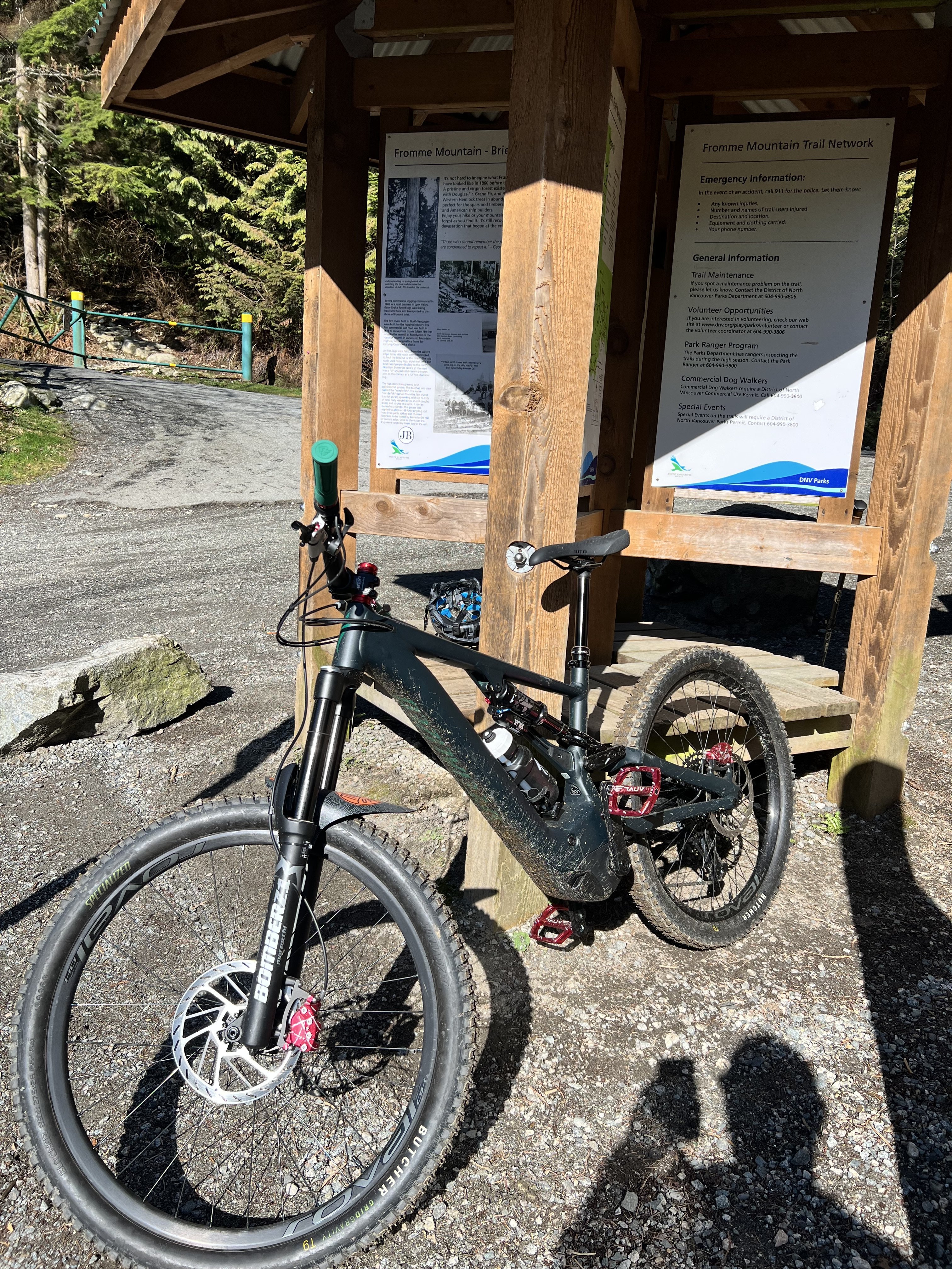

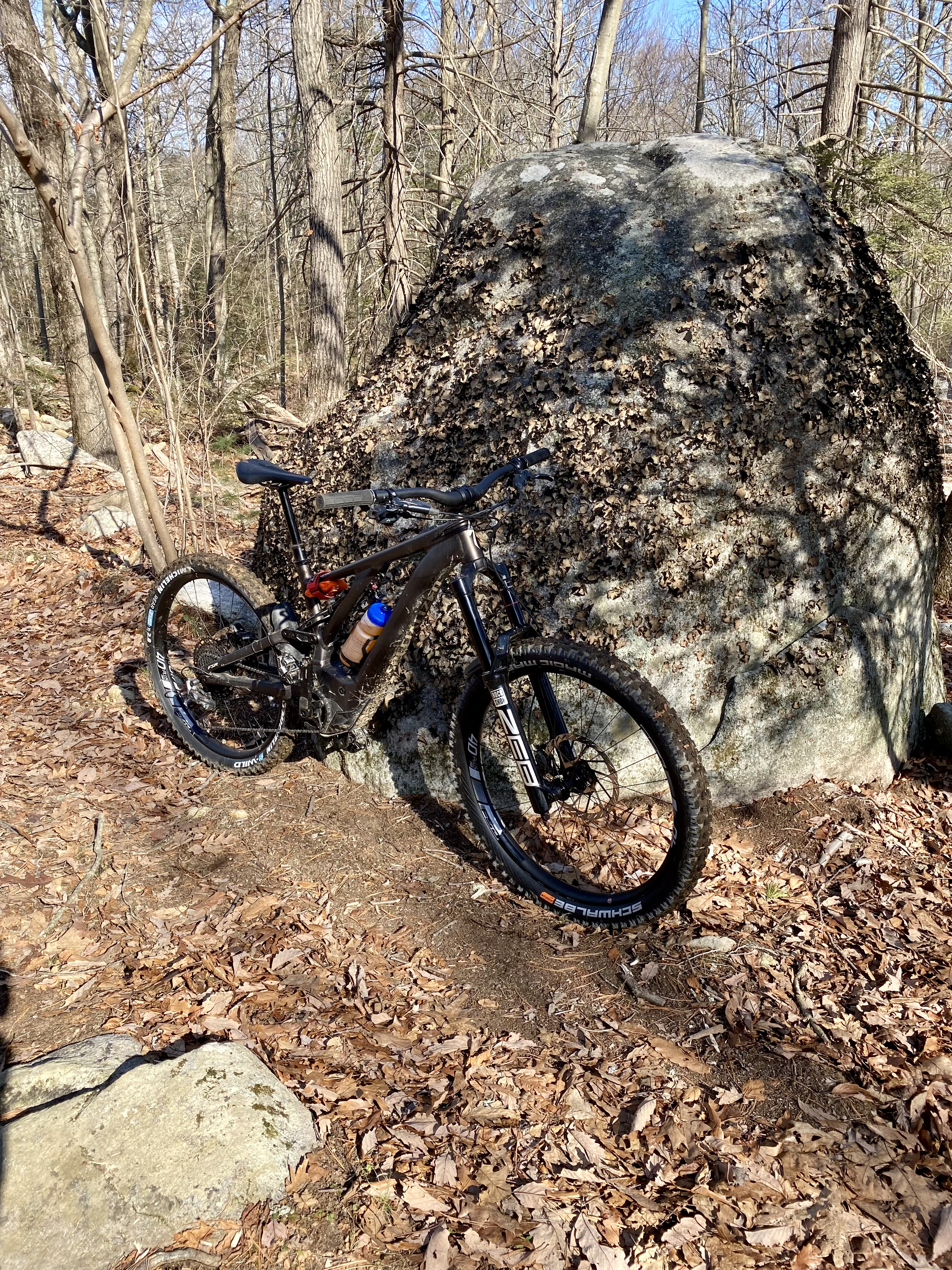

I've had this built for a while.. ever since I saw Rob's vid.. I love the longer chainstay on an S4 being 6' 3". The front end is so low on the bike.. that would be my only complaint.. Running 50mm bars with about 2 in of spacers.
I'm running either a Fox 40 @203 or a Zeb @ 170 depending what I'm riding. I'm probably gonna put a 190 in the 40. I was running a dorado.. A lot easier to change the travel but that upper weight is hard to get used too. (All the weight is at the top of the fork.. The 40 feels way stiffer and the weight is lower.
Zeb
2.4 rear 2.5 front chip in high = 61.8 HA
Fox 40
Same above = 61.5 HA
EXT E-Storia Rear Shock
I would like to get the HA to around 63.5-64 for normal riding.. Seems like me only only is to swap the tires. I put 1/4 block under my rear tire.. gained almost 1 degree. That's about the difference from the 2.5 and 2.4 I'm running.. (Assegai 2.5 and DHR 2.4)
