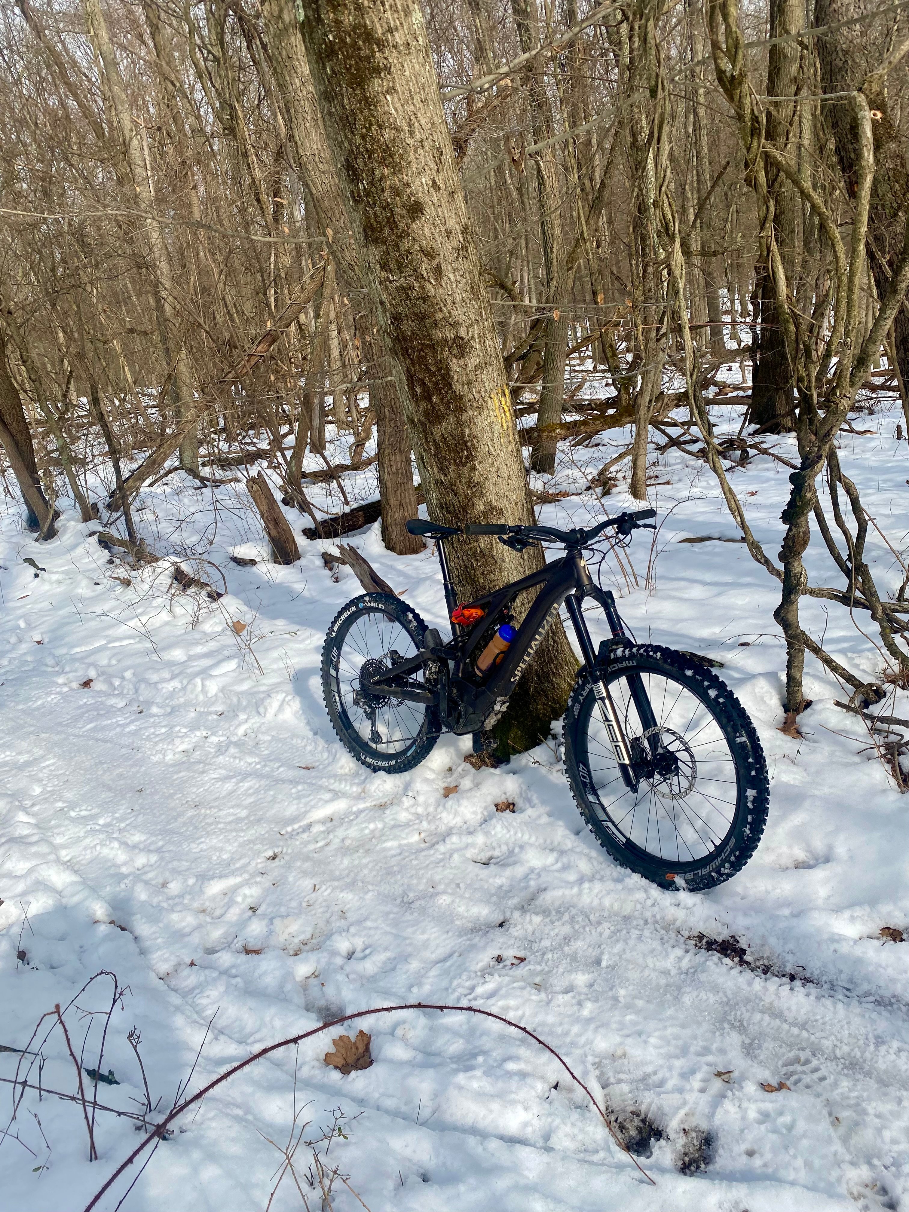

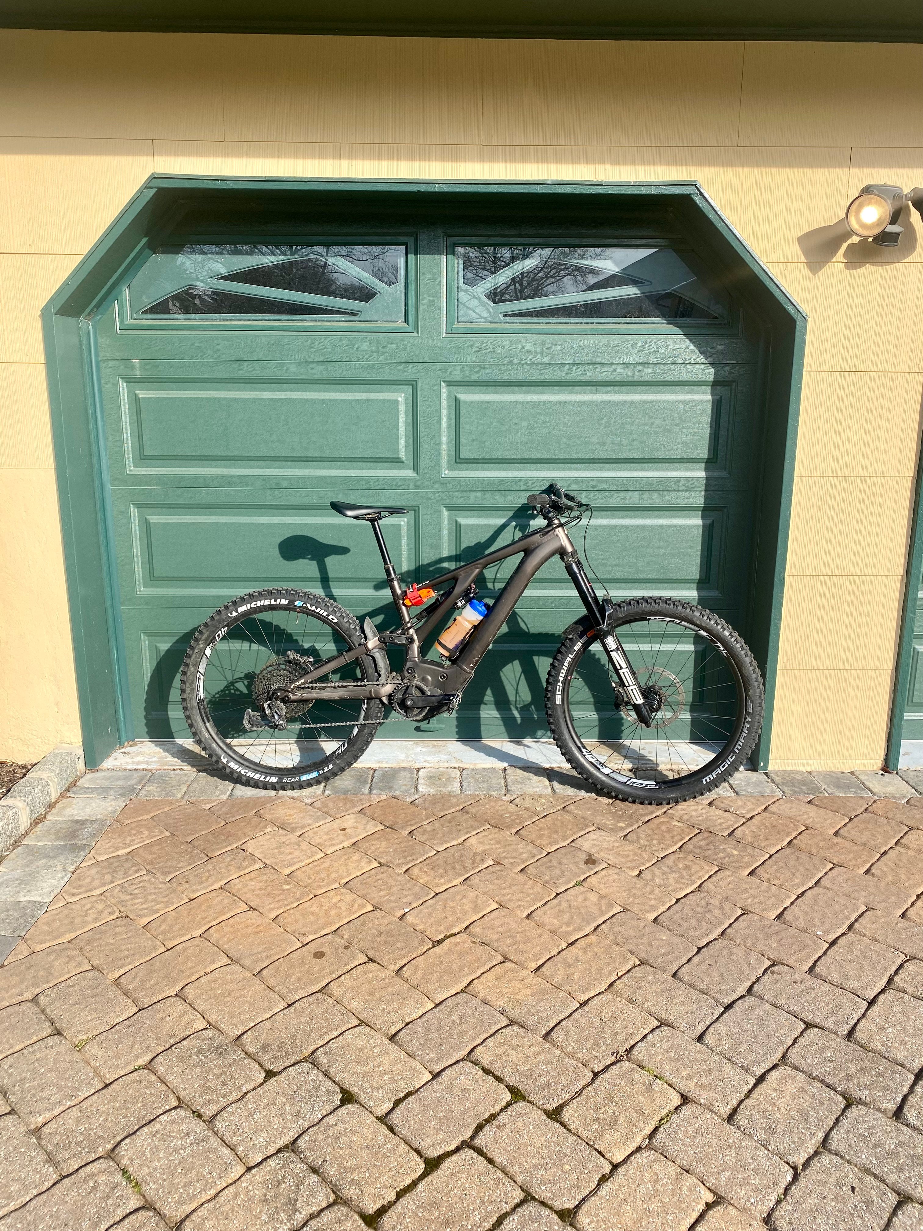

I've had this built for a while.. ever since I saw Rob's vid.. I love the longer chainstay on an S4 being 6' 3". The front end is so low on the bike.. that would be my only complaint.. Running 50mm bars with about 2 in of spacers.
I'm running either a Fox 40 @203 or a Zeb @ 170 depending what I'm riding. I'm probably gonna put a 190 in the 40. I was running a dorado.. A lot easier to change the travel but that upper weight is hard to get used too. (All the weight is at the top of the fork.. The 40 feels way stiffer and the weight is lower.
Zeb
2.4 rear 2.5 front chip in high = 61.8 HA
Fox 40
Same above = 61.5 HA
EXT E-Storia Rear Shock
I would like to get the HA to around 63.5-64 for normal riding.. Seems like me only only is to swap the tires. I put 1/4 block under my rear tire.. gained almost 1 degree. That's about the difference from the 2.5 and 2.4 I'm running.. (Assegai 2.5 and DHR 2.4)

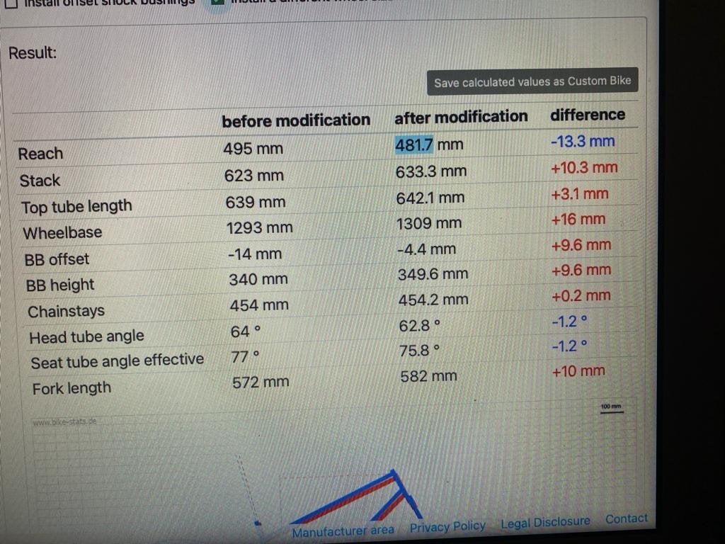

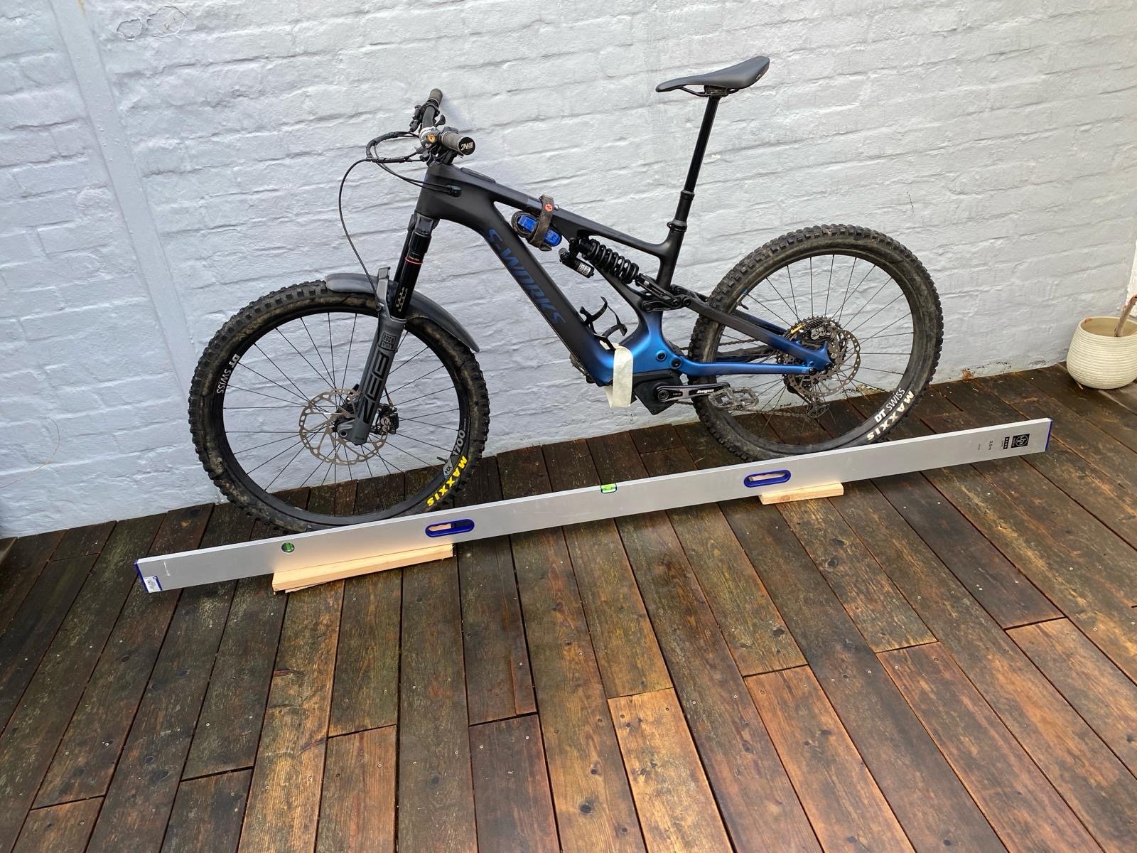

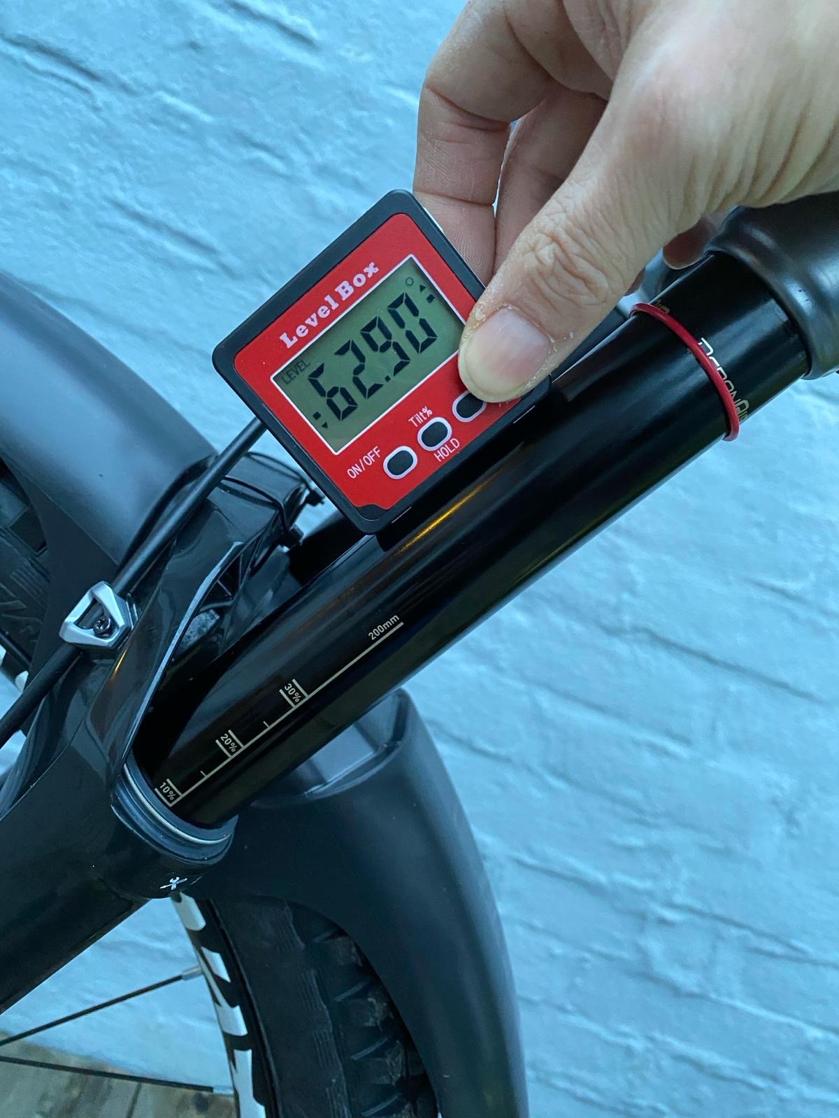

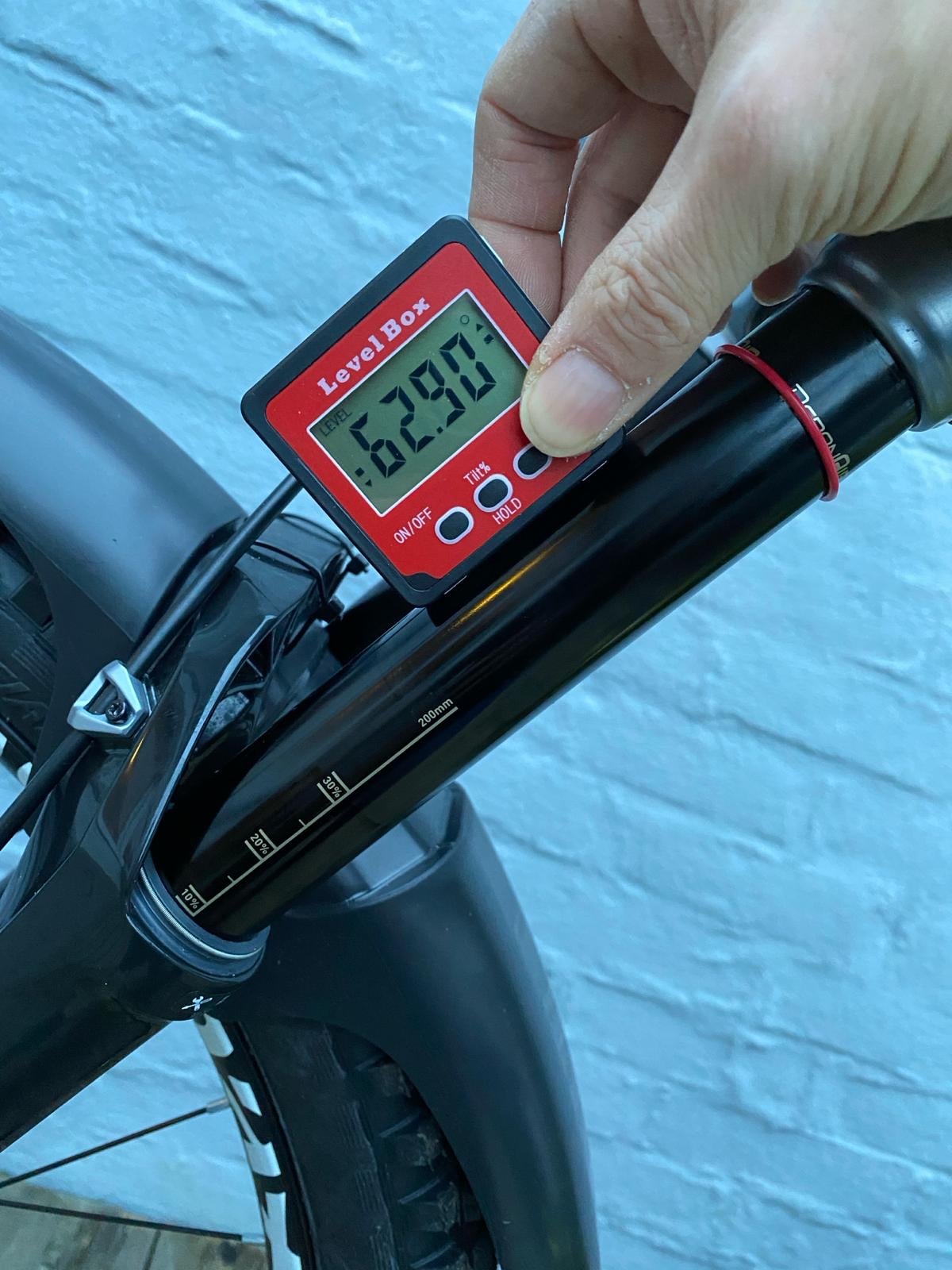

Messured my HTA with the Bike in scale with 62.8 degree.
Picture shows my Levo with the same method.
I did. I was wrong, my tool said 62.9
Calculator said 62.8

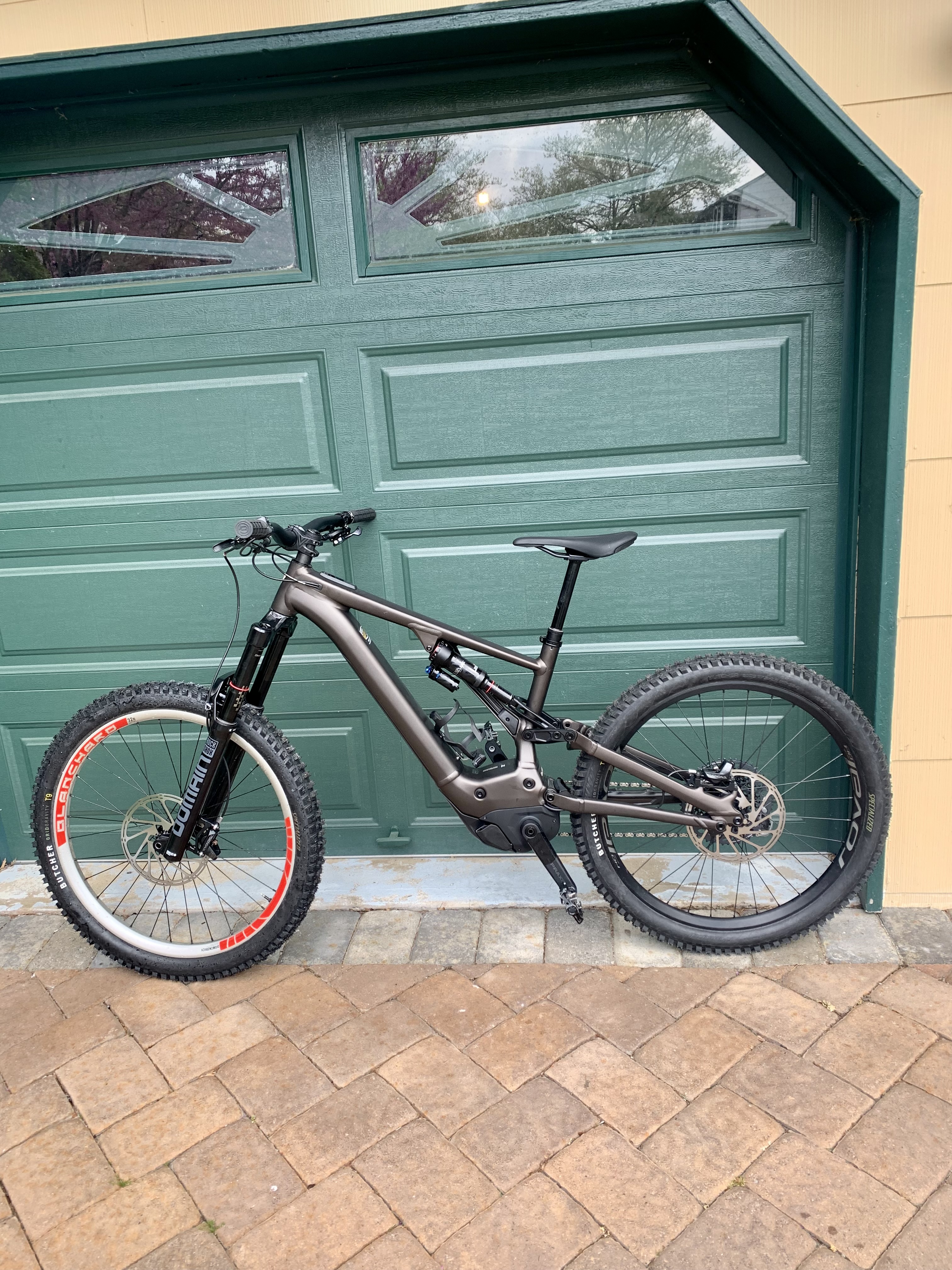

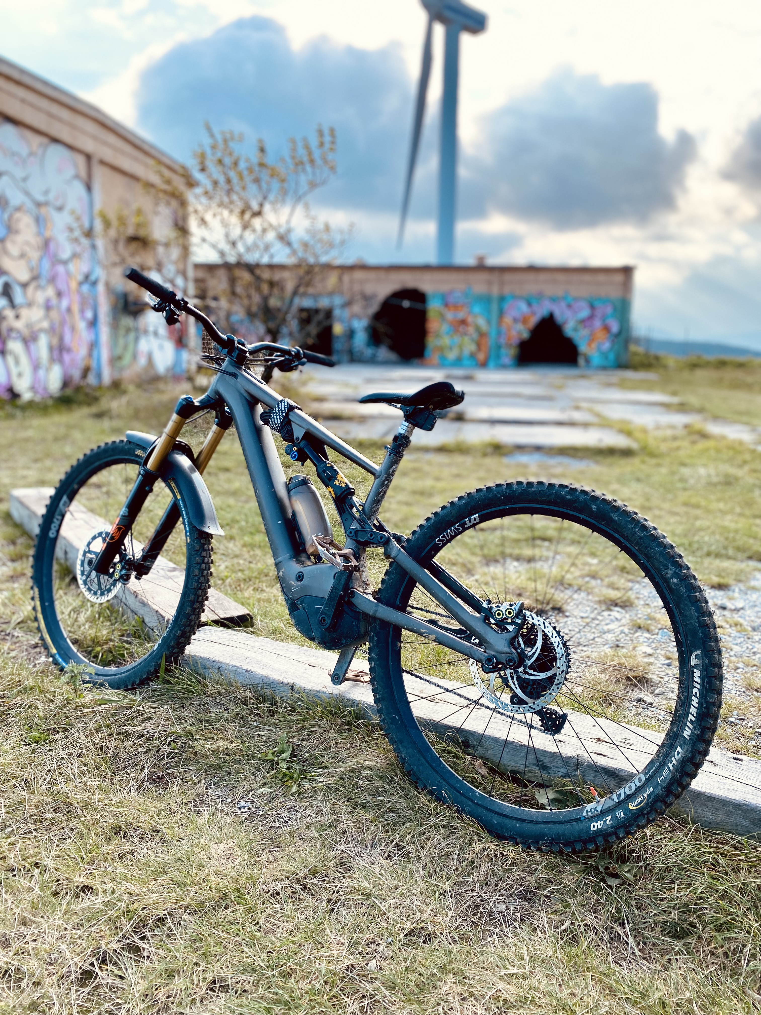

Your spread sheet does not take into account the 29er wheel size difference over the 27.5 rear wheel that is required with a mullet. The difference in the ground to axle of a 29er wheel to 27.5 wheel is 15 ish mm depending on tire size. That hight increase is a real number that head angle make no difference in. Here is my Kenevo with a 180mm Domain 29er with a 27.5 wheel. See how choppered out it is? That’s with wheels of the same size…. Also, fyi single crown forks have higher axle to headset numbers than duel forks because the single crown have to be thicker, a 180mm 29er Zeb is 596mm. This also adds hight to the front of the bike.
Nope.

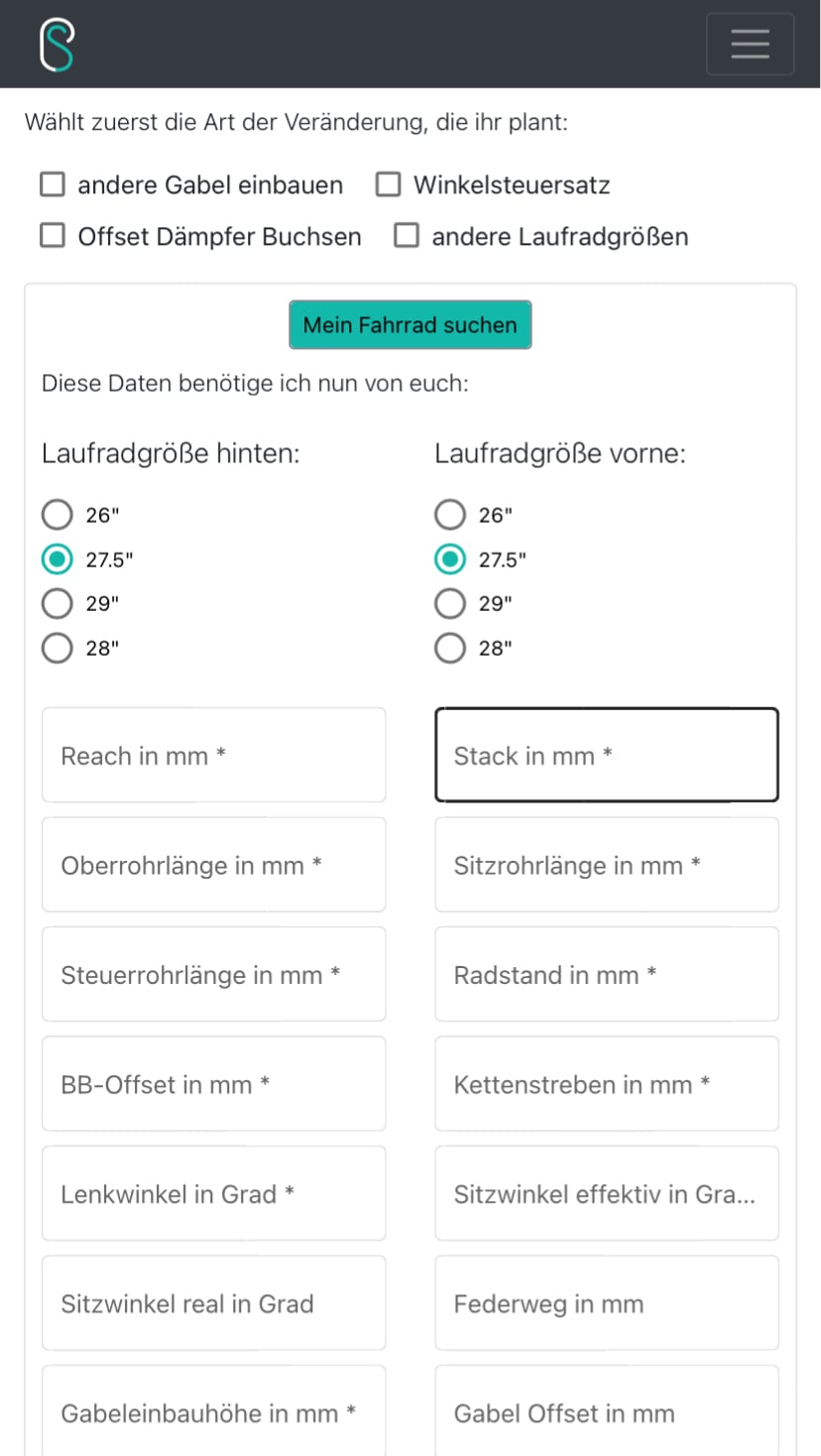

It does. Its German, but I can change wheel size (front, rear), I can change fork, can ad offset bushings etc.
The Boxxer has 602 atc @ 200mm. So, it has 582 with 180mm @ 29
Zeb has 586 with 170mm @ 29
This can also be changed in the tool.
Face palm….. I was replying to the guy that wants to run a fox 38 180mm mullet…. Your numbers are off for that.
Whats the a2c of that fork?
Around 596mm…. Stock is 572mm, and the ground to axle difference from 27.5-29er is around 15mm. You want to know it feels? Take a 2x4, lay it flat and put your front wheel on it. The wheel fork combo jacks the front up about 1.5 /1.7 inches depending on tires. The difference is less if you go full 29 or run a 170mm fork with the 29er.

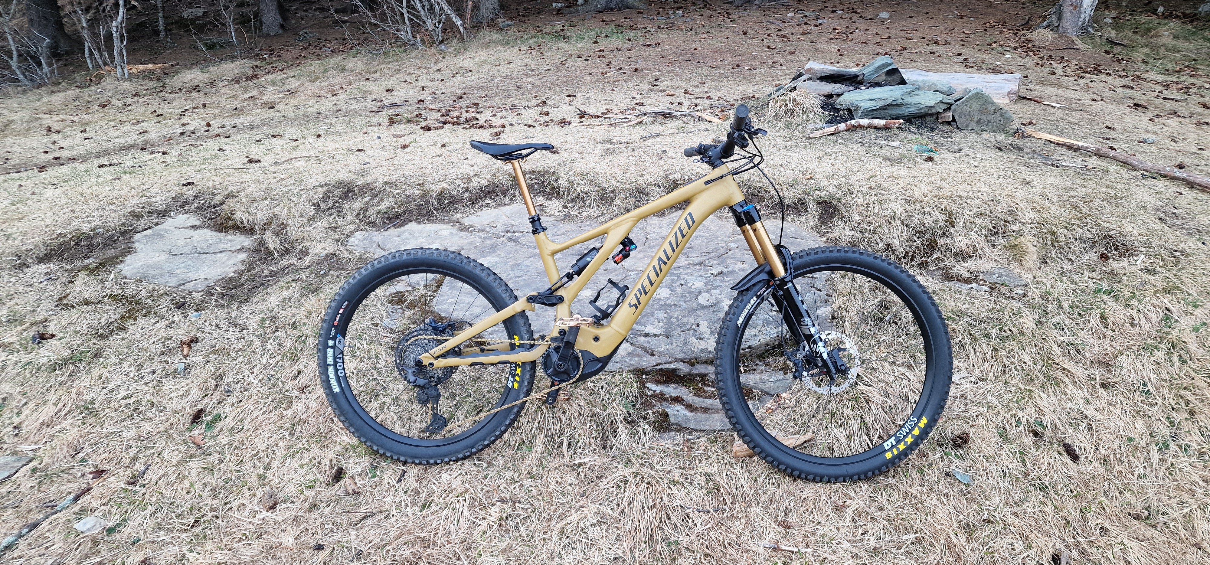

2021 Kenevo S4, I am 6 feet tall (183)
I did the 29er And mullet, went back to 27.5
neither were preferred
Mullet: My Kenevo front end wondered all over the enduro trails in the high or low setting, while climbing the front end lifted very easy.
29er: My Kenevo was ”OK” in low, bad in high setting, felt like my Kenevo was a S5 and wheelbase was extended I believe around 40 or so millimeters (The Titanic)

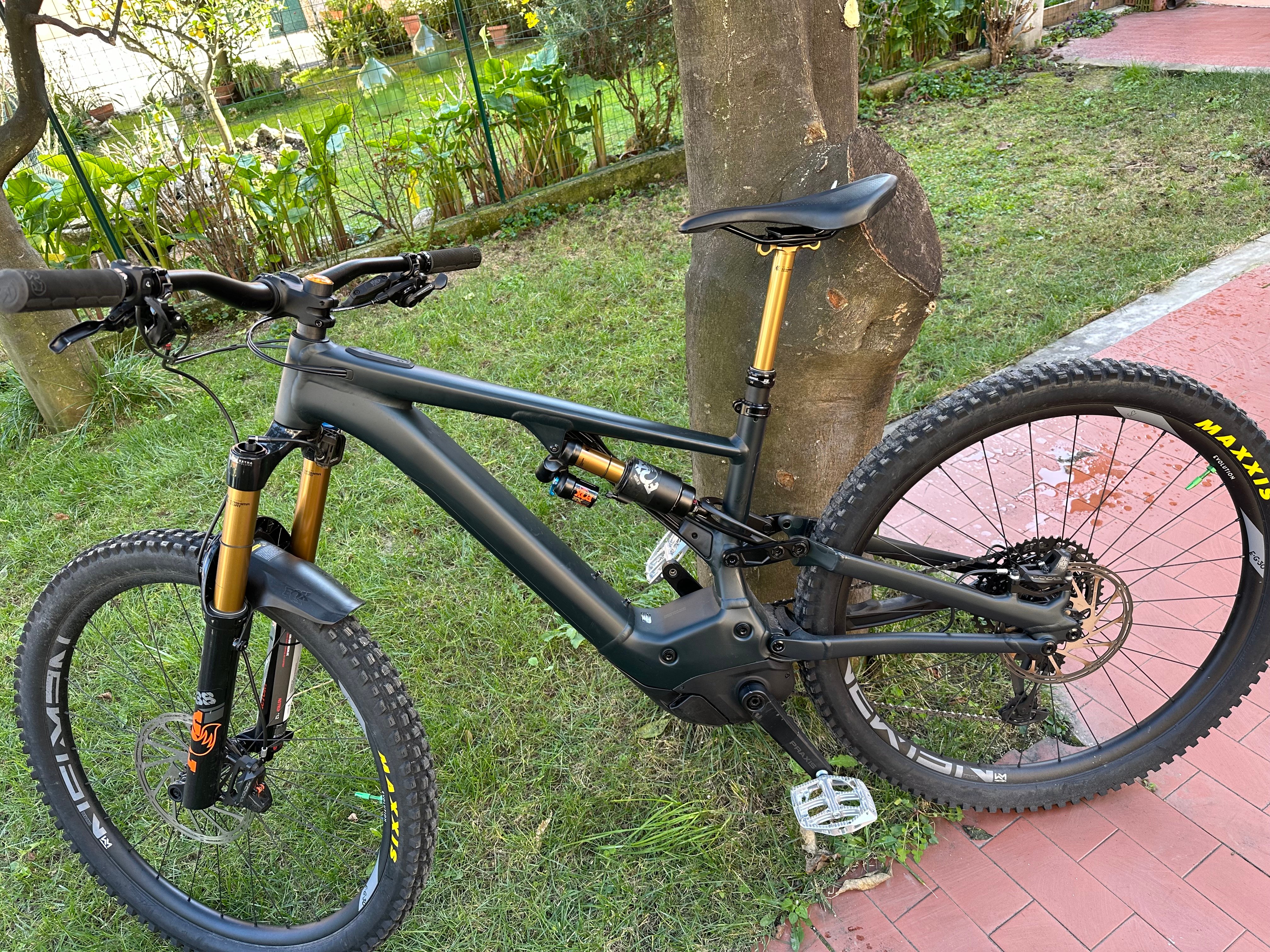

Hi all, my first post on this board 👋
Got a 2021 kenevo since Jan 2021. Second motor, but otherwise had no issues other than 10 or so broken battery rockguards. I ride mostly technical (hiking) trails here in central Switzerland. Always had issues with pedal strikes and the rock guard.
So went first with mullet about 2-3 years ago and then full 29er shortly after. Rides superb 😎 also ran a coil for a while but put metal to metal way too often on even smaller jumps...
170mm Fox 38 and
230x65mm öhlins ttx2 air with a few tokens (1+2)
S3 at 1m77 / 5'10
Nothing stock anymore on this bike aside the frame - even managed to bend one crank 🫣 still running 1x11 though
Nice bike @ Nato base. How did you fit the fidlock bottle? I have tried this a couple months ago but there was not enough space.
Yeah I checked those before but shipping cost to Switzerland turned me down. Same thing with the sicomb fenders.. But now on 29er these things are no longer an issue.
Regarding Fidlock, if I remember correctly I simply put a 2-3mm spacer beneath at the lower mount point (eg from a tube valve)
