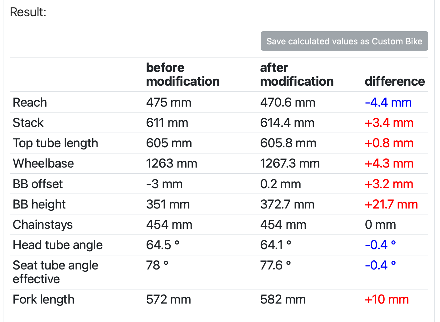

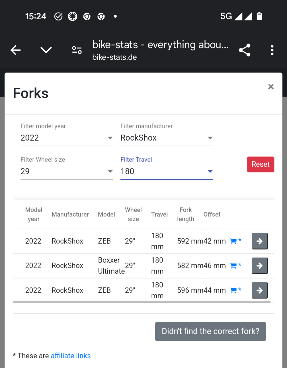

@peterpeterson I saw this and tried using it but have one question. How would I calculate the new fork length? I adding the 29 lowers how much longer would my fork length get?
Honestly - do not know how to calculate, but
I would simply use data for similar fork.
Using the Boxxer Ultimate 180mm travel this is what it came up with
For me quite promising output...
I am 182 cm and ride on S3.
As i recall, data are for high setup at damper bushing.
High riser bar (50) and ca. 35 mm of spacers under the stem, as Kenevo has rather low stack (for me)

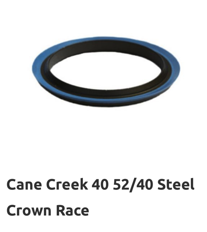

I wanted to convert my Kenevo Expert to Mullet, but I can't get the headset tight.
I installed a Fox 38 instead of the RockShox Boxxer. If I tighten the ahead cap, I can either no longer move the fork properly or the headset is loose.
Do I need a new headset for the conversion? Or do you have any ideas why this might be?
Which crown race have you used? This one should fit.

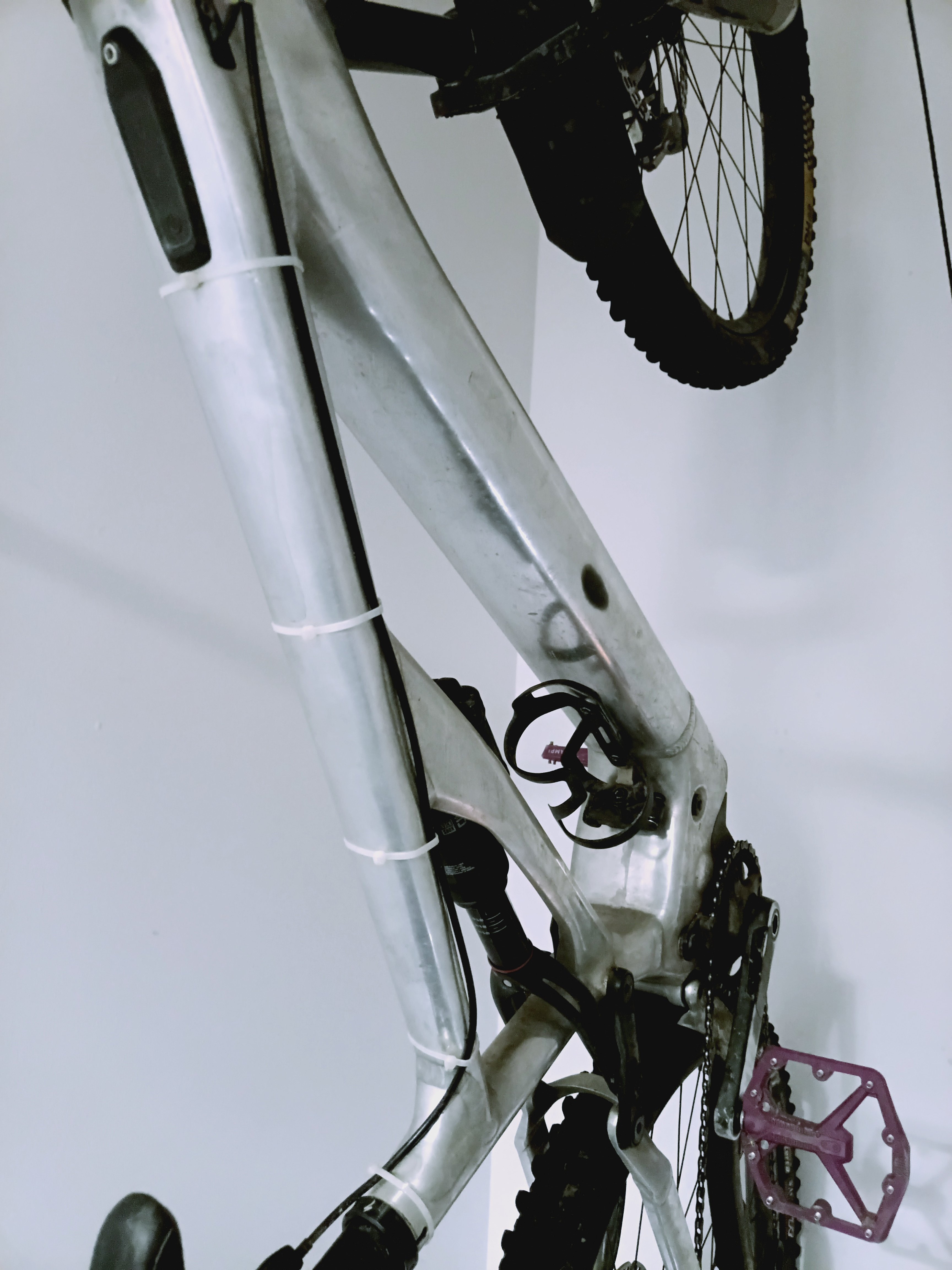

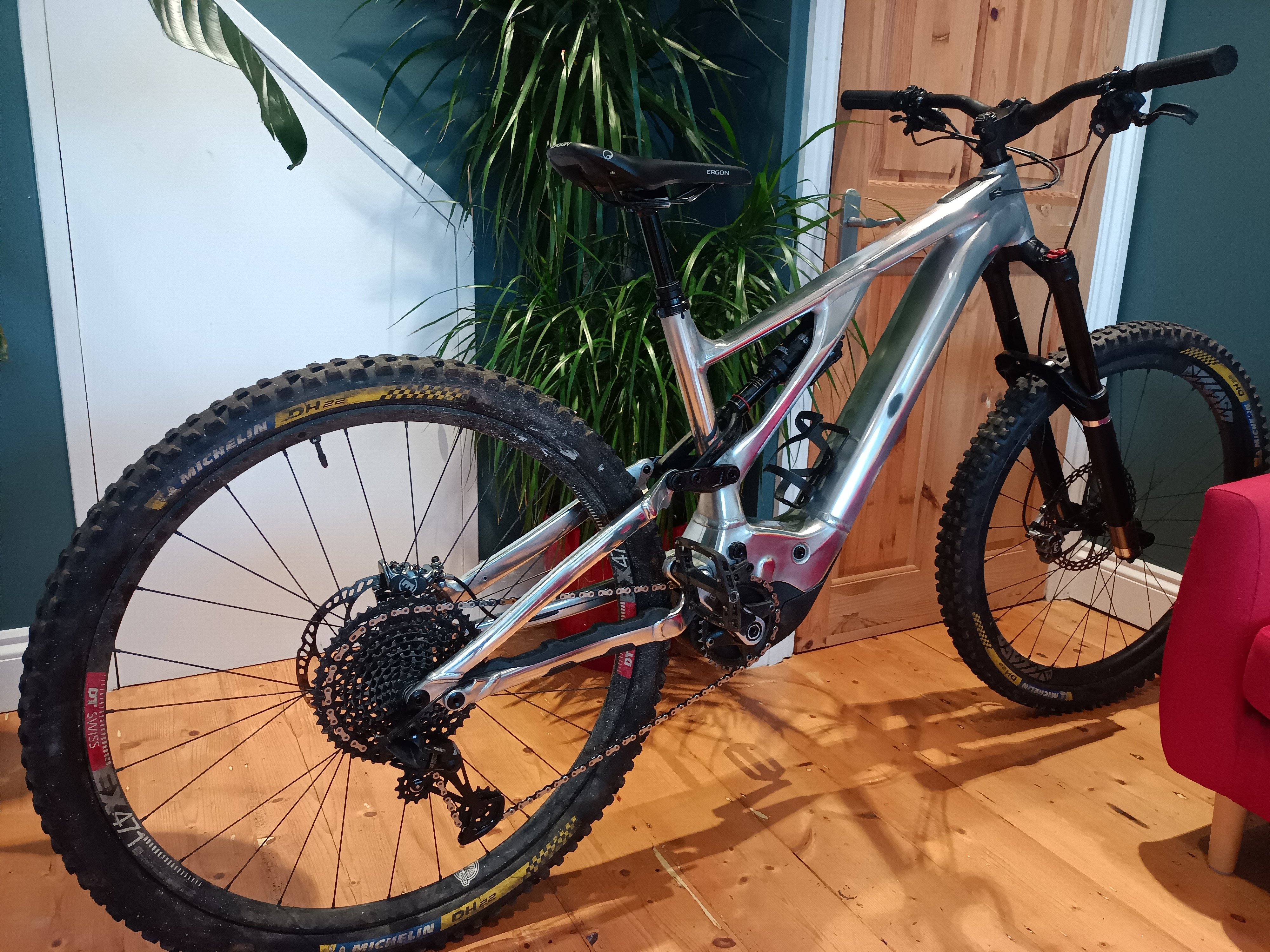

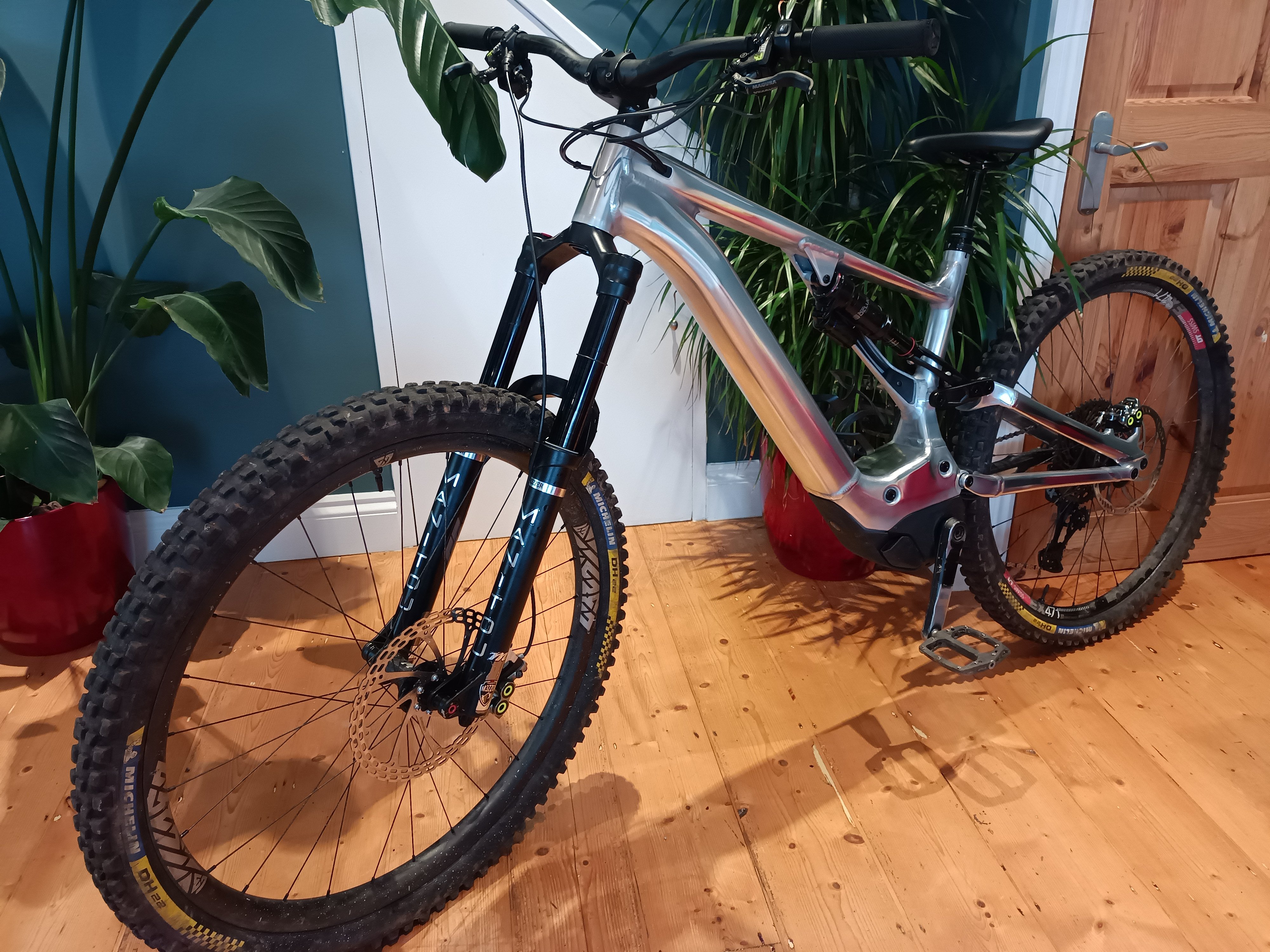

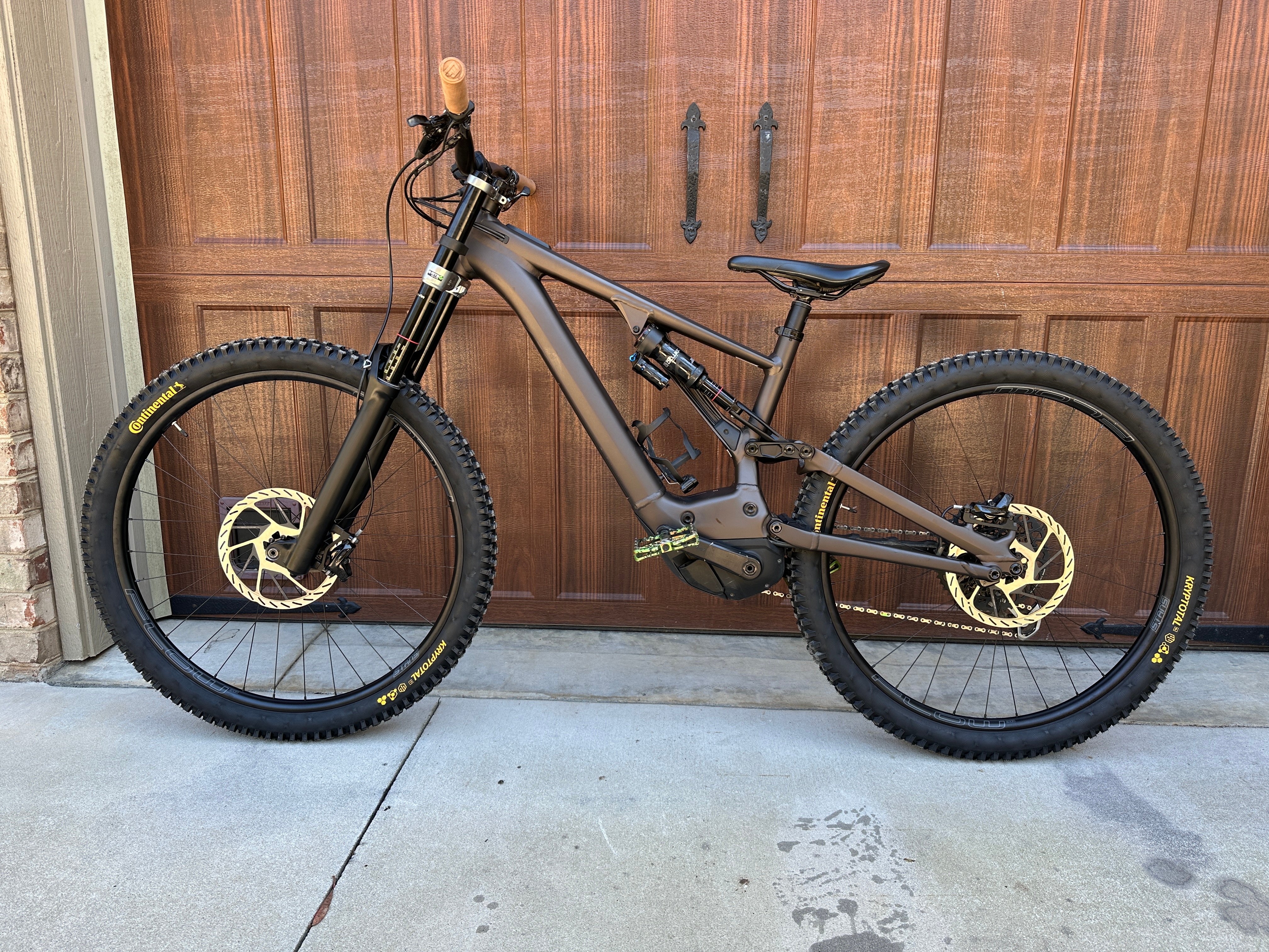

View attachment 157911View attachment 157912
Nice!
Did you use sandpaper to remove the old paint?
  • Like
Reactions: ady
Nice!
Paint stripper, scraping and polishing pads on an airline mainly - the ally is too soft for sandpaper. Had to do multiple layers of stripper too, could have been worse tbh and well worth it,
Then use Mothers Mag on a rag and it comes up like a mirror

Hey I absolutely love your bike. I have a 2023 Comp which is green and I've never liked the colour. Now out of warranty so thinking I either strip it off like you did or try to paint with plastic-dip or similar. In regards to stripping it, did you take everything off of frame including cables, etc? The chain guard protector as well, how did you deal with that? And finally, did you clear coat the frame after polishing so it wouldn't oxidize or rub off gray if you touch it?
Mine oxidizes, but its always dirty so I have no way of noticing it, and I want it to be a tool first and foremost (a cool tool ;) ) and not some souvenir. Highly recommend stripping it, I love my bike 2x after doing it. Shout out to all the stripped levos and kenevos on this forum for the inspiration
Ok cool, thanks for the feedback on that. My bikes get ridden hard so I don't care about some marks/scuffs. Just didn't know if it looked bad after oxidizing or took a lot of maintenance. I guess a really quick buff with a rag and mag wheel type polish would clean it right up again. I'm really tempted to go down this road and hopefully will post some pics in the months ahead while it's parked for the winter (snow on the ground in Canada).
Mine is not polished I have a more sandpapered/gritty look so hopefully someone else can tell you more about maintaining polish
It will be a badass looking bike either way!
From what I've seen I'd probably go with the look you have. Polished is cool but I don't think I have the time or patience to spend that much time then the upkeep. I like a rougher finish anyways.

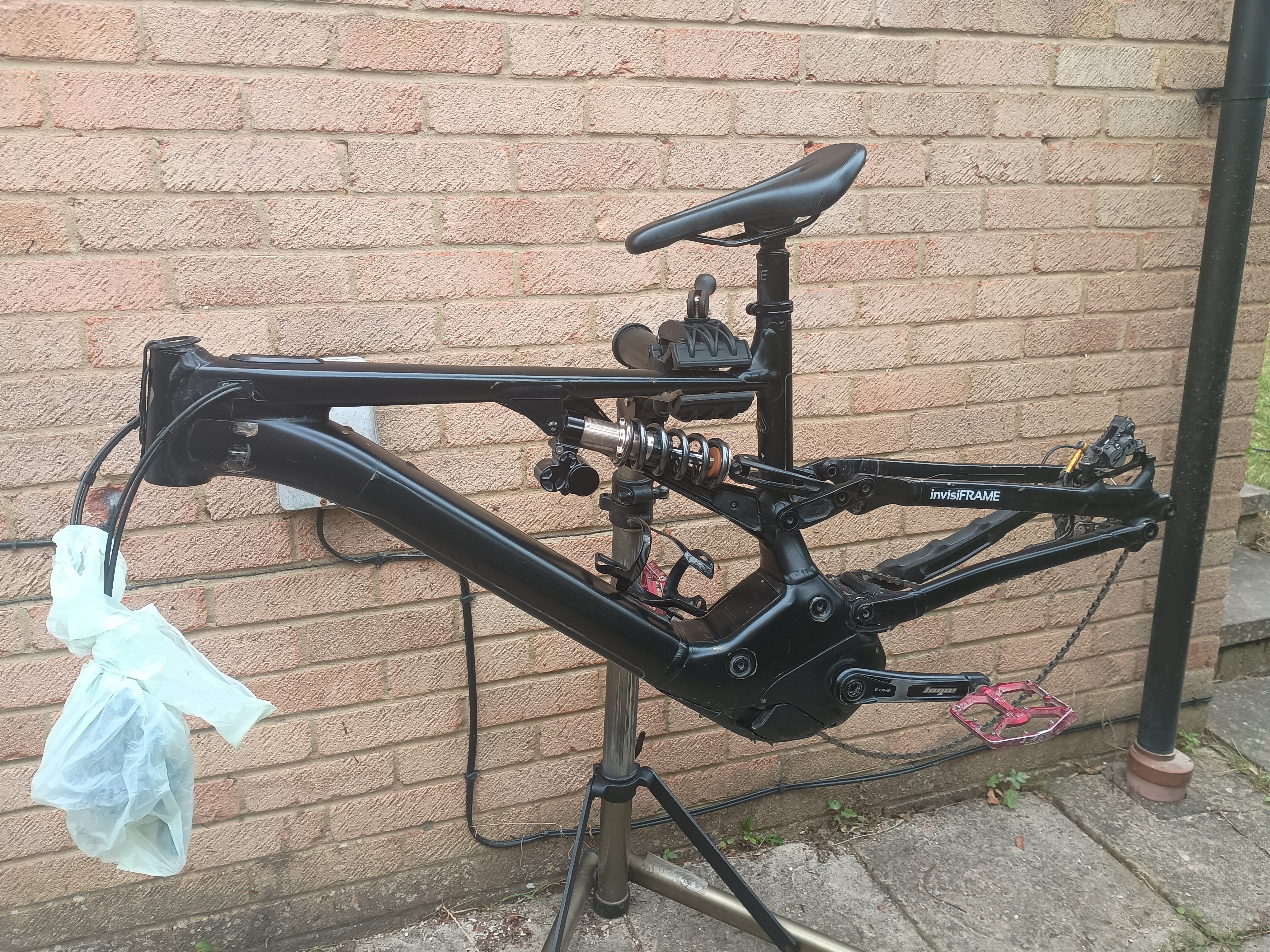

Cheers! I was doing a full strip and rebuild anyway (had snapped the mounts off the motor somehow - props to Spesh for replacing under goodwill out of warranty 👌) so it was completely bare, had also bent the back end so actually stripped back a brand new replacement wishbone. The chain protector just popped off, maybe there's a tiny screw to keep it in place. Paint stripper is pretty messy stuff so you would need to completely break down the whole bike - good time to replace all bearings etc. Don't use sandpaper the ally is soft as cheese: paint stripper, plastic scraper, pointy thing to pick out of the welds, polishing pads with polishing compound on an airline sander, aaaaand repeat...... There may be a pro way with dipping or something but that's what I did.
No clear coat or anything, the pic is after 18 months of not cleaning it apart from a quick hose off after rides, I'm pretty lazy.... I did test a patch - a proper clean and some mothers Mag makes it all shiny again 😻
Awesome, thanks for the info. Mine is in progress right now. Just had all new bearings installed. Paint stripper worked great. I'll post some pics when it's a little further along, right now it's a bunch of pieces in a box.
