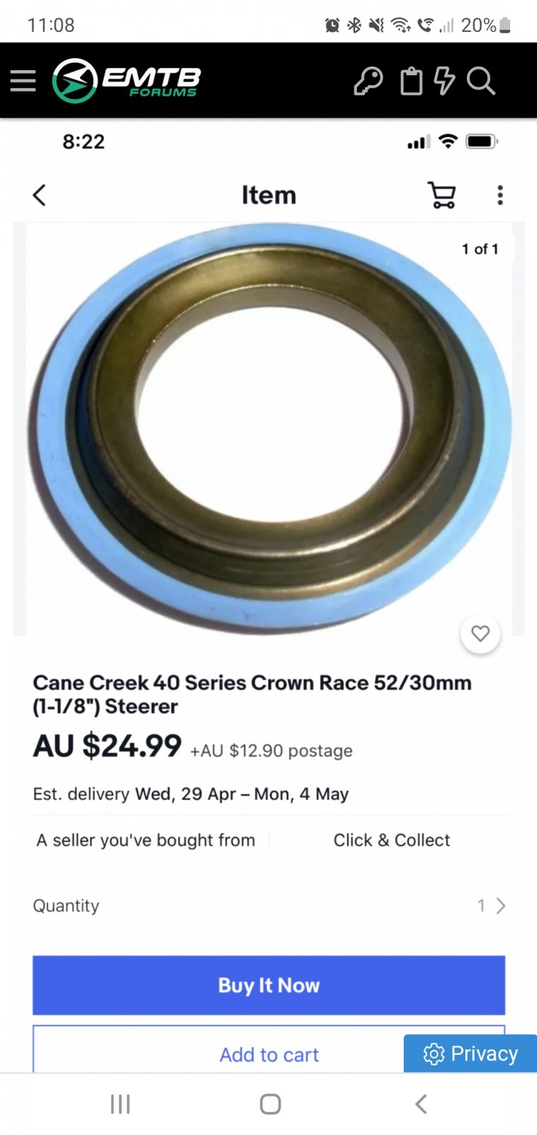

This is the lower crown race that works too.
Pity much similar setup I'm thing of going for. I'm 95kg I was going to just swap bottom sanctions on my boxxers for 29 setup. Dealer offered to do it for $500. Will be heavier than the zeb but I like the feel of double crown forks. Is the lower crown rrace for fitting the Zeb or to change geo?
That's just for the Zeb. I've got the flip chip and high but haven't done the offset bushing yet.

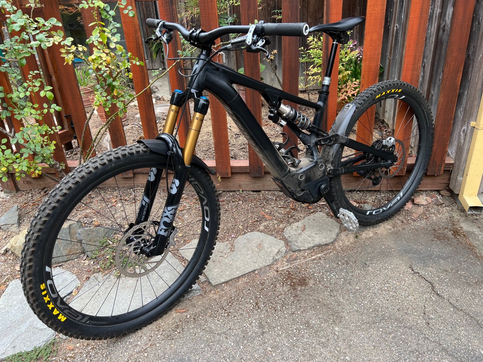

I have fitted a single offset bushing into the EXT Storia top shock mount with the bushing rotated to position the 8 mm hole inward. My Flip chip is in the High position. The steering/handling feels a little squirrely and floppy, not as stable as before with the Boxxer 27.5 set up.
Is this is what the full 29'er Front and Rear set up it is supposed to feel like? I have a 50 MM stem and OneUp Bar.

Try without the offset bushing. It’s slack enough without it I find.

I removed the offset bushing and that helps. Front wheel feels less floppy.

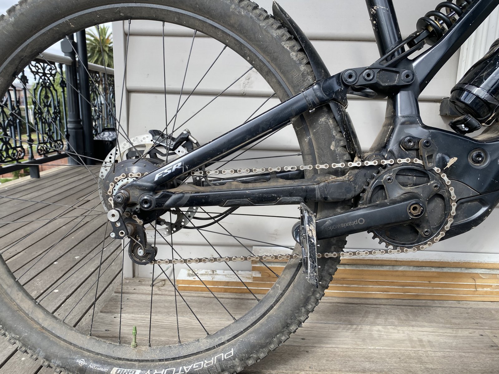

Wow. I didn't think you could fit a 29" wheel in the back. 😲
I'm running a fender in the back to protect the motor/bearings from mud though, which does reduce the available space. Anybody here running this with a 29" wheel in the back as well?
Also, more images with the clearance in the back are always welcome!
That's German. 🙃 I've informed the author to change it.

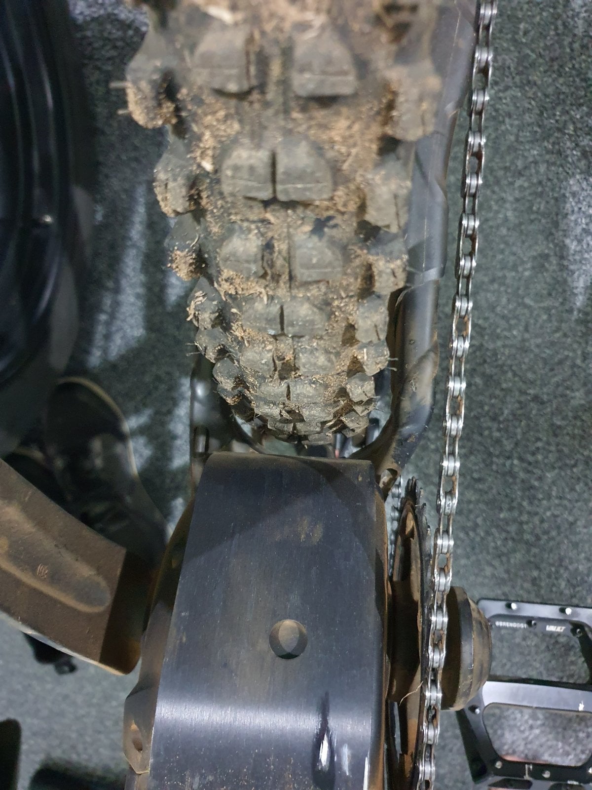

This was a 29 x 2.6 with the Sicomtb guard, 5mm clearance at the tightest point. No real issues in the dry, got a bit caked in the mud but never locked up.
A 2.3/2.4 tire would be a more sensible option.

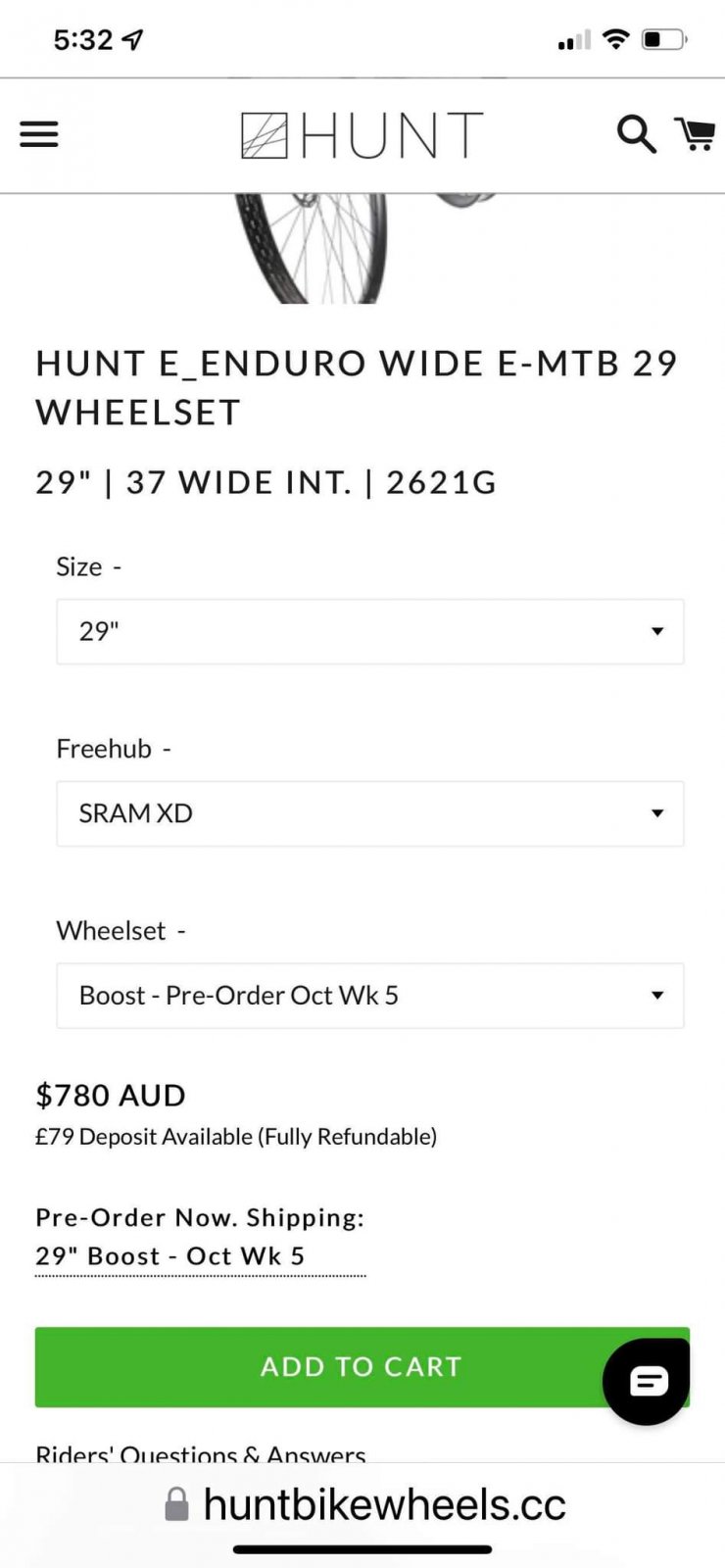

Went to local shop and have ordered Zeb ultimate Rc2 and will be converting to 29ner running Hunt wheel set, pirelli scorpion E 2.6 on front and 2.4 DD on rear with cush core both front and back.
