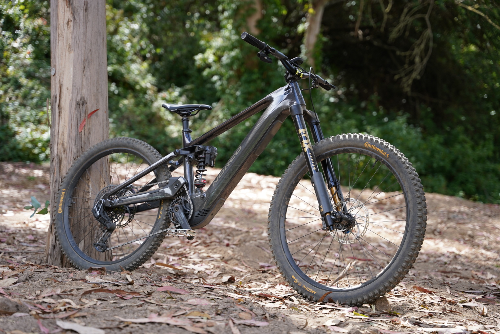

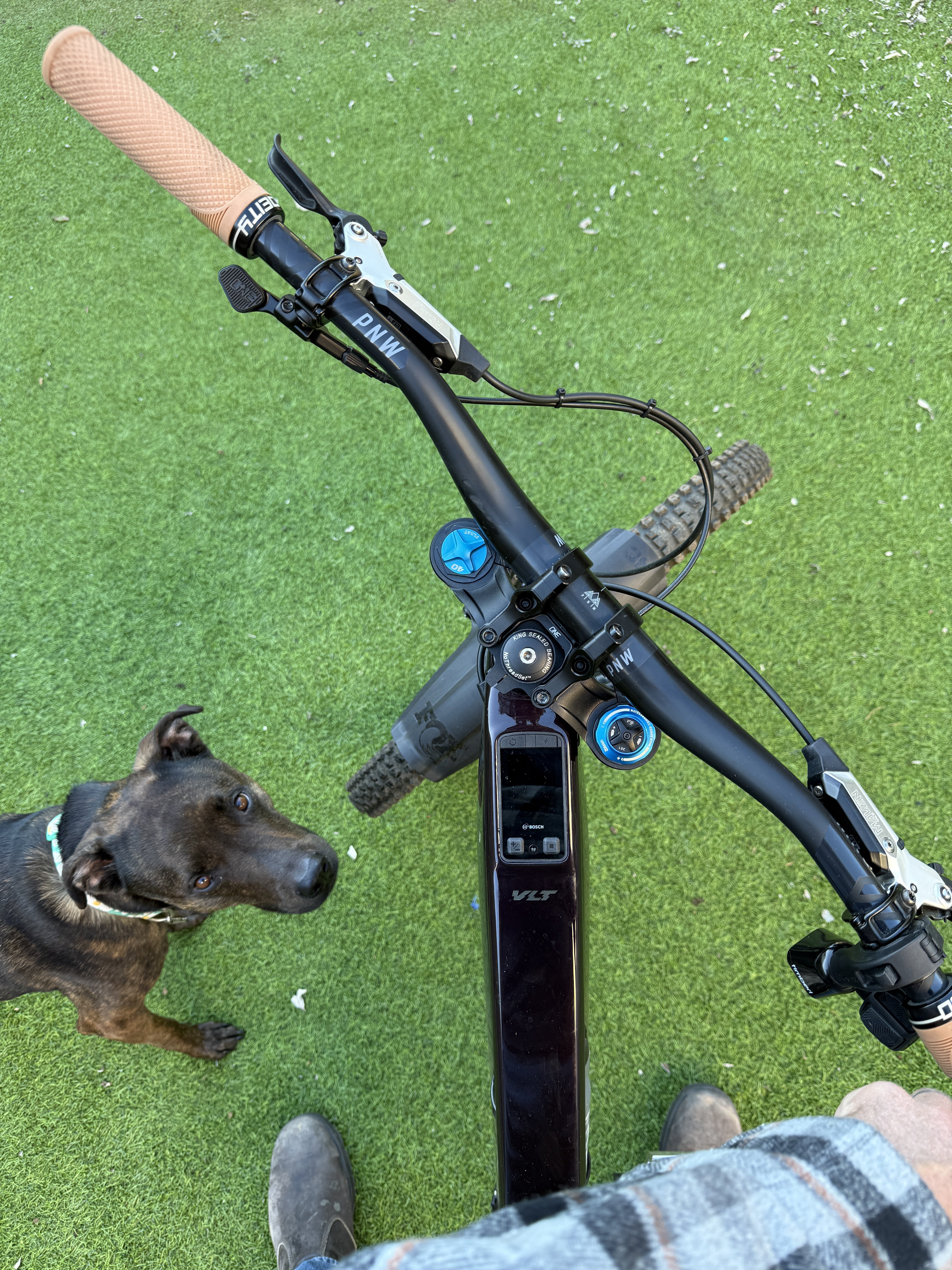

2025 Norco Sight VLT CX
54.7lbs w/ pedals (S4)

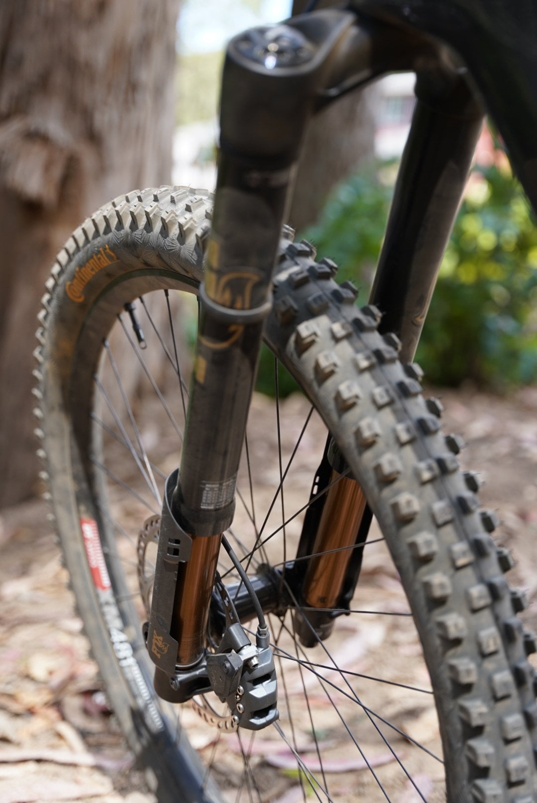

40 has a 190mm airspring (matches ATC of a 170 Zeb).
DH casing + Cushcore F/R
Will swap shock for a 65mm Arma when it gets here (borrowing the 60mm Vivid off my pedal bike). Also waiting on a TR41 rear wheel and a Kiox display.
Sized down. I'm 6'4" and the S4 has the same reach as my XL Dreadnought v2 (which I love). Whenever I go over 500 reach the front seems to wash in flat corners.
Super playful just hooning around the neighborhood. First ride tomorrow hopefully.

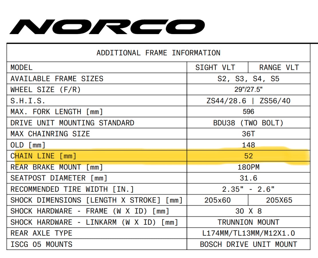

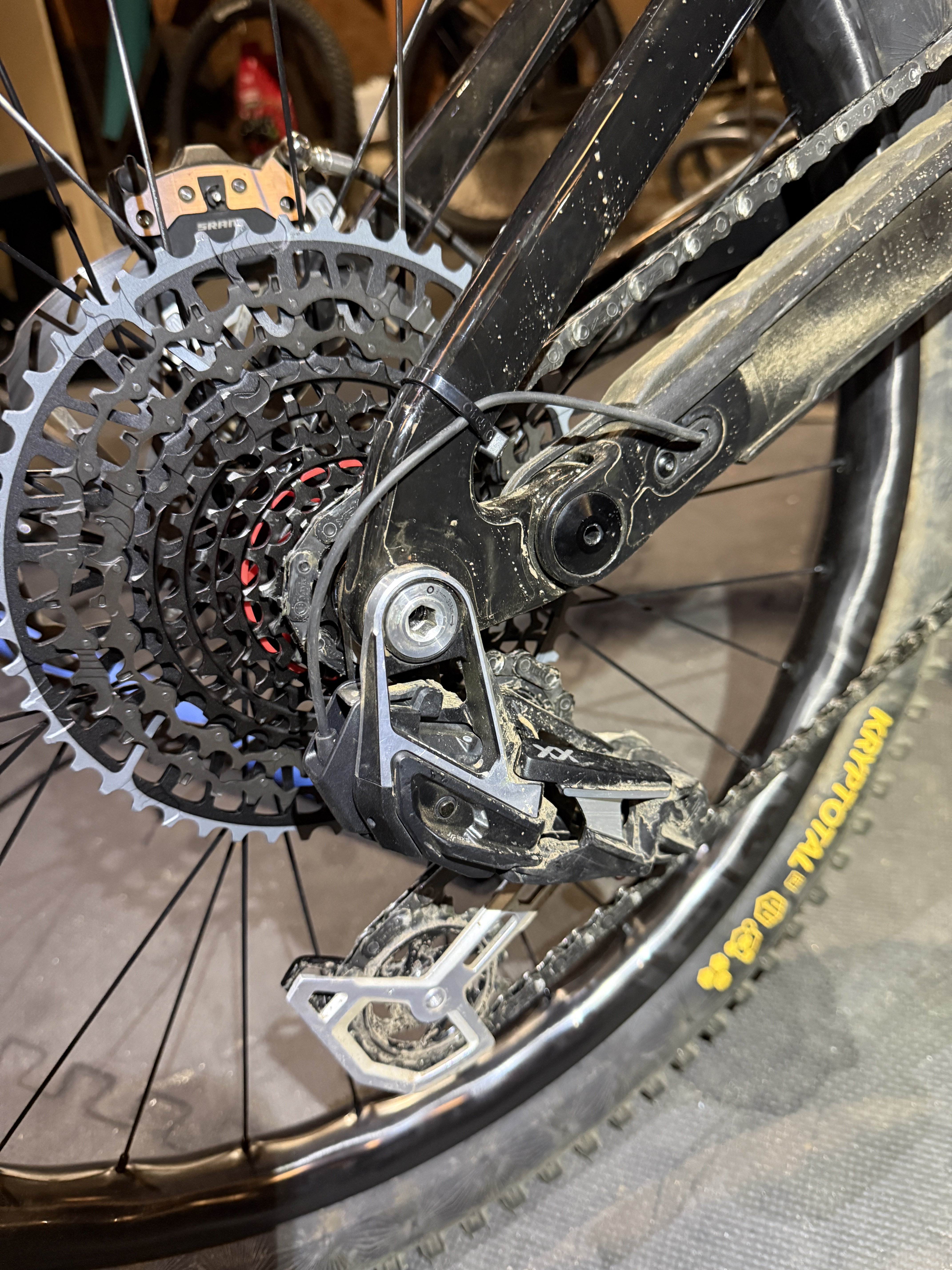

Anyone replace their chainring yet? Tried to mount a SRAM T-type XX for 55mm but turned out it's had way more offset than the one that came on the bike (?). Did not line up with idler.
Wish someone made a one piece titanium chainring for these motors. The two piece alum/steel affairs are bricks and aluminum just wouldn't last.
EDIT:
Looks like the sight/range vlt cx chainline is 52mm vs standard 55mm t-type chainline. Typically not a hard issue since chainring and cassette are far apart, but with the HP idler sitting directly above at 52mm there's no room for error.
So where do we find replacement chainrings?

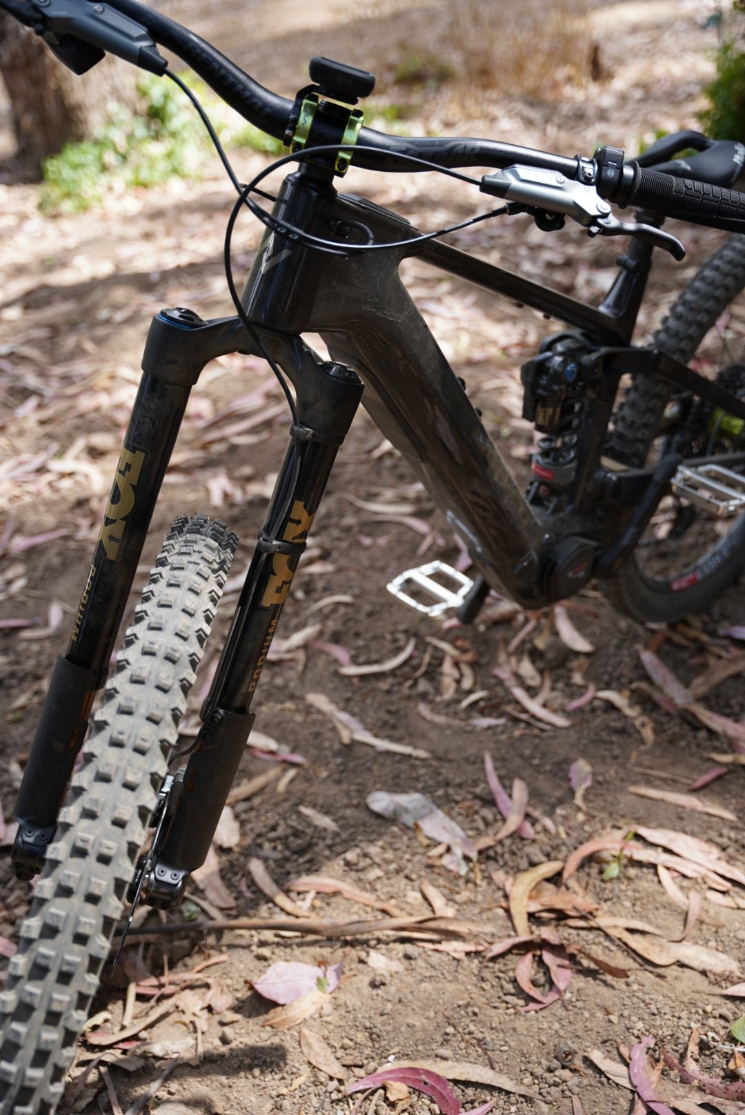

Why don't buy an other ebike more suitable for 190mm travel?
It's suitable for sure. My V2 Dreadnought is set up 190/160 with a 40 and it's fantastic so the Norco should be epic.
Norco rates the sight/range frame for a 180mm fork (596mm ATC). This 40 is setup with a 190 airspring with crowns dropped 3mm to net a 586mm ATC and preserve the Range's 63.5 HTA.
The 40 is primarily for stiffness rather than travel, but the extra sure doesn't hurt.
EDIT:
Given its intended for 52mm, I'd be surprised you'll find a DM T-type CR. Probably why they went with BCD and so they can alter the CR for Shimano or SRAM build options. Plus most options are aluminum anyway. The BCD type in steel will be the longest wearing for sure.

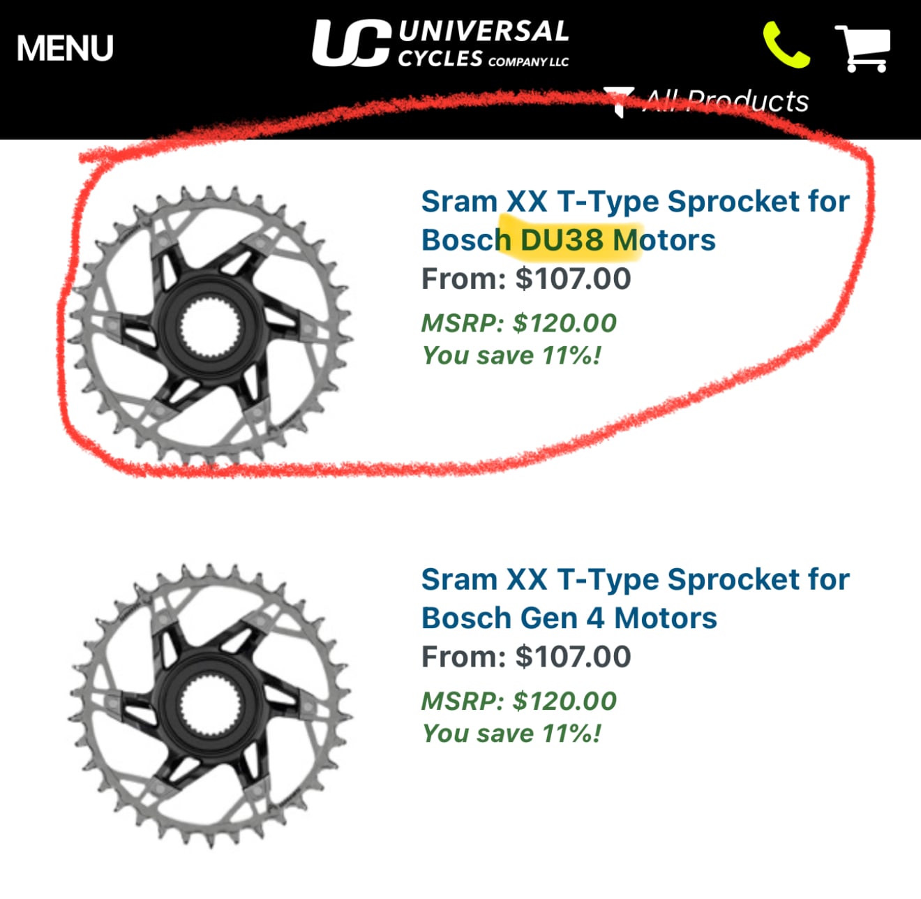

Looks like SRAM sells different Gen 4 and Gen 5 Bosch ("DU38") chainrings. Can't tell if the DU38 version is a 52mm chainline or not as it isn't listed.
The only chainring I've come across that actually lists a 52mm chainline is the OChain spider. Spendy and heavy but I'm not not curious lol.
This might work :

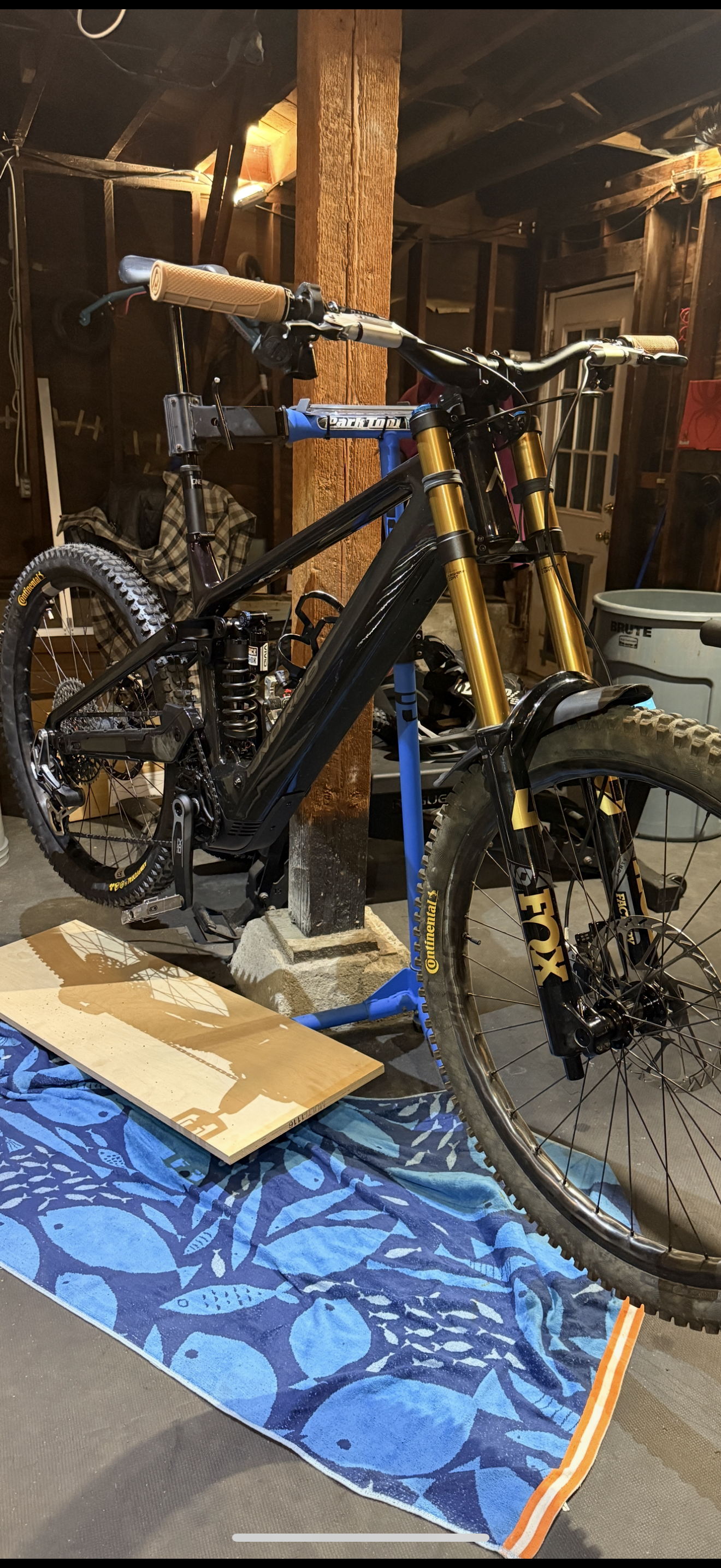

I was told not designed for dual crown and no warranty.
Did you confirm this first?
Mums the word!
I was gonna do that as well but decided it's capable enough...
I'm heavy and tried a dual crown for the first time earlier this year on a whim and immediately decided I'm never going back. So much support, goes where you point it, eats bumps without flexing and binding up. Night and day.
If Norco cleared it for a 596mm ATC that means the head tube is strong enough. Side loading in a crash could theoretically be an issue. Might not be a bad idea to add more bumpers to spread the load out just in case.
The earlier gen range vlt is rated for twincrown, emailed Norco and had confirmation (180mm) and run Dorado pro forks on mine😎

if you look at the earlier (gen2) frame then it's sorta obvious as to its intended use, 1.5″ top & 1.8″ lower headstock bearings are huge compared to most other bikes :unsure:
Rich.
Yes indexed. I just upgraded from the the Gen 2 which I still think was an amazing bulldozer! Still rate that thing highly!
Would be cool if you posted the max angle you can turn the steering on that frame.
Note that this is with a 48mm offset crown so the stock 52mm offset will turn a little further.
No real difference in steering angle between the Sight and the Dreadnought based on head tube width.
I've never hit full lock on trail FWIW. If the wheel gets turned that far I'm either off the bike or about to be ;).
On that note, doubled up on the steering bumpers to spread out the load. Cheap insurance.

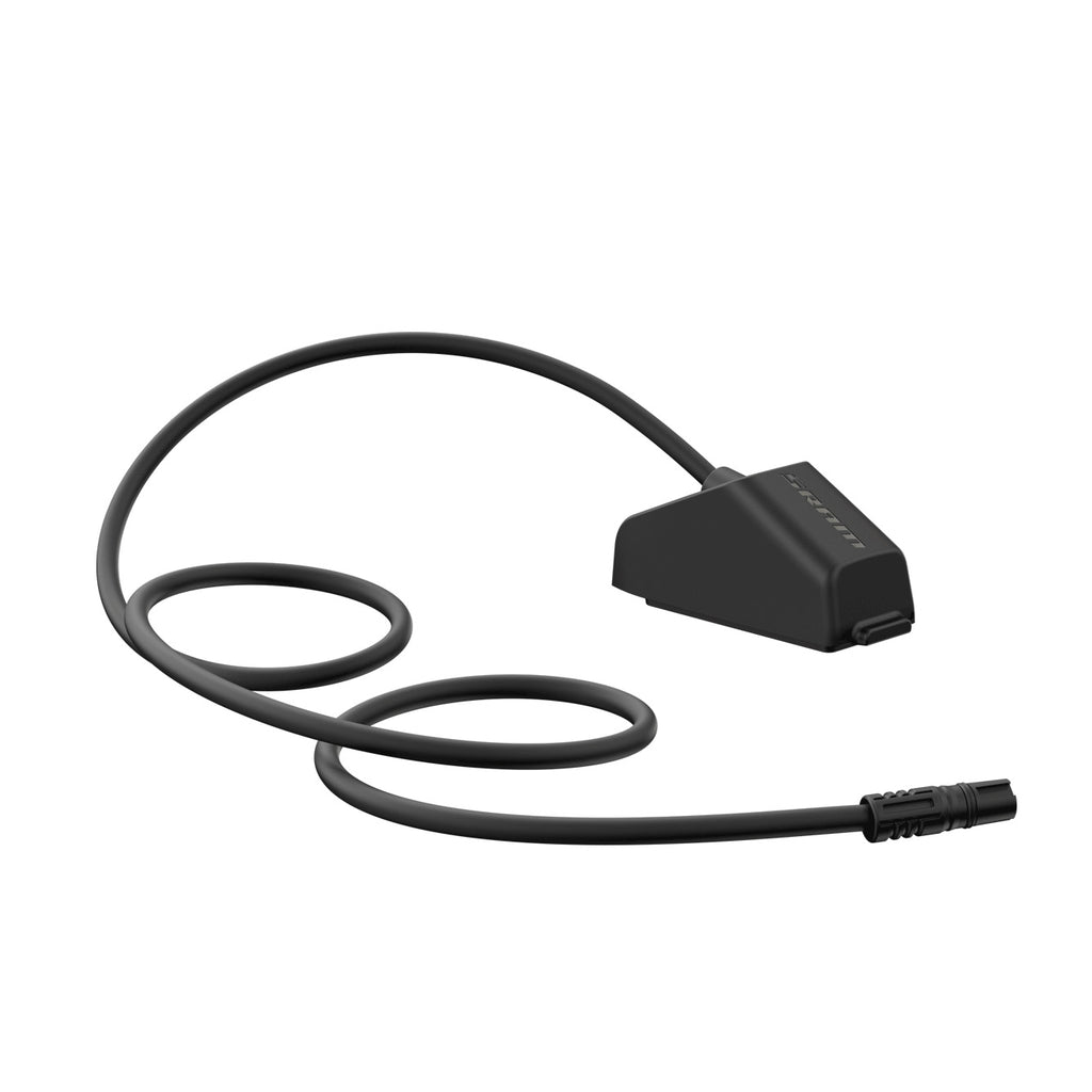

Anyone hook up their AXS derailleur to the bike battery via this cord yet?
Curious about:
-routing
-where to plug it in
-does dealer/shop need to enable
Thanks!
EDIT:
Welp, it works! No dealer activation required. You just plug it into the yellow/orange port on the motor under the plastic fairing.
Looking forward to not worrying about AXS battery charging (while simultaneously wondering if the irony is now officially too thick and I should just go ahead and install a cable derailleur already lol).
Looks like routing through derailleur cable port will work but likely requires at least partially dropping the motor to fish it around.
