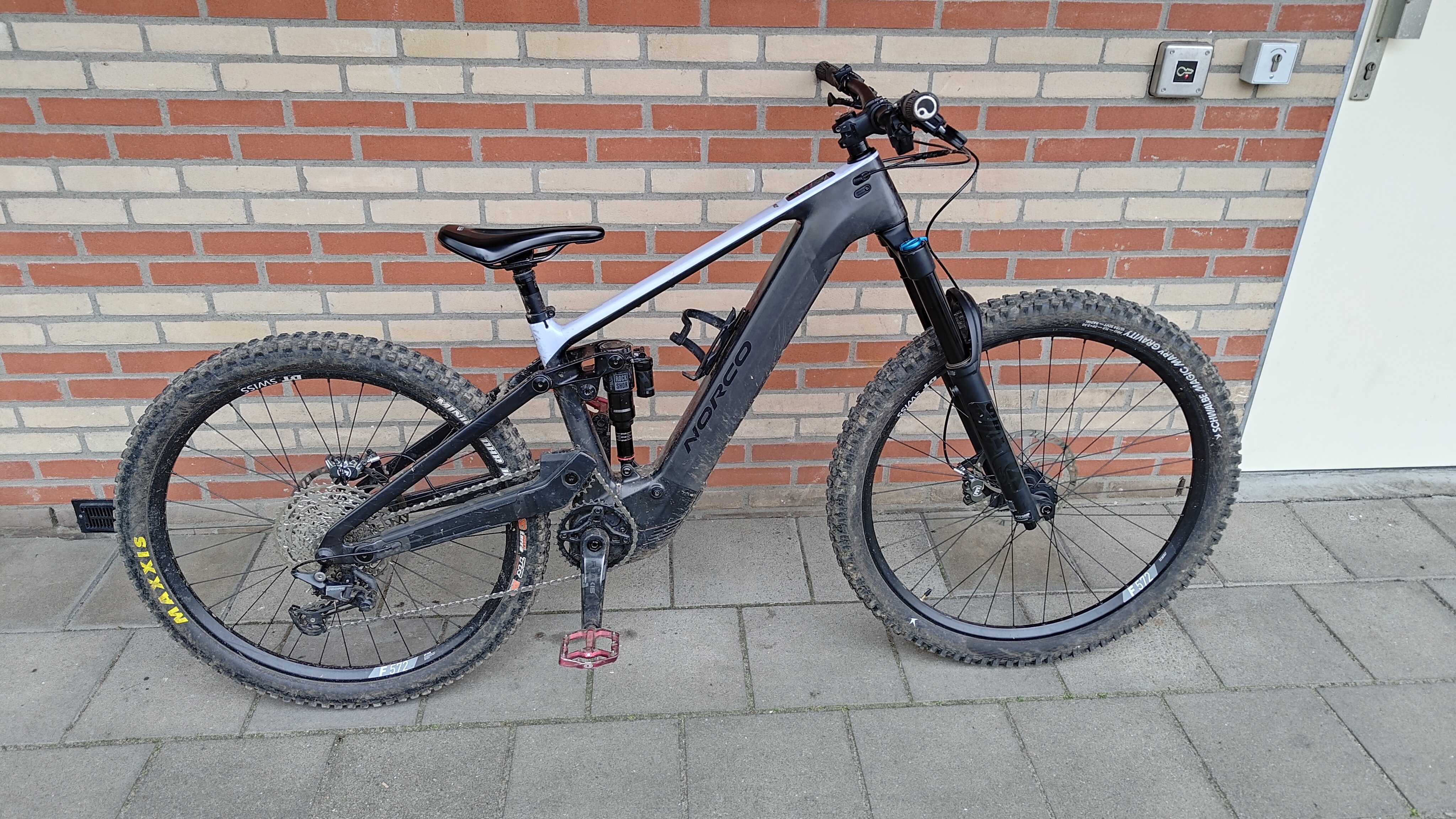

2025 Norco Sight VLT CX
Great ride today.
Stiffer and more responsive than my Gen 2 range vlt.
Handles switchbacks much better.
Low bb. Few strikes, nothing bad though.
Never felt too long I'm 6ft sz4.
Still dialing suspension, usually use ride aligned but can't yet obviously.
Range was insane.
Really steep winch and plummet riding and park laps.
3hrs without using lift and boosting up hills. Trail mode down and trailing.
Super fun direct bike and sizing is correct for my height.
Weight 24.6kg with downhill Tyres pedals and hope brakes 220mm vented rotors both ends
View attachment 172183 View attachment 172184 View attachment 172185 View attachment 172186

Yeah it's definitely not the lightest build. Straight out the showroom floor, adding downhill tyres and 220mm vented hopes also added some weight. I also weighed with hope gravity pedals fitted.
Riding last night at the local bike shop park I beat all my previous times and it didn't feel "too heavy".
Can definitely feel the shorter rear end.
I did consider building up a sight but as they were also delayed I just decided to wait.
When the wheels fail I'll build better wheels set, when the deurailier fails I'll go mechanical, this will be bring it back slightly in time but it's noticeable that's it's lighter and more nimble than their outgoing models.
Pretty happy at 24.5kg

Nice. What size you get, and how tall are you?
The Sight has a Lyric, trail tires, etc. So yah the Range weight gain is what it is.
This is a top 3 bike for me. If I don't ever get my on-order Antidote it'll almost certainly be the Regulator, or this.
If they offered a frame only with a CX-r and a 600w battery, I'd order today.
I do think this is a better Rogue with a better chainstay length and a better drivetrain with a better weight distribution.
Of course it costs considerably more too!
Size 4.
I'm 182 cm.
I'm pretty lanky 46 years old and it feels perfect.... Never felt long. Well placed on climbs.
