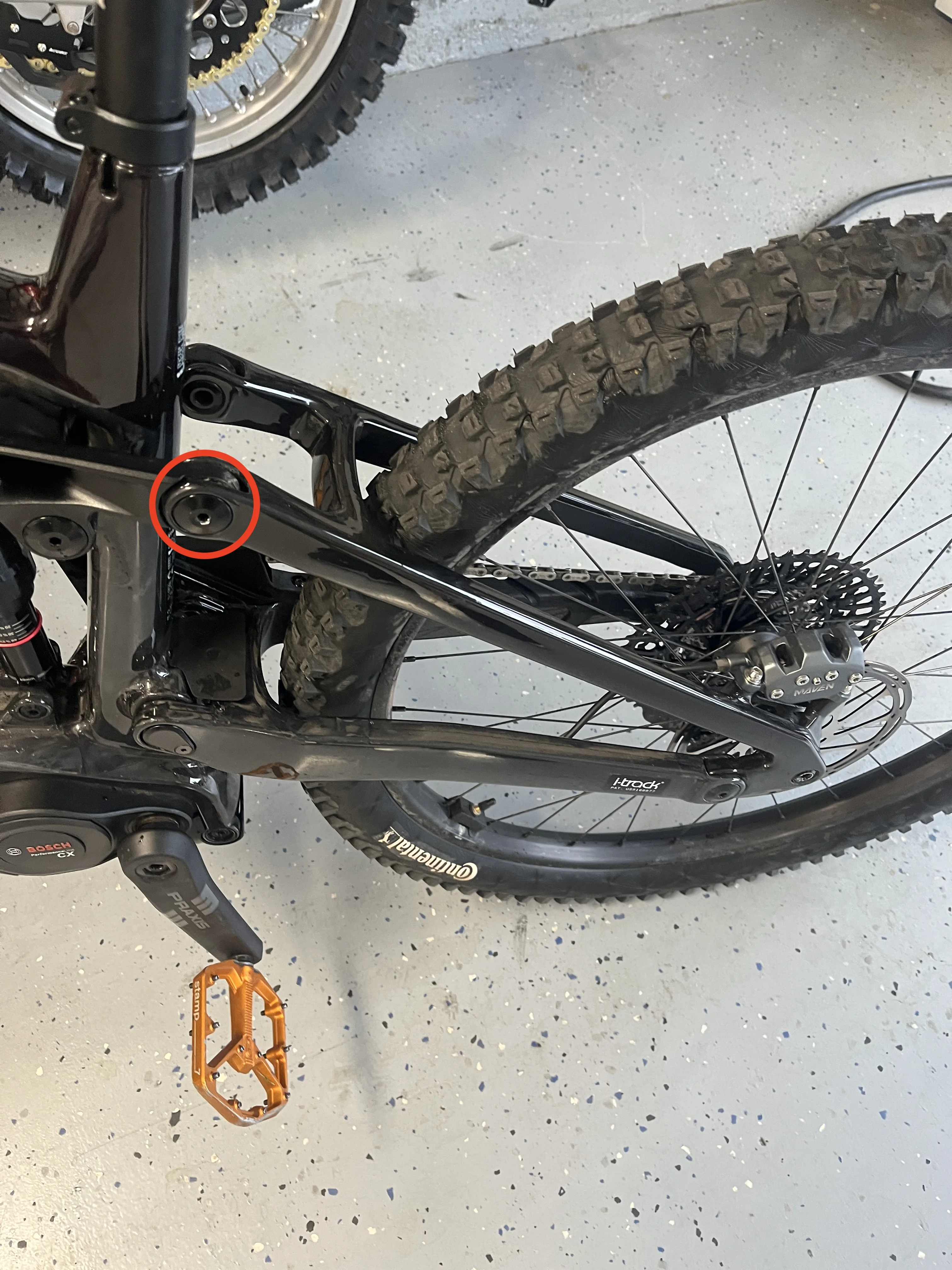

Hey everyone, my brand new C2 model with 50 miles on it has some creaking in the suspension already. Any tips to get rid of this or any common bolts or bushing that I can check? The shop I bought it from is 2 hours away, so I’d prefer not to have to take it back there.
Could i take it into any Norco dealer and have them look at it?
Really tough to diagnose creaking online. Any competent shop (Norco dealer or otherwise) can help you, only benefit of going where you purchased is they might be more inclined to do some amount of free labor. For a 4 hour round trip I'd rather just pay the labor at a local shop if you have one.
How confident are you the creak is from the suspension? If you are 100% sure it's from the rear suspension, I'd start with the shock mount bolts. Just remove, inspect, clean, grease, reinstall. In my anecdotal experience most creaking on new bikes has been from where the shock bolts to the carbon frame. And sometimes just a result of that bolt being over tightened.
I need to do a bit more testing. I thought it might be bottom bracket at first, but just pushing down on the suspension without weight on the pedals, and it still creaks. I guess I was wondering if any Norco dealer would cover that under warranty since its a brand new bike, or would they just say that is the bike shops fault for building it incorrectly and to take it back there
Well the Range CX VLT I bought from Jenson came with some hardware not properly torqued (front rotor and lower shock bolts)... even the prior bike [SCOR] had a loose cassette nut.
Personally, I'd check all the hardware myself. In the long run its something you should do anyway (hardware check) periodically. Easier than bringing bike to shop, at least as a first pass for issues. Also an ebike as no "BB" per se... there's a motor with bearings in it. However, BB gets claimed for creaking more often, but rarely the problem.
There's so many areas it could be creaking from... front or rear? under braking? only compression? g-outs? while pedaling? pressing into seat? actuating dropper? etc...
Ya, most likely not really a warranty thing so much as an assembly issue. Would make sense to hold your shop accountable if they were closer, but since they are not I think you'll just need to figure it out on your own/with help of a local shop. If you chase down the issue and it turns to be a defective part then you can talk to your nearest Norco dealer about warranty help, but that is not likely.
First things first is to rule out the seat and seatpost. Is the creak identical whether you're pushing down on the top of the seat or the top of the frame? Next step is to check the shock mount bolts as I mentioned earlier.
I’ve definitely narrowed it down to rear suspension creaking. If i stand on the bike with no weight on the seat and compress the suspension, it creaks. If i get off and try to press the rear suspension through the seat, it creaks. So that tells me it’s not from the pedals/cranks/motor and not from the seat post either.
I would check torque settings on the shock anchor points, then the linkages. A long time ago I found a slightly loose shock bolt produced a creaking on a Santa Cruz

Re: my suspension creaking. I found this outer bolt to be able to spin freely. I'm guessing it is not supposed to do that base on how the other side is. Question for more experienced bike mechanics, is that outer bolt more of a cover ? I tried holding both sides with Allen wrenches and the bolts seem really tight together, but they spin freely within the bushing. I could probably crank on it but I don't want to break anything. Any tips are greatly appreciated !
Norco uses thread locker on the hardware... so it may take a bit of force to undo. I would remove the hardware inspect, re-apply thread locker and re-torque. That bolt or pivot hardware is akin to a shoulder bolt which clamps the inner bearing race to one of the rotating suspension members (in this case the seat stay).
The head is generally large on these types of bolts either because the OD of the shoulder (ID of bearing) is large, to cover the bearing face, and/or loads into surrounding material.
The outer bolt with the wide flange is not a cover it is the actual bolt. Agree, I'd pull it apart and check it out. If you aren't sure what's what, pull the other side apart to compare. Just checked mine to confirm and it does not spin freely.
Factory thread locker on those bolts in particular was stupidly stubborn when i was swapping out the recalled seat stays. To the point i stopped and regrouped to make sure they weren’t reverse threaded. SRAM crank bolt level stubborn.
Glad you located the likely creak culprit.
In a roundabout way your experience is how I ended up with this bike. Cant stand a noisy bike because it makes me not trust it - noises are usually a symptom of a problem and it’s hard to untrain your ears. Previous gen DJI with the knocking motor was enticing but I didn’t want a $10k+ cacophony! I also did not want to wait lol.

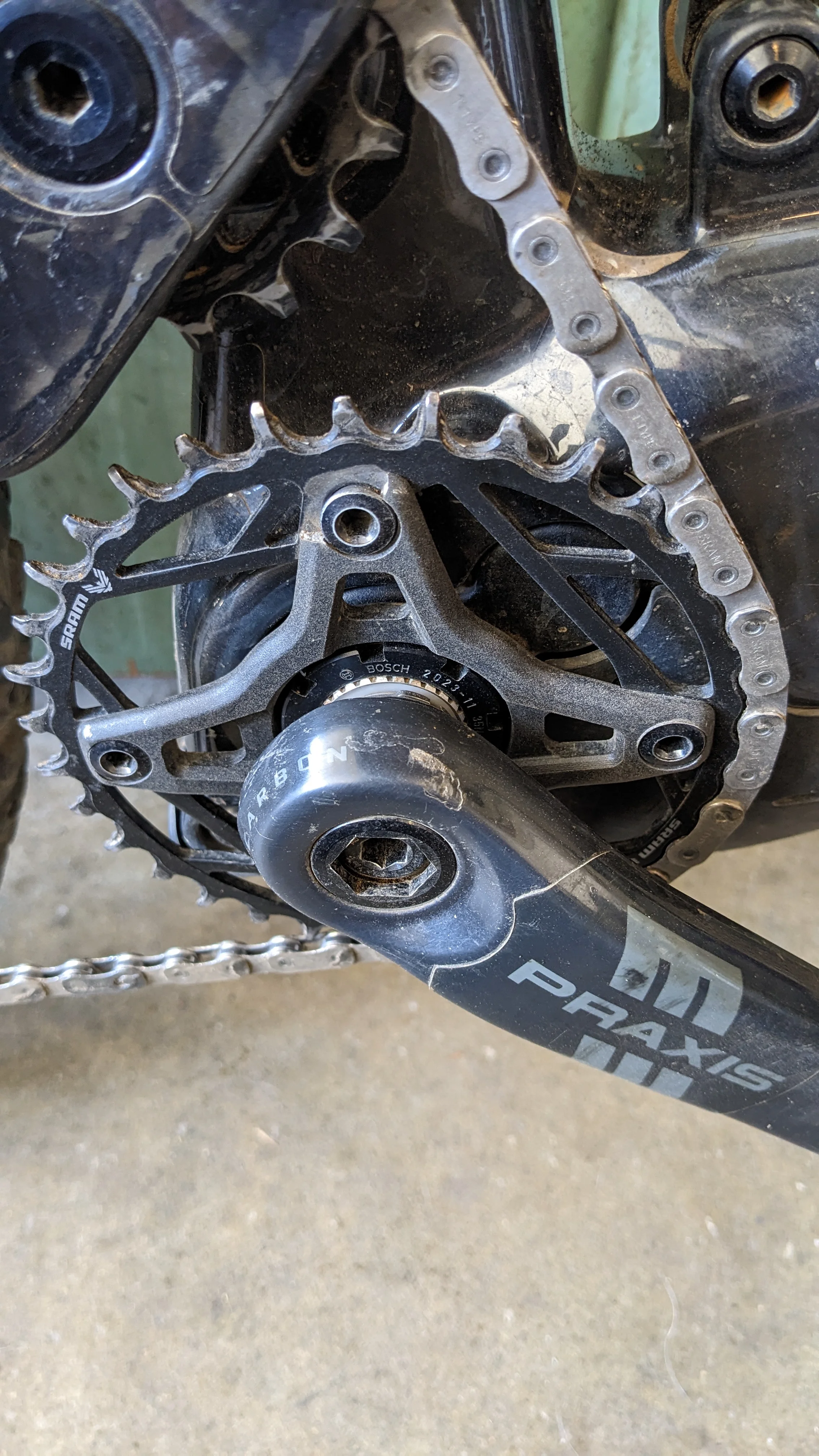

I just made the rather late and obtuse discovery that the OEM chainring is in fact a custom spider to achieve the 52mm chainline + 104BCD bolt on chainring, so replacing the chainring due to wear is solved by getting a replacement 104BCD (just ordered a 5Dev titanium).
I guess I just assumed those chainring bolts were rivets like the ones on the sram XX.
Kinda bummed that we are stuck with that spider. Ochain probably not an option
I just cracked my spider. All four mounting points were loose. I rode 115 mile in two days and should have checked the torque on everything.
Do you have to get the custom spider from Norco or can it be purchased elsewhere?
