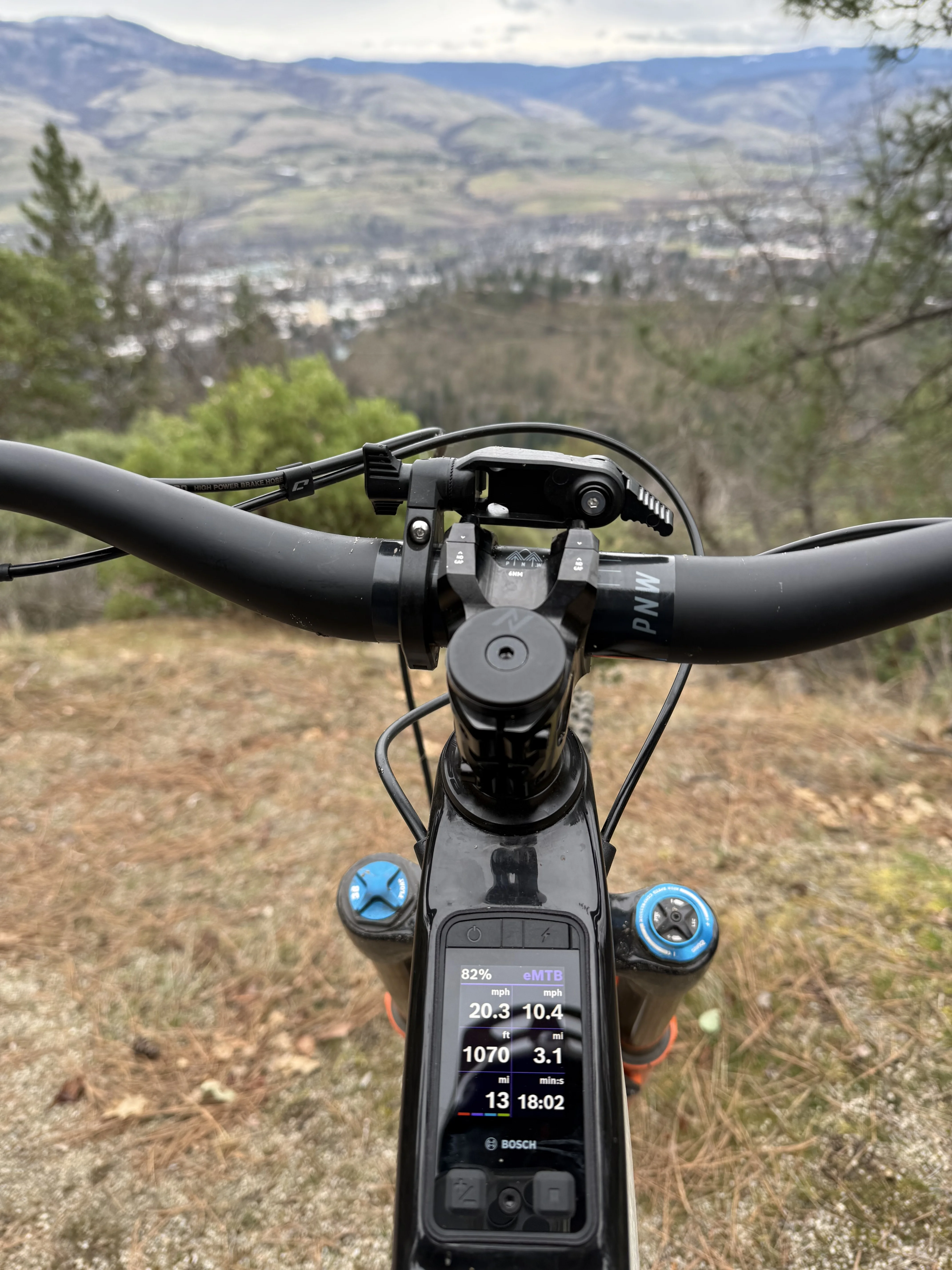

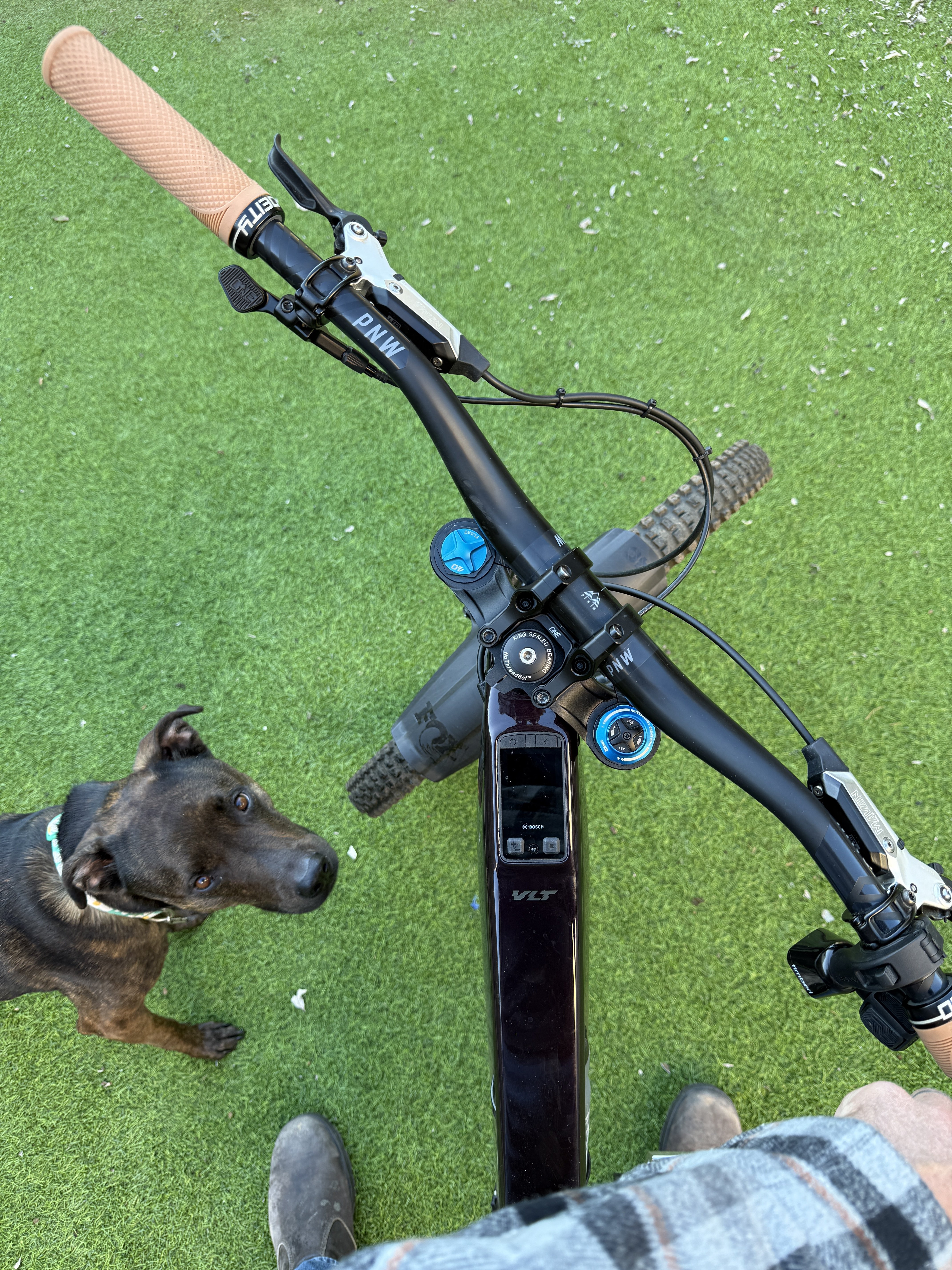

I've been experimenting with running no handlebar controller for the bosch system. Anyone else going that route? I love the ultra simplicity of having absolutely nothing in the cockpit and just some LEDs on the top tube. Certainly can not switch modes amidst technical terrain, but I don't switch modes much anyway and I find removing the option only simplifies the equation.
Note that this is with a 48mm offset crown so the stock 52mm offset will turn a little further.
No real difference in steering angle between the Sight and the Dreadnought based on head tube width.
I've never hit full lock on trail FWIW. If the wheel gets turned that far I'm either off the bike or about to be ;).
On that note, doubled up on the steering bumpers to spread out the load. Cheap insurance.

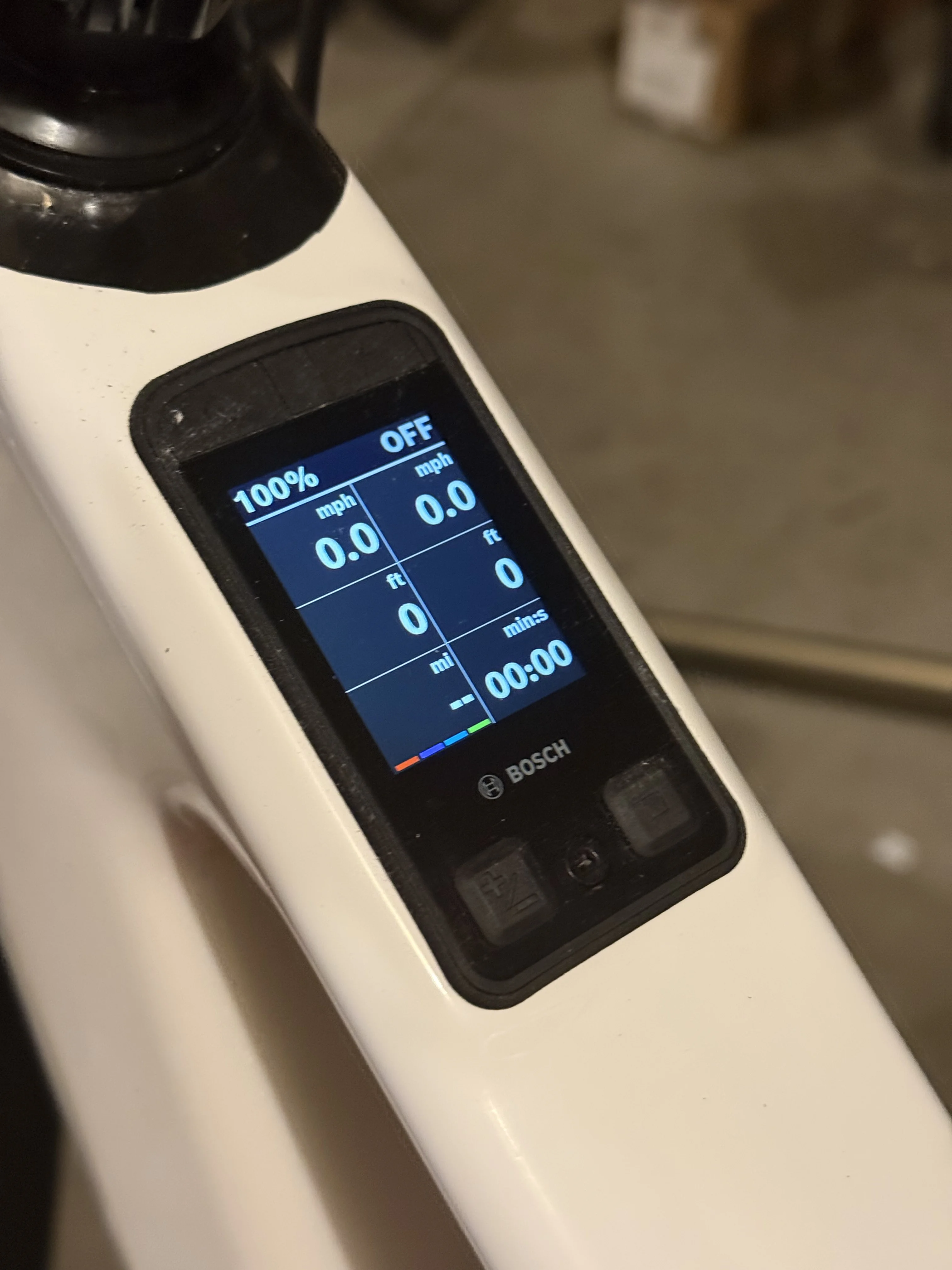

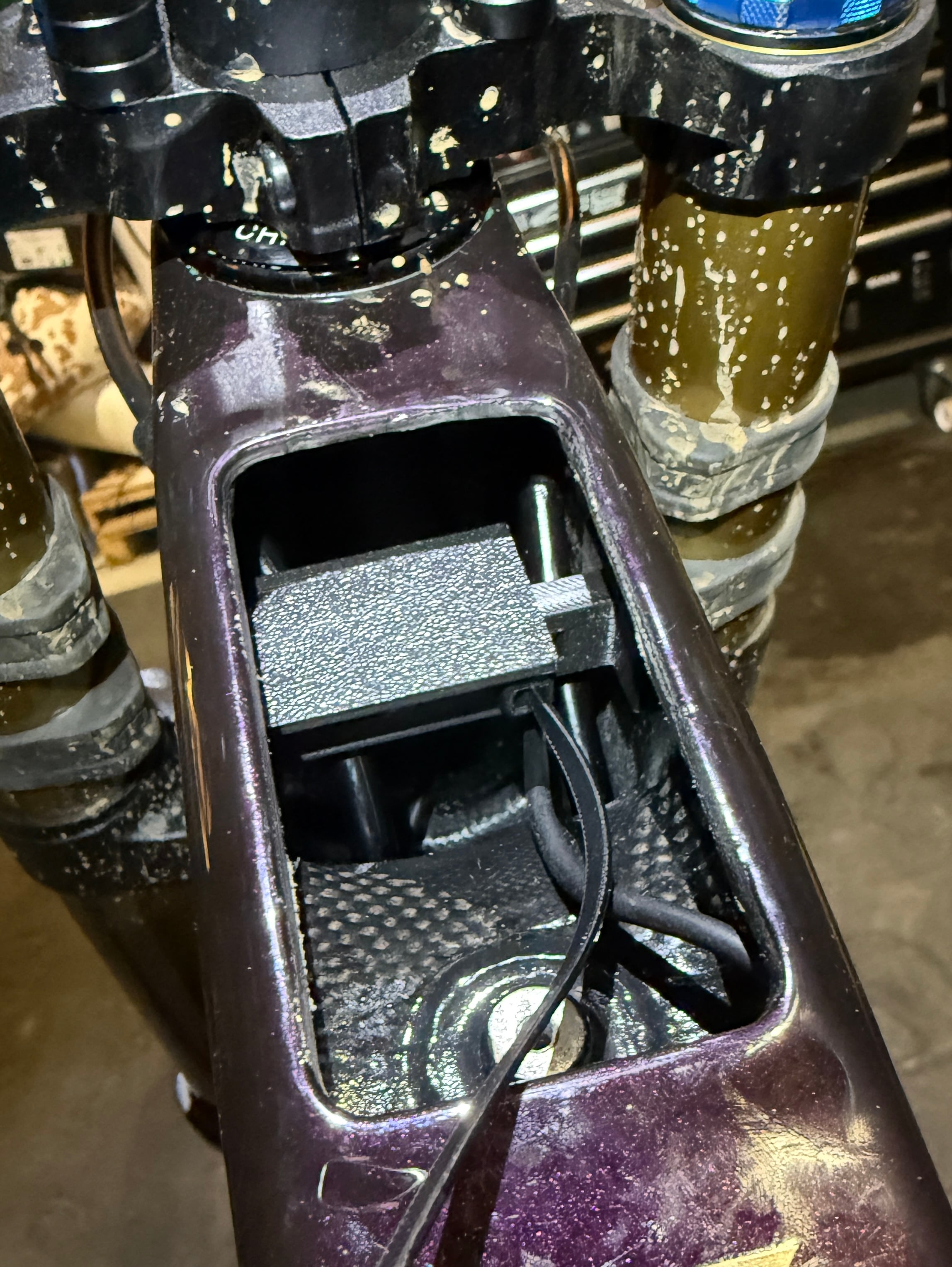

Looks good!

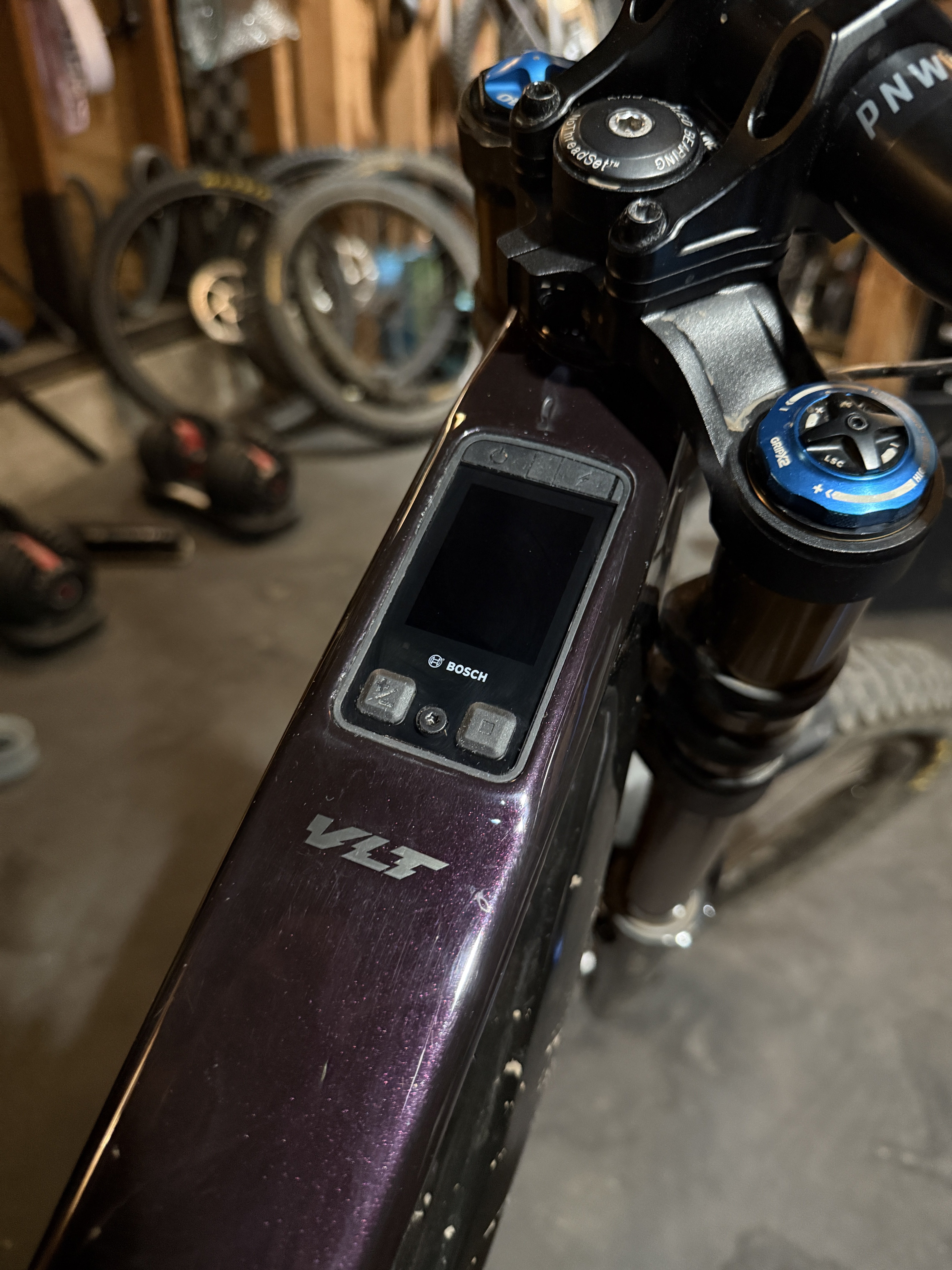

I also got the display but when pushing top buttons it falls into the frame.
Did you purchase as a kit with some special frame mounting adapter or did it simply fit snug using the one bolt /machine screw?
Looks good!

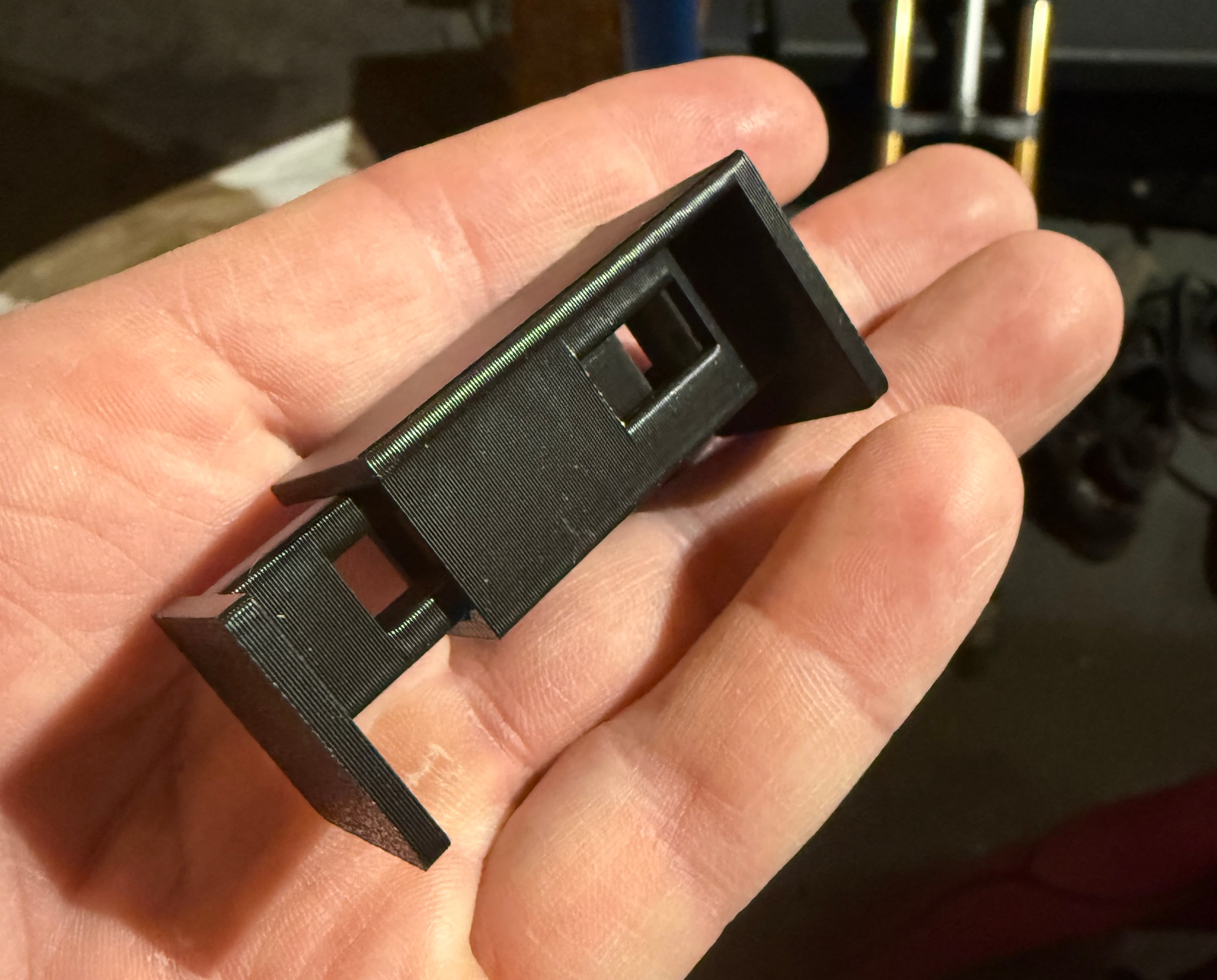

Went overboard and made a little 3d printed shelf for the front end of the display to sit on. Massive PITA getting it in but ultimately it did the job.
Here's the link to the file if you want to try.
A few install notes:
-Bridge ends get gorilla double sided mounting tape
-Zip tie goes through the holes and gets tightened to create the outward thrust to keep it secure
-Ended up having to snap off the "leg" extensions to get it to fit (kept catching on the internal cable tubing)
-That extra piece in the file is the depth jig so you can get it set at the right height. I ended up gluing 1/16" of material to it to set the bridge slightly deeper. YMMV
No bar remote here either. Whatever convenience it might offer was eclipsed by the very real problem of accidentally switching modes while pounding downhill.
There are a few jumps/drops that require some clutch pedaling on the run in and I absolutely do not want to discover I've accidentally put myself in turbo (or worse in eco/off). No bueno.
Never thought about that. Good one. On the eeb before jumps I brake and then pedal towards the jump before the assist cut out.

Looks good!

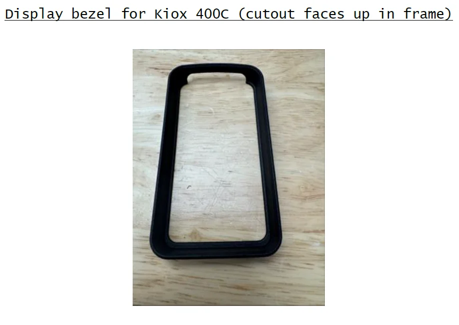

I emailed Norco about the Kiox 400c, they shipped me a molded plastic surround (as shown in the photo) at no cost.

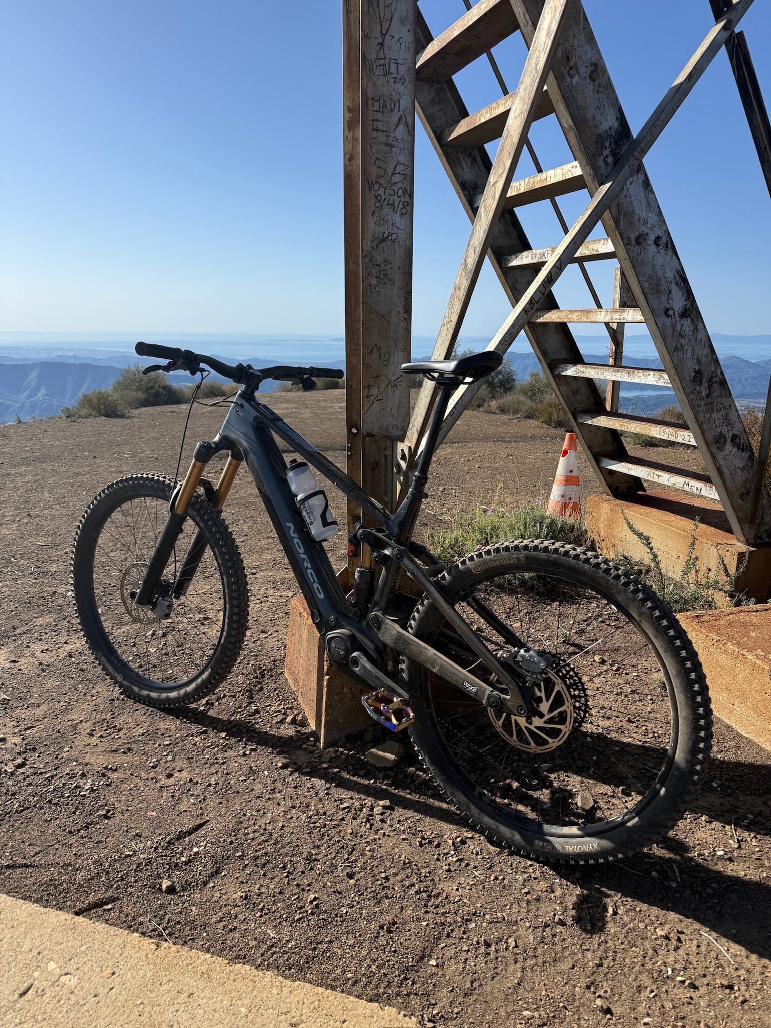

My size S4 C1. Made the following mods and she’s perfect:
•Hayes 220 rotor in front
•Moved Shimano 203 front rotor to back
•Swapped in Kiox 400c display (see post above about bezel/surround from Norco)
•Super Deluxe Ultimate coil shock
•PNW carbon 38mm riser bars
•3M glossy vinyl wrap over top tube (I believe the all white top tube makes her look more proportional.
•Powermore range extender (we have huge vert out the door)
I am 6’ 0” 210 lbs, and the reach on an S4 is a nonissue for me. IMO Norco has it right. Spring rate on the coil shock is 500 lbs.
Previous emtb was a gen 1 Transition Repeater.
Found another pic from before I applied the vinyl wrap to the top tube, if you’re curious. Super clean
It is as clean as they could possibly make it. Emailed norco for mine immediately.
The only way to do it better would have been to go ahead and remake the S4 mold when they realized it was effed up 🤣

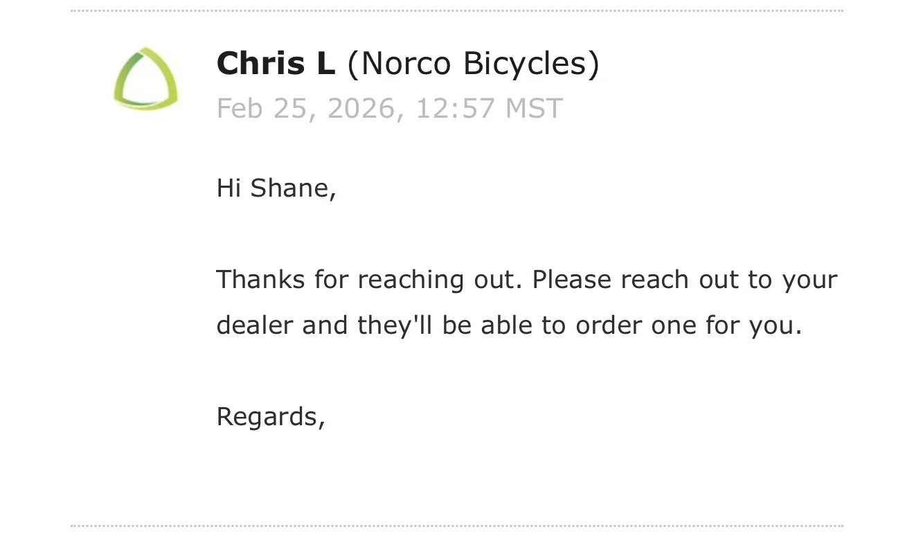

Update:
Norco told me to kick rocks and talk to my dealer lol
