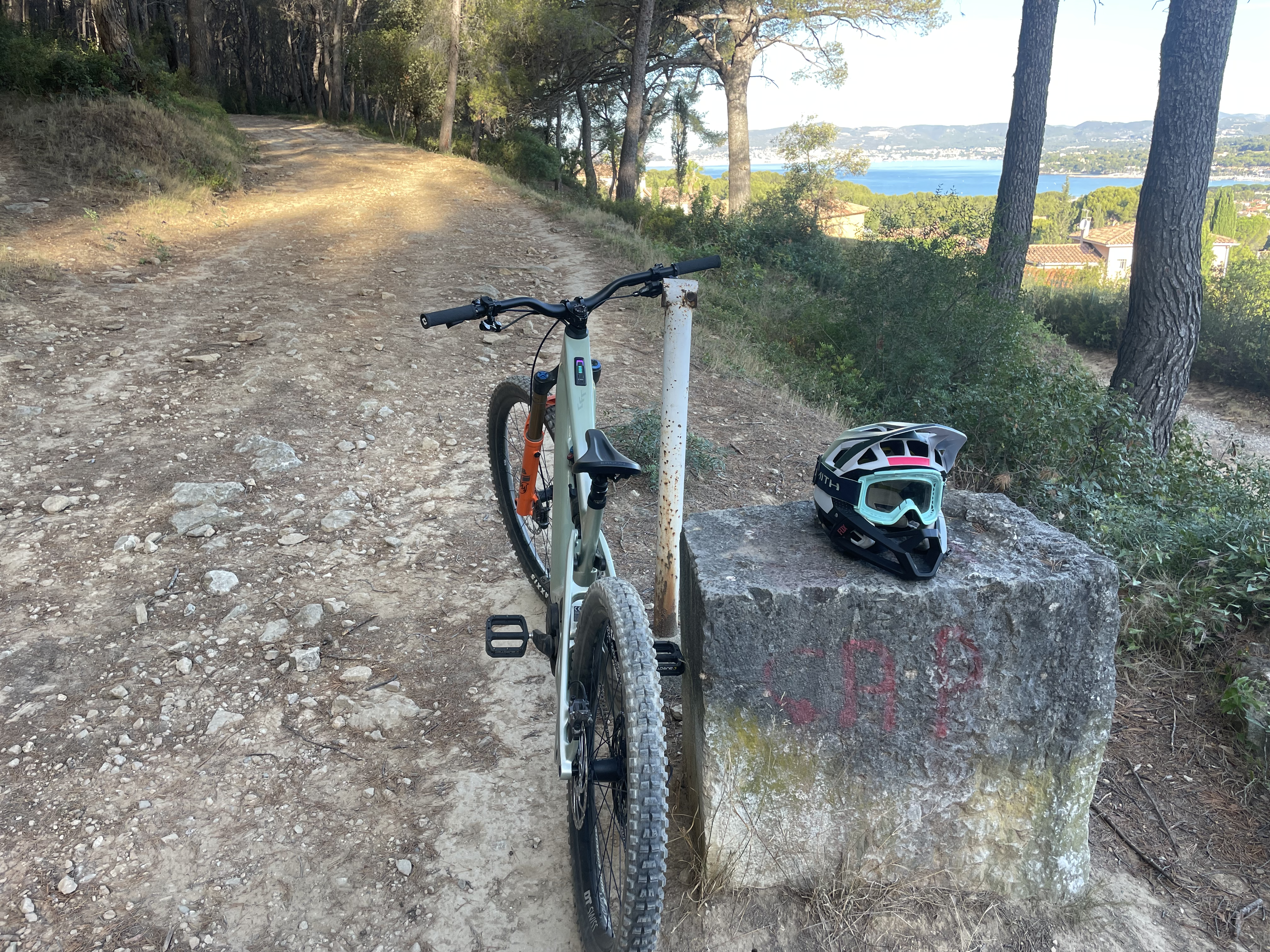

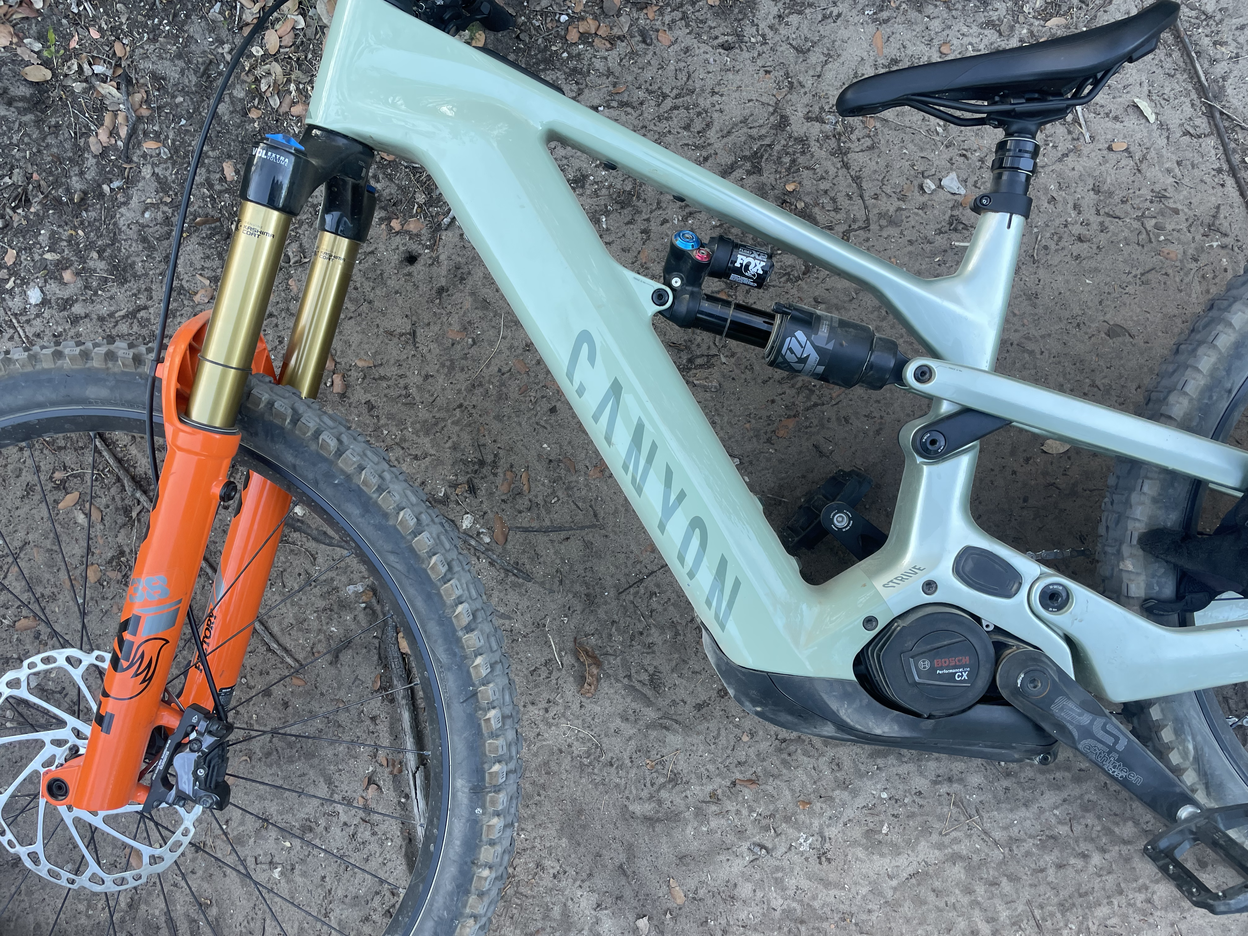

Sorry to speak again about rear suspension with X2 shock and maybe I worry for nothing as I like how the bike ride.
But it look like I use a lot of travel easily. I'm 75 KG 180 Psi that set me a bit under 30% of sag.
Even going up by some fireman road quite smooth I use more than 50% of the travel. this avoiding bump on that road if I don't I'm more at 75% of travel used going up.
Is that normal?
You can see where the O-ring seat after going up by smooth road and also a picture of how that road to climb up to top of bike park look like. Nothing demanding on rear suspension.
I thought that Fabien Barrel said that the Strive on suspension was made to have a lot of mid stroke support?
Is that normal?
View attachment 120155 View attachment 120156

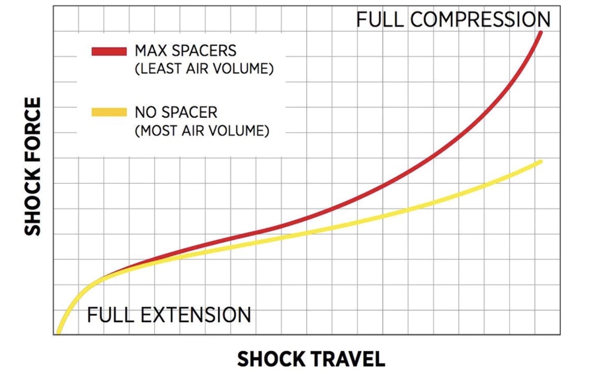

Also worth trying a small volume spacer?
To my understanding Volume spacer help mostly on end stroke. If I get it right
I think it will not help much mid stroke
X2 graph spacer vs no spacer

Did some test pedaling on the road access to my house ( dirt road) try 180 psi Compression fully open then fully closed then 185 psi Compression fully open then fully close. it's always about 50% of travel used No change.
look like it goes very easy through the first 50%. Maybe it's because it's the first bike where I can see the shock when pedaling that I get paranoid 😃
Some tester on PB have use telemetry and find out the best set up on his fox shock was Fully open LSR and fully closed LSC. I will try that tomorow.
An other tester on Bike radar says that the Fox X2 need to be ride with every thing fully open!
I think that's a regular criticism of Fox suspension; that you need to ride with everything open unless you're on the heavier side.
Went this morning to test LSR fully open and LSC 3/4 closed felt super good downhill. Bike have very good pop for jump and felt very stable on rock garden.
I try LSC fully closed but was too harsh. try LSC half open and felt using too much travel.
Still using 50% to 75% of travel going uphill but I think I will try forget about that.

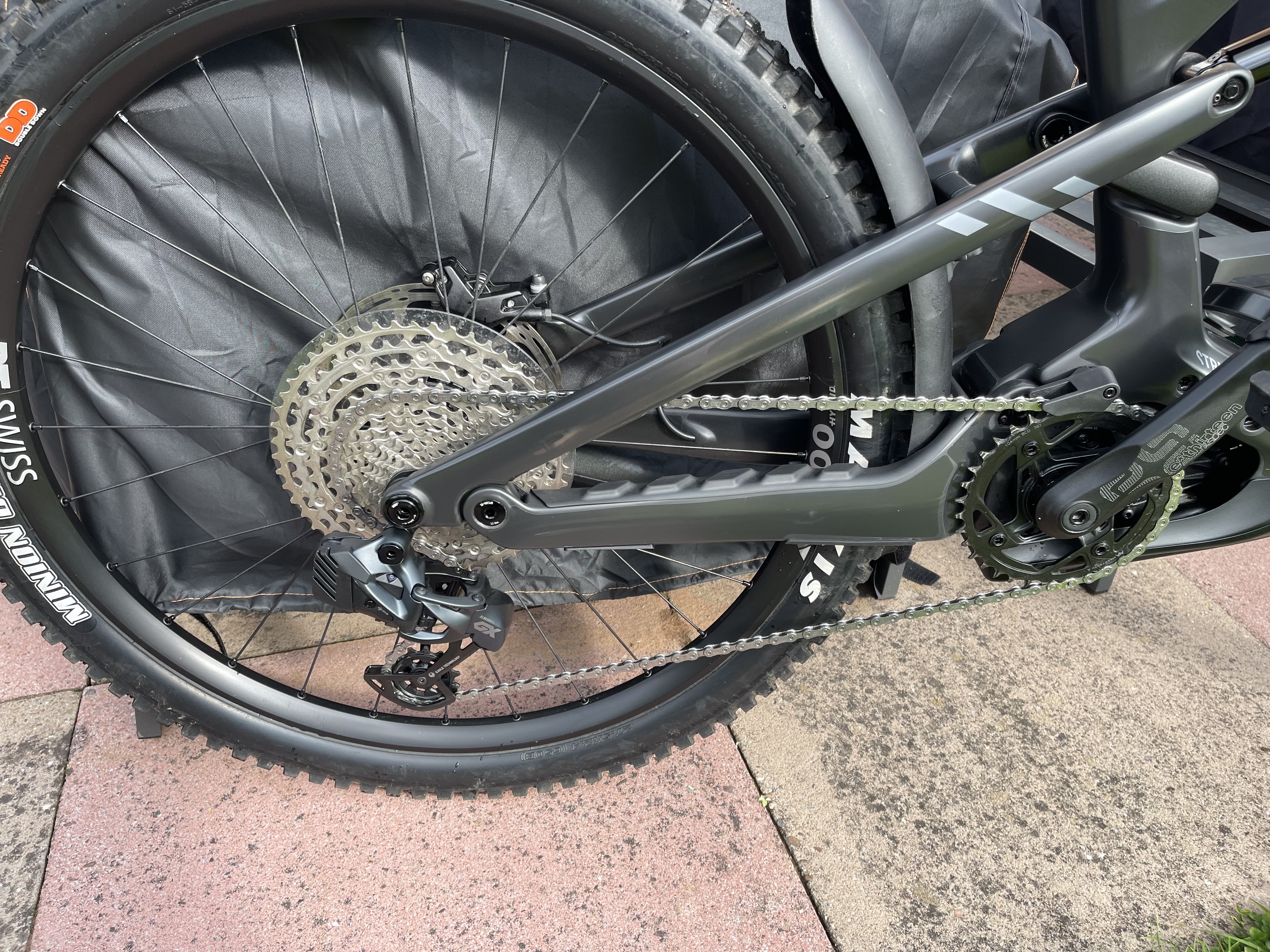

I’ve swapped the Deore mech out for SRAM AXS GX upgrade kit. Runs beautifully with the Shimano cassette and chain and I’m loving the instant always perfect changes and lack of cables.
Also such a simple install 👌🏻
