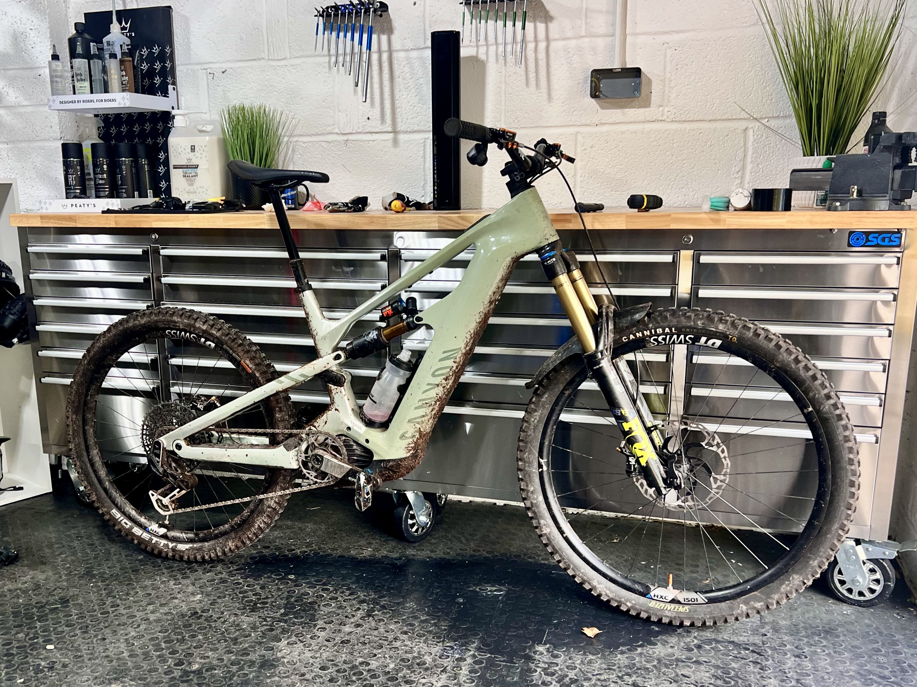

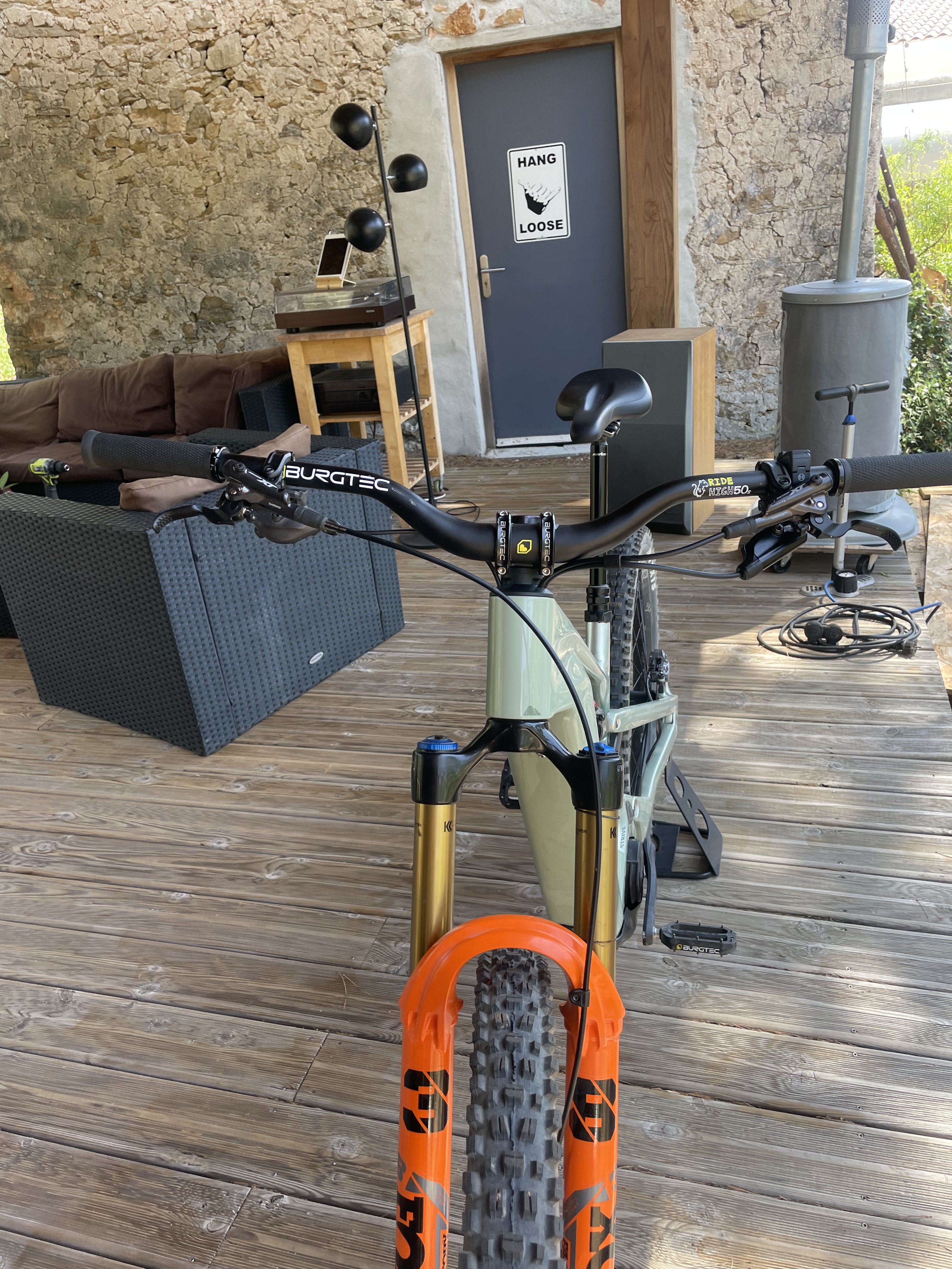

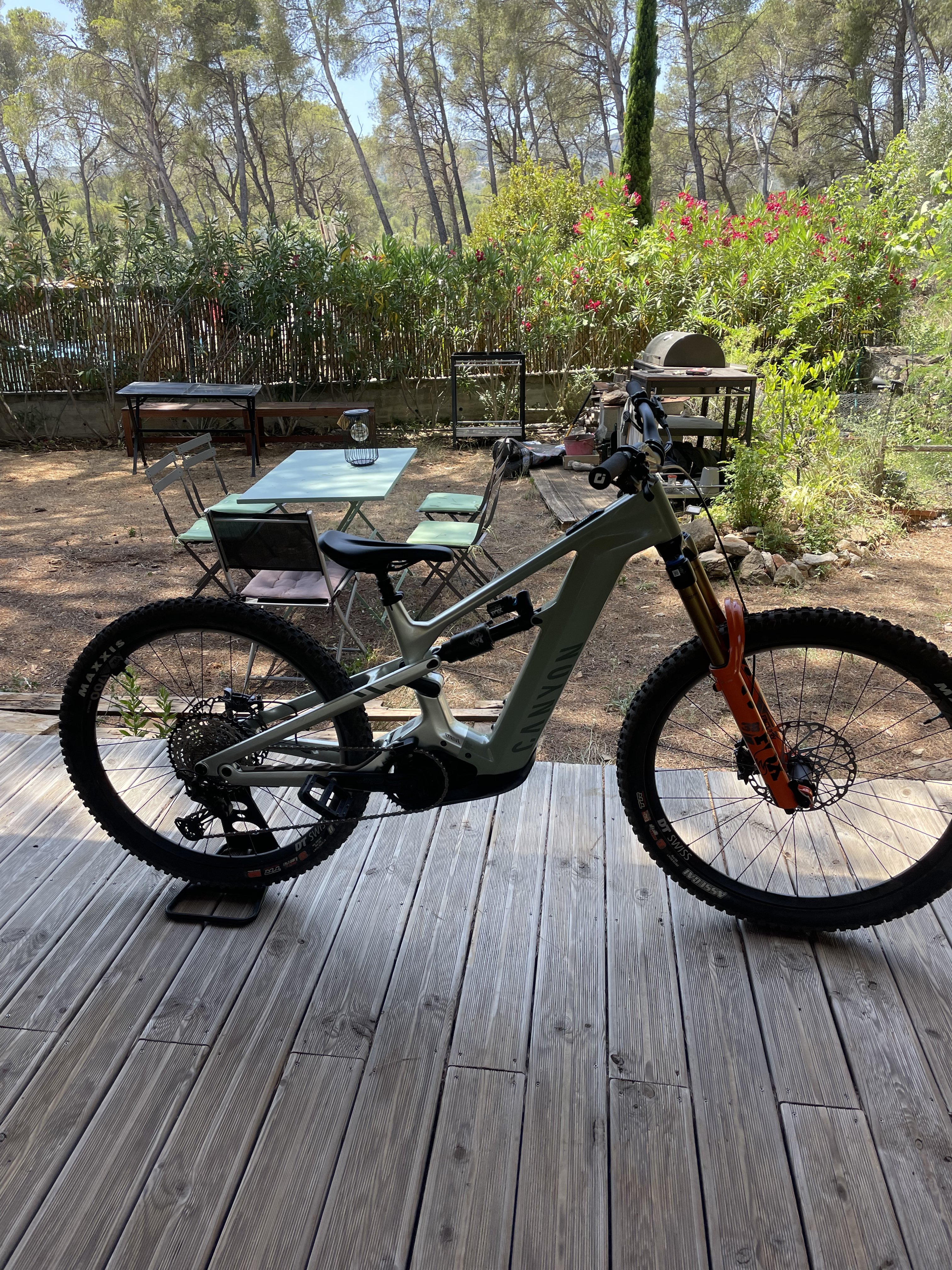

Reverb 200mm fit on size Small. Cable route even cleaner now .

Wow this is intresting! did you put some offset bushing to lift the rear and keep same geometry just 10mm higher?
"Big betty" I thought you would have a "Taky Chan" at the rear
slashed the sidewall on the Cannibal yesterday so all I had left in 27.5 was a big betty. But 2.6” sucks it felt like I had a puncture on the fast descents as it is quite wallowy, even in super gravity casing.
Just running +10mm at the front so it’s not that different to stock, just slightly slacker out front by 0.5 degree roughly and obvs 10mm higher stack. Reduced bar height spacer by 10mm to compensate a bit.

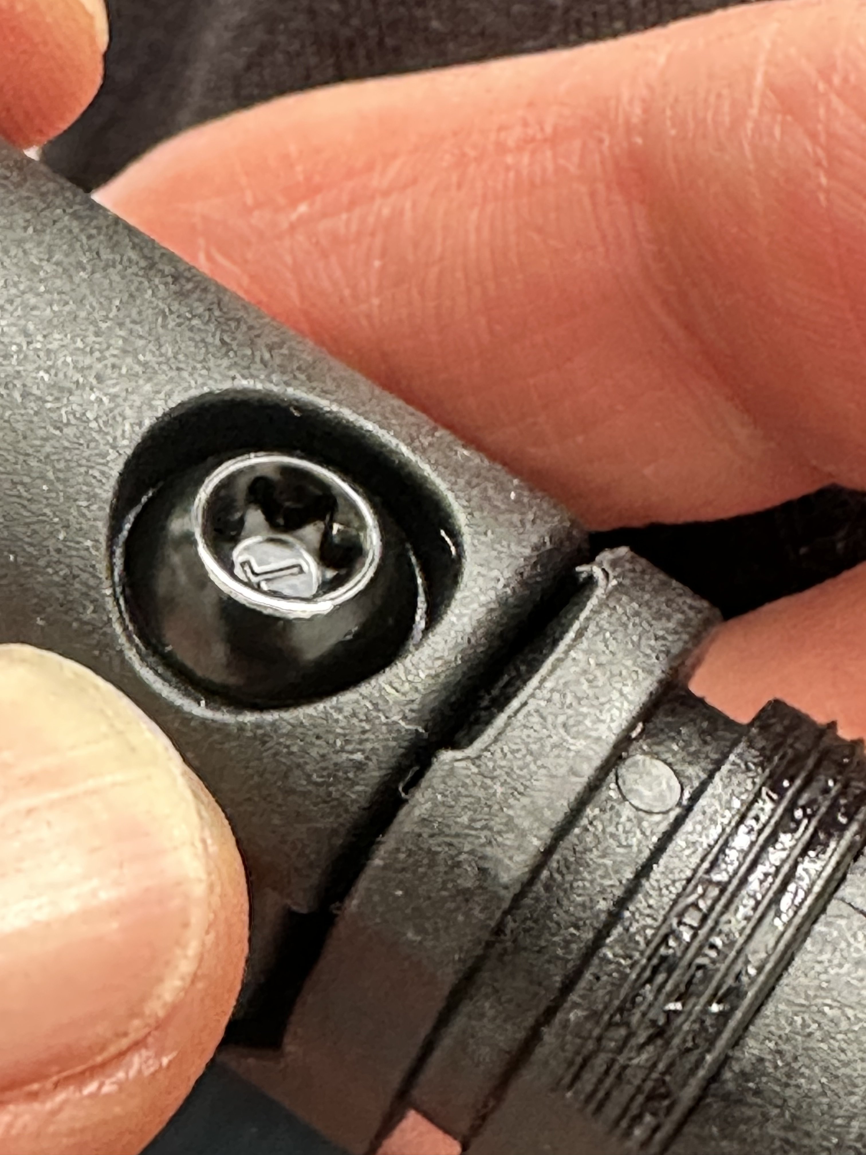

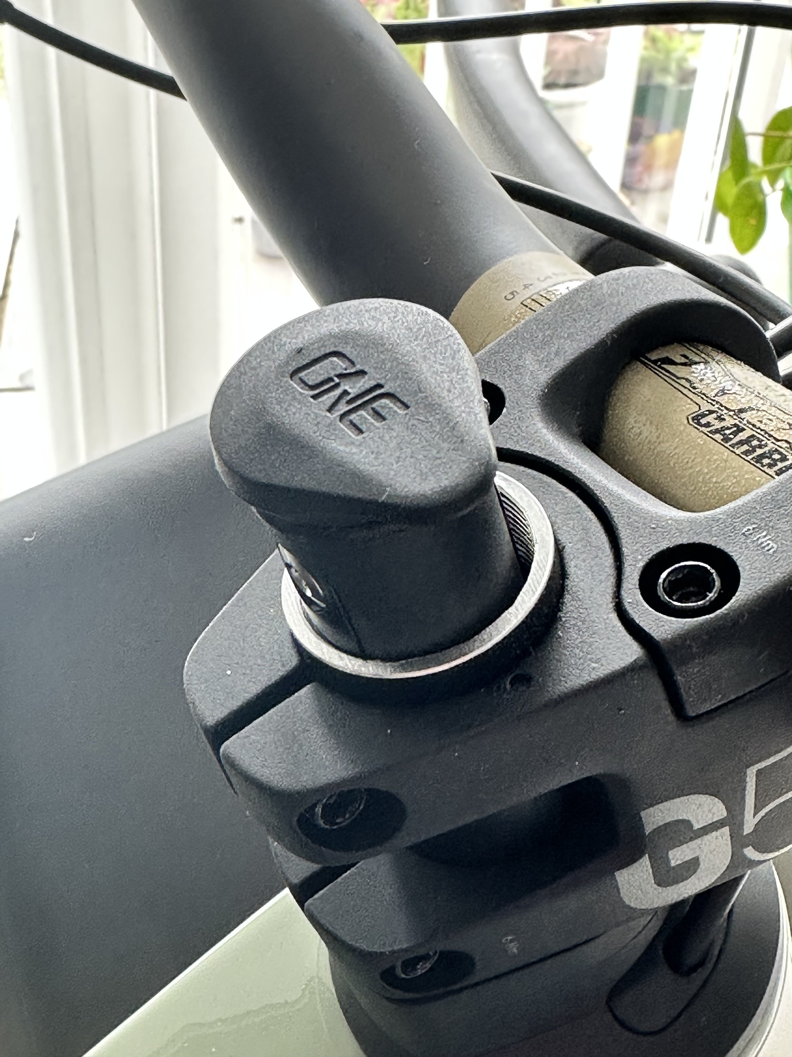

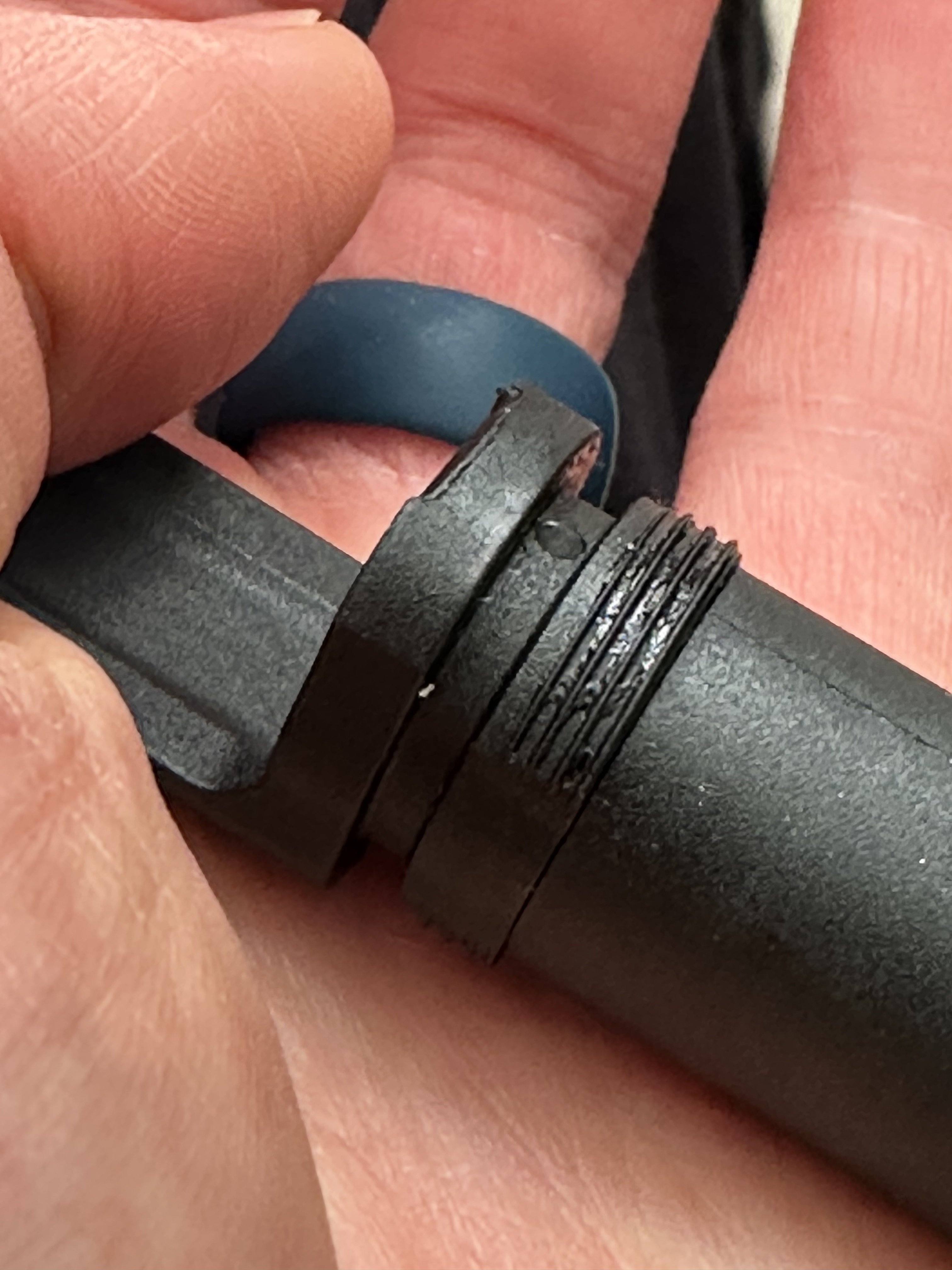

Another question - regarding the EDC Tool, how much do you need to shave off of the large capsule to make it fit? And from where? Or is it best to just wrap some sandpaper around it and sand it down until it fits?

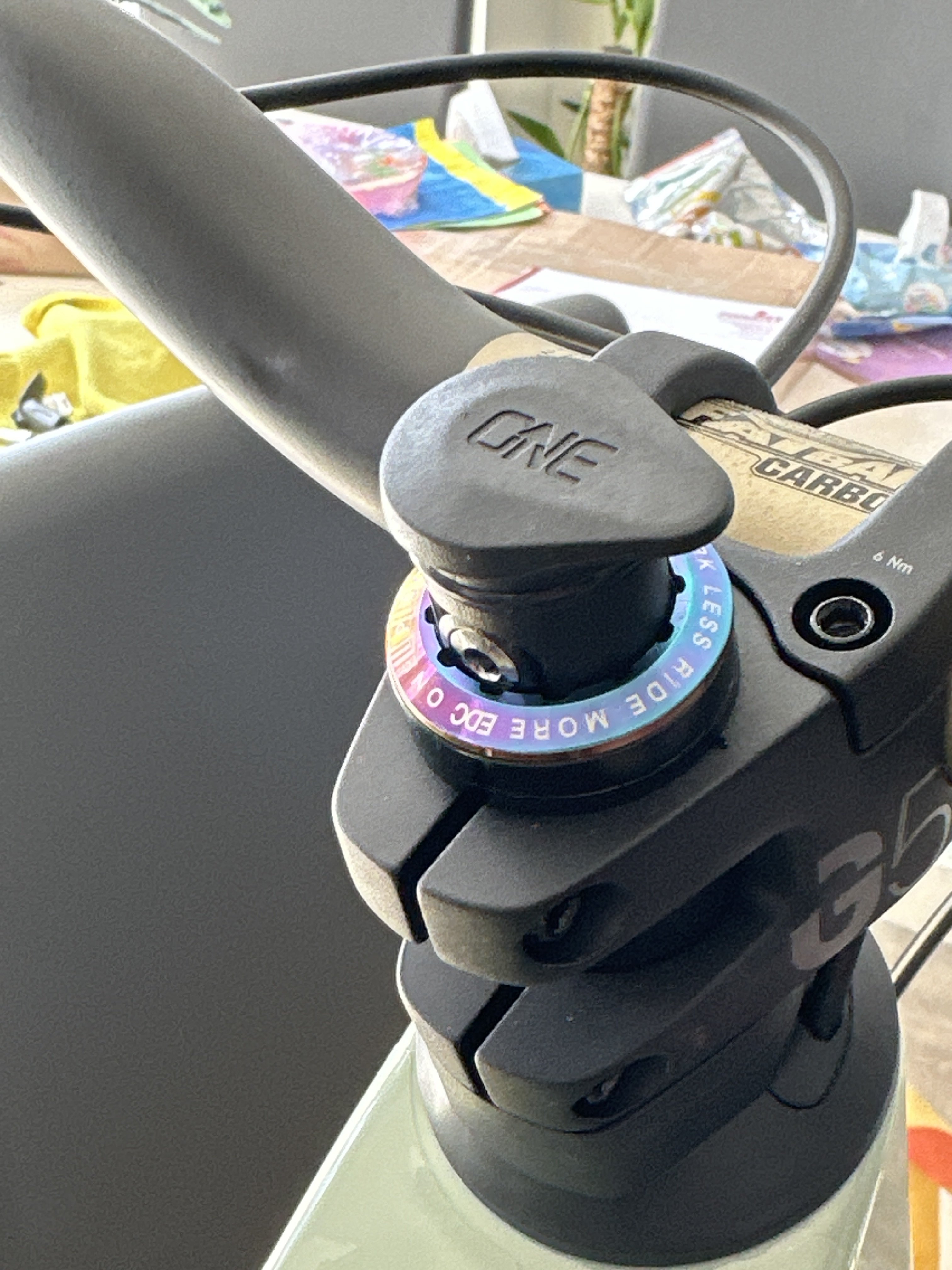

Also, I can't get the flippin' thing in the steerer tube. Any ideas why?
I've tapped the steerer, installed the threaded top cap and tightened the stem back up, and even installed the special O-ring from. The back of the packet, and it's very hard to get the tool into the steerer (the new O-ring doesn't help), but with a bit of force it goes in, then gets stuck like this.
I've given it a whack with my hand a few times and greased the O-ring and the inside of the steerer, and even tightened the bolts on the multi-tool, but it doesn't seem to want to go in and is much stiffer than expected... Help!
(The tool, has the small capsule on it, FYI.)
I assume it fits fine with just the small capsule?
No, it's getting stuck like in the pic even without any capsules and with the star washer removed... Any ideas?

Will it fit with the multi tool removed completely (and the plastic holder thing)?
Just trying to eliminate what it could be.
I assume you fully removed the star nut that was already in the fork!. Is it completely free in the steerer of any debris?
I’ve never had this issue on 3 fox forks.
I'll remove the multi tool and see. I already changed the orientation of the tool and tightened the bolts on it.
Yes, I completely removed the star nut. The steerer looked free of anything and I poked several pieces of kitchen roll down there to clean it all out after tapping the thread. (They all pushed through fine.)
I'm just at a loss as to why it won't go in. Also, seems odd that the top ring shredded my anti-rattle star washer so fast. 😩
By using a 2.6” tire at the back and 2.4 at the front you change the front back balance by 6mm in “theory “ so just 4mm from that 10mm increase of fork length. If I don’t mistake.

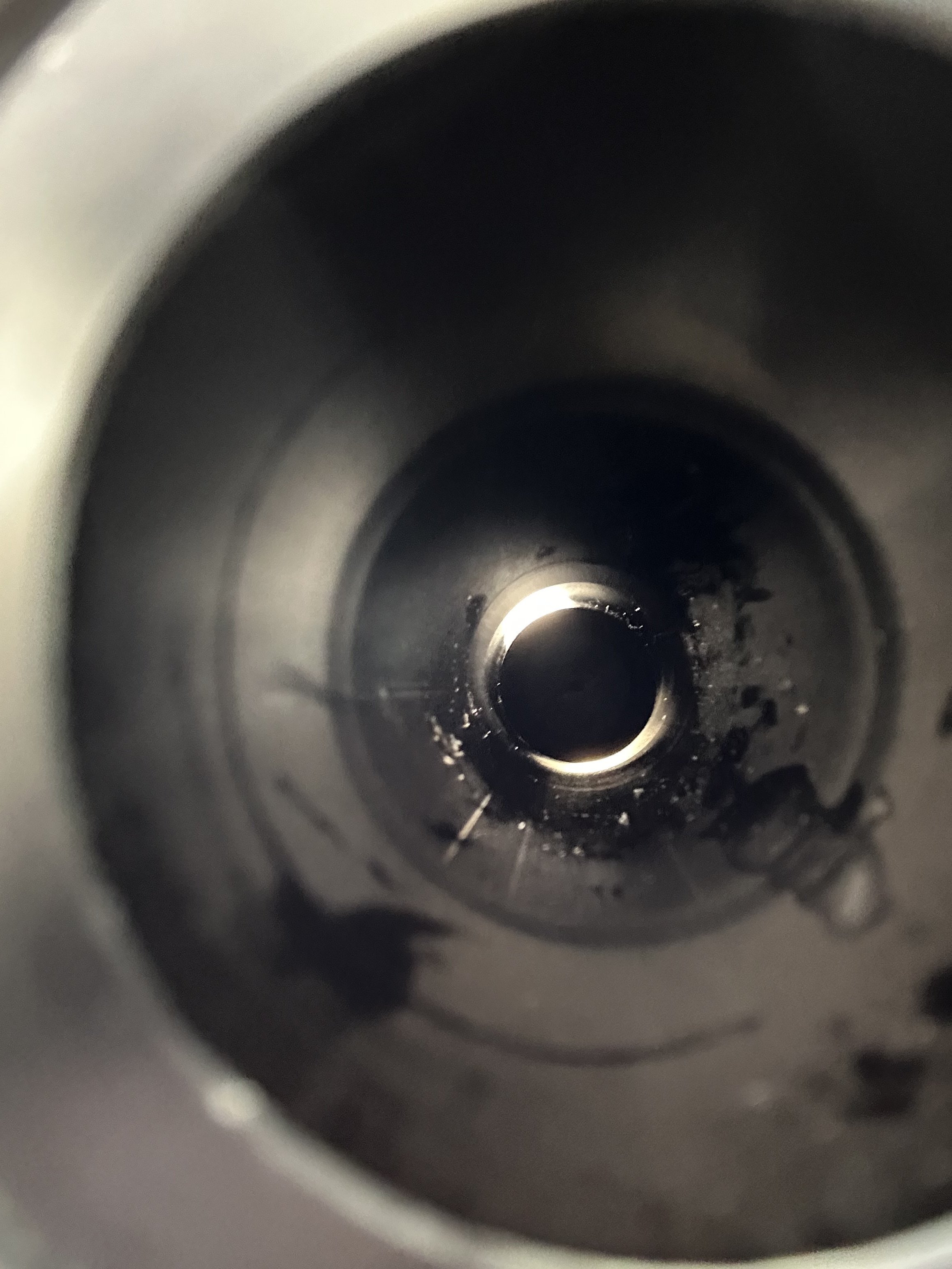

Has anyone with the Fox 38 Performance Elite included with the CFR successfully fitted a OneUp threaded EDC V2?
Only, I'm having no luck at all. It seems that the steerer narrows as it goes down and the tool cannot go in far enough.

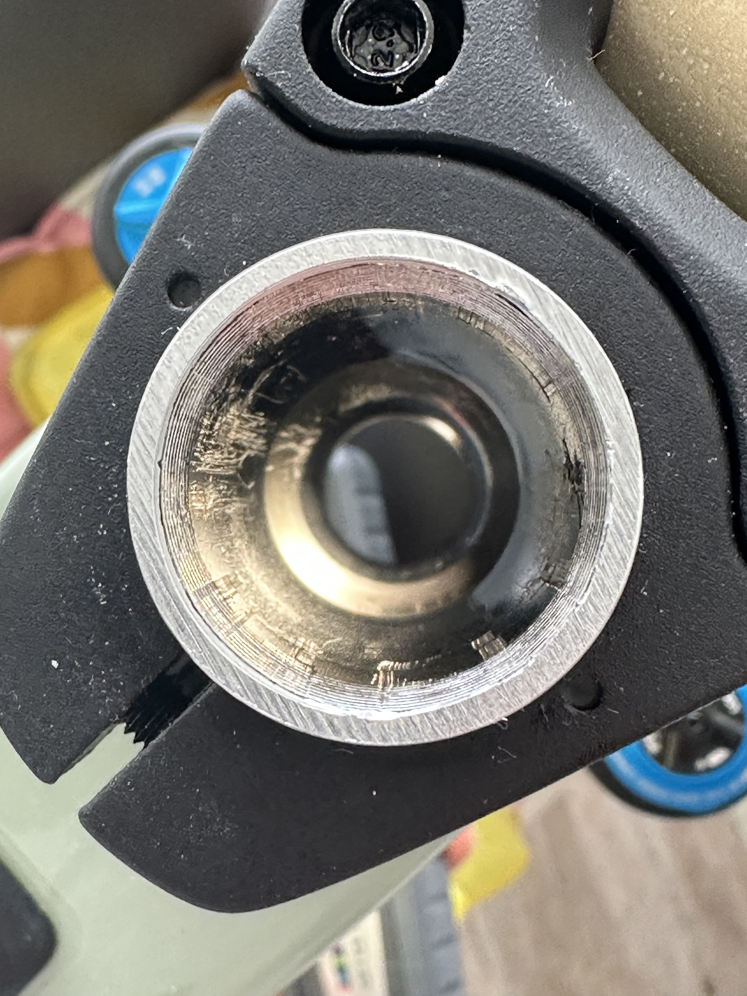

I've removed the multi tool and the small capsule and the tyre lever and it still won't go in. It seems to get stuck k the shoulder just after where the capsule screws on. You can also see where the paint has rubbed off of the spare disc bolt.
I removed the EDC top cap and the bottom plug and stuck the tool in as far as possible# then shone a light from the top whilst taking a photo from the bottom.
Looks like a square peg, round hole issue.
I wonder if the fork steerer has recently changed? Or the design of the EDC tool?

So strange. It *should* fit no problems.
Sadly not. Does your steerer taper-in like mine?
The shoulder of the tool seems to butt up against the part where the steerer tapers in.
I'm wondering if Fox have recently changed the steerer. Of course, you have a different fork, so perhaps that's why yours fits.

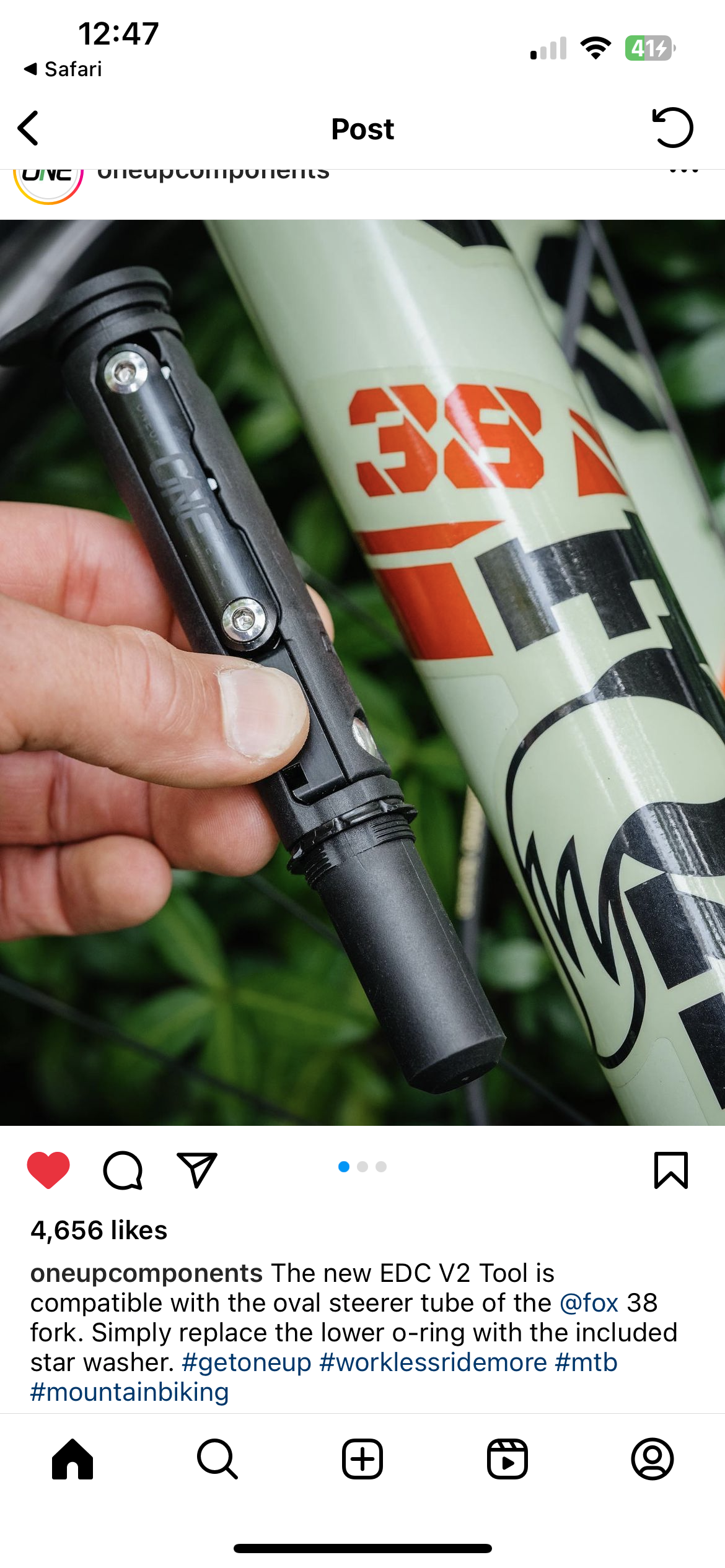

Also, I'm guessing that nobody with the standard CFR forks (Fox 38 Performance Elite) has fitted a threaded EDC V2?
I'm in contact with OneUp and they have suggested that there's 3 steerer types with the Fox 38 and it's not always clear which fork will get which type. As such, it seems that the one used on the CFR has the narrow part too high to accommodate the EDC V2.
Obviously @Rob Rides EMTB fitted Factory forks, so didn't run into the same issue. I guess the steerer must be the same width on the outside so it doesn't affect compatibility with the bike...?
It's slightly annoying, but I think OneUp are going to put things right the best they can, even if it means I might have to go for an EDC Lite instead.
Just not sure whether to keep the regular EDC in my EDC pump so I have the additional tools - chain breaker, etc. Or send it back. Seems a bit silly having two of the EDC multi tools on me.
