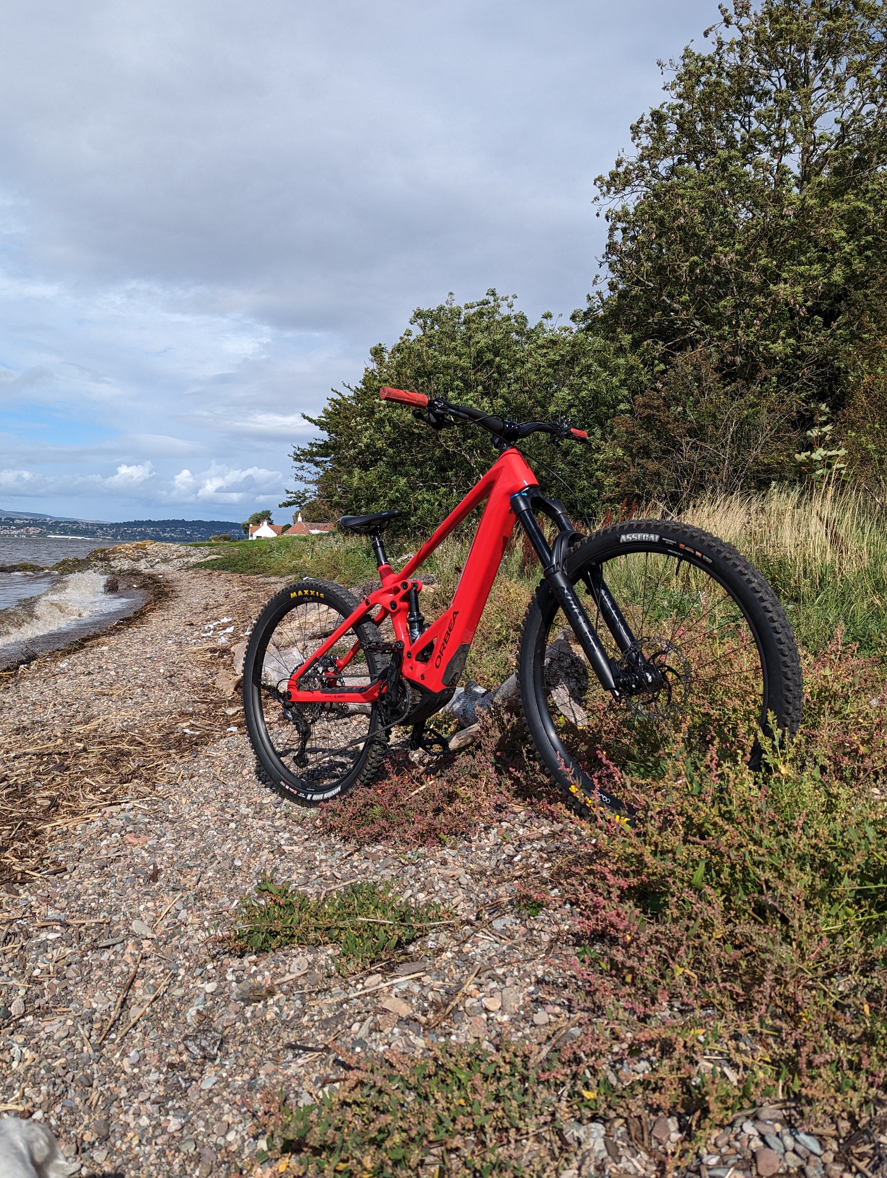

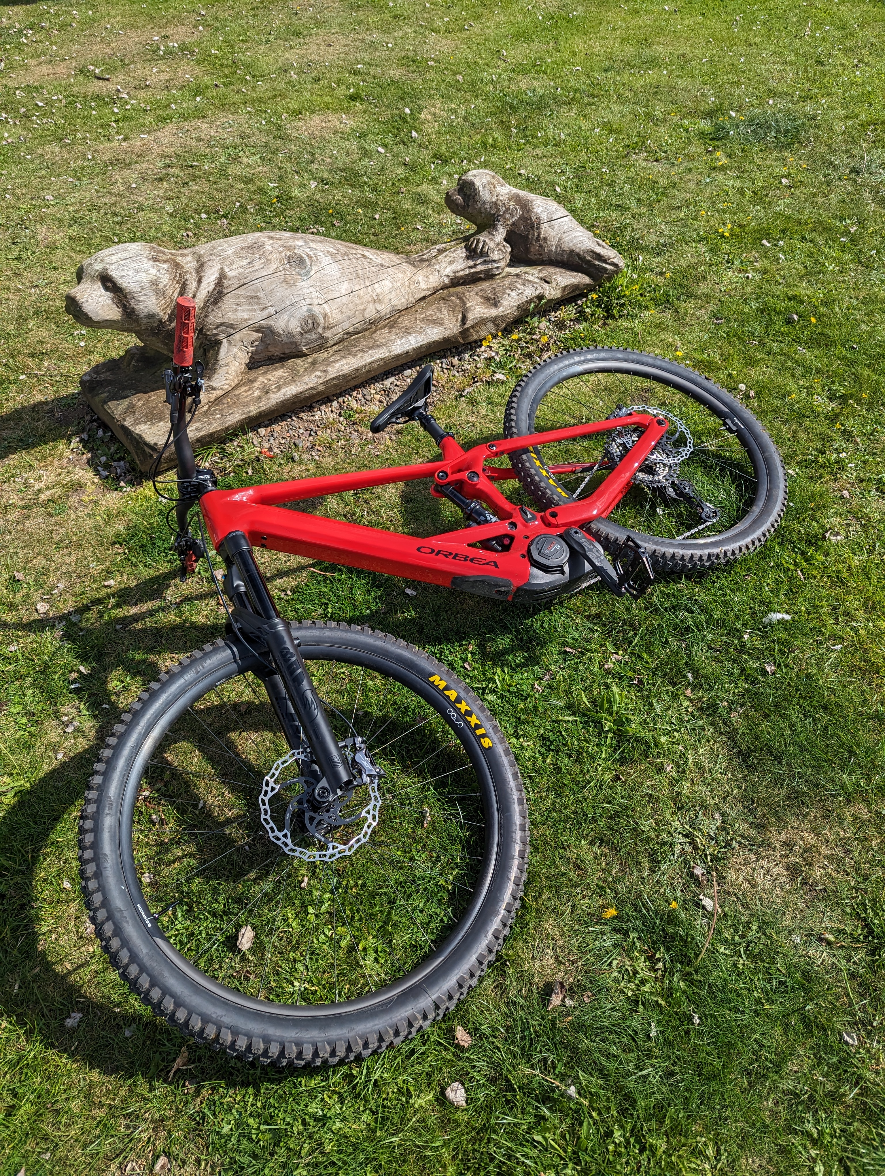

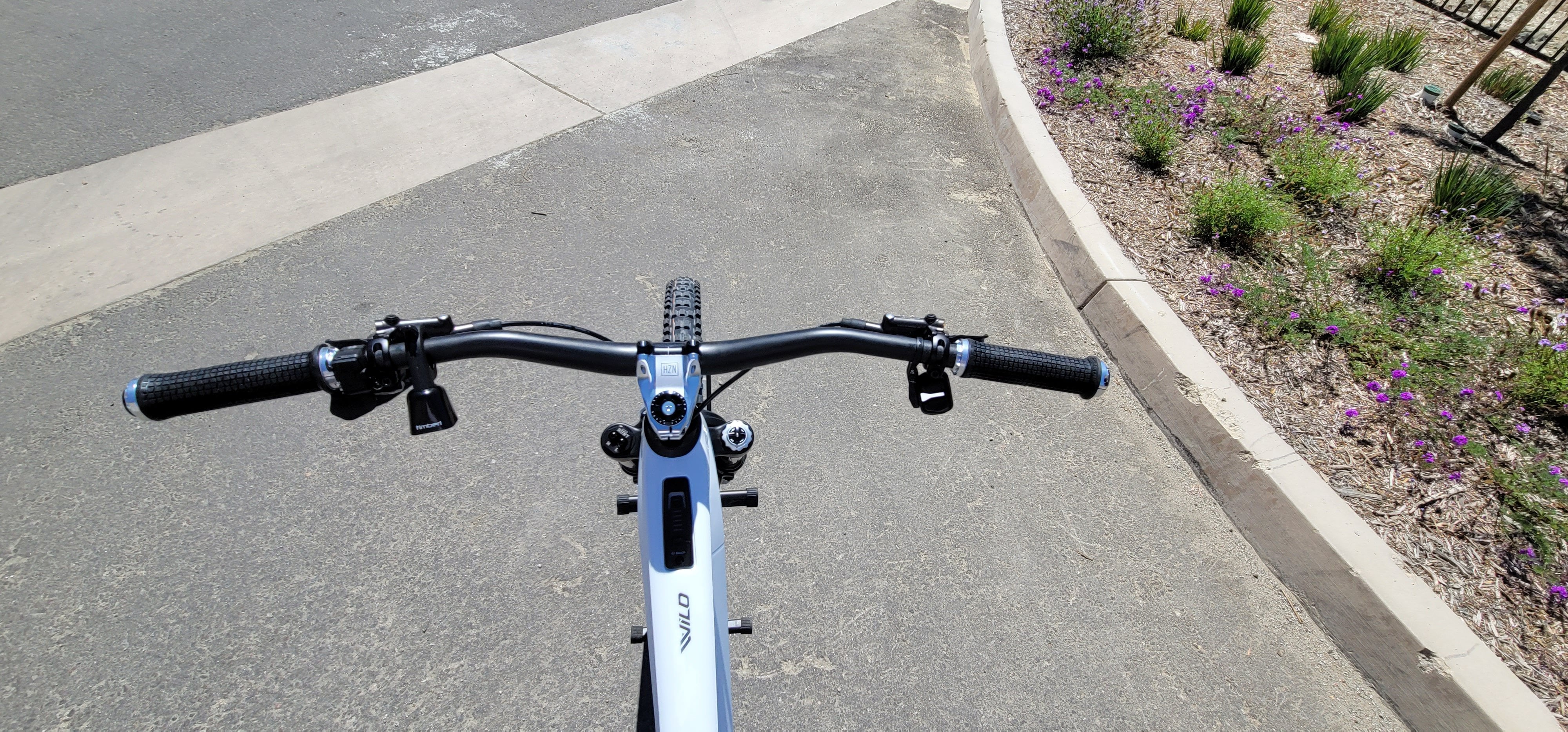

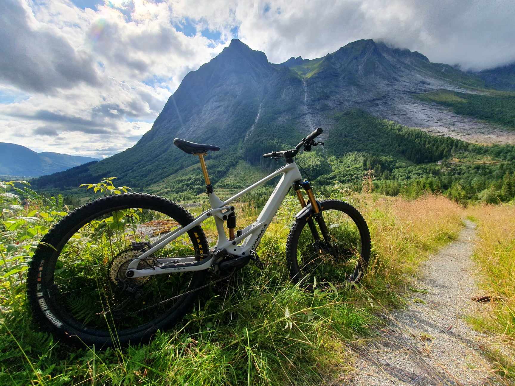

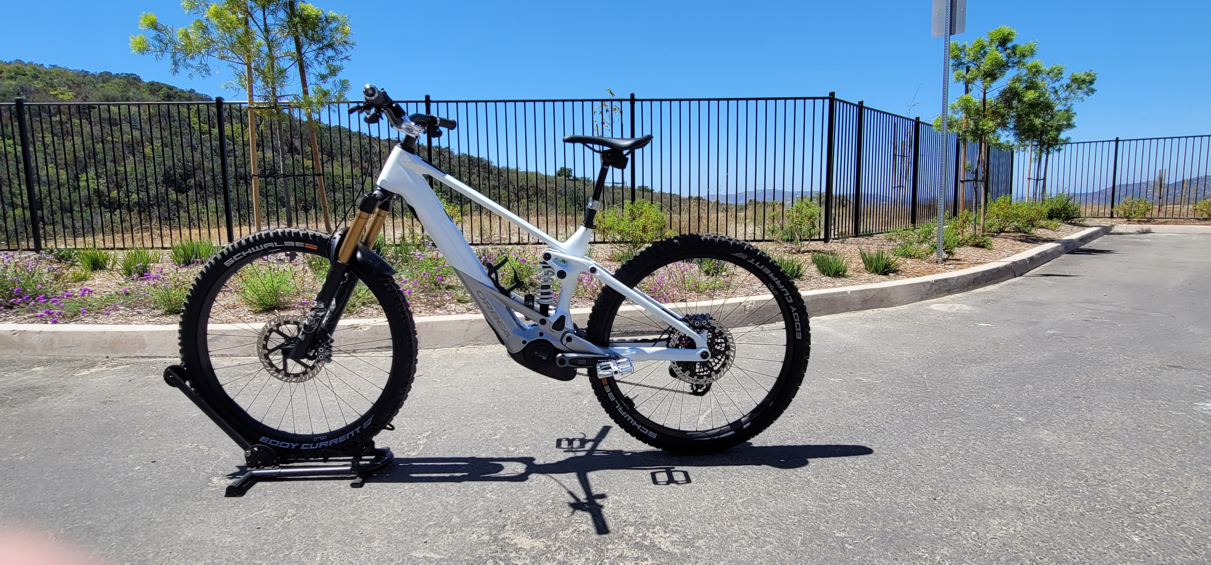

Can I ask what colour this is? The bike looks much better without the colour split just above the motor IMO.
Top/Bottom both in matte mouse grey (and black letters) Probably as generic and boring as it gets :p
I would most likely have gone for something different if I were to choose again, but I'd definitely still choose one single color overall.

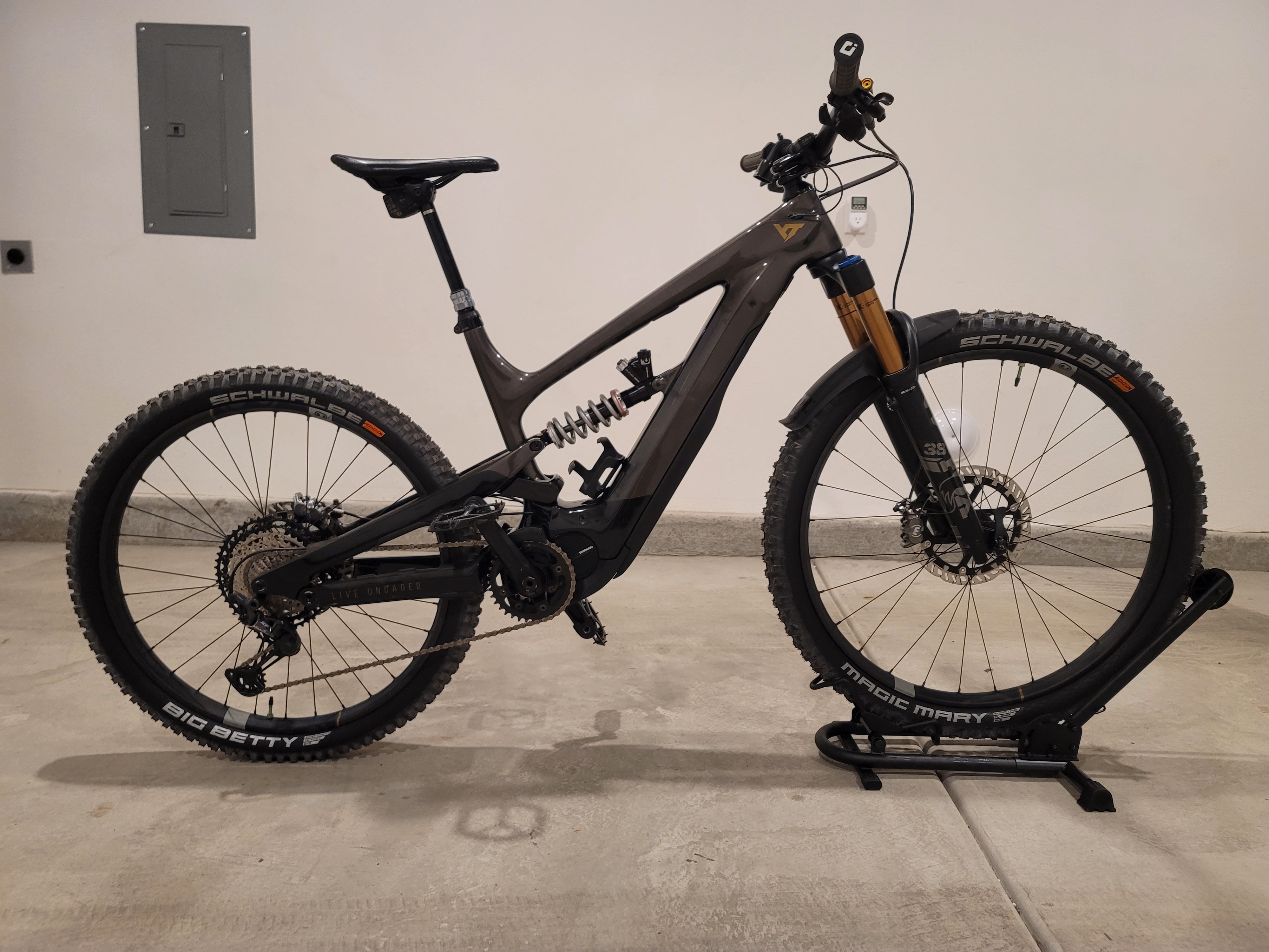

I think Orbea runs a lower seat tube to give you more options for longer travel droppers. Only have a couple rides on my new Wild, but it fit like a glove right out of the gate.

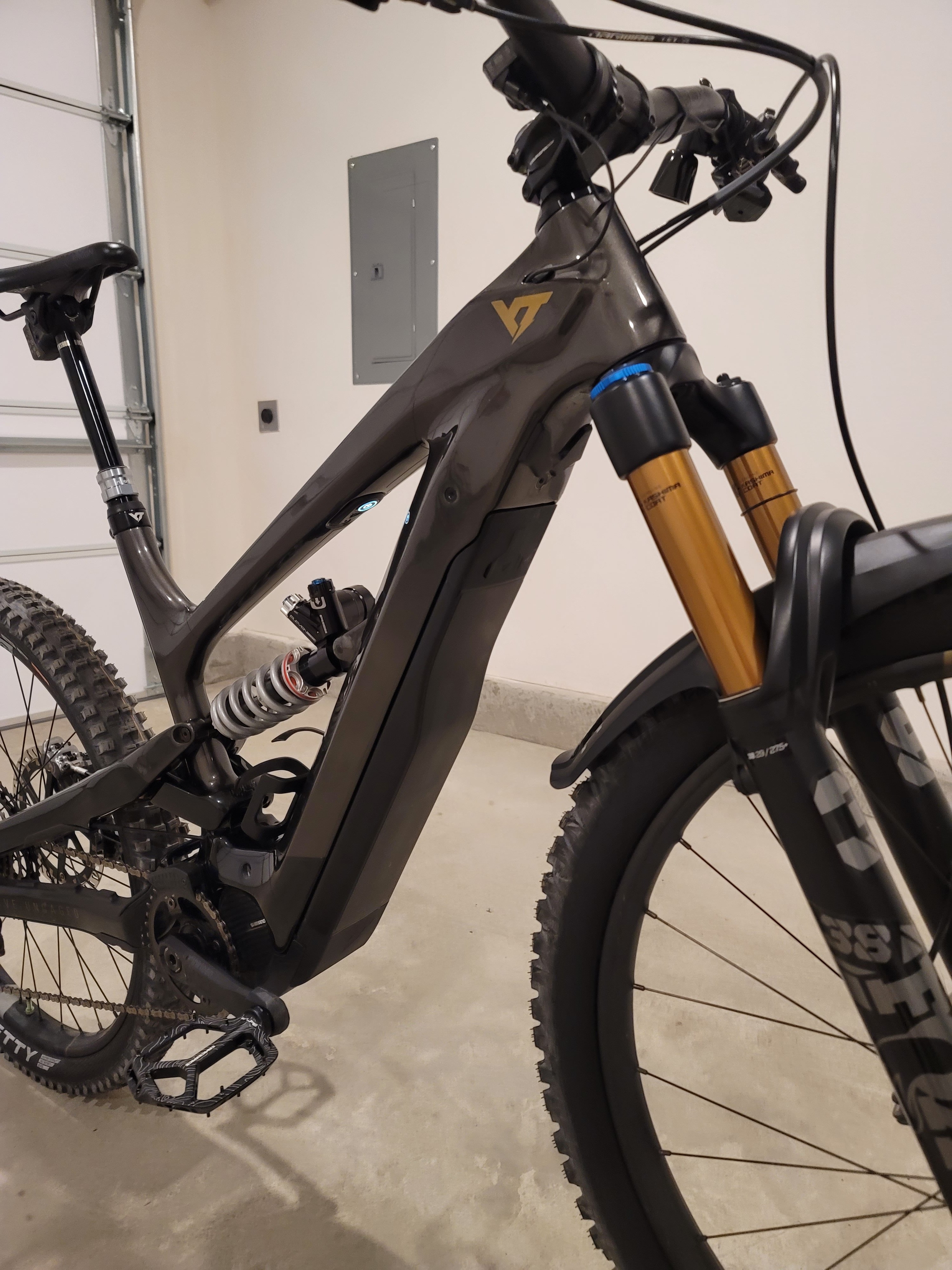

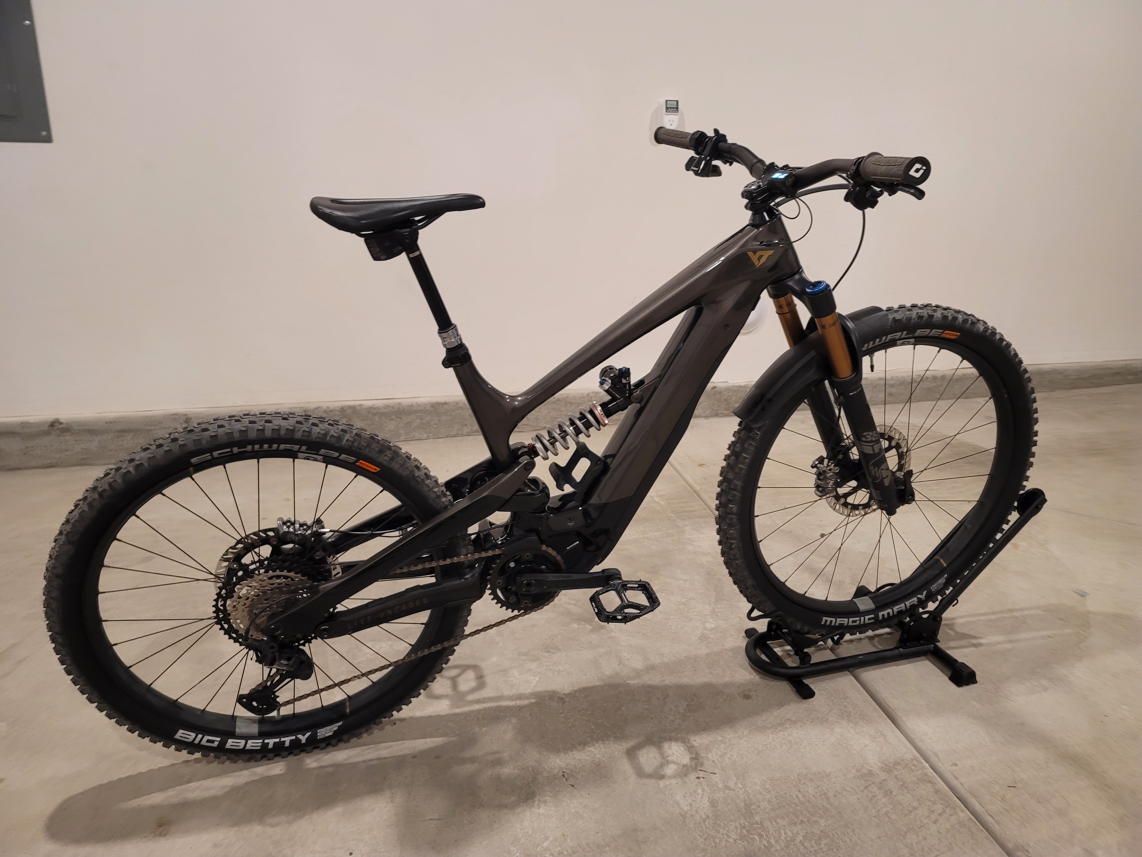

See pics of new Wild and of my YT Decoy that has a seat tube that's actually longer then most manufacturers. I can barely fit the same 170mm dropper.
Having owned 5 emtbs over last few years (too many Amish bikes over the years to count!) and ridden a few of my riding buddies emtbs, think the Wild is the best all-round bike I've ever rode. Climbs awesome, likes the flowy/techy stuff and more then holds its own on the knar!

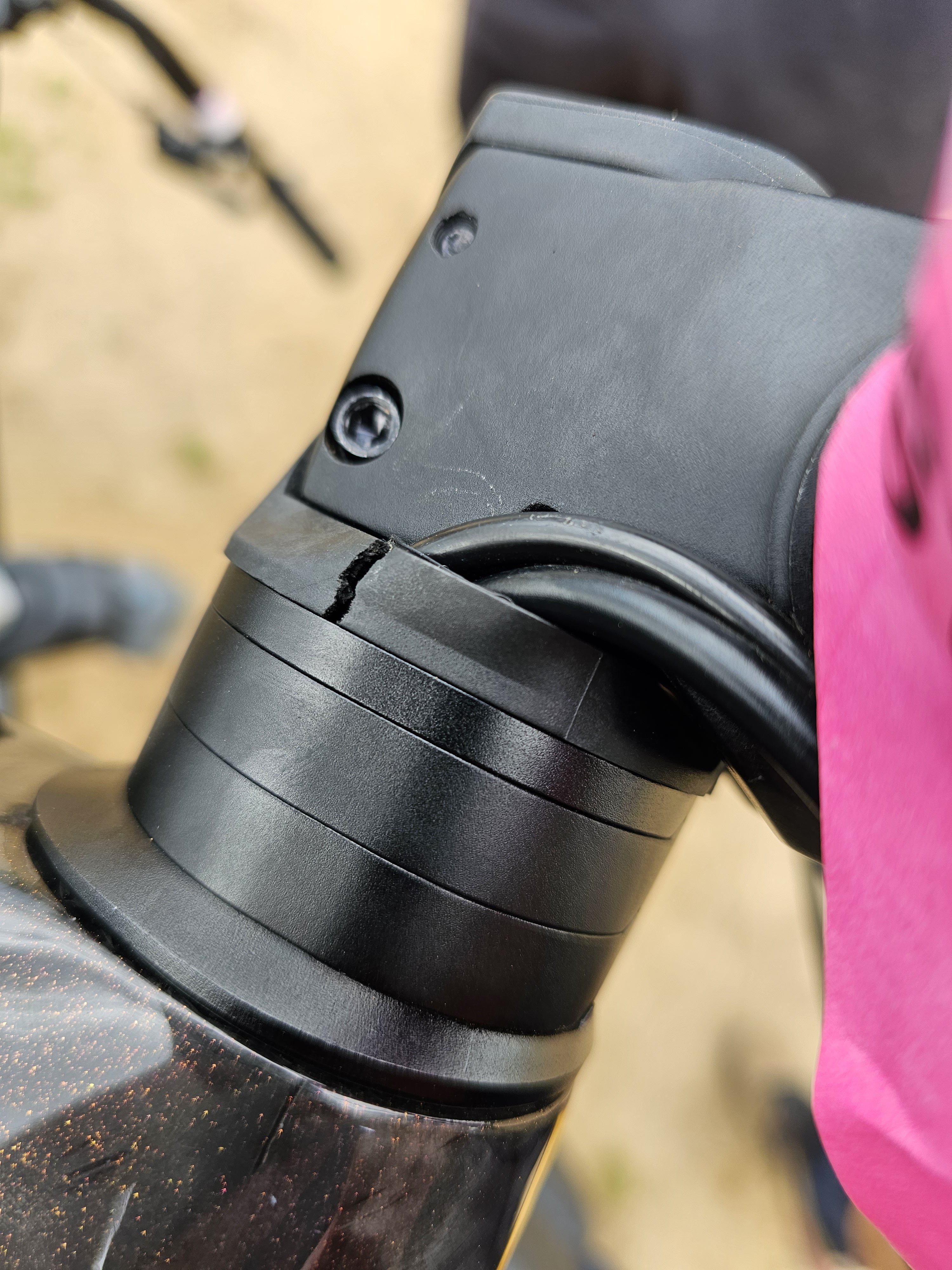

Hey, loving my M10 Wild, just took a very small tumble on it today in some loose wood chip stuff and it did this...
Stem had slightly gone to the left, all bolts torqued to the required Nm too if that helps.
Any ideas/thoughts?
It's in two pieces by the way, I just had to put it back together after straightening the bars so I could ride back to the truck.

Sounds like you whipped the bar pretty good on impact. Also looks like the weakest link let go. I would order the new piece and move on. Obviously make sure everything is straight and not damaged…
I had a get-off and the bar rotated right past the “stopper”. No damage done though.
You know what they say..if you don’t crash you’re not riding hard enough! 😊
Thanks for the comment, just my pet hate now is the stem and spacer setup. May just got for a different stem and spacers. I'm guessing that's absolutely fine/possible to do.
For sure. If mine ever does something similar I’ll swap for aftermarket stem.

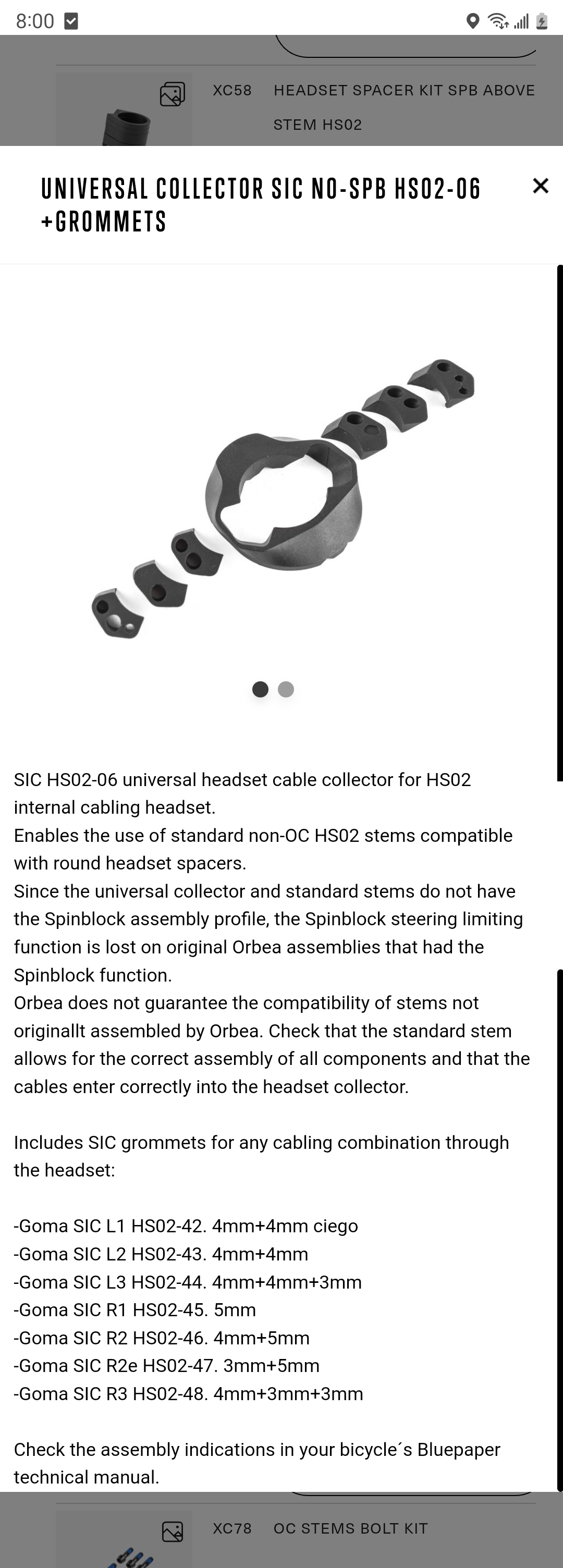

I never used the stock stem that came in my Wild. Use an aftermarket stem with round spacers. You will need to purchase this part if you choose to go that route.
Thanks @Singletrackmind, I've clicked the link but just loads the entire spare parts section. I don't suppose you have a part number or name please? Much appreciated.

This is what I was talking about(page 8) when the bike was released, no one mostly really understood what I ment. I would check that the brake hose wasn't crimped by the rotation of the stem you don't want to loose your brakes on a downhill...
Thanks for the heads up man! That could be a disaster!
Will 100% be going for an aftermarket stem now, the part in question that I would need from Orbea to stick with the stock stem wouldn't be with me until Jan 24. 😂
Hey man,
I don't suppose you have any walkthrough or pointers for me, I believe that I am going to have to strip the cables etc off of the dropper post, brake leavers and gear shifter to then re-route the cables through the new part.
Is that correct?
Thank you.
Unfortunately you will have to strip off all the cables. I am running SRAM AXS Dropper Post and Transmission Drivetrain, so I only had to run the rear brake cable and did this when setting up brand new bicycle. You may want to strip the cable ends on the Handlebar side, route through the openings on the new part then mount the aftermarket stem and round spacers.

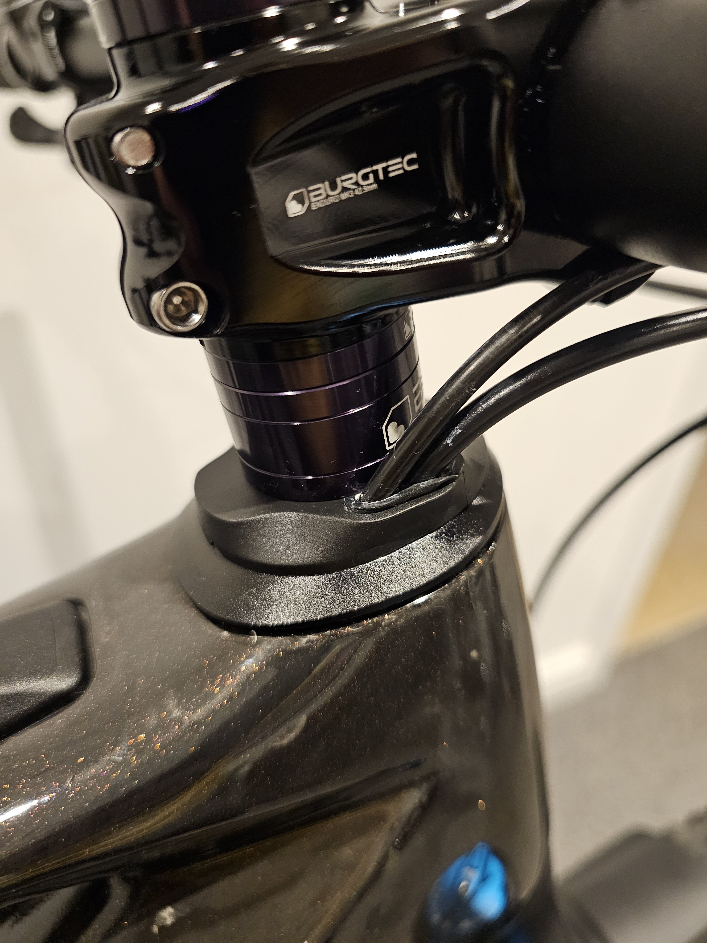

Hey, just a quick update.

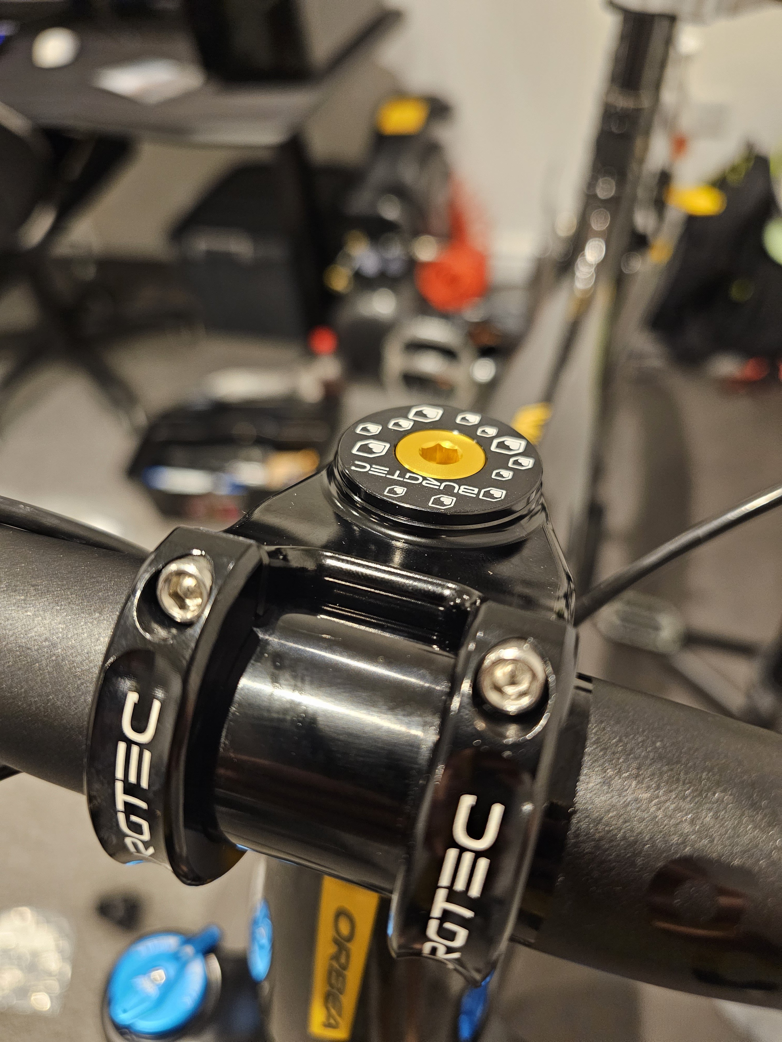

I have managed to do everything that I needed too and got my Burgtec stem, spacers etc on.
Only issue is that the Spin Block fell out when I first took it apart and fell into the frame, I don't suppose you have any tips on getting it out?
My next step is to just take the stem etc off and drop the forks out to then see if I can tip it out. 🤦🏼‍♂️😂
Wow, not sure how you can retrieve the Spin Block bits. Sorry I can't assist.
