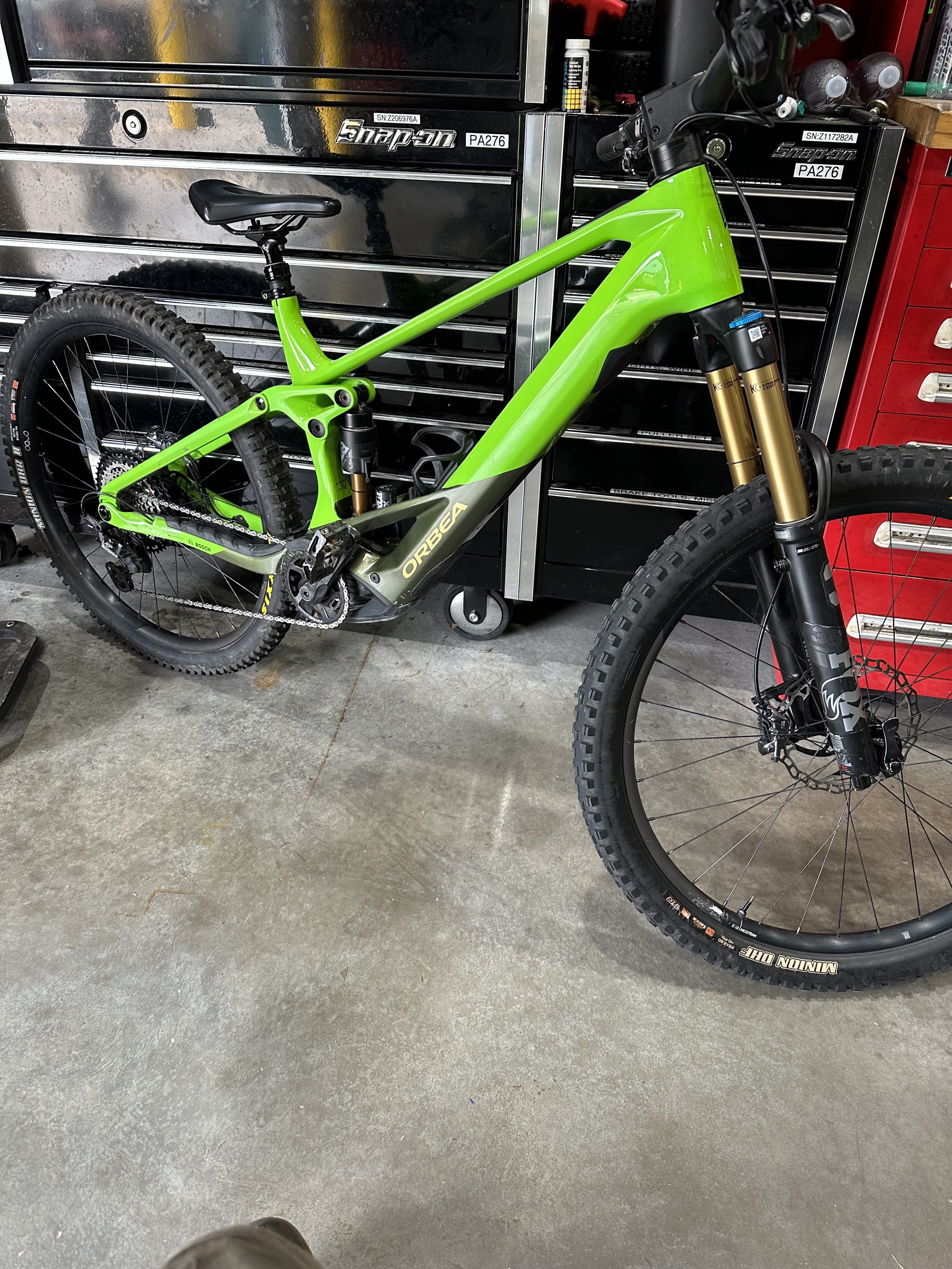

Hey all new to the forum. I have a wild showing up tomorrow in the m-20 configuration. I’m ditching the sector fork immediately. Does anyone have experience running a fox 36 on this bike. I am a lightweight at 155 lbs, or 70 kilo’s. I have found a good deal on a 36 and it would save some weight. I don’t want to buy a new fork that feels like a noodle. Riding in Colorado mostly front range trails so nothing too crazy, but I would like to be able to handle some chunk.
I’m leaning towards maybe I just get a 38 but thought I would ask first.
Just FYI I think the crown of the Fox 38 e-bike version where the fork meets the head tube is designed to fit the Orbea better. With a regular 38 and probably 36 the crown won’t line up perfectly. They work fine but don’t look as good imo. If you’re super picky about how the bike looks then this is another thing to consider. Another thing I’ve realized is that you should always go for better performance rather than trying to save weight on an e-bike. I’m thinking of adding another pound to the bike with a Vorsprung Smashpot in my 38
Thanks for the info. I’m not all that concerned on the appearance of it but I appreciate you passing the info along. I can appreciate your comment about adding weight to improve performance. Sometimes that’s very worth it. I figured I would check and see if anyone has run a 36 on the bike and how they felt about it. It would save a half pound. I’d like to try to get the bike around 50ish pounds without compromising the bikes abilities for the type of riding I like to do. I’ve also found a 36 at a very good price. Ultimately price isn’t the final driver but I do love to find a good bargain. Thanks for your help!
The 36 is a great fork, as a bigger dude who’s ridden most modern forks I can promise the 36 will not feel like a noodle.
Thank you for that! I appreciate your input! If the 36 works out I’ll give it a try.

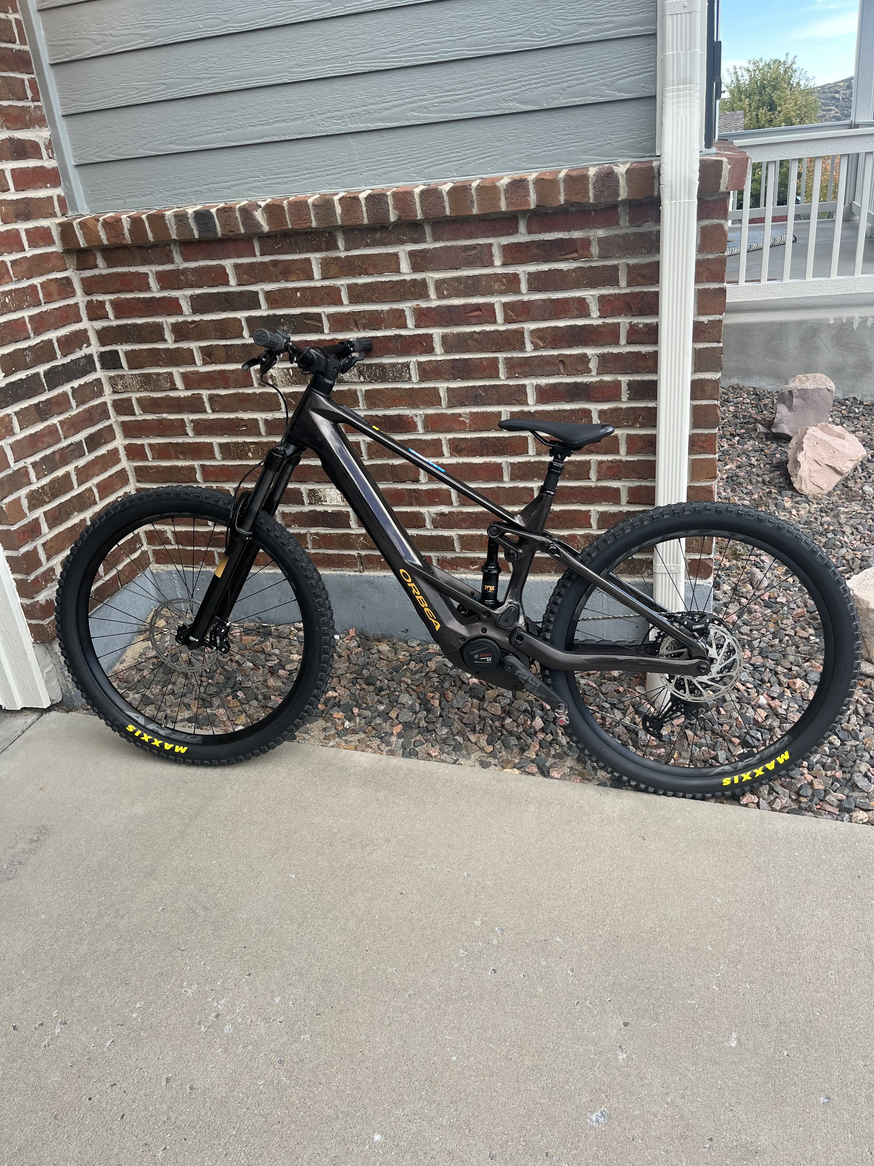

First ride on the wild today and I was not disappointed. The only other e-bike I’ve ever ridden is a Rocky Mountain Instinct power play but I have been riding mtb since the late 80’s. This bike is amazingly fun! I don’t feel like it gives anything up to the Rocky on power and I prefer how it handles over the Rocky. The bike definitely enjoys being leaned over and being as long as it is, it needs to be layed over to get through tuns at speed. The harder this bike is pushed the more it comes alive.
I got the bike in the m-20 trim yesterday. Immediately put on a saddle that I like on and swapped the tires to tubeless but other than that it’s currently stock.
The fox 35 silver tk fork that comes on this spec is hot garbage but I knew this when I bought it. Honestly it works better than I thought it would which is still not good. Everything on the fork is cheap and it’s almost impossible to tune it to any significant level. I ordered a fox 36 grip 2 factory that should be here on Tuesday.
I actually thought I would end up replacing the rear dps shock but I was actually impressed with how it performed. I will hold off on replacing the shock until I’m able to ride the bike with the new fork. I’m hopeful that the rear shock will be fine.
The sram DB8 brakes are significantly better than I was expecting. Those will stay for the time being. I was intending on swapping them out with 4 pot XT’s or Magura MT7’s, but I will hold off on that for now.
The only other plans I have for the bike are installing a one up carbon bar that I have laying around that is cut to 780mm and some carbon wheels. Beyond that I may upgrade things as they break or are worn out.
I can’t even describe how fun this bike is. I’m truly amazed!

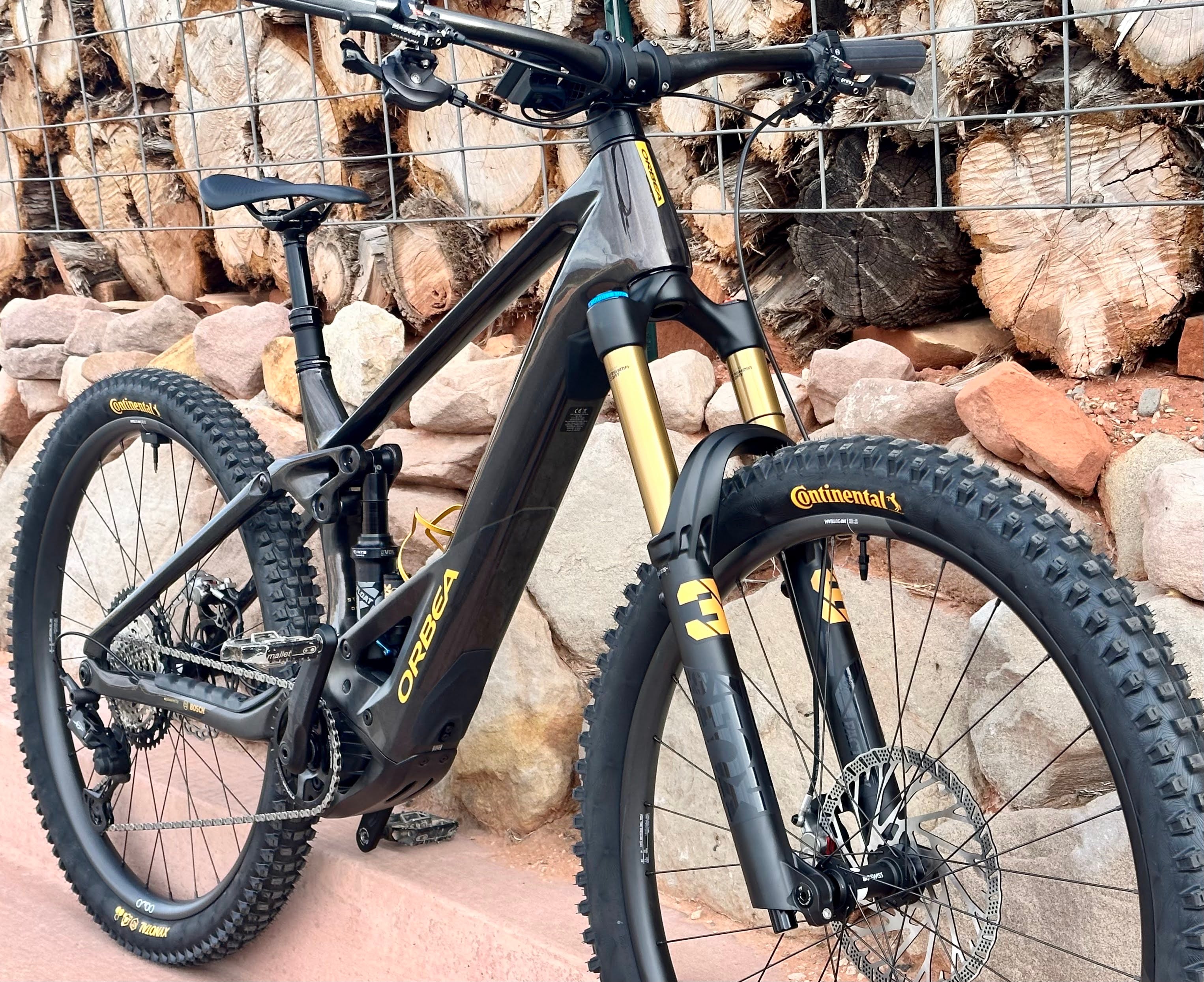

Installed the fox 36 and it really balanced out the front and back of the bike. This bike is amazing!
Headset cable routing I could do without 🤣. It took me about an extra 20 minutes screwing around with the headset spacers etc. getting the fork installed. The good part is now I understand it and it will go more quickly when I need to service the fork.

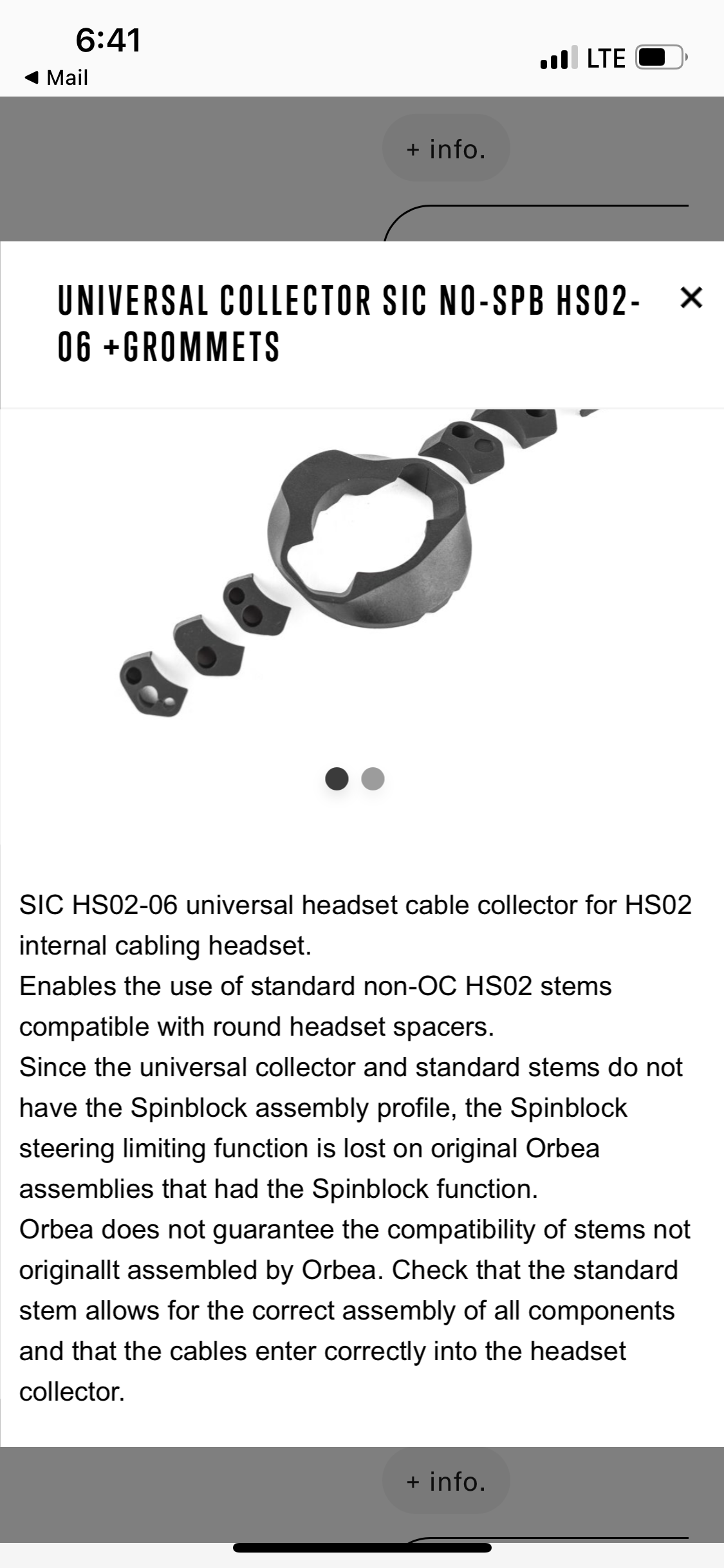

Is there any solution to replace the through headset routing with better through headset routing because I hate it.
The stack of silly little half-rings that fit together like a metal puzzle and fall apart at a touch combined with inflexible cables that get chafed easily combined with the possibility of scratching the paint.
You can get a kit from Orbea to run a standard stem and spacers. The cables still run through the headset area but they go outside of the headset spacers. When you do this you lose the knock block aspect of your stock headset.
If you are on an XL you should be fine. I’m on a large size frame and with a fox 36 fork, my compression adjustment on the drive side, and the air cap on the non drive side, would barely miss the downtube if the bars over rotated in a crash. I would think smaller than large and the controls at the top of your fork legs would likely hit the frame and damage it.
Somewhere in this thread there are pictures of people switching to standard stem and spacers.
thanks, can you point me at exactly the right kit? or post in this 20 page thread?
because the Orbea website is a nightmare :(

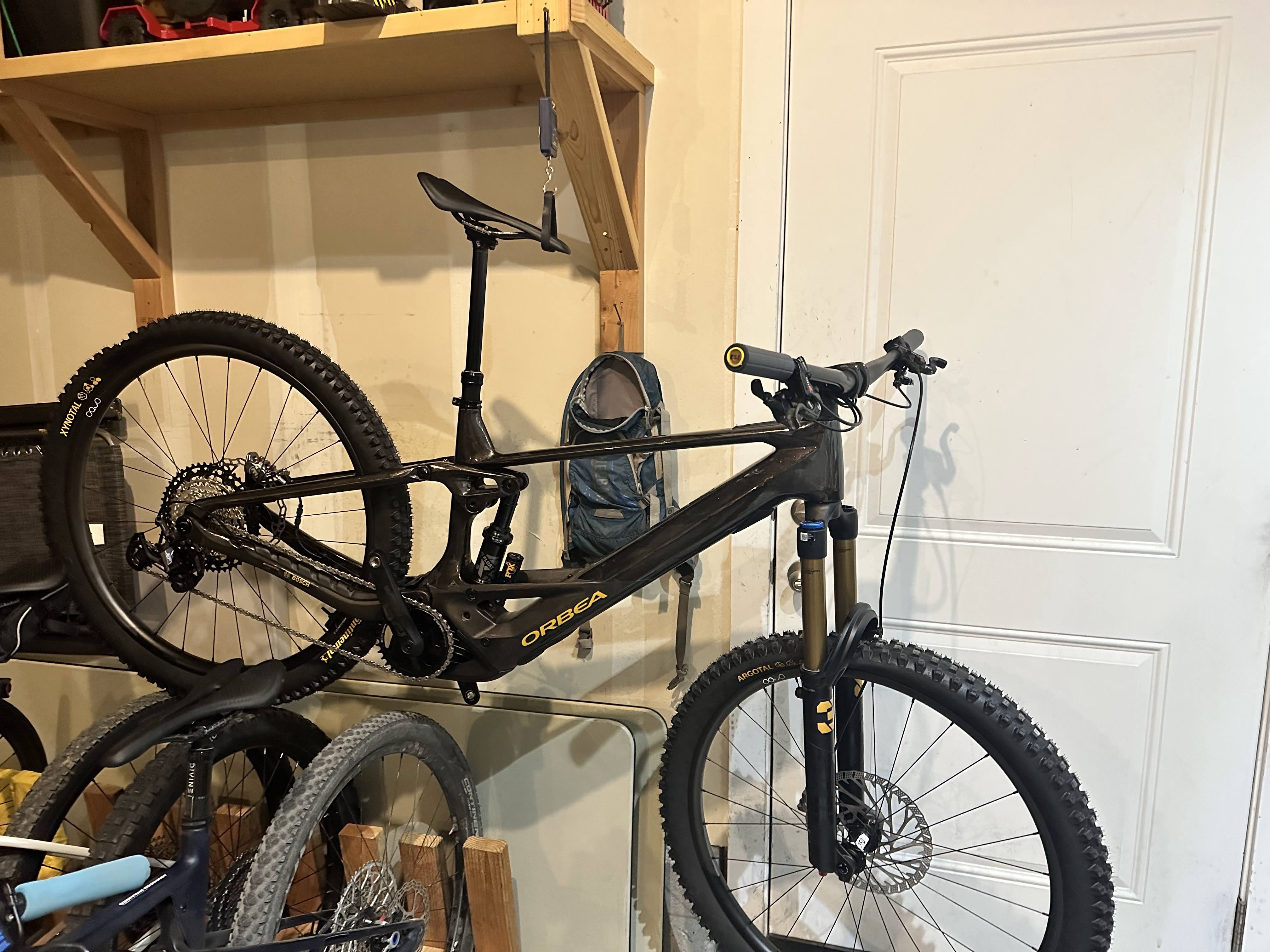

Another wrinkle, I dropped off the bike to get wrapped with RideWrap and the guy called and said he couldn't really do it because the bike already has a partial wrap from factory so he didn't want to remove that, and didn't want to put a wrap on a wrap and the other option of cutting around it isn't satisfying either.
My mistake for not realising it has a wrap already, but what did other owners do? is the factory wrap good enough, did you remove it and do a proper wrap?
thanks for that.
I am really impressed with how much factory protection was installed on the frame when I got it. Significantly more protection than any other bike I have purchased. I’m running it as is, however I’m not overly concerned with scratches etc.
You may be able to get away with some top tube and head tube coverage. If you really like to keep the frame in good shape you could have him install all the pieces he can in areas that don’t already have coverage. I would be nervous removing the factory installed stuff but it may be no big deal?
