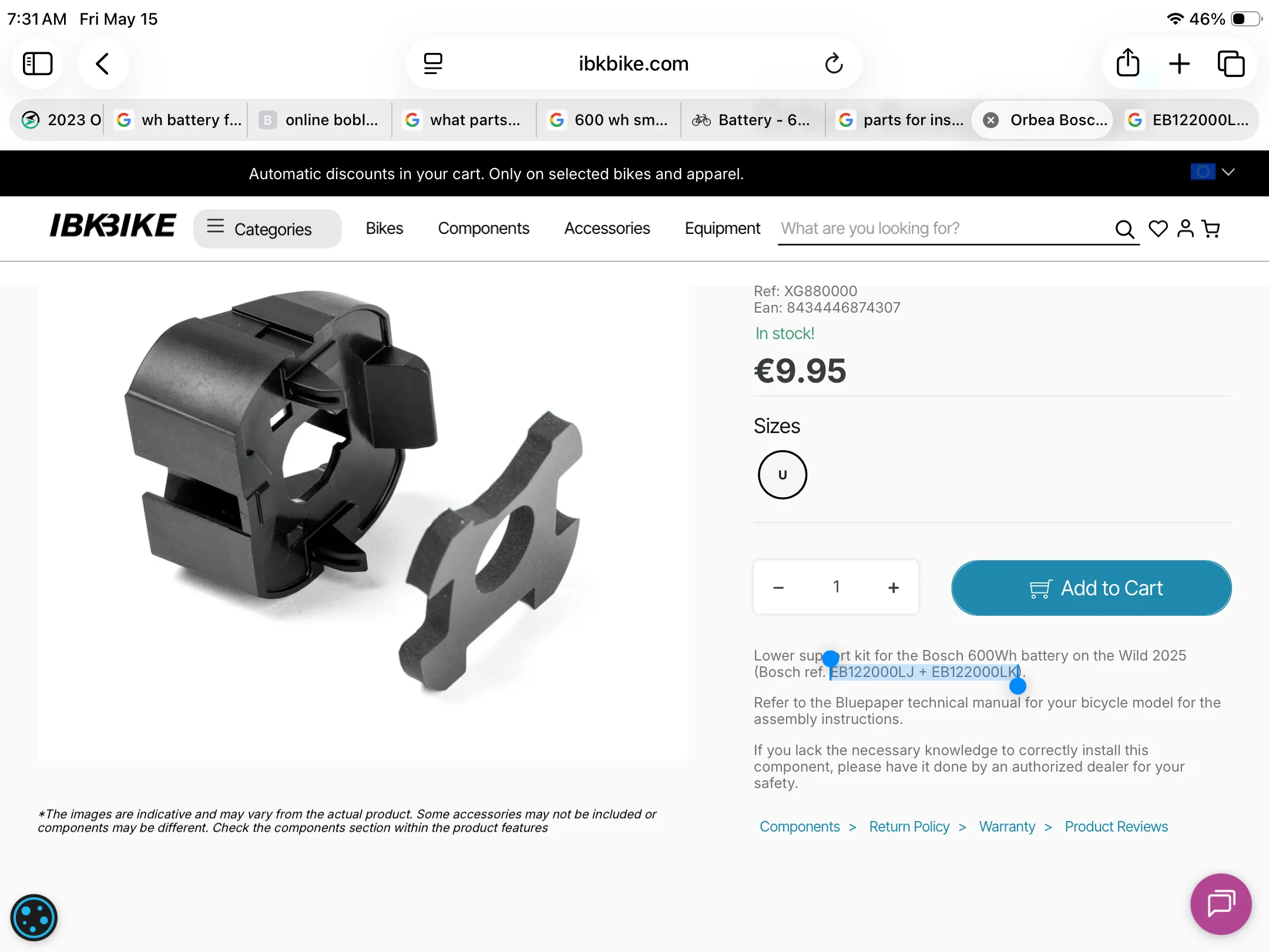

Yes it did. The only change at the bottom of the battery was a very thin plastic spacer which is in the parts required
Thanks for this. Considering doing the same. Currently in Australia with a 750 but will be travelling back to Norway where I have a 600wh. Can you tell me more about the plastic spacer. Is it must? Could you just do a home job fix or which parts kit did you use. Thanks in advance :-)
For those that have swapped the 750 wh battery for a 600 wh battery, what additional parts were needed? Do I need to purchase any spacers or mounting kits? I found the one pictured below, but looks like it is only available in Europe online? I am getting ready to purchase the battery online, but want to make sure I have all necessary parts for the install.

From what I understand, The 600 will work. I just need to know which additional parts are needed, if any.
