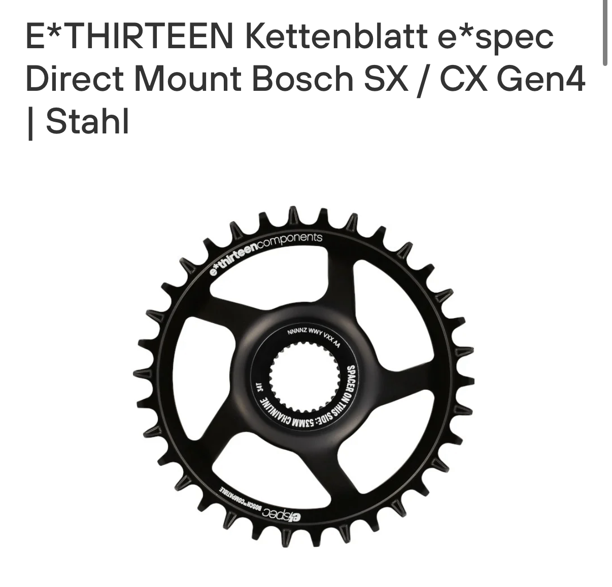

Wilders, I believe i am in need of a new front chain ring.
What do you recommend ? Pretty sure a 36t wont fit, so 34t, but what make and where to buy is what I'm after.
Cheap & durable

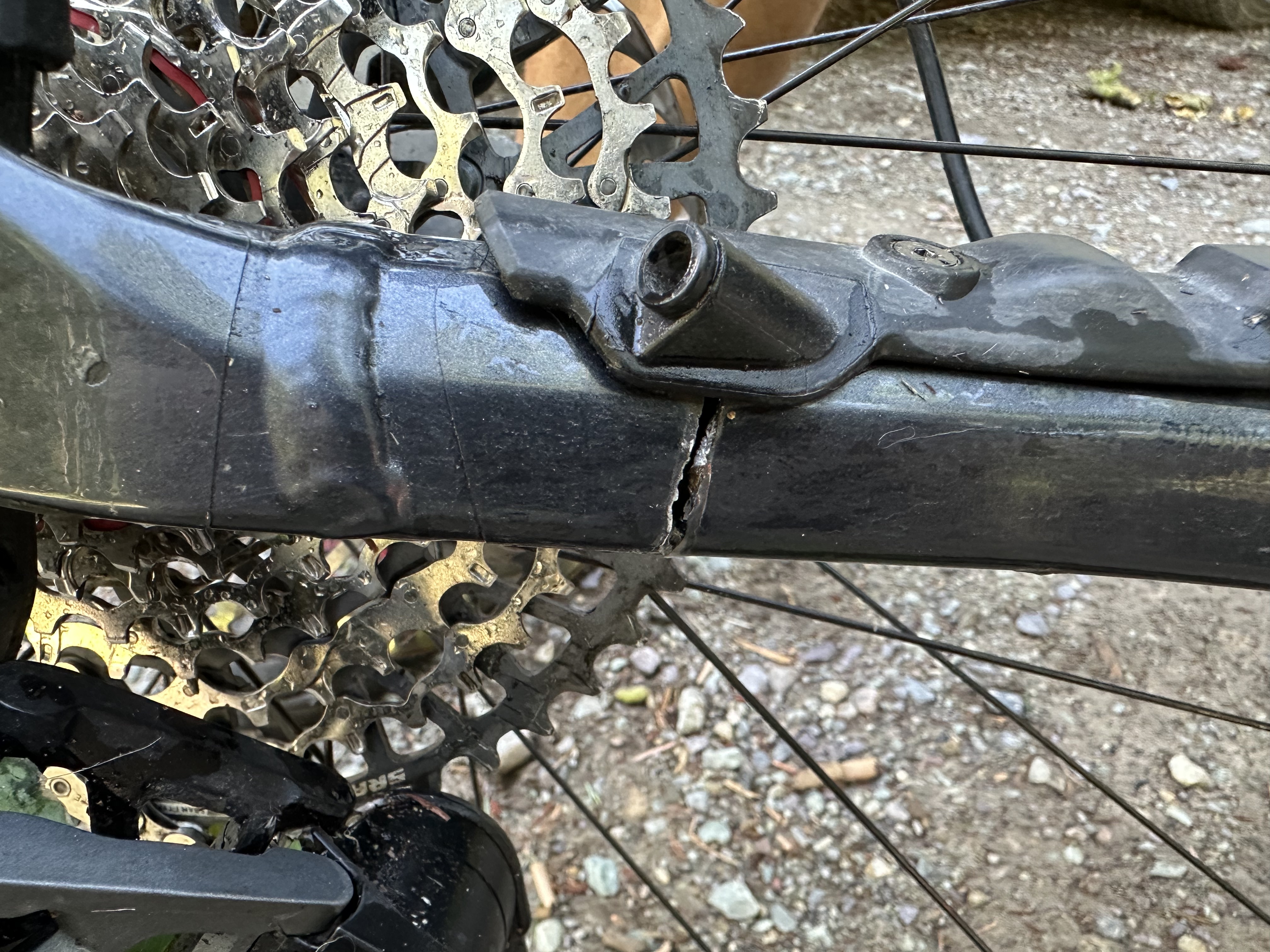

Bike Discount had good price for aluminium Cube 34t. Of course steel is more durable.
Inteteresting. Not the first Wild aluminium alloy rear frame which is known for this failure.
Hope your buddy didn‘t go down and is o. k.
How long does Orebea's warranty usually take? Can you just buy a rear triangle?

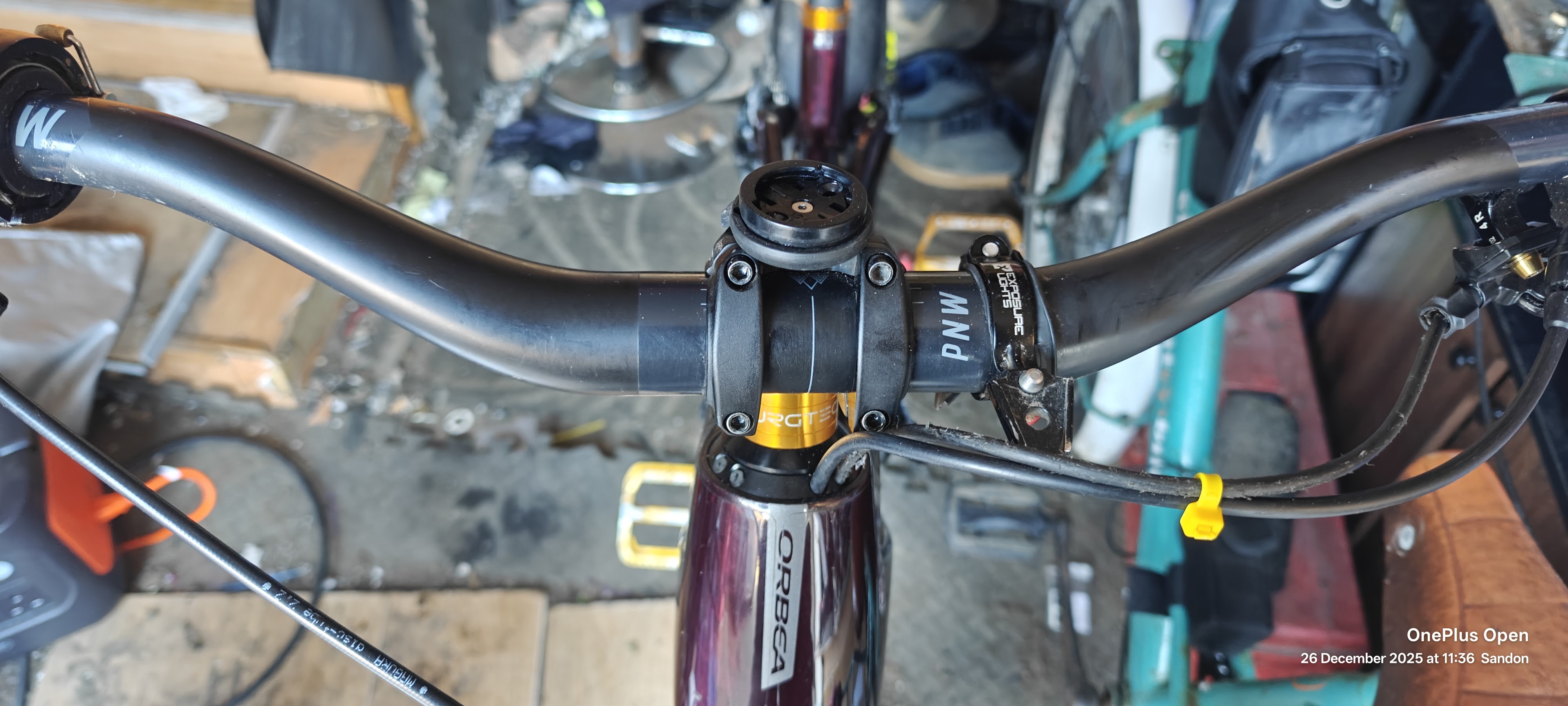

Continuing with the topic of improving the Wild 23-24 for downhill performance, increasing the front suspension from 160mm to 170mm and upgrading the suspension, I'd like to ask about changing the handlebar rise from the stock 20mm (on 800mm length) to 30mm or more. What has your experience been? Is this another factor that could negatively impact performance on technical climbs? And what about switching from aluminum to carbon? Has anyone made one or both of these changes and could share their experience?
Thanks!
You may try the rise change, because if it doesn't convince you, you may still be able to fine adjust by moving the stem down.
On another side, 800 mm is wide.
Did you consider to cut the bar?
I'm about 177cm and have my bar cut at 750 or 760mm.
It's just as it came originally... I got used to it and works well for me... From 20mm rise, how much do you recommend? 30?
Thanks!
I went to 35 rise with a 45mn stem if you look at the original stem it has a slight drop to it another option to look at
I'm running 800 wide, 30mm stem, 50mm rise. Helps with the steeps, doesnt help with the steep climbing.

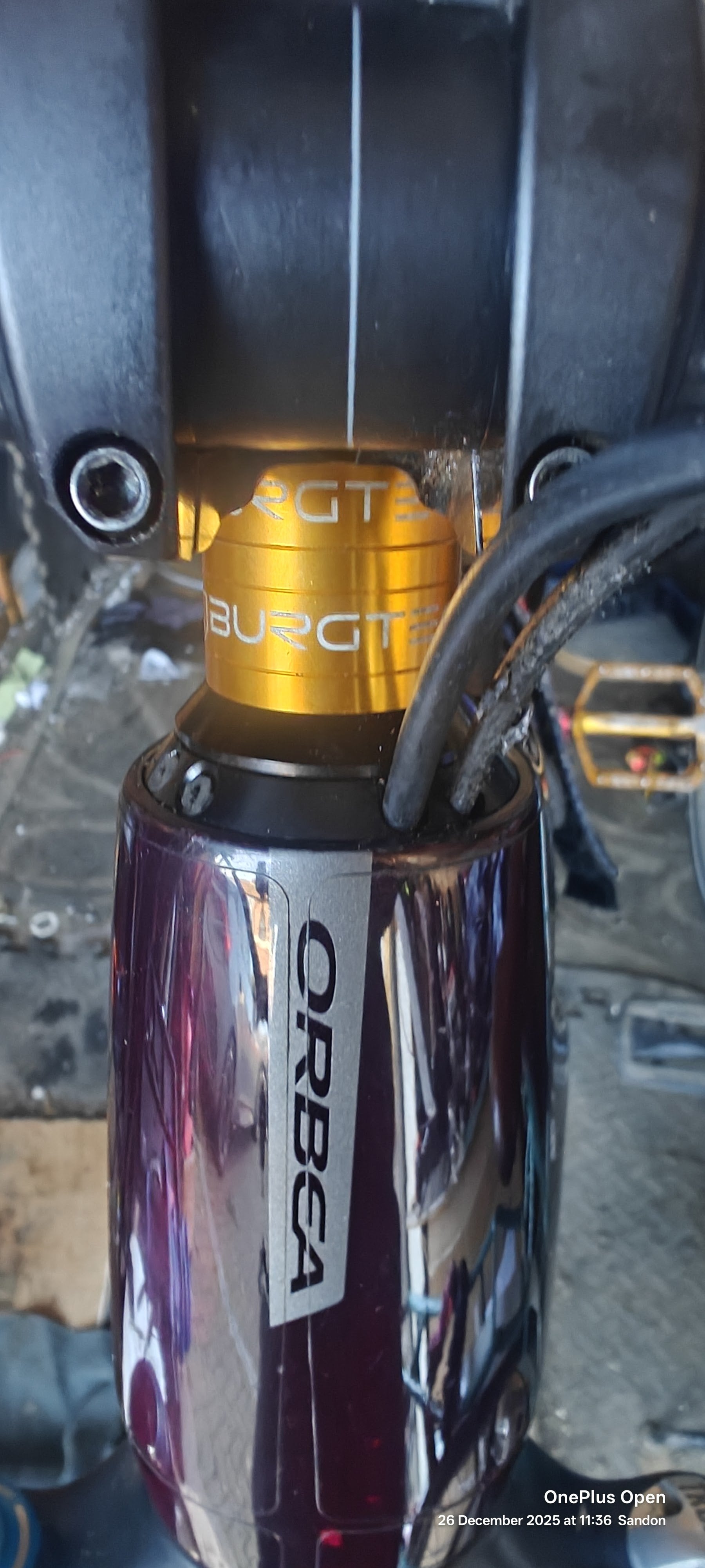

Finally got around to fitting the internal cable routing conversion. No more cables pointlessly through the inside of the bearings????

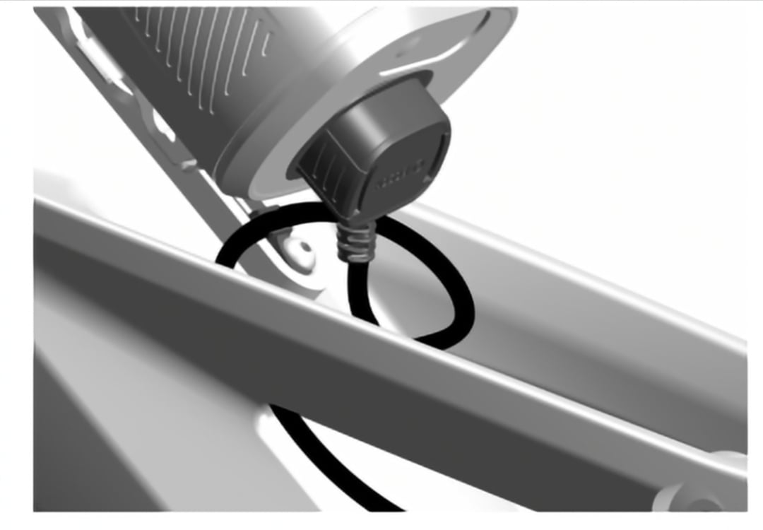

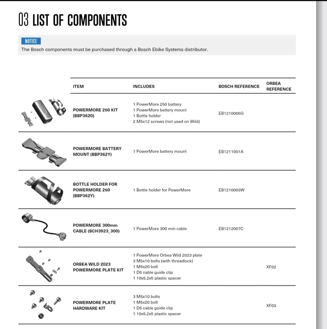

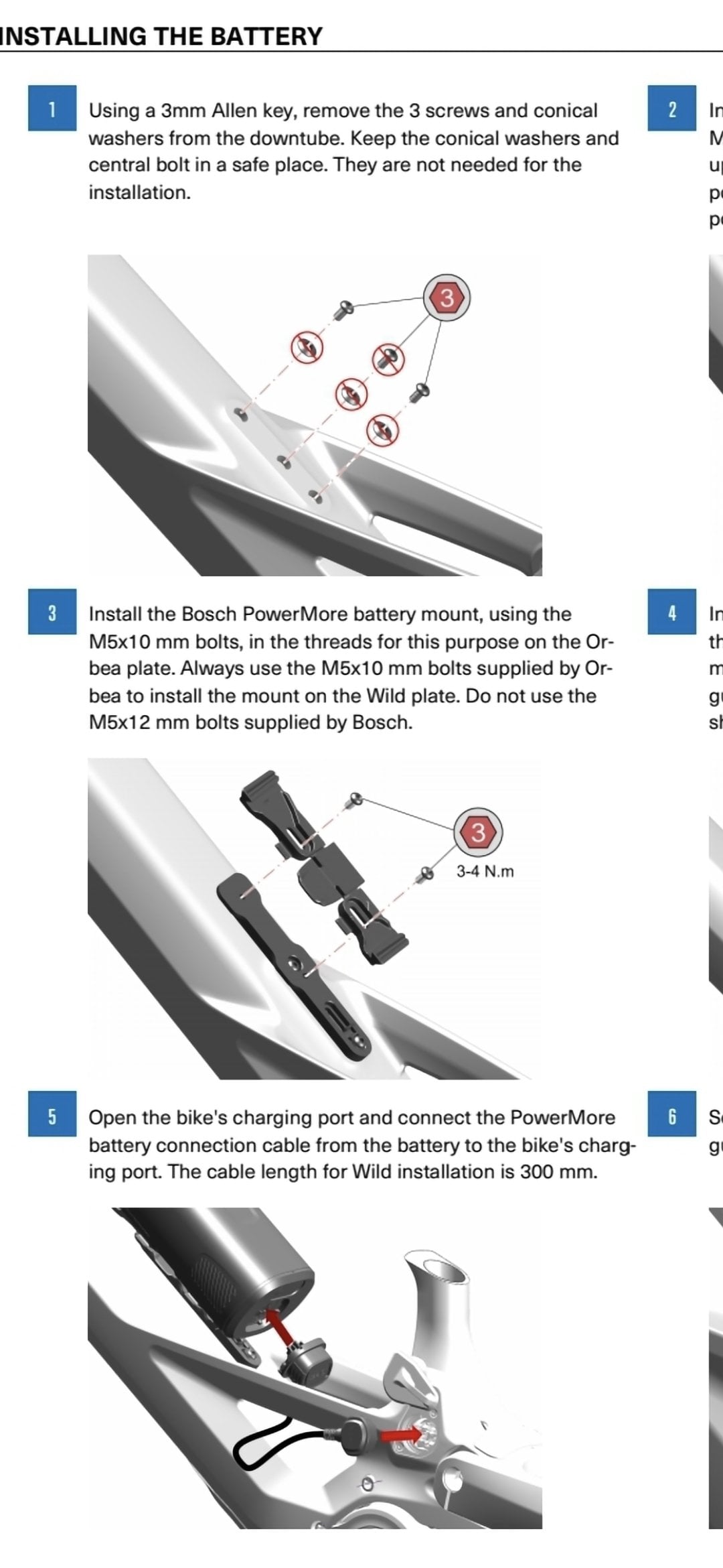

Also what length cord are people using for the powerMore?
Hi guys.
Better late than never. I managed to fit a new 600w battery into my 24’ MTeam Wild. It was a straight forward swap just requiring the same conversion kit as the ‘25 wild. I dropped 1.5kg from my 750w battery and it’s 23.5kg with pedals. No idea how people are getting them sub 22kg.
Which got me thinking has anyone tried fitting the ‘25 link to the older model? It seems as though nothing else has changed between them and the reviews speak well of how the newer model rides (I can only assume due to the updated link).
I'm using the 300mm length cord. Don't have an actual pic with PowerMore mounted to my Wild, but this illustration is spot on how it looks.
You will need a specific 2 PC mount in order to securely install on your bike thats included with the battery kit and can be purchased separately if you just have the battery.
