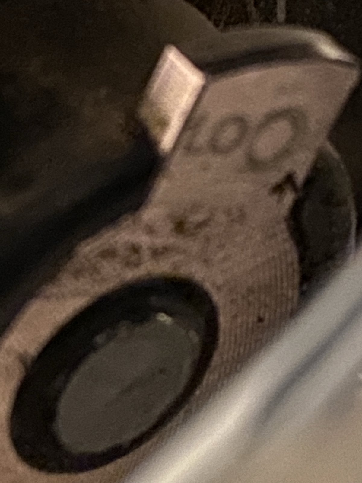

I'm probably being stupid but how do you tell if you are in high or low setting on flip chip?
Plus how do you get bolt out? I can get chip out thread side but can't extract bolt to take chip out on hex side.
Thanks
The chip is marked "Hi" and “Lo” on each end. When the marking is at top that’s the position it’s in. Here's a crappy pic that I took using the macro on my phone. It is easy to flip when you put the bike in a stand with the rear wheel removed and take the air out of the shock.

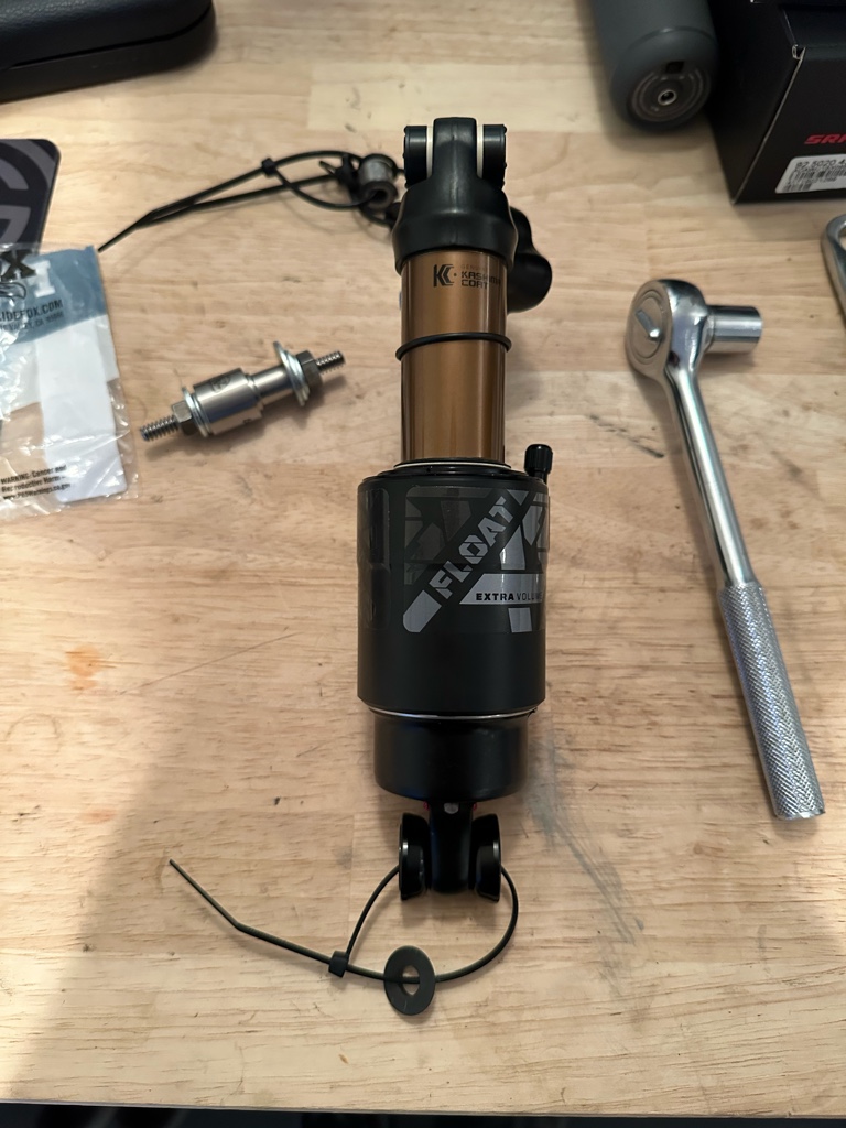

Thanks for the feedback. I’m curious as well. I’ve got an X2 on my bench that is a take off from my Ripmo V2 so it has their “traction tune”. Same size as the heckler shock, and I’ve wondered whether it’s worth the trouble to swap them out.
Dude, its like a 5 minute swap. Give it a try.
Honestly, I have a ton of stuff laying around so fitting something like that is usually not a problem. I just went through it with my fuel EXe. If you don’t have a lot of spares like I do it may require a trip to the bike shop….which is usually fun anyway. I guess it’s now a 1:05 job. It’s been a few months since I did the swap so I have no idea what I did.

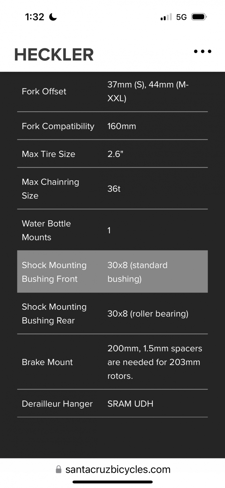

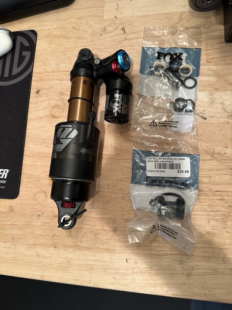

@Desert_Turtle @Silent Drone I just picked up an x2 and thought I could re-use the RS hardware. WRONG. I guess I need a 30mmx8mm roller bearing? Is that correct?
That’s what I was referring to. The shock is the same size but you need different mounting hardware. Changing the hardware is quick and easy if you have a bushing tool, like this:
And you also need the correct hardware, of course. SC says you need a 30x8 standard bushing in the front and 30x8 roller bearing in the rear:
I don’t have the hardware so I haven’t taken the time to fiddle with swapping it, plus I think the stock super deluxe on this bike is pretty good. I’m not convinced that the X2 is going to be a significant improvement.
You are correct sir. I just tried the X2, didnt like it. I love it on my Ripmo v2, but on the Heckler it felt more chattery and wayy less poppy. Strangely, I felt like it had more traction (not sure if that makes sense). I'm going back to the Rockshox shock.
On my V2 I replaced the X2 with a Float X. I also replaced the Assegais with DHF/DHRII, pushing the bike more towards a long trail style bike. I like the float x paired with the fox 36 on the Ripmo. It suits my riding style well. I found the X2 to be a little too plush, a little too soft.

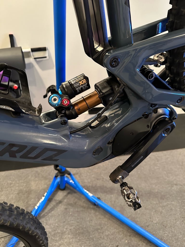

All this talk, so I swung by the shop and picked up the shock mounting hardware, and did this….
Before, with Ripmo hardware installed
After, with SC hardware
On the bike…
It looks good, lol. It’s a little easier to measure travel for set up because you can see the stanchion, but it’s still too cramped to get my calipers in there to measure.
Anyway, took it for a quick test and it feels good. A little more plush and less poppy than the super deluxe, but the X2 has so many adjustment options that I might be able to dial that out of it. We’ll see. The squishy sound it makes is very noticeable. I wonder if it might have some air in it or something else because it sat unused for about 6 months.I
