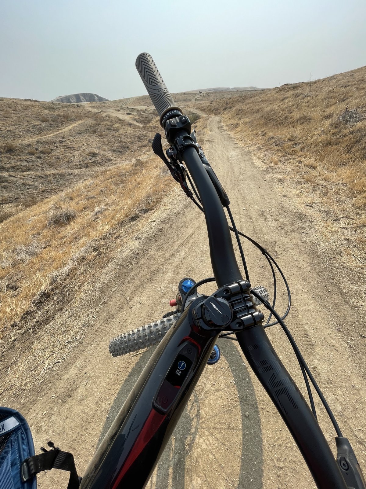

My 2022 turbo levo expert has completely stopped working. It went from errors to no response on power lcd unit. So weird. Less than 25 miles .. the bike is a $13k paper weight / it’s at the local bike shop now waiting warranty repair … I rode it 3 times… now I wait to see when they will repair. I will keep this open and keep updating for future buyers. I’m bummed about it all, but hopefully it won’t be another month of no bike! Sounds like a lot of people are having issues. At what point do they just send me a new bike haha ? I rode it 3 times… fix it or send a replacement… by the time warranty repair is finished there will probably be a new model.
