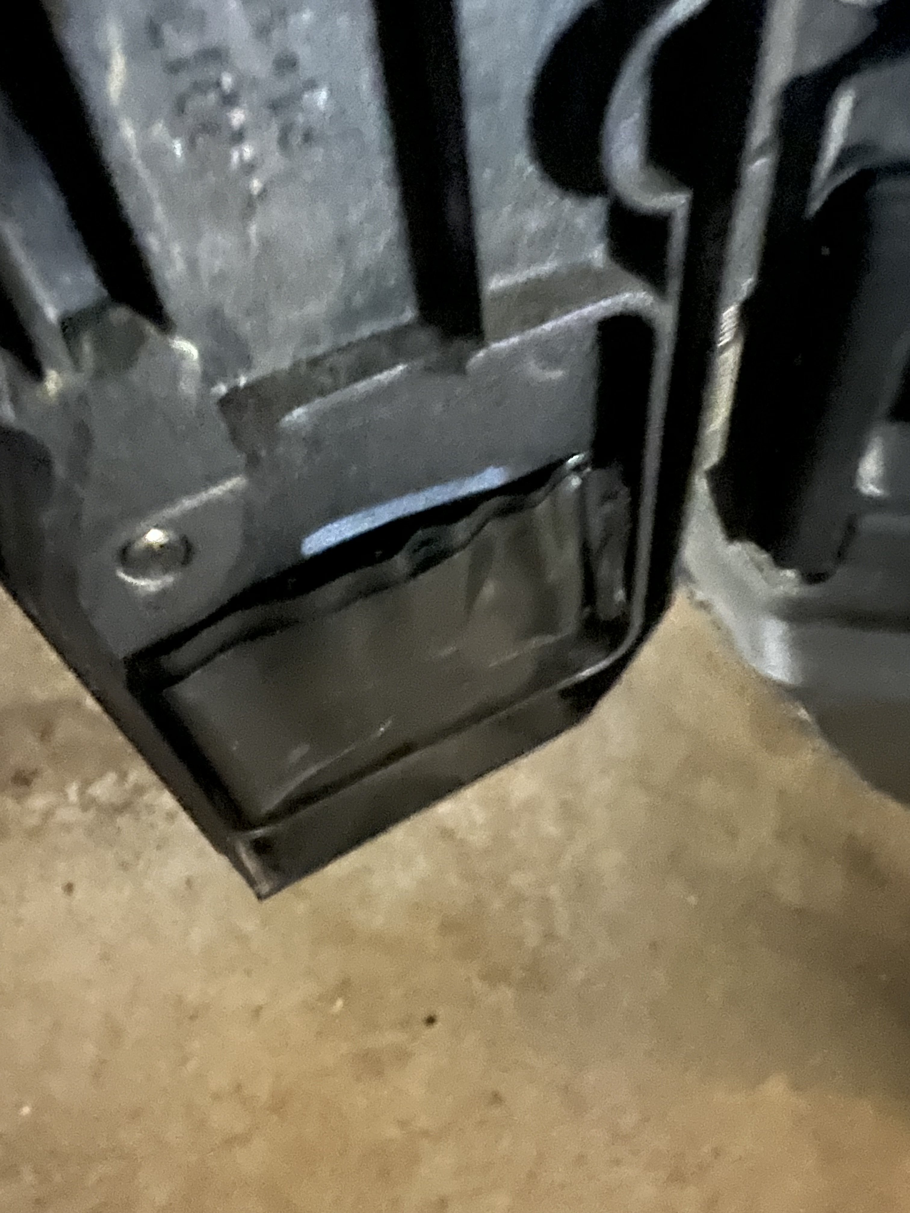

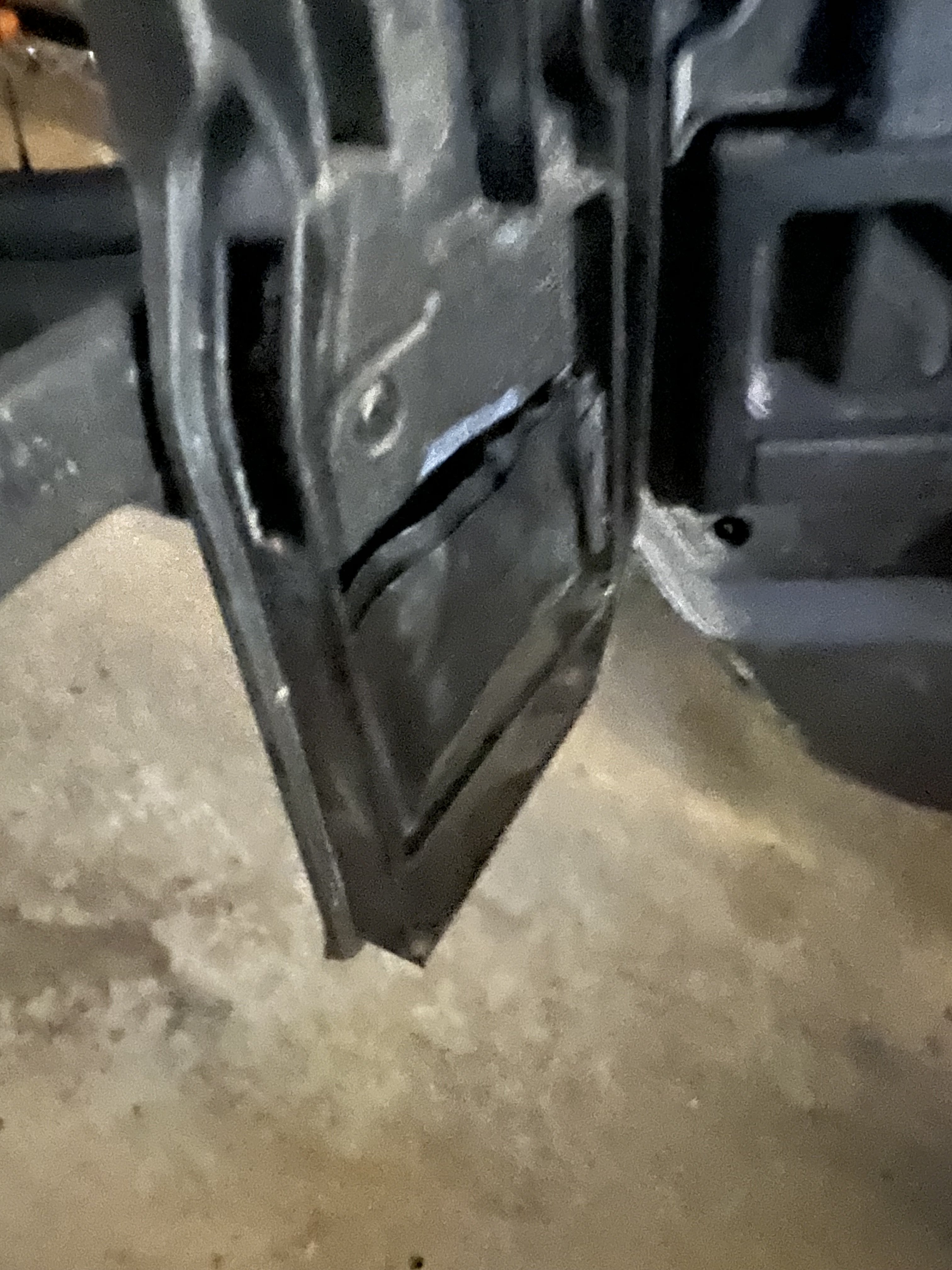

Hello!
I just picked up a second hand 2022 Gen3 Levo and had the same issue on my first ride out. The MCU and power cutting in and out, and it was frustrating to say the least. I had all the firmware updated, which I don't think was the issue. I also added some electrical tape inside the battery door as a hack to create more pressure against the power cord to make sure it keeping a solid seal and connection. See Pics. Next ride out had a very technical sustained descent and no issues what so ever. Plenty or chunky rocks, 1-2 foot drops and it any connection was going to rattle loose, I'm pretty sure it would have. We'll see if it holds up.

If it works, I hope you can keep it that way. There is a lot to enjoy with a proper working Levo.
Sad enough the same solution on my Levo didn't last; lets say it lasted from my lbs to my garage, but once out in the mountains the problem was back again right away.
