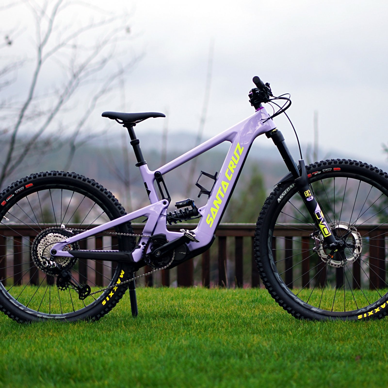

2021 Santa Cruz Bullit
Just placed the order on a lilac :O
If santa is as nice a fella' as they say I should have it around new years.

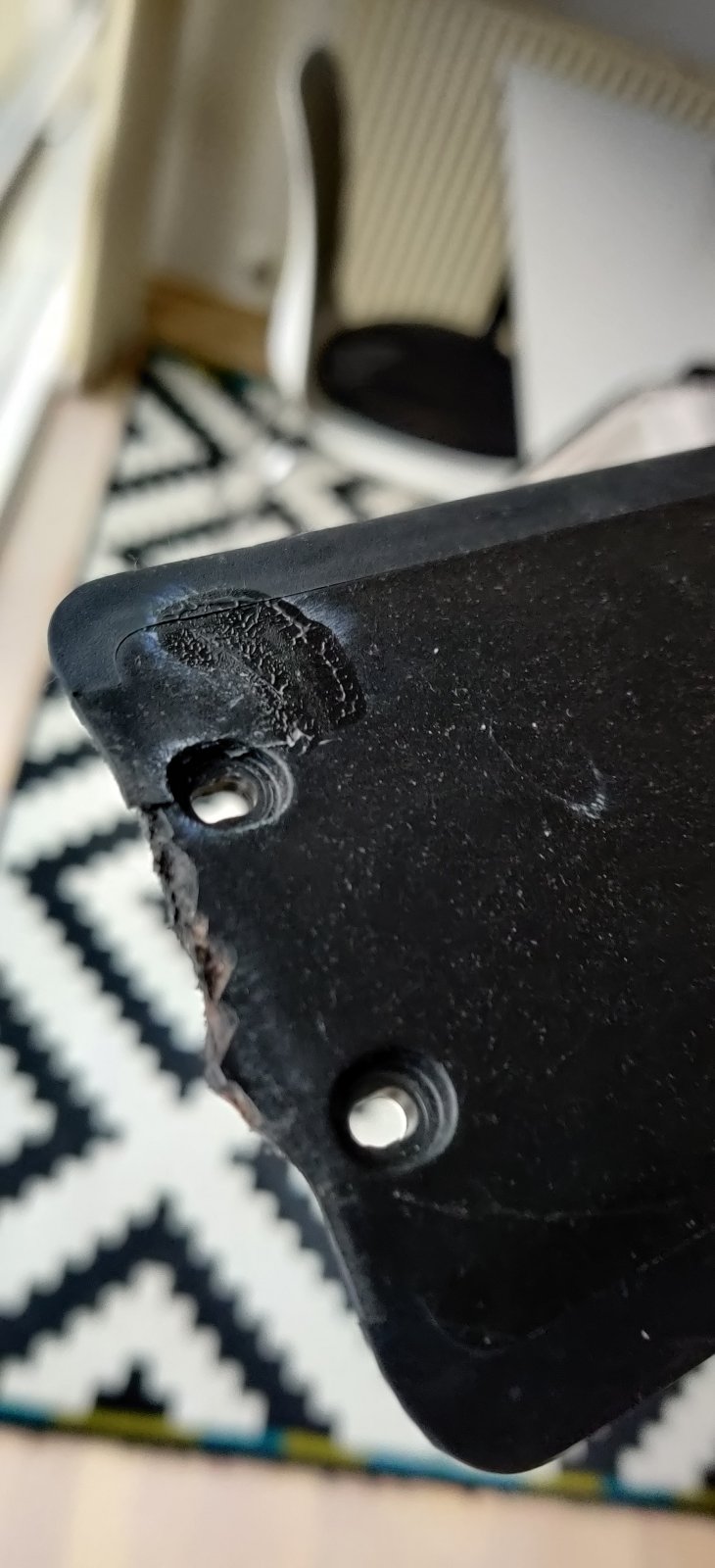

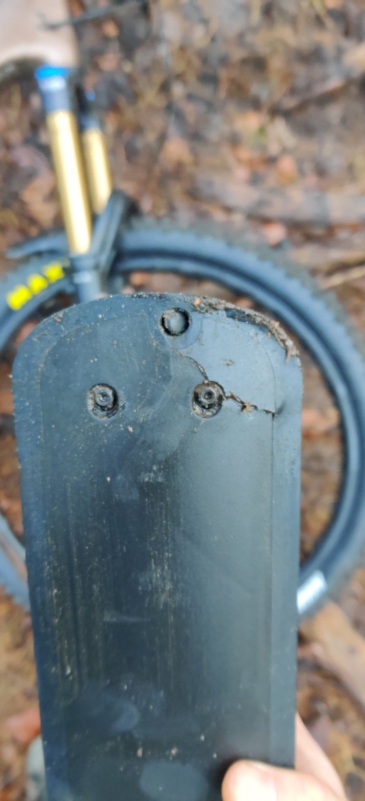

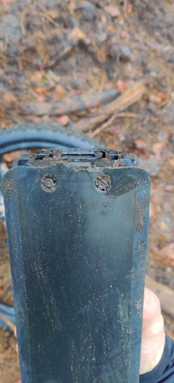

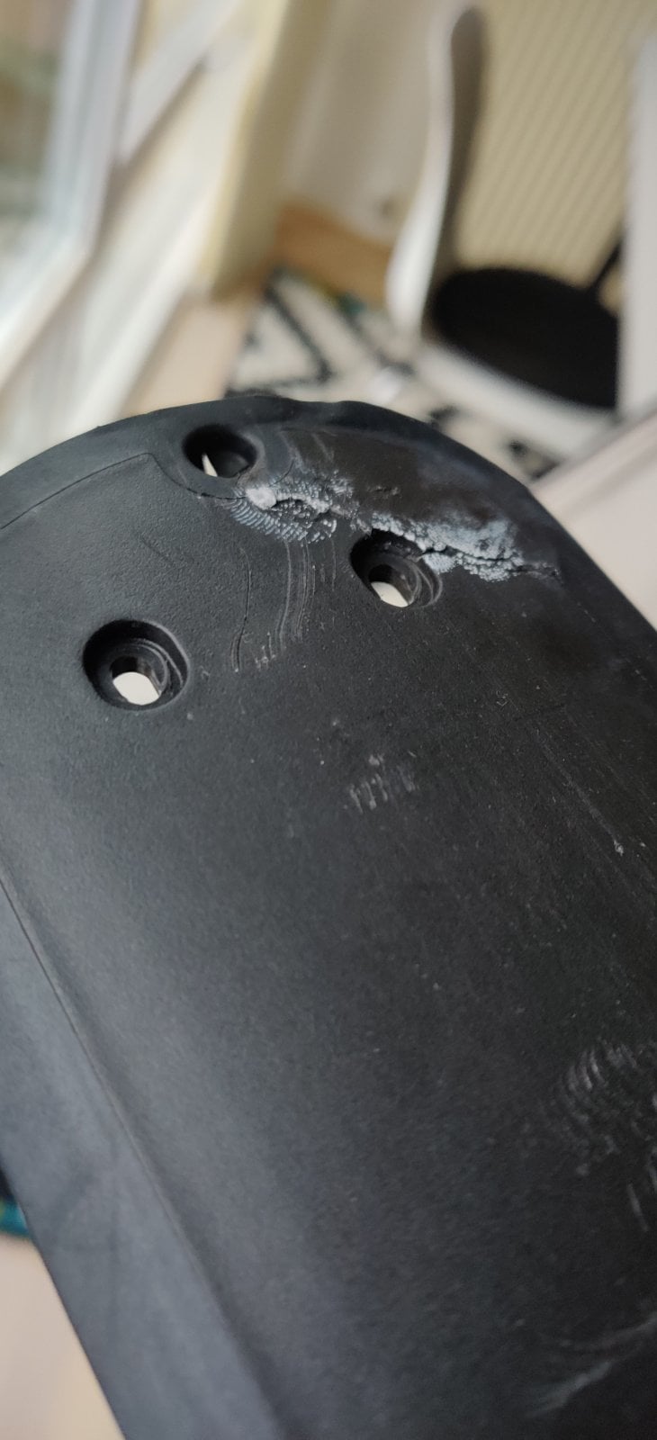

Had another great ride today on the Bullit, with a not so great experience.
Did a rather small jump, but overshooted it abit which resulted in a semi hard front wheel landing, nothing the fox 38s didn't turn into butter, but it resulted in the freaking battery dropping out of the frame with full force.
Huge disaster, so trailside cleaned it. Popped back in and everything worked.
Did another 15km afterwards "mindful of harsh landings".
Seems like only the battery cover really took any damage.
Going to get in touch with SC Monday.
Hopefully that's a one off, but probably going to do a hotfix(safetyband) solution untill someone has had a look at it.

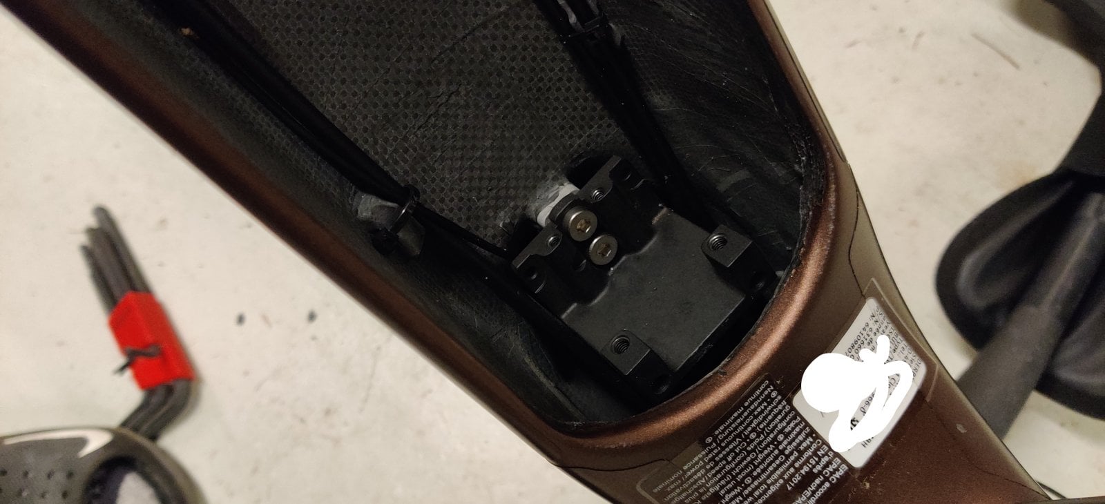

Wow that is a strange one! Never had anything like that happen on my Heckler and have had many hard landings or crashes. Hope it is a one-off. Still waiting for my Bullit but have already ordered a second battery, but last time I checked the battery cover is out of stock on the Santa Cruz website. Hope your dealer will have access to one as that seems like a warranty item.
I was looking around, and I think it might be something similar to this.
Can't tell for sure ofc. but it would make sense.
Needless to say I didn't look into this on bike arrival after receiving it. Will take a closer look on it in the next couple of weeks.
It’s not that uncommon on EMTB’s, more often than not because the battery mounts are not tight enough - the Shimano battery mounts have adjustment on them, and may have not been correctly set by the LBS.
Exactly what I was thinking.
Anyway, a new battery cover and fixing the mount and I think I'll be all set for more sweet riding ?
Adjusted the mount down some, was fairly easy. Only time will tell if it's sorted or not.
Can't wait to get out and send this machine some more tho, so I'll put it to the test on Saturday.
Bodged the battery cover back together with loctite and some 3M tape untill I get a new set.
Oh and to those with internal Shimano batteries!
That little latch with the spring on it, properly has a tendency to come loose, I'll keep an eye on mine at least and maybe threadlock it later on.

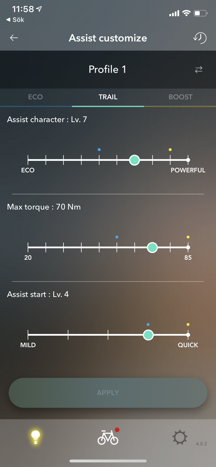

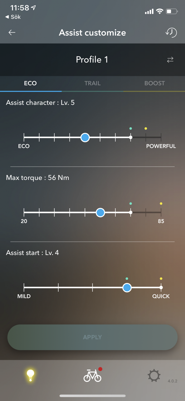

I actually have a Rail as well, and the Bullit (EP8) default power assist settings are comparably high to the Bosch Gen4. It is very noticeable in Eco and Trail.
Had the same experience as you the first time out on the Bullit. Battery drained really quick and ended up biking without assistance the last couple of kilometers.
After adjusting down these setting to be more on par with the bosch motors it’s way better! Tune down Eco and Trail in the E-Tube app you will get far better range.
Do you have the settings that are comparable to the Bosch by any chance?
Thanks
Thanks
Sure. These are my current settings. Nice part is you can customize this even further for long days out.
I mostly use Eco, and Trail with the occasional boost up the steep stuff.
