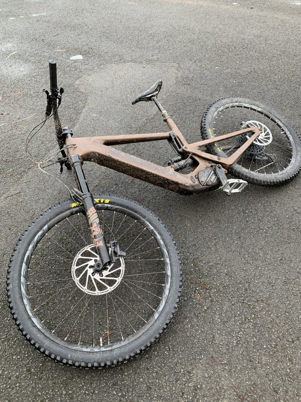

I have been riding almost exclusively in eco mode with level 5 and 63nm now in the winter with slippery conditions and cold weather. This feels very natural and still quite powerful. Although lately been thinking why not put these settings into trail mode and then tune down eco mode way more for commuting to trail heads. Boost for me is really just a "shuttle mode" with everything set to max. Anyhow, I really like this tunability of the Shimano system, you can really make it your own!
@Ricky101uk - Post some photos once you start your build. Sounds like an awsome setup!
I love the stock Fox 38, and the Coil. Did however invisiframe and AXS upgrade before hitting my first trail with the bike. Simply love it!
Update, changed the factory settings to same as pictures above and it seams to have worked well.
I also agree that I’m going to put eco a little bit lower and flick between eco and trail.
