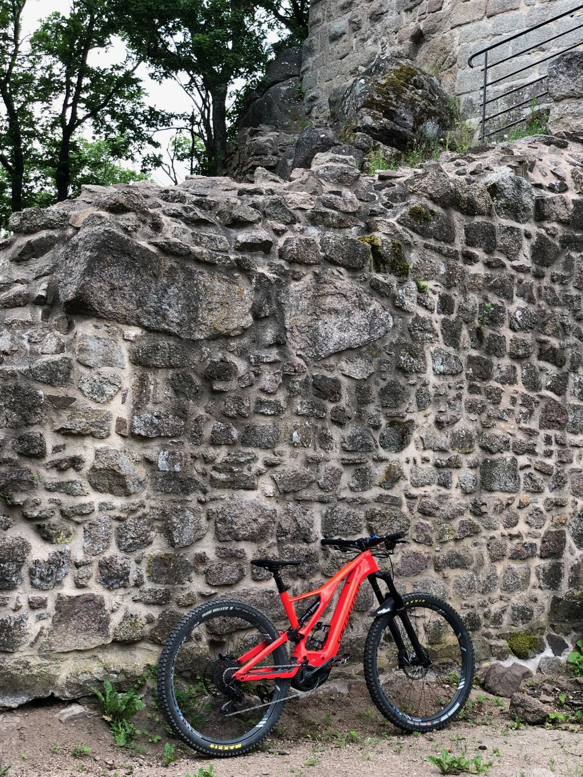

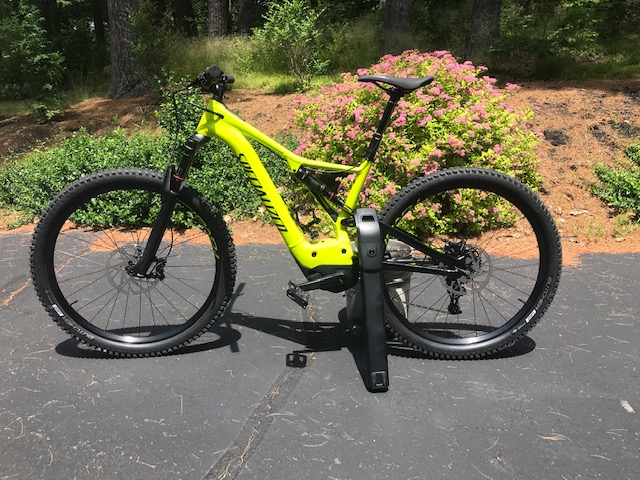

My Levo 19 with 1000km of Trails:) Just enjoying it!

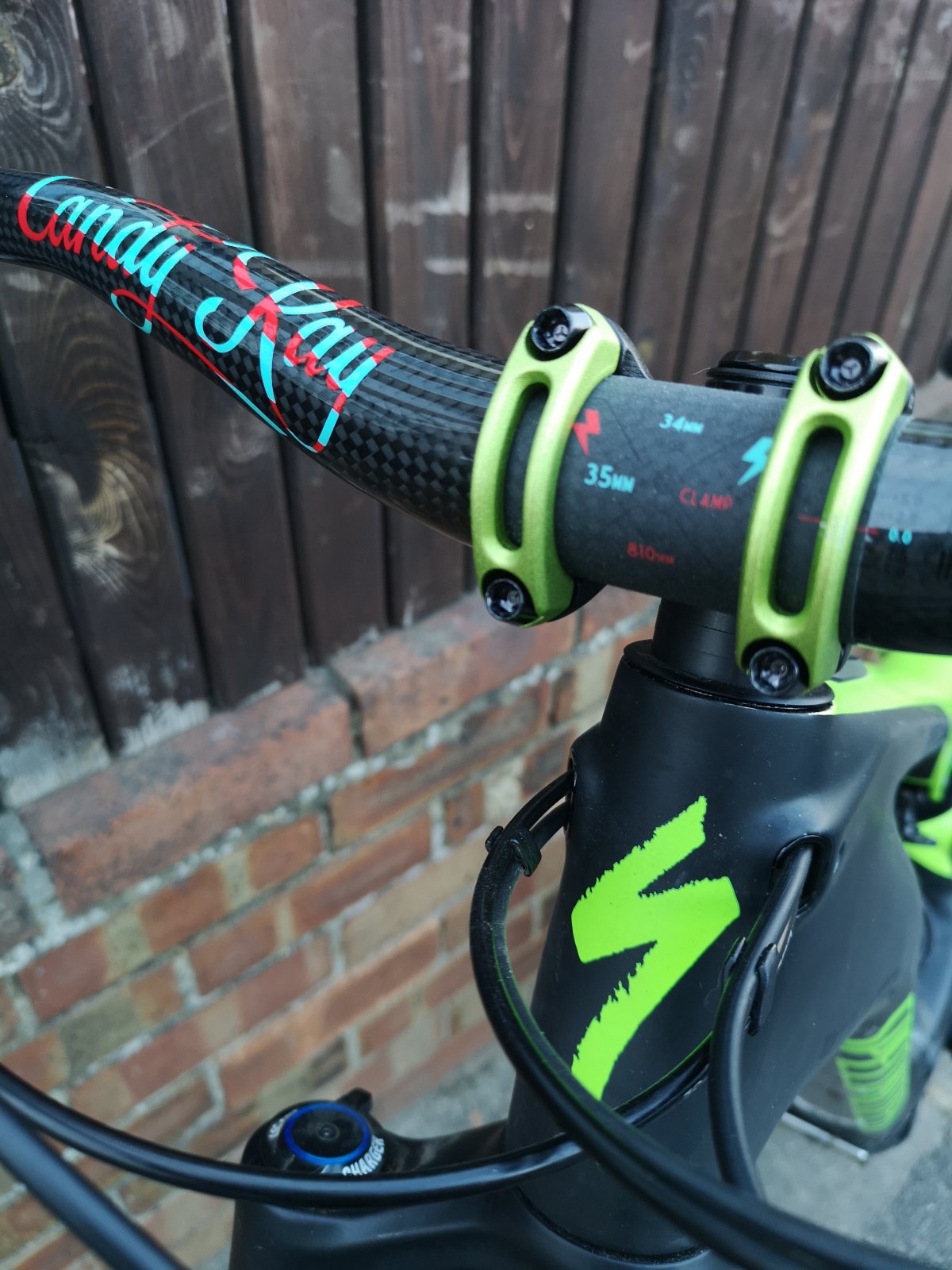

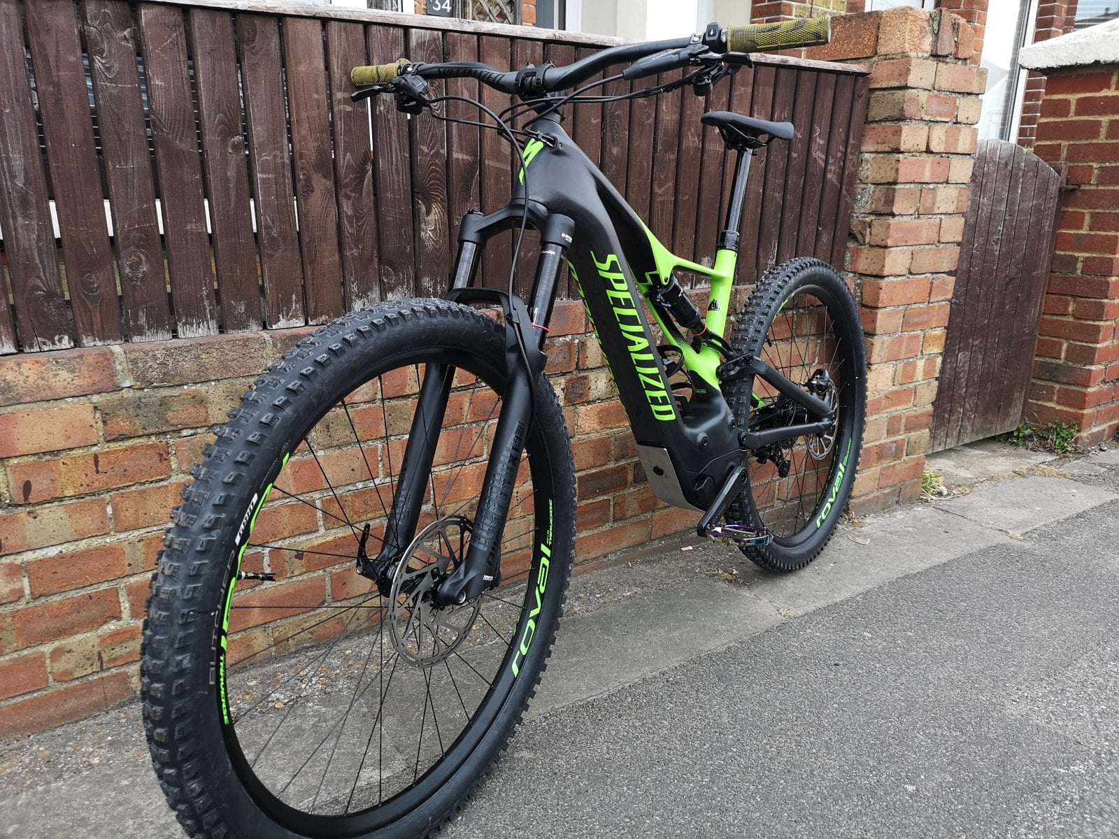

I've had my 2019 Levo for around a month now. I have replaced the dropper and handlebars. I love how balanced this bike feels and it certainly doesn't feel heavy whilst riding it. I cannot gain confidence with the Butcher's tyres, so will be changing them shortly for Schwalbe Magic Mary. These will also be new to me, as I have always ridden Maxxis.
Great bike :) I had Magic Mary put on my new Levo and they are superb as I have read that the Butcher tyres are a bit skittish!

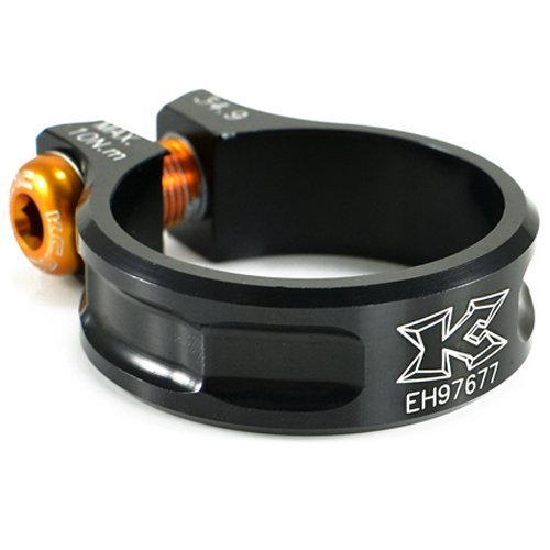

It's not even the correct diameter. At the bottom of the post it is 34.9 but then it tapers in to like 33. Wtf? I had to over tighten the clamp so that it wouln't slip, and the bolt on the clamp is made of soft cheese so it doesn't last. I bought a KCNC seat clamp and KS Lev Integra. It is so so much nicer. I used the spec lever and cable housing so it was basically plug and play. Other than that the bike is briliant, absurdly capable.
Finally i got fed up with the specialized dropper. It is so bad.

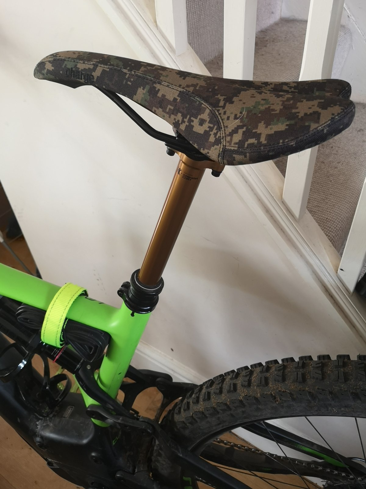

Good call. I switched to a Race Face which is the same as my fox transfer I have on my Pivot 5.5. A shim was used due to the diameter, doesn't slip and adress's my biggest complaint with the bike.
PS Pivot 5.5 has only been ridden a few times since this purchase.
What size are the seatpost clamps? I know the post is 34.9. Thx

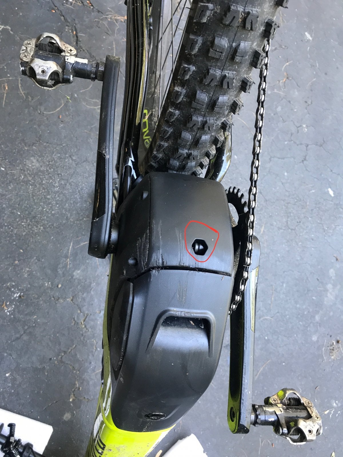

No its drain hole best not to block it
well personally I wouldn't ride mine through water that covers or partially covers the motor but I would ask your dealer to confirm if you can or not

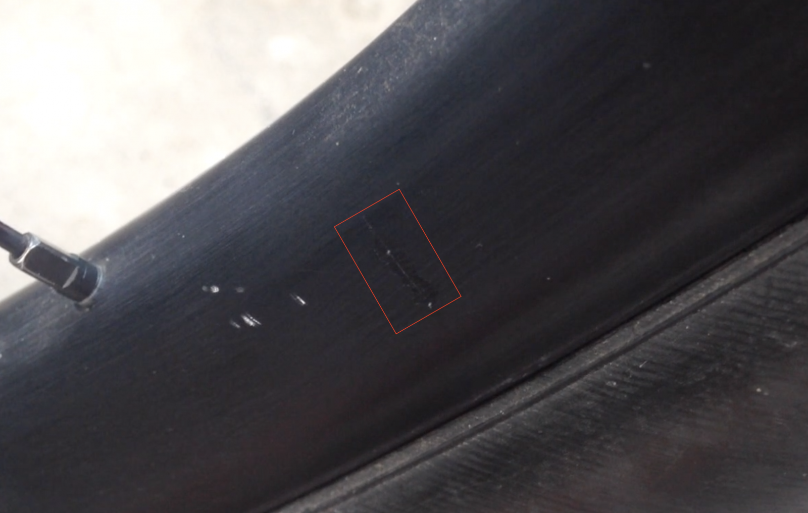

While I was converting my front wheel to tubeless last weekend I've discovered hair-thin crack (>10 mm or 1/2" in length) after I've bedded the tire - it leaked air and bubbled from underneath the wheel's decals.
Is it something I should be concerned about?
LBS guy told me to keep riding and keep an eye on the crack size.
