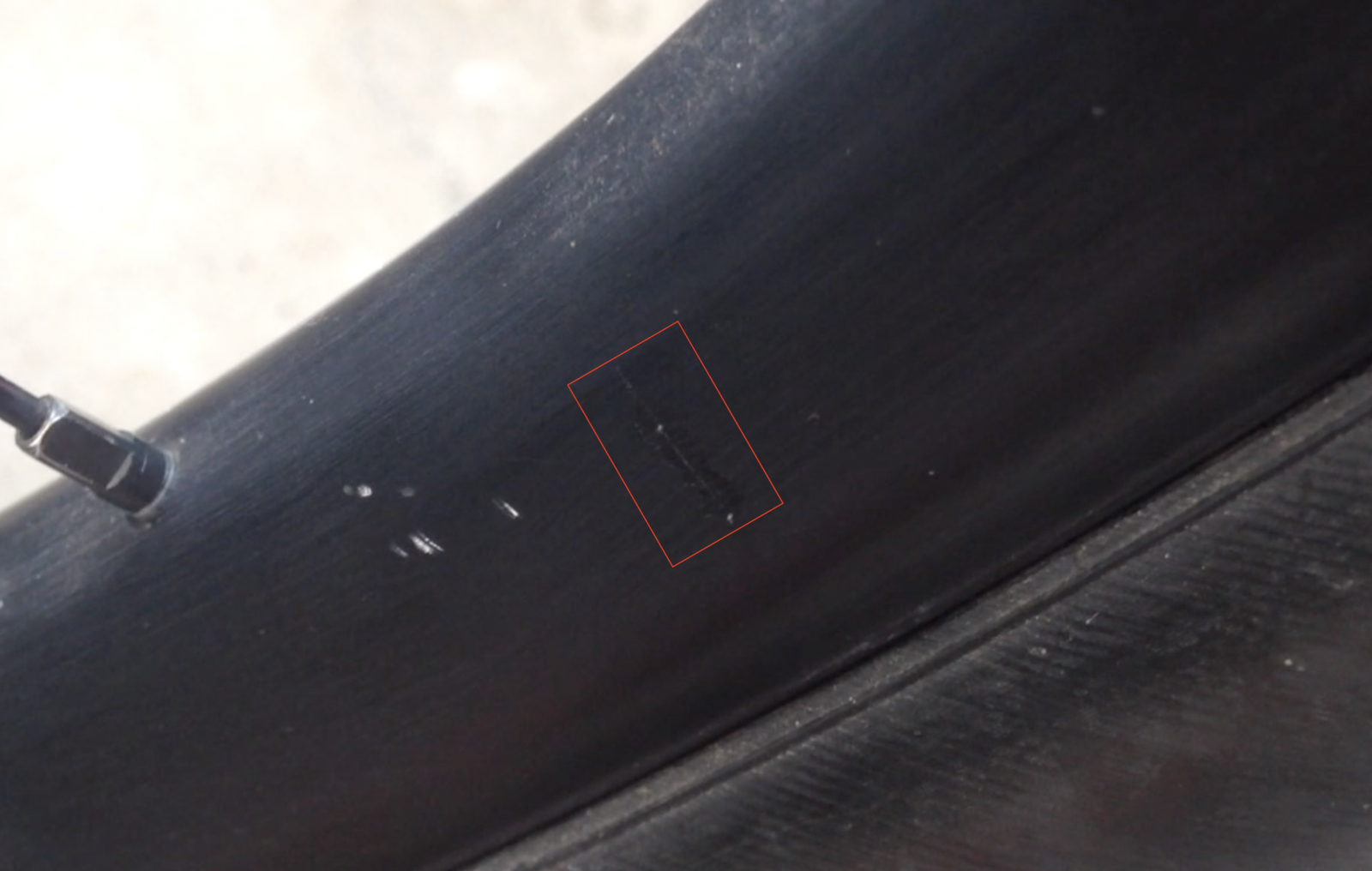

While I was converting my front wheel to tubeless last weekend I've discovered hair-thin crack (>10 mm or 1/2" in length) after I've bedded the tire - it leaked air and bubbled from underneath the wheel's decals.
Is it something I should be concerned about?
LBS guy told me to keep riding and keep an eye on the crack size.
Ally can be dented but a crack is usually down to metal fatigue caused by continuous flexing and that would show through a paint finish and start at an edge. So I would say the crack is a manufacturing fault rather than fatigue or impact damage. Spec wheels are included in the lifetime warranty so get it changed.
That’s clearly a production error and I would request a new wheel immediately. Can you imagine what would happen if it suddenly disintegrate when you go downhill at 30 mph? We are ultimately talking your health here.

thanks @khorn and @Mikerb... my thoughts exactly... at the beginning, I told myself I'm going to go along with LBS suggestion but subconsciousness is a bitch and I started to be more worried :)

I full agree, it looks pretty dangerous. If the crack is already leaking bubbles it isn't a scratch but it's a crack which went completely through the aluminium rim. I would bring your bike in to claim warranty.

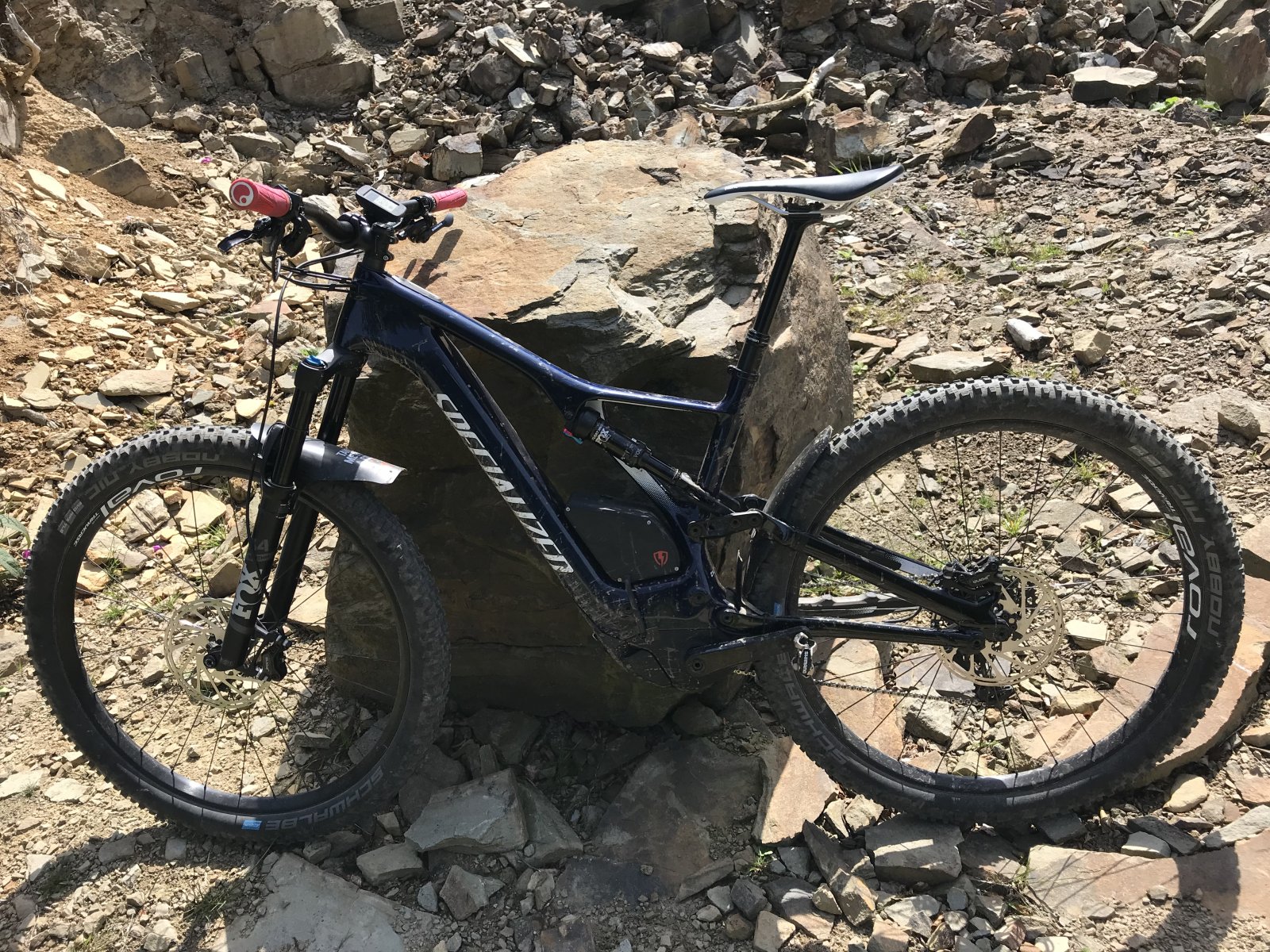

my comp carbon at whinlatter , will post some of my thoughts on the bike later

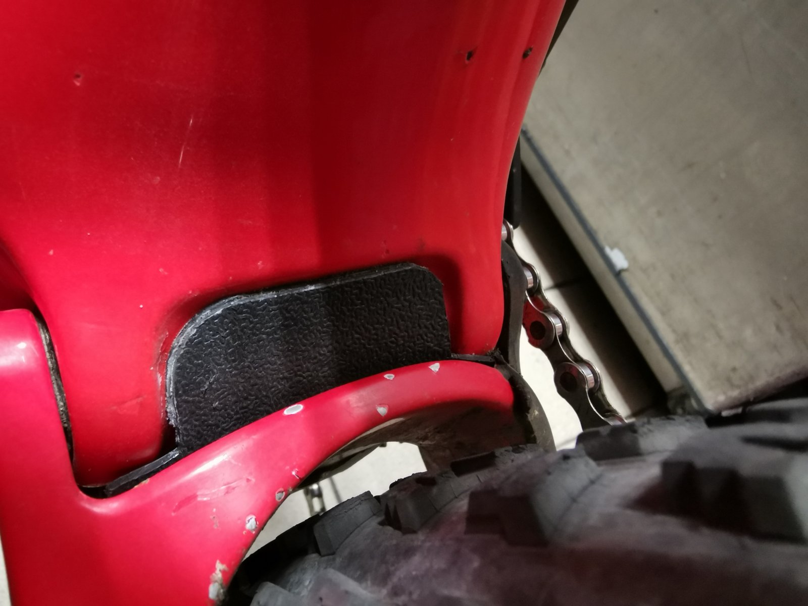

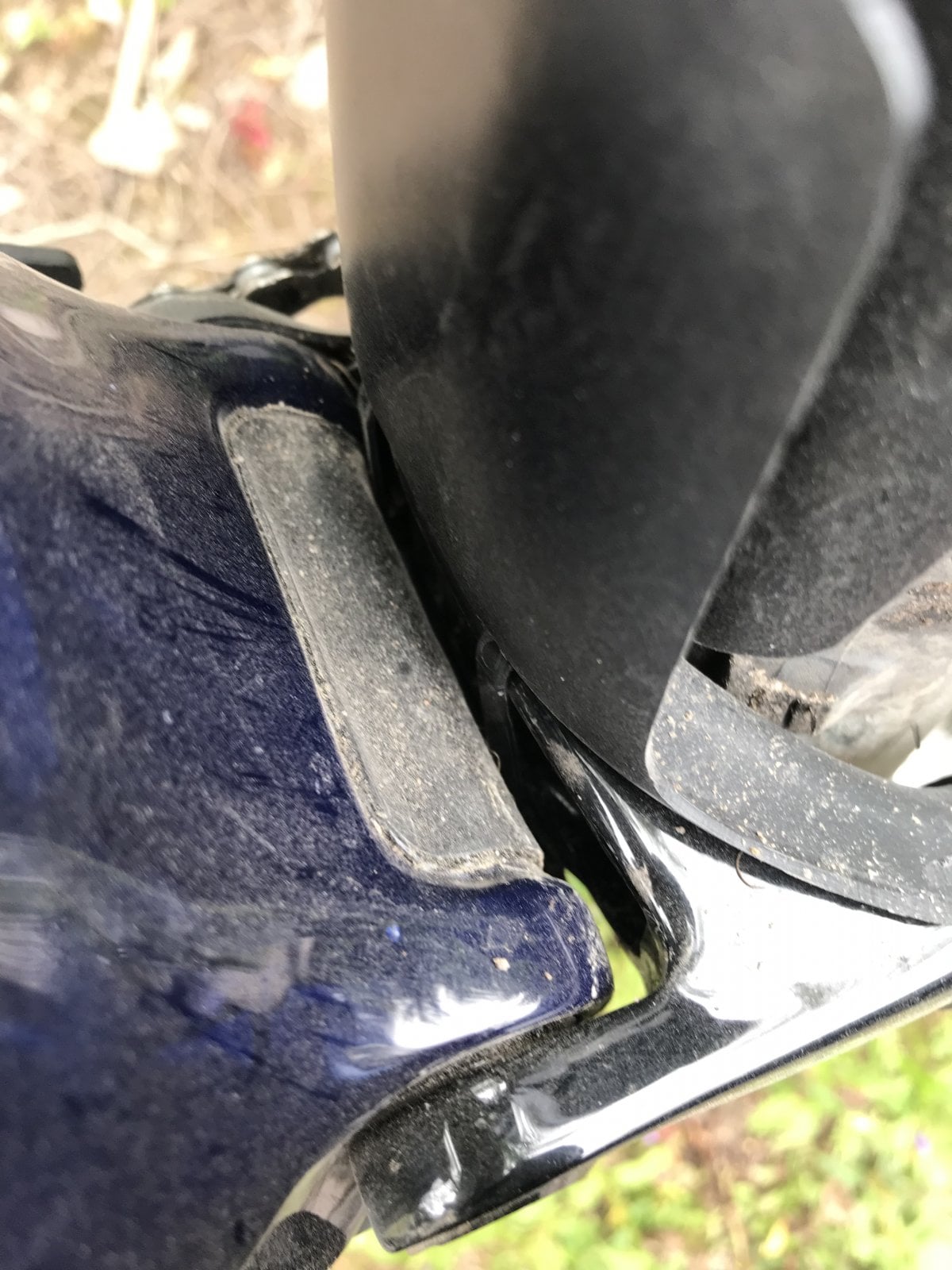

2. Not looked under cover yet for debris but my dad designed a shit lip see below for pic.

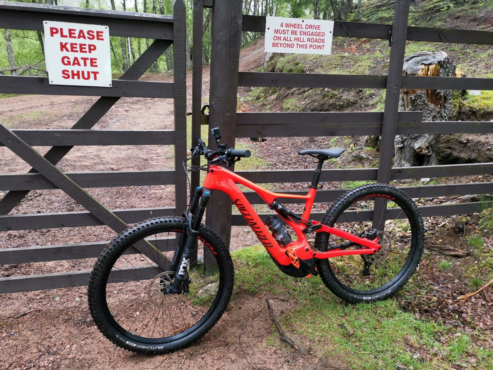

Bike at start of burma Road in Scotland, look it up its a amazing ride
My shit lip

2,6...……...you need a rear mudguard. I don't think the paint finish is poor. The area you photographed gets bombarded by stones off the rear wheel at speed and no paint will stand up to that. The arched section in the picture I have covered with frame protector.
3,...…...I agree and I use Komoot which is a free phone app which is not only completely reliable but does a lot more than MC to map rides, navigate rides etc ( and if you buy/download a map of the region where you are riding the phone does not need any internet access)
2....your DIY lip will not prevent dust or water going down there. There is a Specialized mod kit for it which my bike does not have yet either so meanwhile I have used a small kitchen sink sponge stuffed into the gap ( and a mudguard).
6...I think your LBS can order the correct touch up paint.

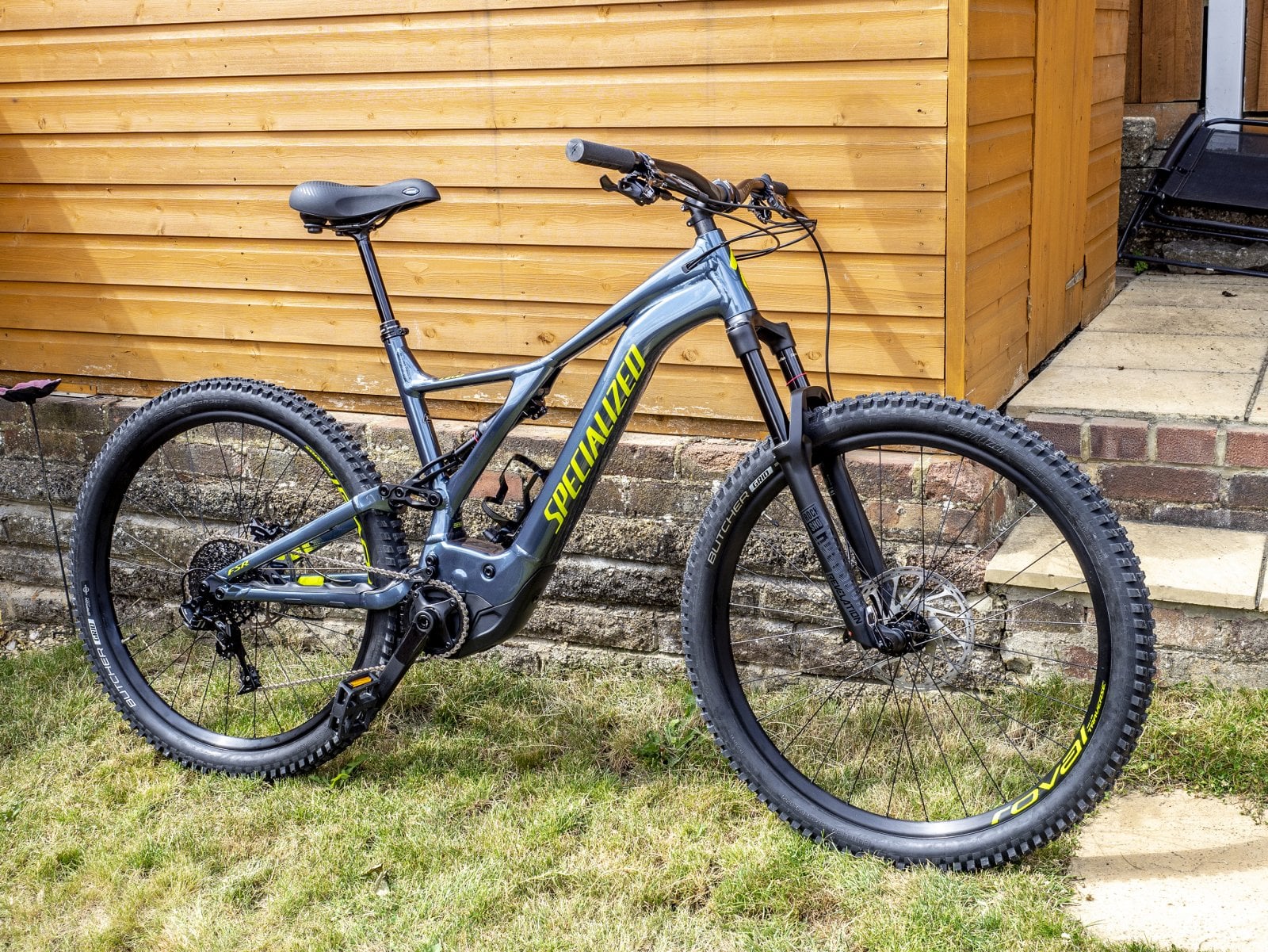

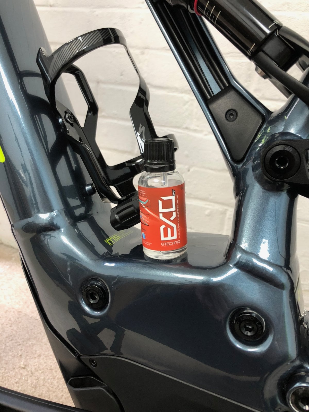

Hi.... picked up my Levo Comp today. I tried a few different bikes out before looking at these because i sort of always knew i wanted one. So, i got it home this morning and first job was to make it more durable in the wet and dirt. Wheels off, i set to wiping down with a paint cleaner to remove any grease and contaminants, hen applied Gtechniq EXO (had some left over from a customers car) on the paint. now its all clean and protected. can't wait to get it out.
