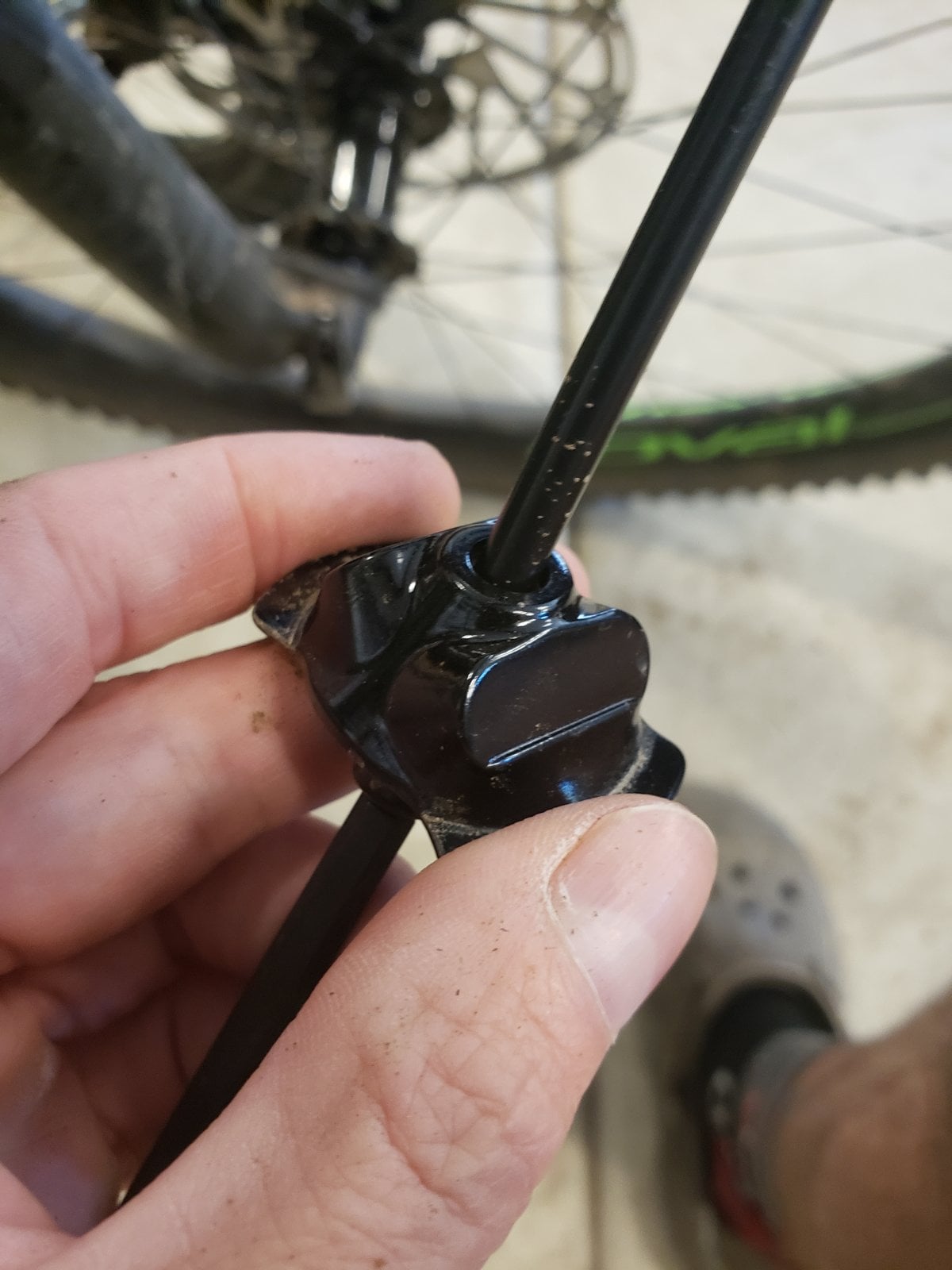

Hi! Anyone have trouble with the rear hub that comes with the Comp Carbon Levo 2019? Myself and several of my mates need to tighten the preaload nuts for the bearings quite often. (Like every 3-5 rides) the LBS did this at first but I have done it lately my self. This sucks, if you bought a brand new expensive car and had to tighten the wheel bearings after a few rides repeatedly, you would just not accept it! Our local LBS sent a complaint to Specialized regarding this issue. They were told that we just have to tighten the nuts on a regular basis. I’m not looking for technical solutions to this, just curious if anyone else experience this. And yes we have tried with loctite, new bearings and all thinkable other solutions in dialogue with our LBS. I have now given up and put on a DT Swiss H 1700 wheel out back. But that ain’t right. I thought specialized were world class in customer support? At least that impression was given me when I bought the 2019 Levo.

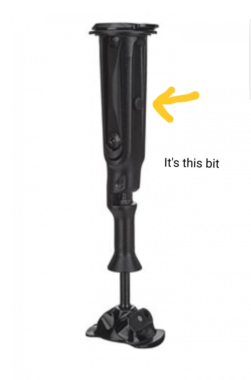

The SWAT CC steerer tube tool that comes with 2019 carbon Levos has a 5mm hex bolt that is accessed from below the fork crown. The 5mm bolt goes thru a base plate that interfaces with the bottom of the steerer tube tube and preloads the headset bearings by tightening them against the cap on top of the stem. (It also serves as part of the chain breaker.) From the factory mine was set a bit loose (not enough bearing preload), and I noticed a slight clunking sound from the headset area on larger hits. I would advise checking the headset bearing preload on ANY new bike purchase, with or without the SWAT tool.
To adjust the preload you need to loosen the stem (usually 4mm hex) before adjusting the 5mm bolt and retighten the stem afterwards. You also have to completely remove the upper part of the SWAT CC tool if you want to change stem spacers or switch or flip stems. It's a bit more involved than a conventional star-nut system but very easy to do.
I just traded my comp in for the expert. It has the swat but no chain breaker or extra link carrier? I thought this was supposed to come with it? I just got it last week build date was 2.13.19
It has a chain breaker and spare link, you just have to undo the bolt under the steerer tube and pull out the swat tool holder, it's all in one piece
Yep not there, no chain break and no link holder just pulled it apart to grease top of steer tube chasing a creak. All the videos and photos show it.
Did the grease get rid of the creak? I’ve got the same issue. Gonna change them out for metal spacers..
Yes, fixed. It had a dab of grease on the steer tube from factory below the lower bearing race. I added a little more and spread it all the way around and no creaks.
PS my only additional thoughts at this time is Command Post is not good at all, 5 days and it's already dropping when I sit on it after bringing back up. I think the rear tire needs a DH casing as well. Anyway LOVING the bike
Definitely missing from my bike. No chain link magnet spot and no slot. The whole bottom part with the notch isn't there or the flared bottom. I pulled it out again after my ride and brought it into shop as I flat spotted my rear rim. They pulled it out to double check as well. Side note, check your spoke tension!
That's weird, is yours a different part completely, or is there just part of it missing?
You would think specialized only made one swat tool, because without the chain breaker etc, not really a swat tool is it ?

it does kind of suck, i have been using 70 psi and applying suspension grease and wiping it off and it's better for a few rides. I spent 2 hours yesterday trying to figure out why it wouldn't shift out of the bottom gear, the thru axle had loosened up after 2 weeks
