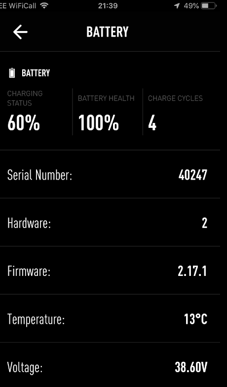

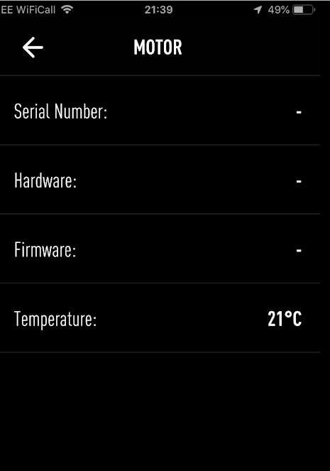

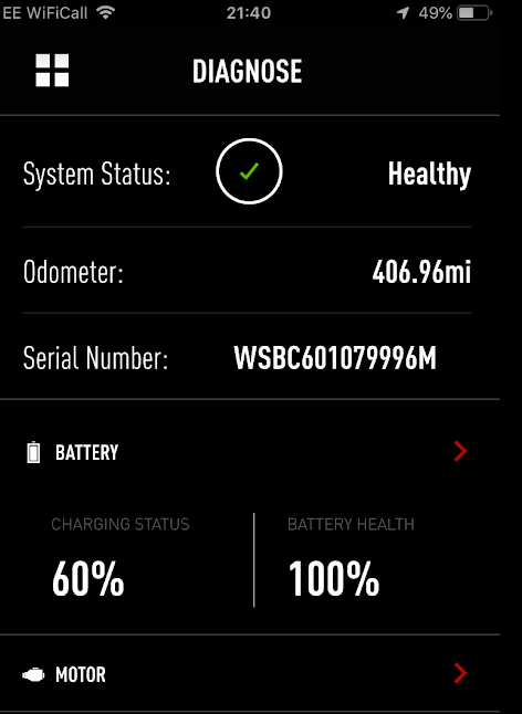

I have recently had a new battery for my Turbo Levo Expert MY2017 and all was well for the first few rides but I am now experiencing what appears like a motor connection issue either at the start of a ride or it cutting out during a ride?
My Mission Control App shows the following:
The connection from the battery to the motors appears good and is free from corrosion or dirt ingress.
