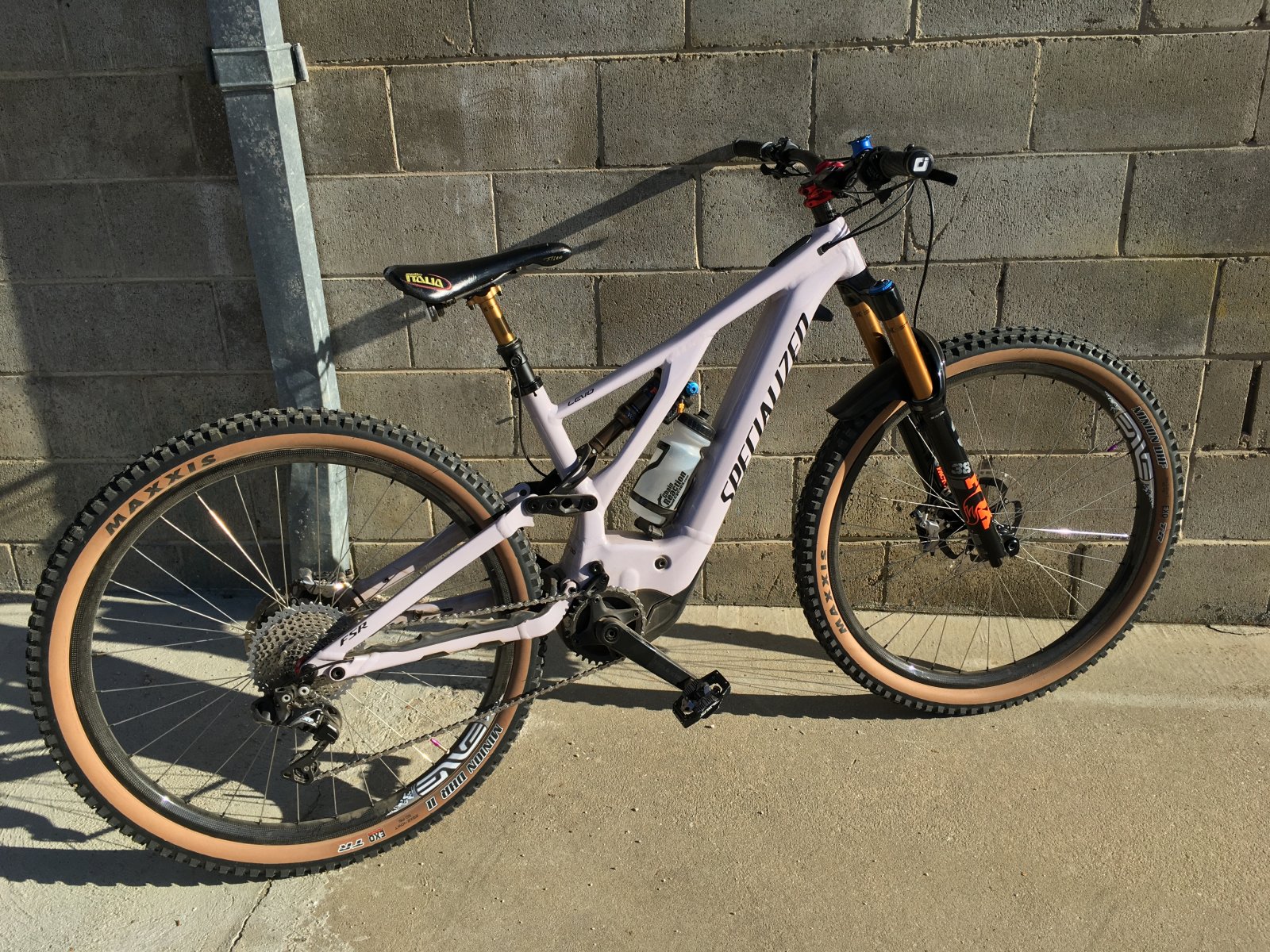

Wow, that's a horrible experience. I do really feel for you and hope your new Levo's problems are all behind you. This is my new gen 2 alloy Levo I have just built. They are such a fabulous machine enjoy yours.
