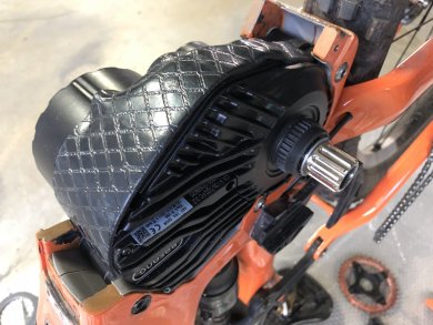

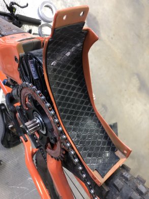

I placed the silent gear in my M600, and it was more quiet.
With my 600er it has only brought a slight improvement. By decoupling it from the frame and using insulating panels, it only became really quiet
Looks like its a kind of bitumen insulation. What are the heat insulation proporties ?

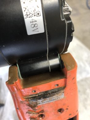

What did you use for the e-motor mounts ?
These are self-adhesive bitumen mats from car accessories, I used 1mm sealing paper to attach the engine
How thick are those bitumen mats? Have you consider future issues in the motor, because the bitumen mats may not transfer heat to the frame, and all heat may stay in the motor?
Since the carbon frame does not absorb any heat from the engine anyway, the decoupling does not play a thermal role. the insulation mat is about 3mm thick and sits in a place where no wind comes to cool anyway. I have driven it up to now about 1200 miles and had no overheating problems even in summer ?

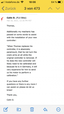

You must be careful if you open your motor, on my first attempt i had destroyed the controller when i came to the circuit board with the screwdriver during removal and i had recently received this notice from FLX bike:

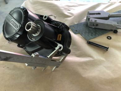

do you know if i can buy in Europe a m500 m600 mounting plate
FP G520?
I have emailed bafang , but as you can expect no answer.

The text, so it's easier to search for in the future, well, hopefully ! :
Additionally my mechanic has
passed on some words to assist
with the installation of your new
controller:
"When Thomas replaces his
controller, it is absolutely
paramount, that he not turn the
crank arms at all while the
original controller is removed. If
he does the new controller will
likely need to be calibrated and
because he is in Germany, it will
very expensive for him to send
us his motor to perform a
calibration."
If you have any further
questions or there is any more I
can assist on please do let us
know!
