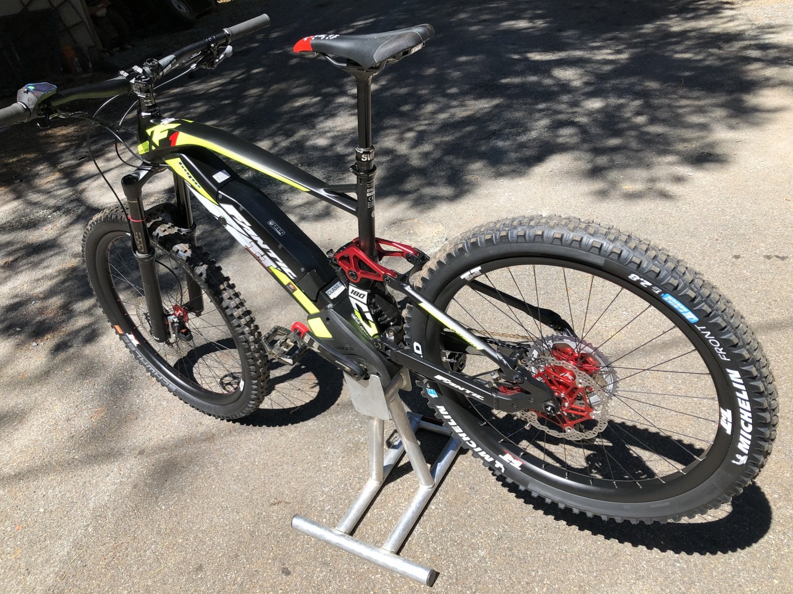

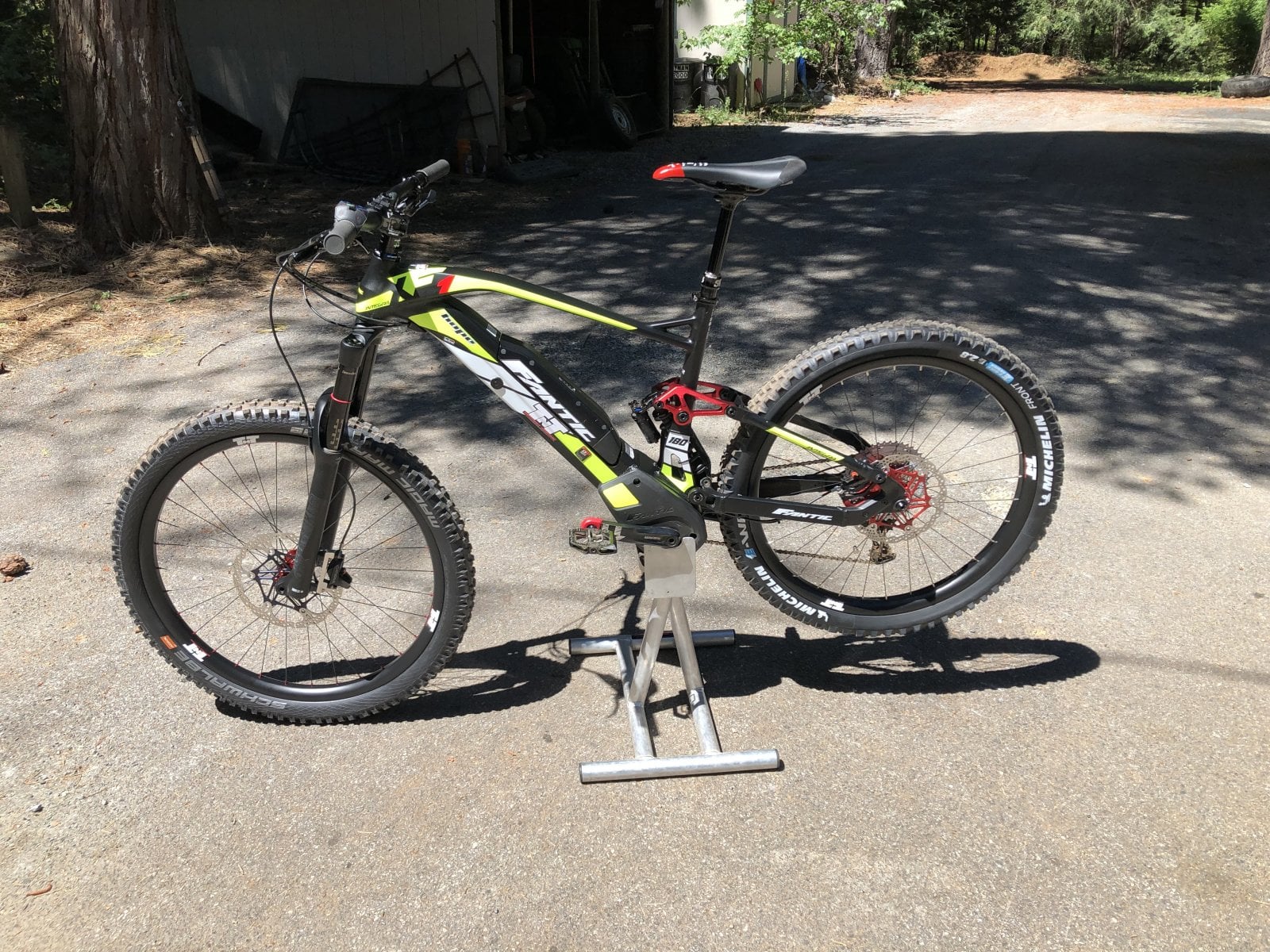

Race bike finished, the combo I’m going with for this weekend.
Mary 2.6 up front and 2.8 Ewild front soft compound in rear.
My practice bike has 2.6 Hans up front and 2.6 Ewild in rear.
Spares are Eddie current 2.8 rear and soft compound Hans 2.6 for front
Practice bike has 29x35 front rim and 27x5x 40 rear
Race is 29x36.5 front and 27.5x43 rear
As a rule I don't like bling but the red rear hub matching the shock link is the ducks nuts! Matching front hub would take it to drool category.
Front hub is matching just not the front rotor as Hope only has the 225mm rotors in black, i have one at powder coated to have it done in red as i can’t anodize it

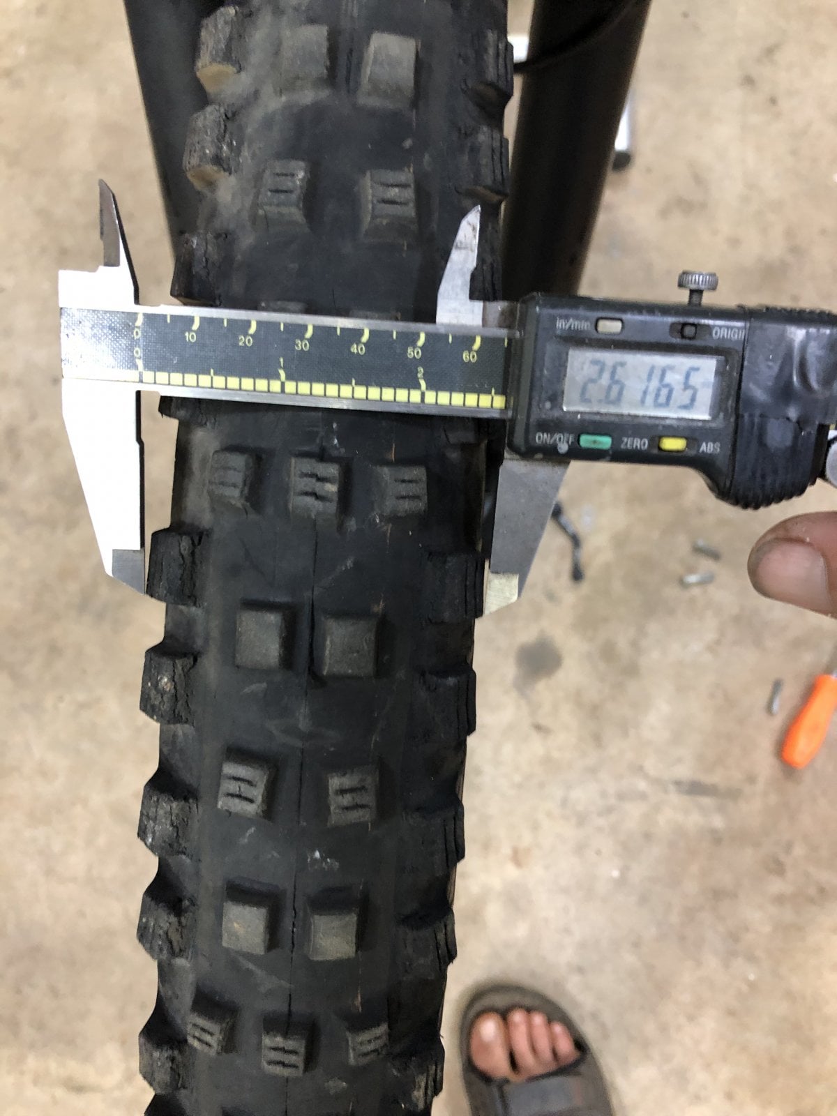

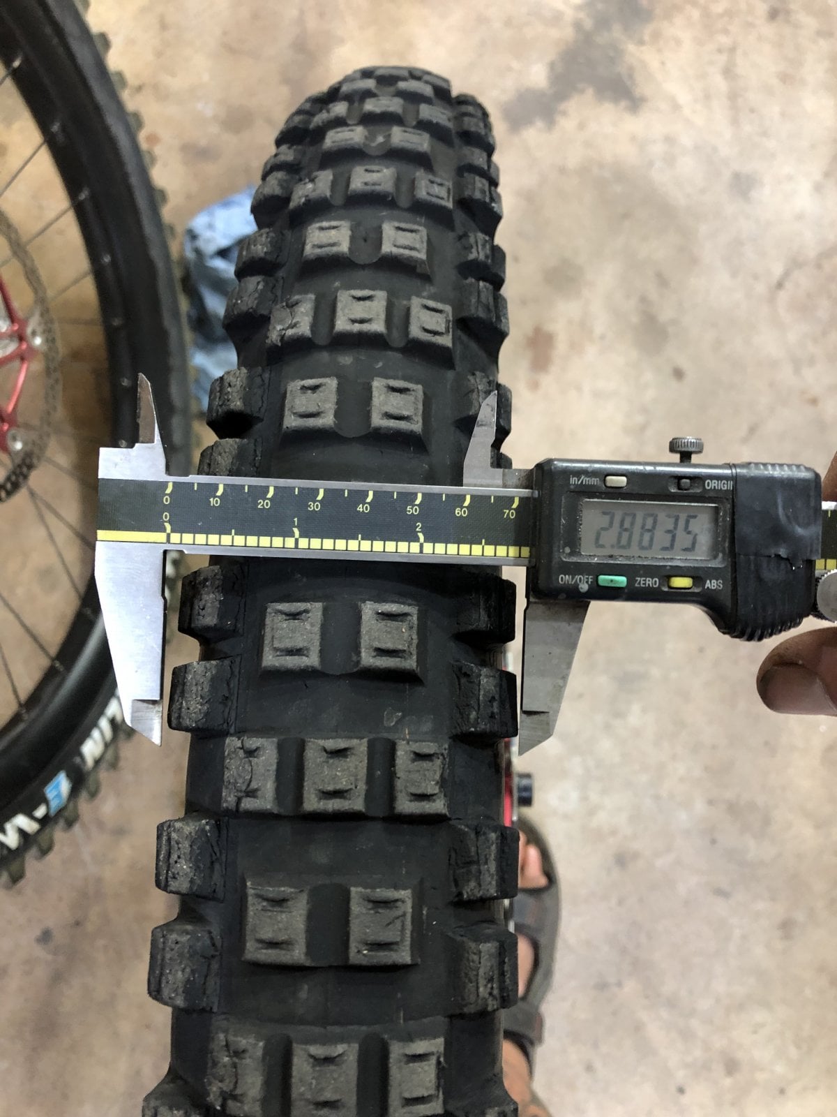

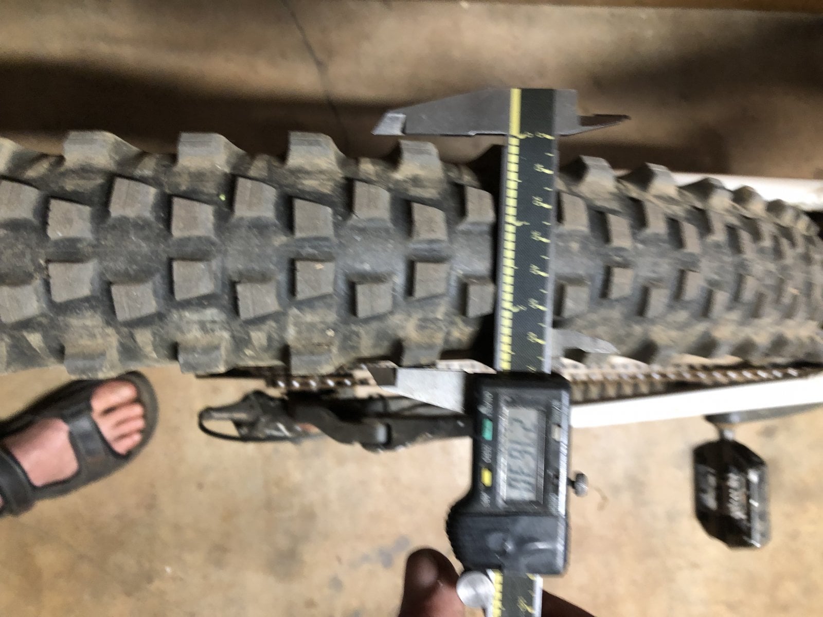

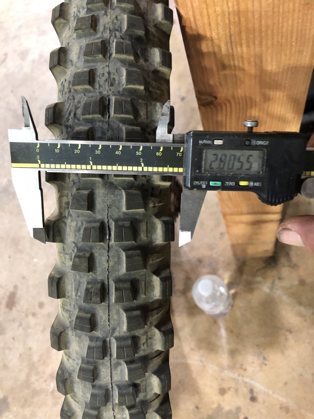

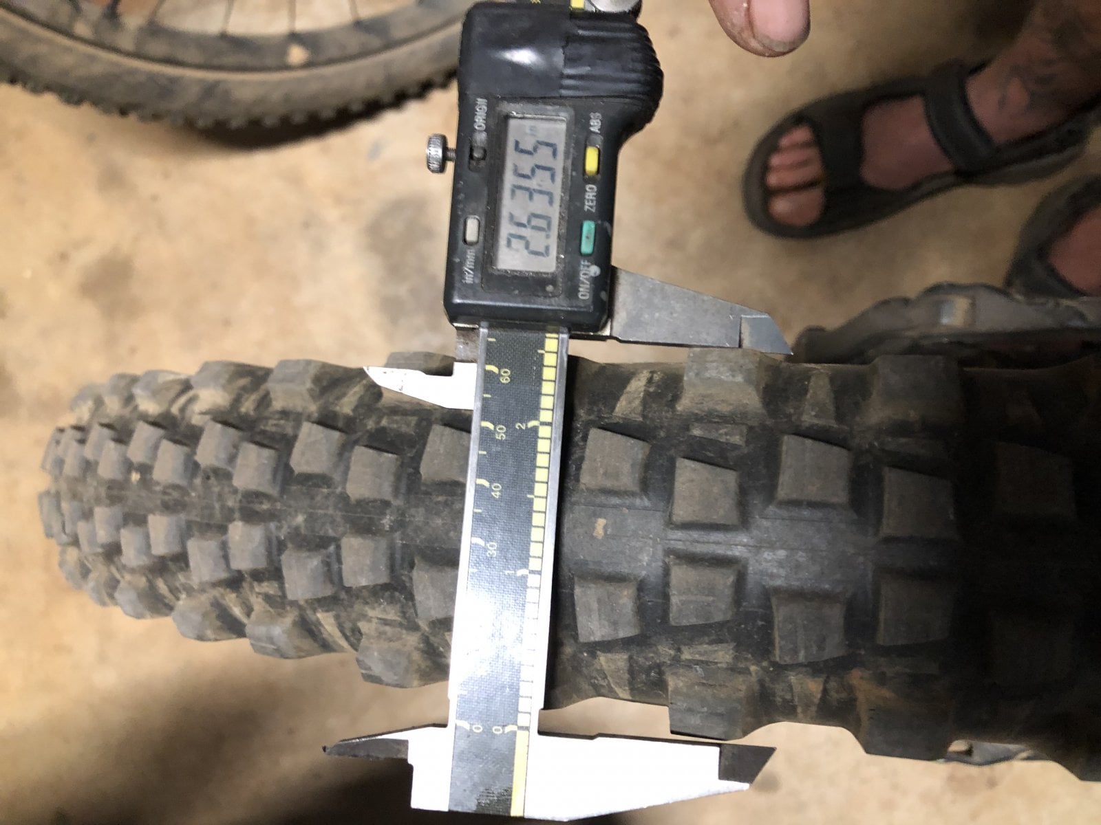

Ok thanks. I see there's a wild enduro front in a 2.6. That might be the way to go up front then. That should be 1200g +.
Did you measure widths? Ewild 2.6 compared to magic Mary 2.6?if not , could you?
Ok you you go
Pic 1 29x2.6 Mary on 36.6
Pic 2 27.5x2.8 Ewild on 43
Pic 3 27.5x2.6 Ewild on 40
Pic 4 27.5x2.8 Eddie on 43
Pic 5 27.5x2.8 Ewild on 34
Dirtnvert
Sep 25, 2018
1,352
1,600
BC Canada
Ok you you go
Much appreciated Tim. Looks like the widths are really close(2.6 to 2.6). I'm guessing the wider rom that the 2.6 ewild is on, as opposed to the 2.6 mm, would make up for that difference. Reason I asked is because I had a 2.6 mm previously and I wouldn't want to stray too much wider than that. That helps . Changed tires(widths mostly) in my shopping cart back and forth a few times and was apprehensive about getting something too wide
