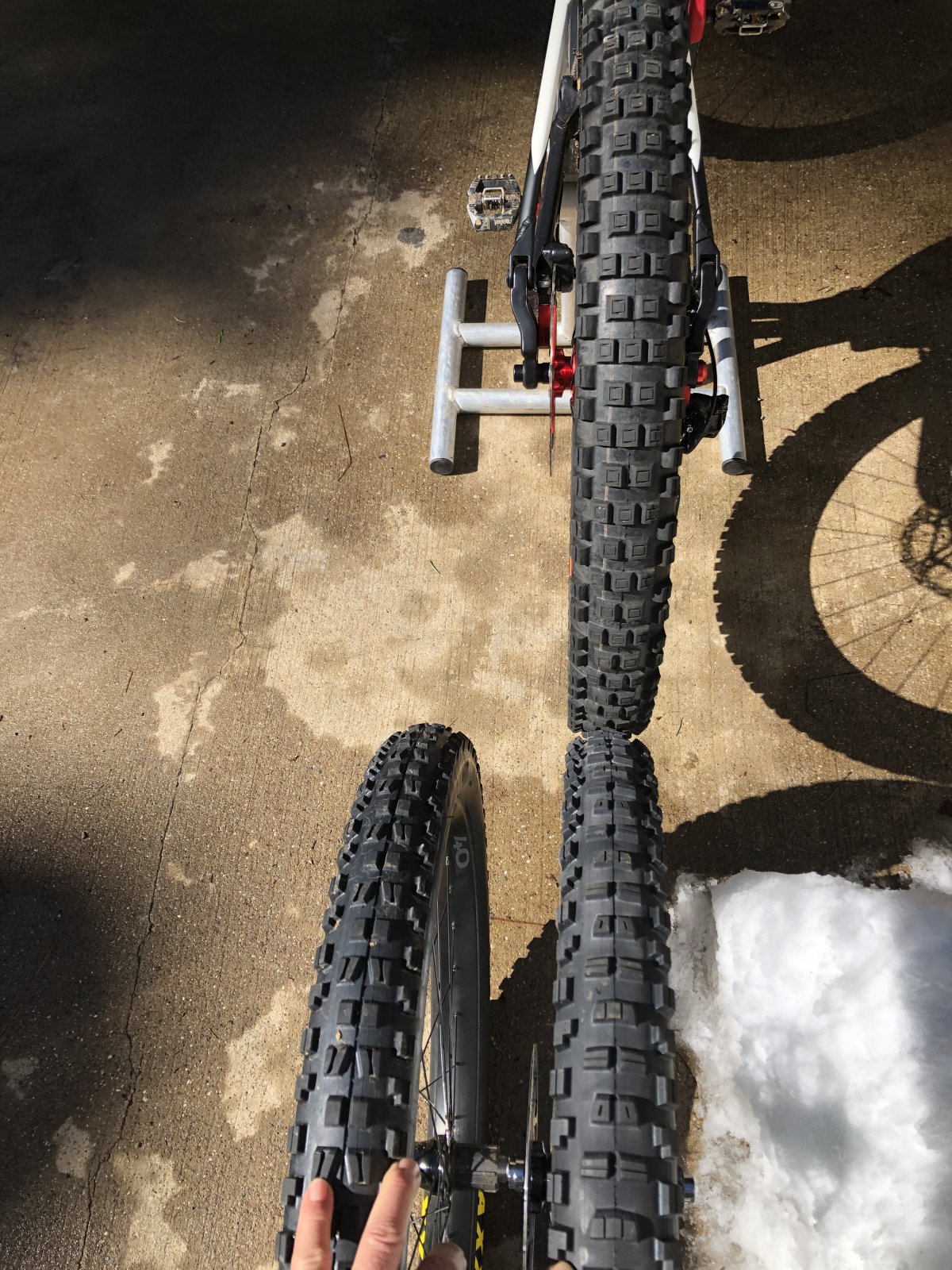

First pic is a 2.6 wt DHF ON A 40 internal
Next to Eddie on a 43 internal
Second pic
2.6 Mary on a 36.5 internal, next to it is a 2.5 DHF ON A 35 internal.
Outside is a 2.4 Eddie on 32 internal
Third pic.
2.8 Eddie on bike on a 43 internal
Next is 2.8 DHF ON A 34 internal
Outside is a 2.6 DHF-wt on a 40 internal
Last pic is a 2.8 Eddie on bike holding 2.8 DHR 2.8 on 36 internal
Beside it is 2.6- DHF WT ON 40

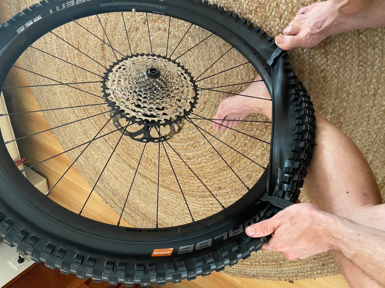

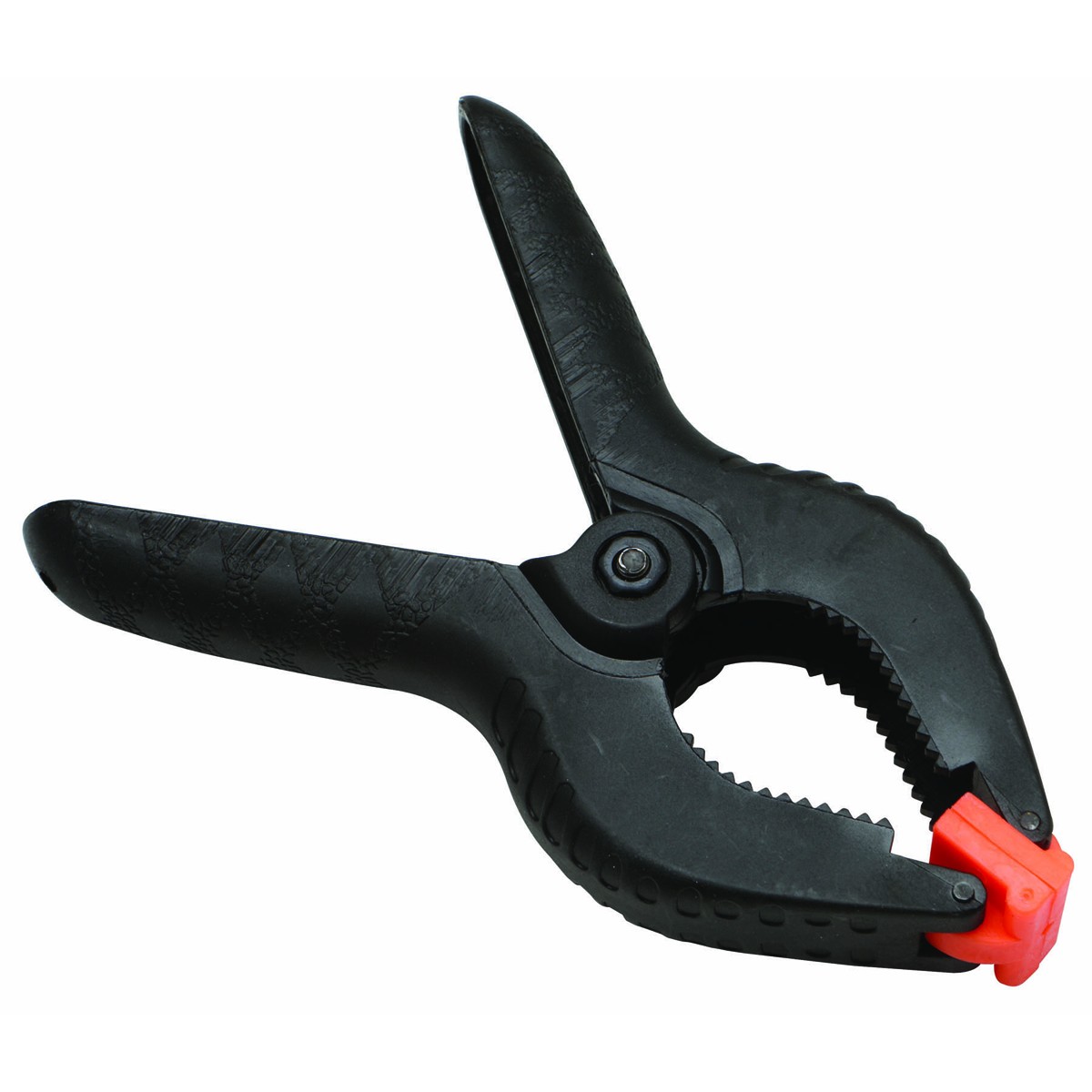

I broke two levers getting mine on, try this, take three spring clampsimage_20427.jpg
get the tyre on as far as possible like in your photo and put one clamp each side clamping the tyre together.
Lever a bit more of the tyre on close to one of the clamps and put the third clamp on.
Take the first clamp off (nearest the third clamp) and repeat till the tyre goes on.
Pump it up and enjoy the pop as it seats.
Then take it off again cause you forgot to put the sealant in:)

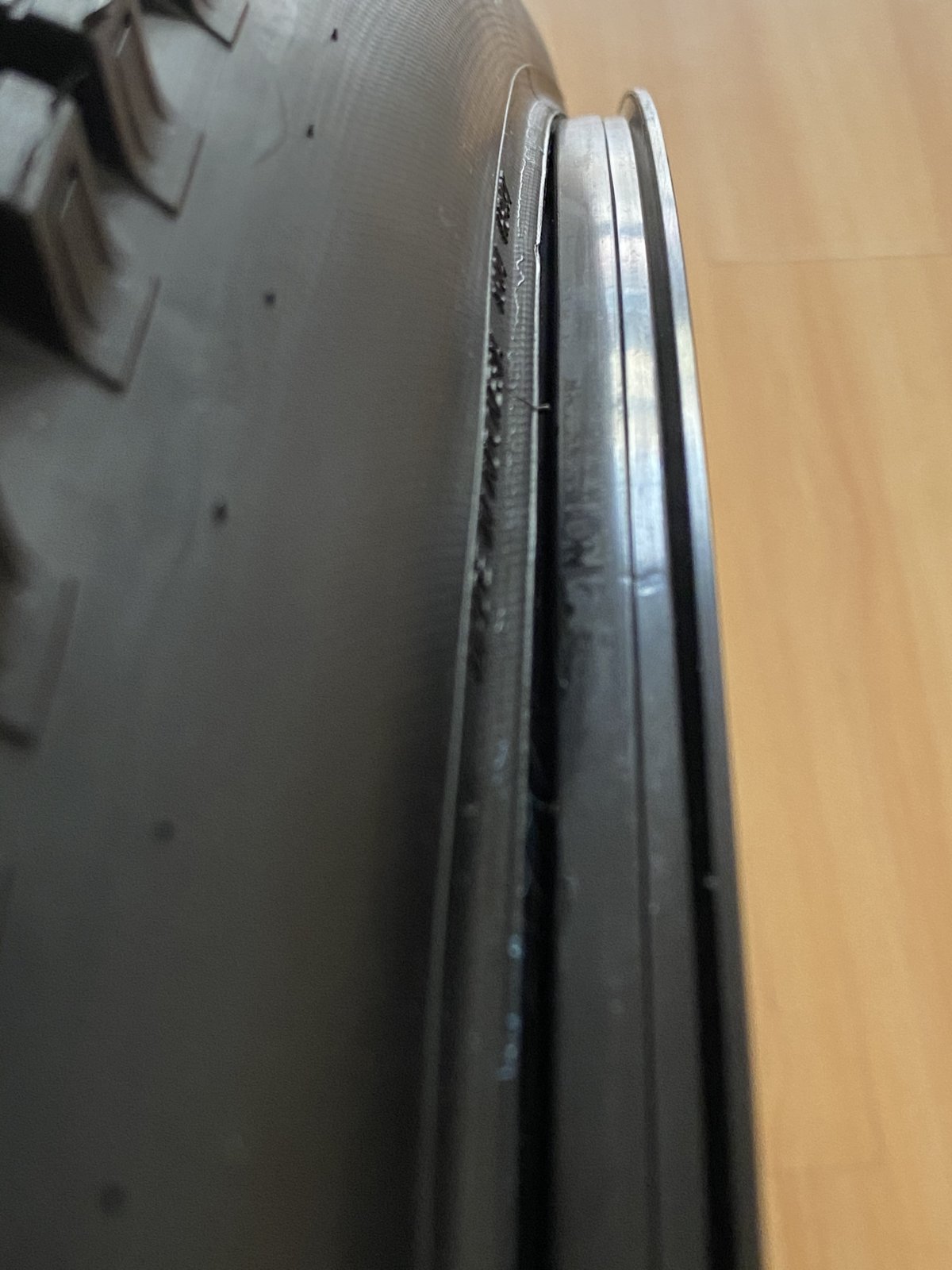

I’m starting to think that Bontrager wheels are not compatible with these. I have the bead at the lowest point in the rim, and am using the valve-last method. Check this out!
Beads will stretch over time. I guess you have to get it on to stretch though. Id put it in the oven in low heat then use soapy water and moto tire levers(be careful not to damage the rim inner wall with moto levers). Ive put rims on and off a few times that way until it was easy enough to get a tube in. Ride with a tube for a couple weeks and the bead stretches then do my ghetto tubeless setup. I dont have an oven so left them cook in the sun. Id use an oven if i had one
