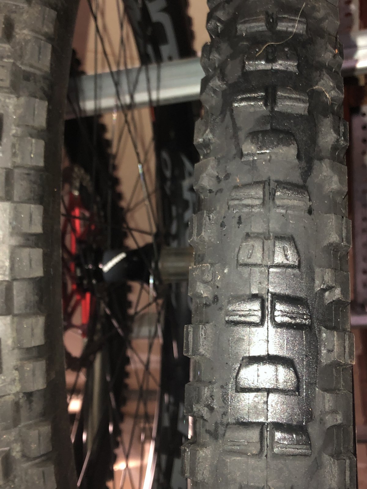

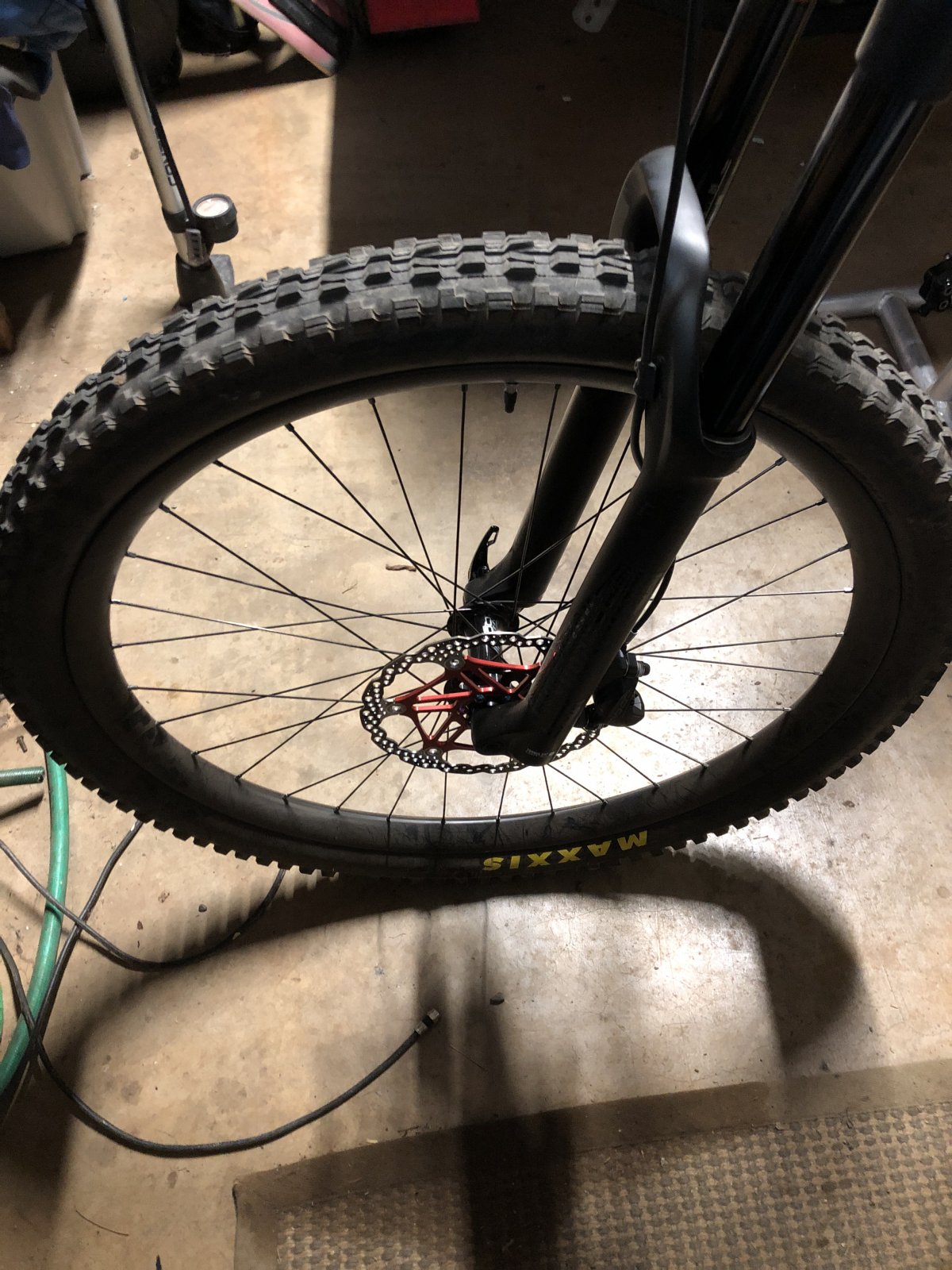

Gary, so i tried something yesterday, couldn’t give it a proper shake down as it was really muddy in a lot of places but shows some promise.
I put a 2.6 DHF wt on the rear on a 40 internal wheel. And a 2.5 dhf on front with a 35 internal.
That’s a 29 front and 27.5 rear.
So far I’m impressed. It’s pretty dam fast, have your (drift zone) on the rear that fades before the front so far has helped my dislike of the dhf front as the rear fades before the front and helps reduce that unexpected front wheel drift on off camber and hard fast turn ins.
But the combo is really fast rolling for a larger knobby tire. I am gonna give it a more thorough shake down on some fast hard sections and see if Nehru truly roll as fast as they feel like they do.
But i had fun with them yesterday in the wet. But i was running well off pace because of conditions.
But typically Maxxis doesn’t claim the dhf to be great in wet and muddy.

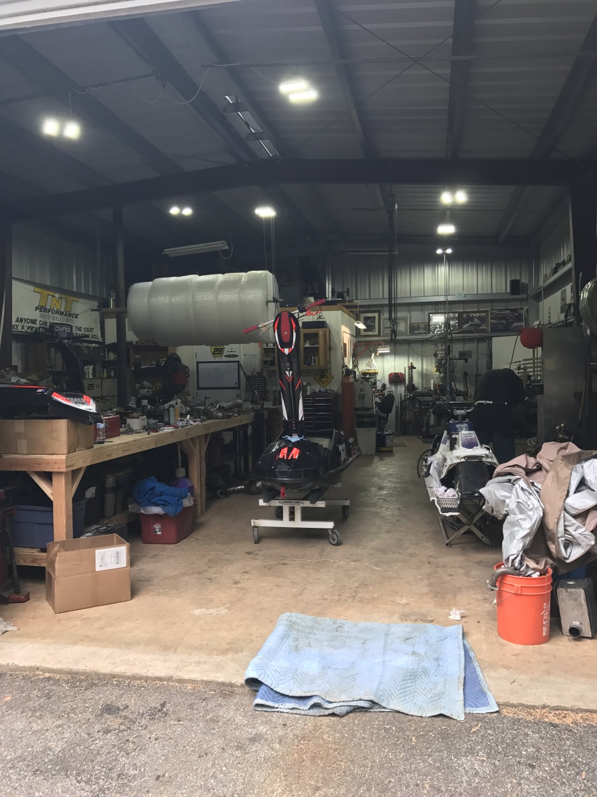

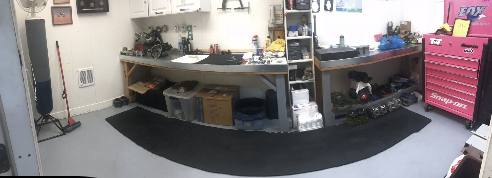

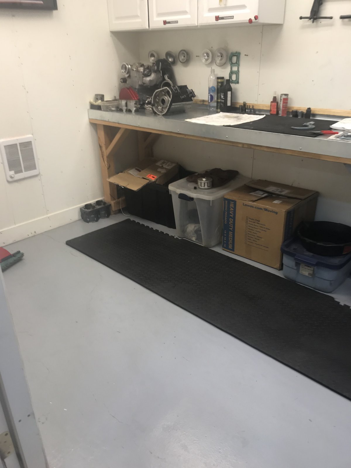

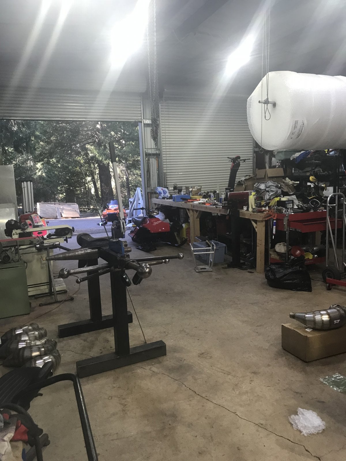

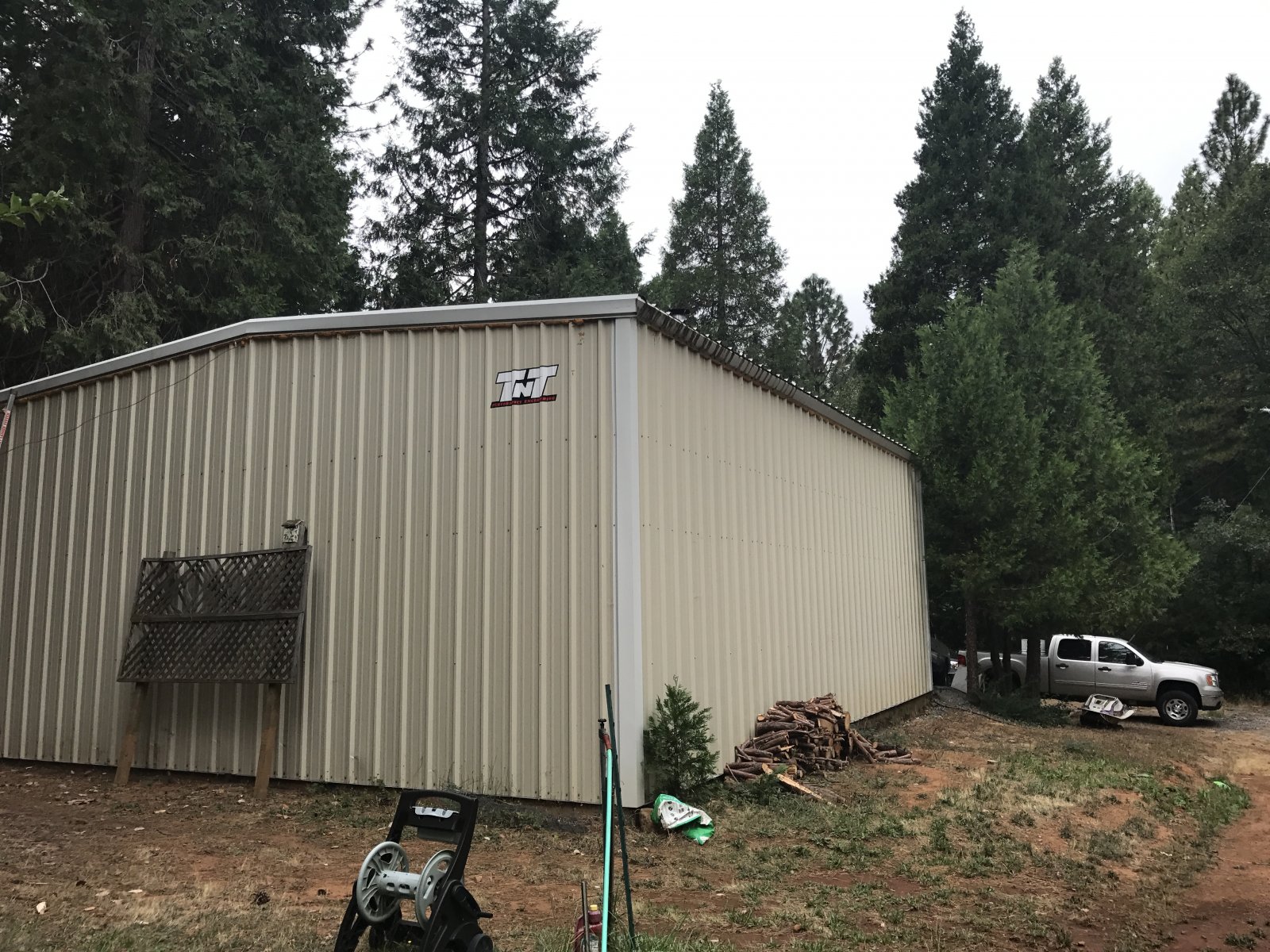

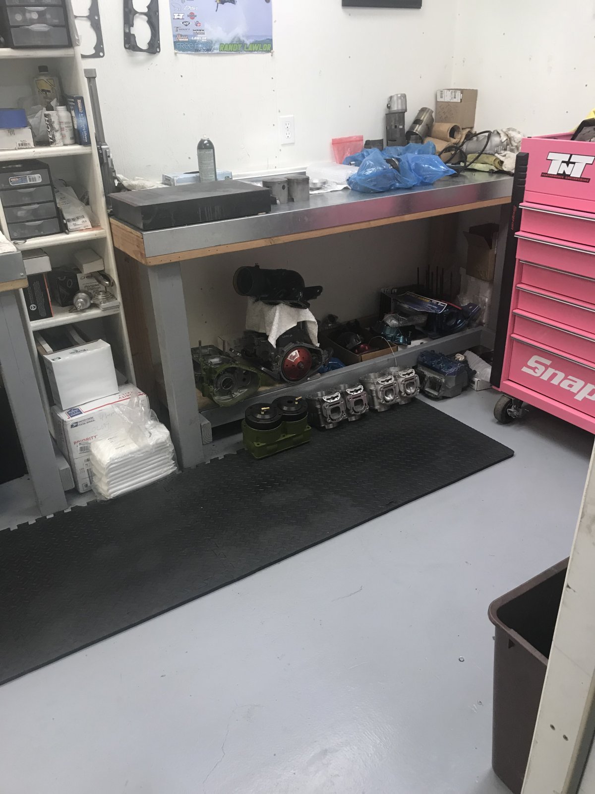

Kerrist! How many have a garage like that! :eek: (Envious):sick:
Mine looks like Steptoe's yard!
For the non-Brits in the membership and for those younger then 50, Steptoe was a junk dealer patrolling the streets with his horse and cart. It was an early 70's comedy on BBC (maybe late 60's).
Thays
Thats not my garage it’s a girlfriends.
Mine not as clean

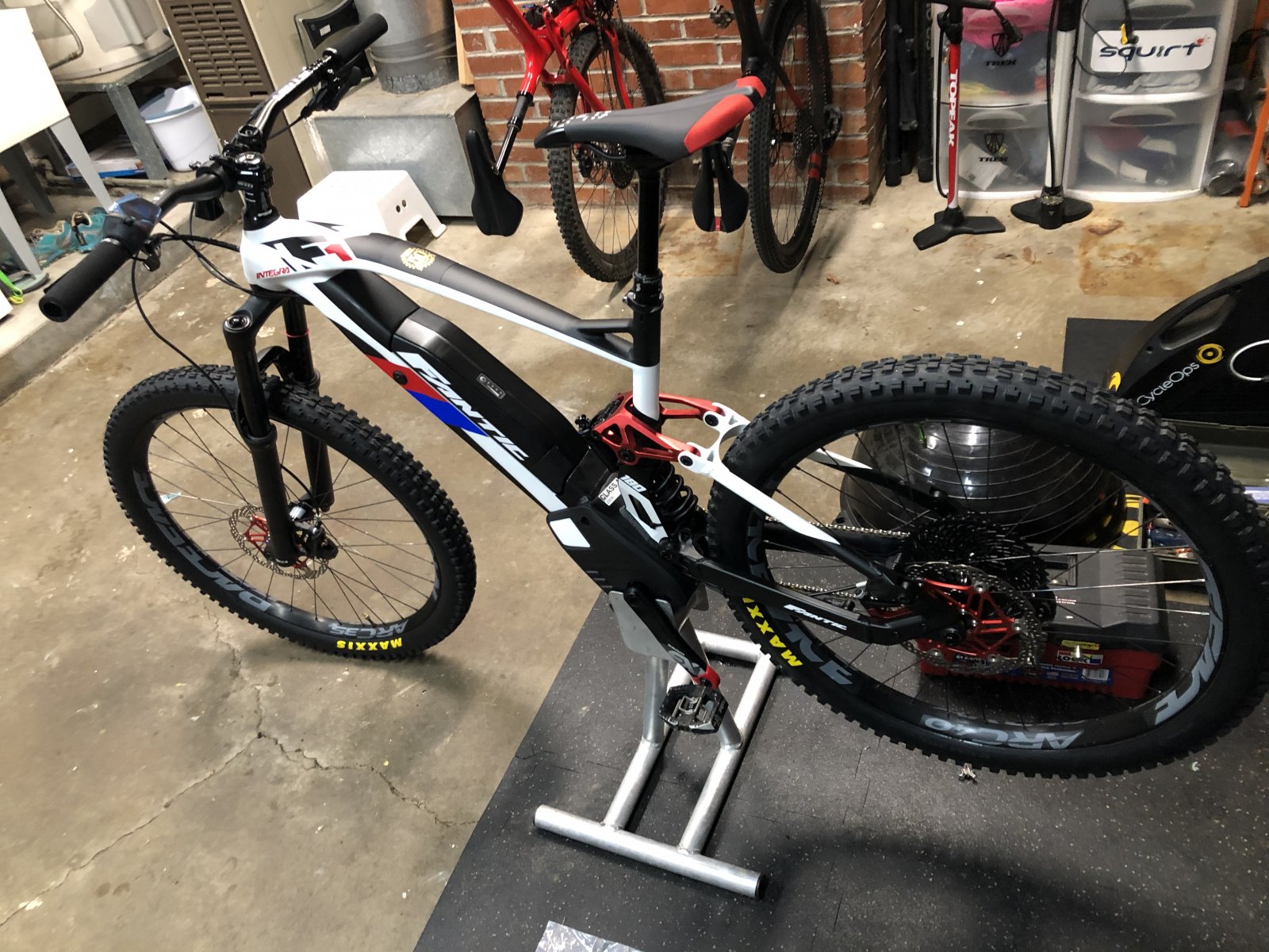

I have the 27.5 x2.8 rear and the 29x 2.6 rear up front.
Not sold on the front yet. Have the 29x2.4 and 2.6. It’s a little scary when wet. But worked pretty good on hard pack and chunk.
But can’t give it a proper shake down till it dries up a bit.
We been getting hammered with rain.
Plus I’m on a new bike so need to get it dialed in before i go tire testing.
But i really like the 27.5x2.8 rear in everything but mud.
Tire is amazing in chunk and hard pack.
