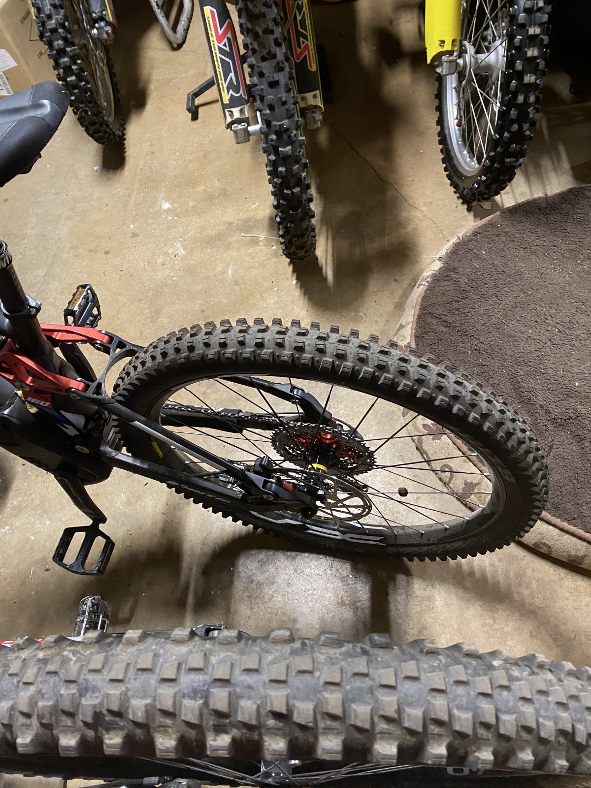

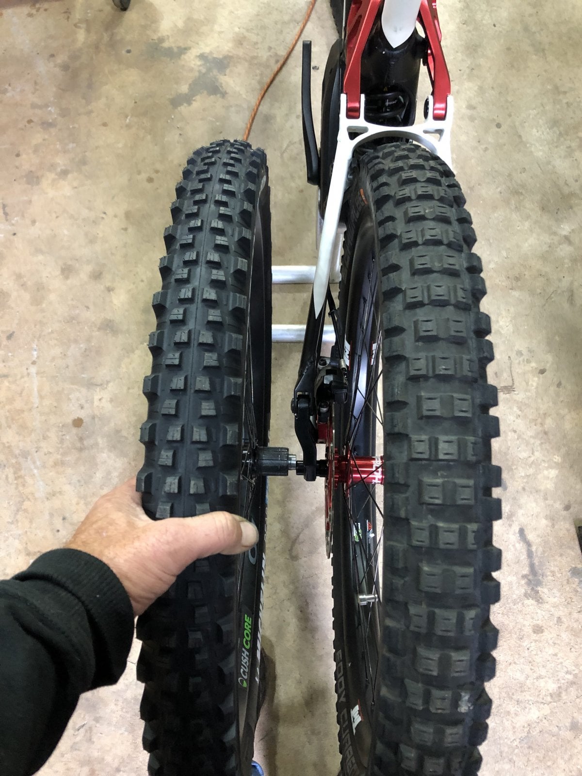

I don’t know the WTB tires to well, i do have a verdict the one on the pic.
that tire i find works ok in wet, sandy or powdery Conditions anything other then that the tire to me feels like it has 10-15Psi i always feel like i have a flat riding that tire. Even with smaller 27.5x2.5 on a 34 internal
I wish i liked them better as i can purchase them for less then half any other tire

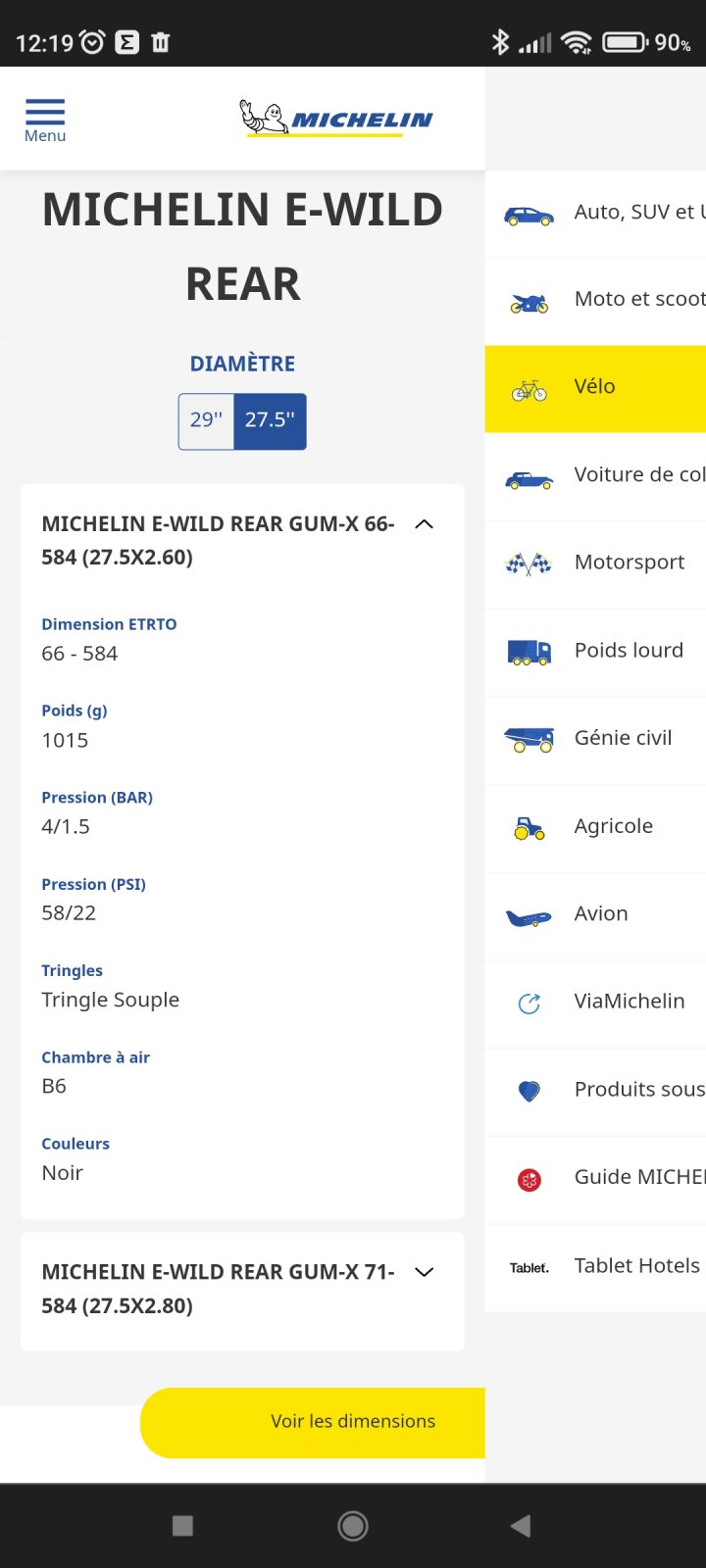

Cant find the weight for the 27,5“ 2.6 Ewild Rear.
Has someone put this tire on a Scale ?
thx
