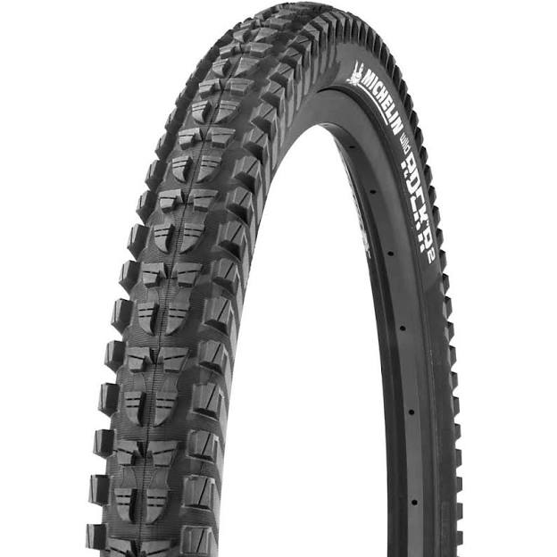

If the top one is the DHR2 then your idea of totally trashed an mine are completely different.
I have piles of them there all yours.
But there a catch.

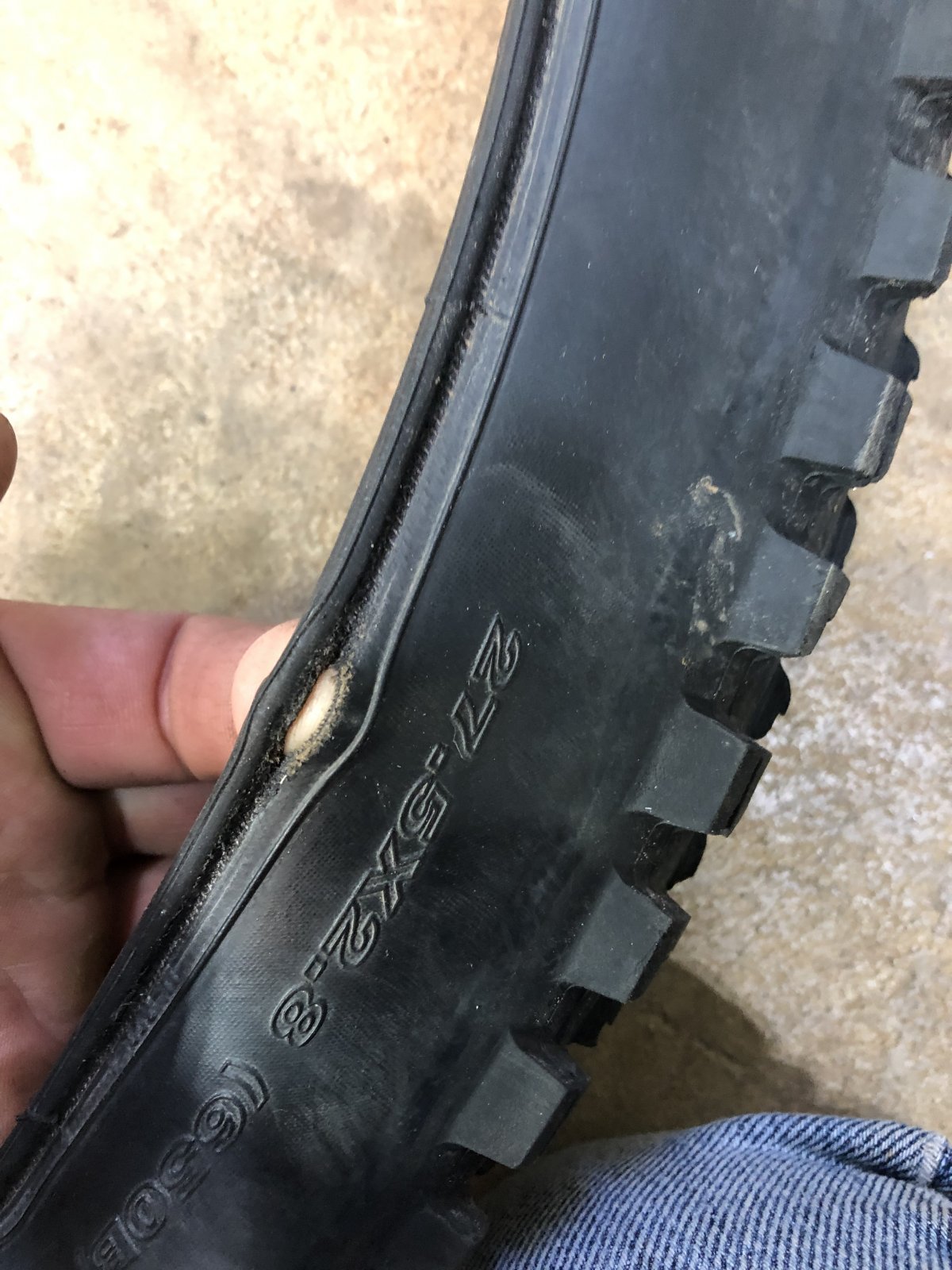

There at least one of those finger holes in the bead of everyone of the EXO case DHR2. That makes them totally trashed in my book.

Well that's different, you didn't show all the holes in the previous post, just the treads!
I did say totally trashed. I don’t understand how a tire fails like that without flatting

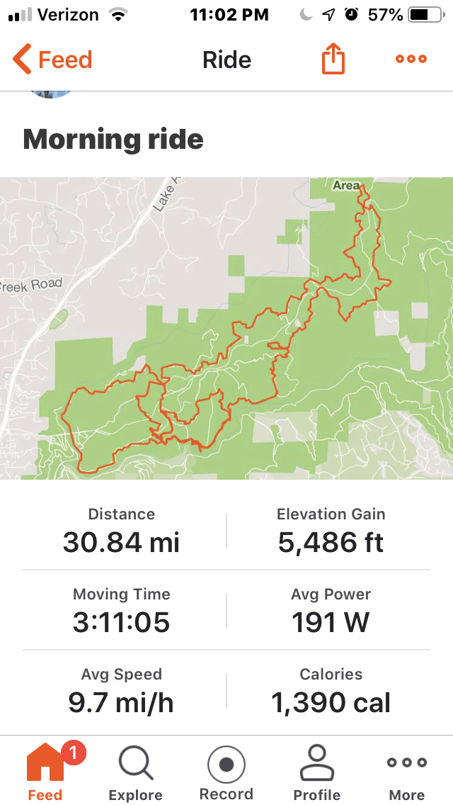

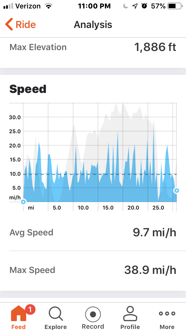

Today we did 32 miles of a combo of diets and the hot day dried out all southern slopes and the dry hard rocky conditions brought out the best in the Ewild.
The rough trails i ran today have given me a multiple of flats and rim damage over last year and at 22psi the 2.8 Ewild with a tube has now gone over 100 miles of rough terrain at speed and seems to only get better and impress me more. I have never been able to run under 30Psi with a DD Case max without serous risk of pinch flat or rim ding even tubliss.
I said i wasn’t gonna go tubeless until i flatted once. But that’s starting to look like it might not happen before tire wears out.
So I’m gonna switch it tubliss no core see how that goes
You can see by graph there a lot of hard braking from 25+ mph never broke 40mph

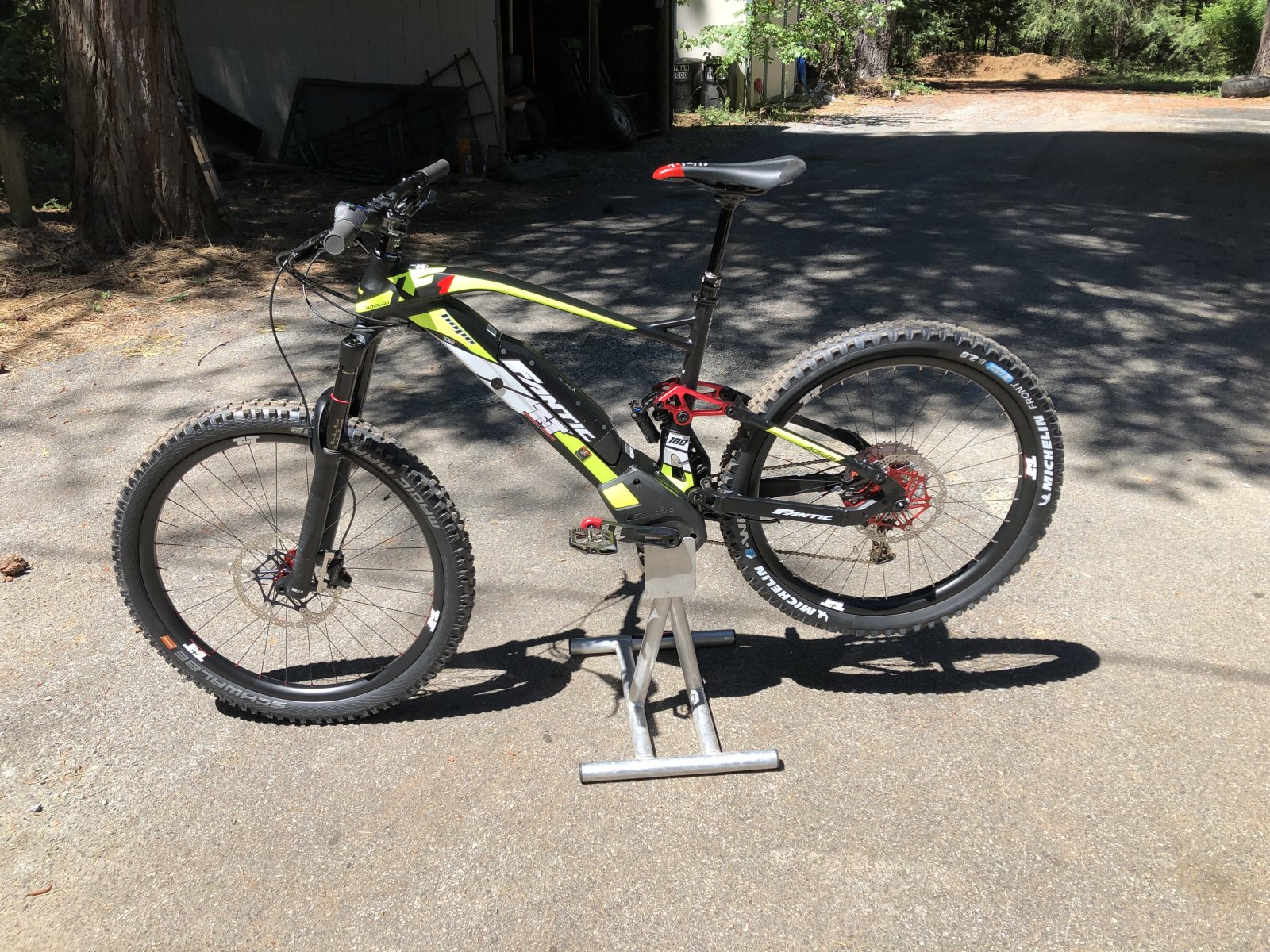

Interesting you say that. If you notice the bike with Ewild is my demo bike, my race bike still has Carbon hoops and swhalbes on it as well as red Hope 4 hubs and Rotors.
I’m always doing testing on my demo bike leave my race bike until the combo is proven.
Two of my riding mates also still have Mary/ Eddie combo and we have switched out on trail back and forth.
Shon says he likes the smoother feel of the larger volume Eddie with Cush core. It has a softer more compliant feel like it’s 5-6 psi lower pressure. But it also has more tire roll in corners and i feel Eddie needs a core to be solid.
One thing i do like better about Eddie is when climbing it will climb over larger sharp edge like lateral root u can’t hit straight on. Eddie molds to face of root and grips well. Ewild slips easier. But the tread compound of Eddie is so soft i think it’s why it molds to sharp and rounded obstacles.
But after I’m done going to all test ride locations and tire starts to wear see how it performs through its life span I’m gonna try the softer compound front Ewild on the rear see if it molds or climbs over off camber obstacles like Eddie does. I’m guessing it won’t as it’s smaller volume and harder case. But maybe at lower pressures and a core??
Oh my race bike has 2.6 Mary snake skin front, Eddie or supergravity Hans rear depending on pitch of DH runs.
Test bike has Alum wheels, 2.6 speed grip Hans up front and Ewild rear

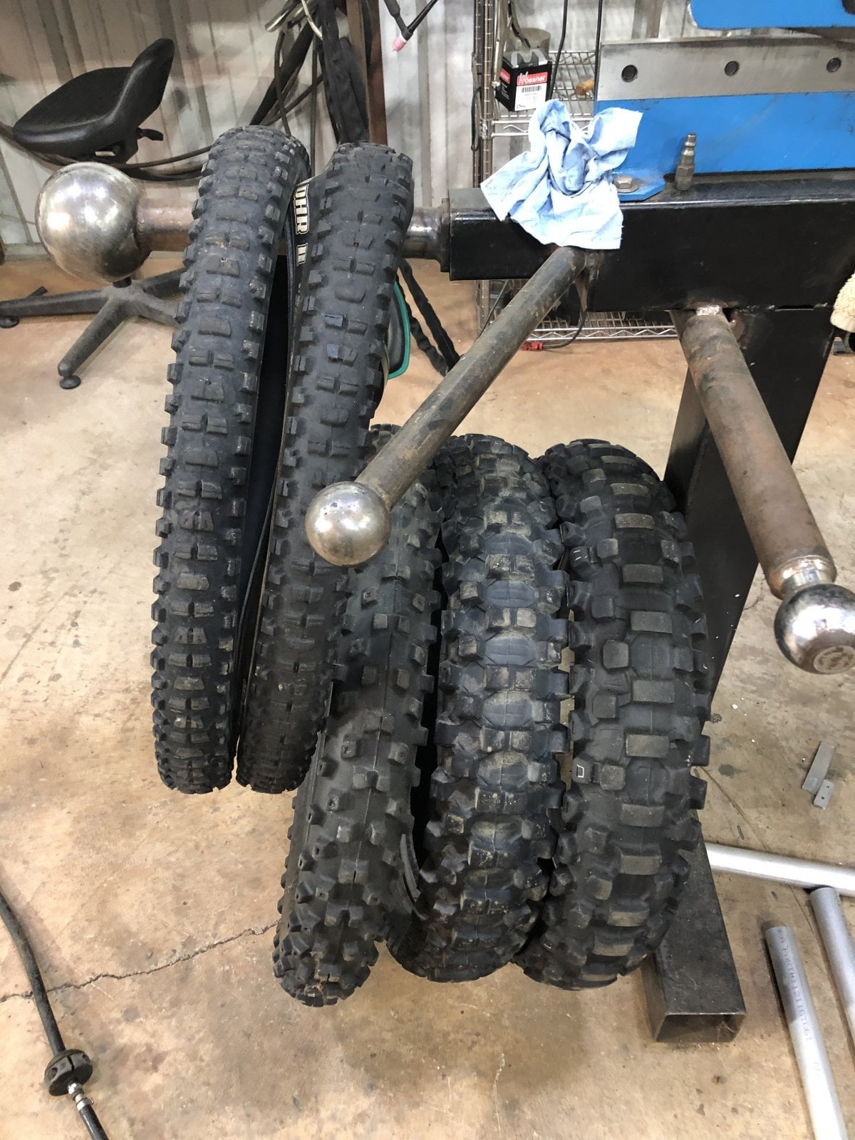

Ski boy i come from motocross, my background is still motocross, in fact i just won the 2 stroke world championships at Glen Helen last month. But i can’t ride my moto bike at less then 16psi or i have a flinstone wheel in one moto!!
I have to replace my moto wheels at 40-60 hrs as they are done.
I take it because as i don’t go around square edge bumps, i glide them. The bike you can’t feel the hit but the rim still takes a pretty good shot. Prehop to unload the bike over them. The bike doesn’t upset and drives through the bump but wheel still doesn’t clear top edge. In moto i am equal opportunity wheel killer, meaning i kill both front and rear. But on mountain bike it’s 15to1 rear to front.
But on mountain bike i roll the tire in turns bad. So i run up to 40psi on flow tracks with big burns.
Flat corners and rough into lower 20’s.
I attached a couple pics you can see i attack corners. 20t is my two stroke. 29 is my 4 stroke

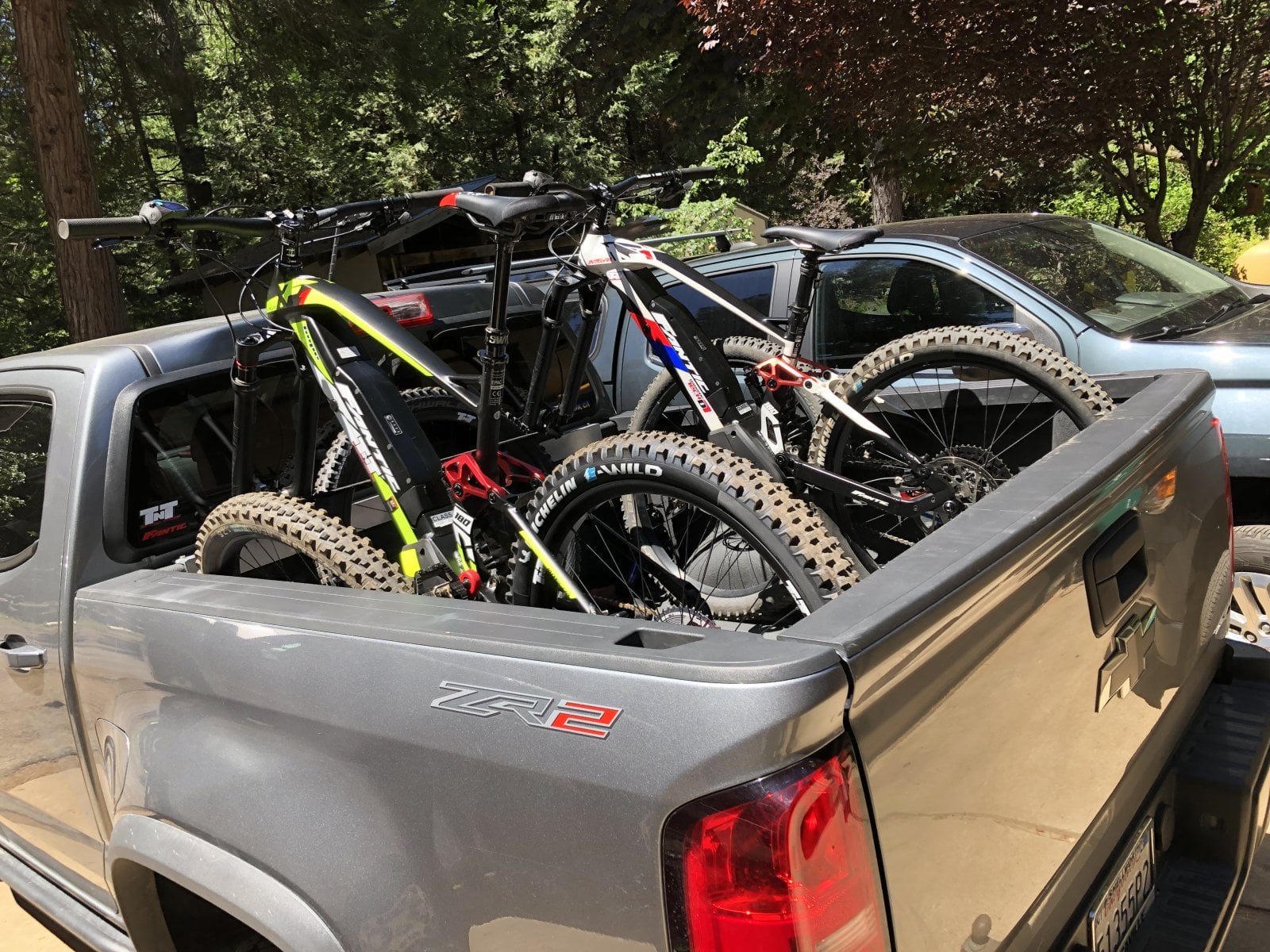

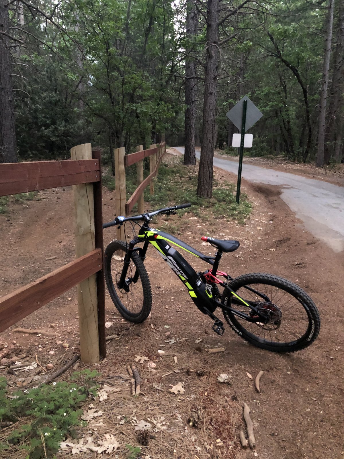

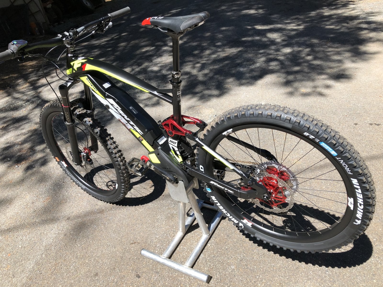

took new ride out today for checkout spin.
Fork valving and shock valving with 2.6 Ewild on 40 with 2.4 Eddie up front.
Even with 38 offset fork I’m not comfortable with Eddie. Still can’t put my finger on why that tire doesn’t let me be comfortable.
But I’m liking that 38 offset the bike is snappy in turns.
Tim29
Jul 10, 2018
421
548
Left the building
So yesterday and today i have concluded my testing.
So here it goes.
The winner is the 2.8 E wild by a tick!!
The 2.6 is faster but not as forgiving and as versatile on all conditions.
In order. 1st-2.8 Ewild 2nd-2.8 Eddie 3rd -2.6 Ewild.
Why??
Ewild is faster then Eddie, has matching grip on everything but round roots off camber chunk climbs, Eddie molds to those types of obstacles and is slightly better at the same air pressure. Eddie has more tire roll in corners and needs to run 2-4psi more to hold as well as Ewild and it then looses that riot hopping agility. Eddie is smoother ride by noticeable margin but it also feels heavy and soggy after coming off Ewild.
If speed has no meaning and ride comfort is all you care about then Eddie might be a better choice.
If your spirited rider and want a grippy tire that’s got some speed then you really should take Ewild as your go to.
Running the front Ewild on the back gives it the root chunk clim traction of Eddie but suffers slightly in hard berms as u can feel little tread roll. But the grip is amazing. But that comes at a sugnificantly faster wearing tire then the rear compound.
Ewild performed flawless without any type of insert and never once flatted with a tube. Case is so solid on Ewild i think it’s a true ebike stiffness and needs no help unless your running carbon wheels and want a little piece of mind.
Going to the front, i went from unsure and hesitant to down right throw it in the lake!! Eddie is a miserable tire up front on , hard pack, dry hard with loose on top, gravel, anything dry and hard exp solid rock it down right SUCKS!! Both 2.4 and 2.6, although i will say the 2.6 on a 34-36 internal is much better then the 2.4 on a 27-34 internal.
So in the 5 days grinding and 3 riders
2 of three say Mary up front with Ewild in rear is best combo ever ridden.
One says Hans Dampf front Eddie rear is his go to favorite.
For me, i say summer dry and hard Hans Dampf 2.6 speed grip on hard dirt with 2.8 Ewild in rear on 35 internal front and 40 internal rear. But the 34 internal rear is pretty good on wet roots and chunky climbs. But i feel the 40 was better all around as you could lower pressure get the root and chunky climbing compliance and it still holds corners well.
2.6 Mary in soft snake skin with 2.6 Ewild hold the records for time on all 5 of the enduro legs. It was consistently the fastest combo but the front tire shows significant wear in just a few miles. Hans speed grip still looks virtually new and was really close in time and comfort.
Blue groove hard pack wet base and flow tracks i think Hans will be the fastest but can’t prove it just my gut telling me.
For baked out summer dirt left I’m stayin with Hans 2.6x29 speed grip on 29x36.5 rim up front and Ewild 2.8x27.5 on a 42 on rear.
Come mammoth kitty little will prob go back to Mary 2.6 front and Eddie rear as the dirt is deep and soft or chunky.
But for my race in Sierra summit it’s gonna be 2.6 Mary and 2.6 Ewild on 35 and 40 rims

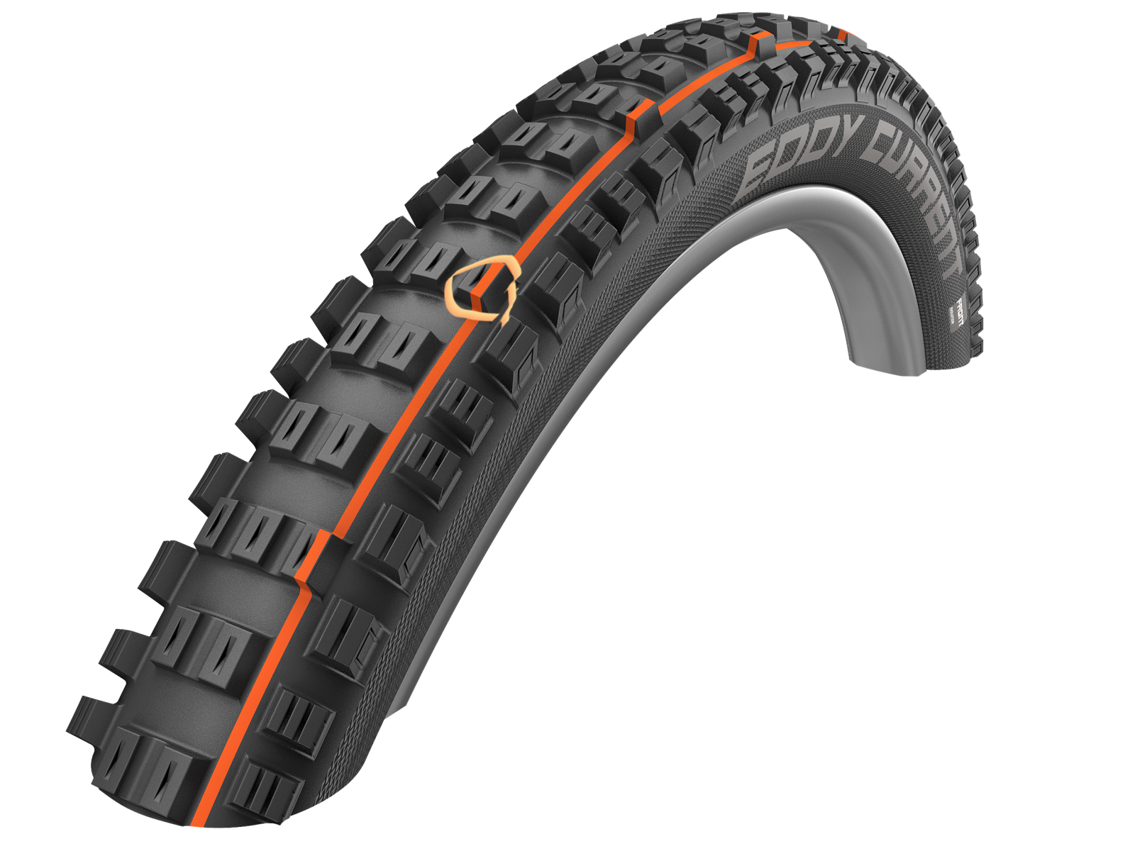

The intermediate knobs on those eddies give me pause. Reminds me of the bad things the kendal nevegsl suffered from. I think a nice channel seperating the center pattern knobs from the side edging knobs is key, especially for the front. With those intermediate knobs, when you go to roll the tire over on to the side knobs it can just skate past the edge knobs rather than have a definitive transition from center knobs to , bam!, your locked in on the edging knobs. If you're so inclined you may want to snip the outside half of the all the intermediates on both sides and try that.

Nope,
I’m just gonna stay away from that tire, there to many options available that mount right up and shred!

2.8 DHR2 on 32 alum Died
2.8 DHR2 on 40 alum Died
Both the DHR2 evo vase tires tore on edge of rim as the rubber ripped from the threading and wouldn’t seal one cut through on rim edge.
DHR2 evo case failed as a suitable ebike tire and that’s the oem tire to the bike.

Race bike finished, the combo I’m going with for this weekend.
Mary 2.6 up front and 2.8 Ewild front soft compound in rear.
My practice bike has 2.6 Hans up front and 2.6 Ewild in rear.
Spares are Eddie current 2.8 rear and soft compound Hans 2.6 for front
Practice bike has 29x35 front rim and 27x5x 40 rear
Race is 29x36.5 front and 27.5x43 rear
