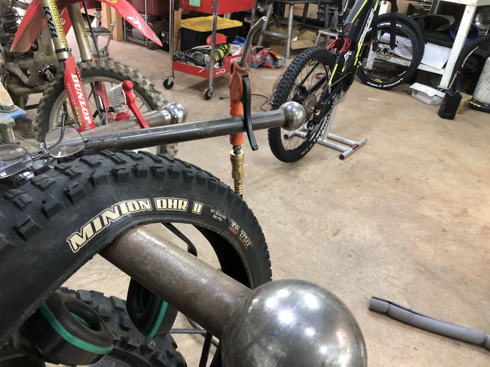

I just did a little check out ride on the. Ewild 2.8 mounted on a 32 internal alum wheel with no core and a tube.
Started at 30psi and the tire to harsh for play ride and lacks little grip on pitchy climbs and loos over hard.
So dropped pressure to 26 and traction came in nice. Speed still really good, but i feel to much tire squirm. Remounting onto 34 internal

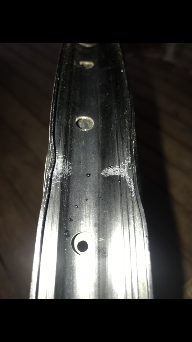

Epic fail today i tried a new line in the water fall and came up short doubling down a chunk section.
Tire survived but wheel didn’t.
So i have to give the casing an A+ rating.
Oops!! Flat ran out of talent.

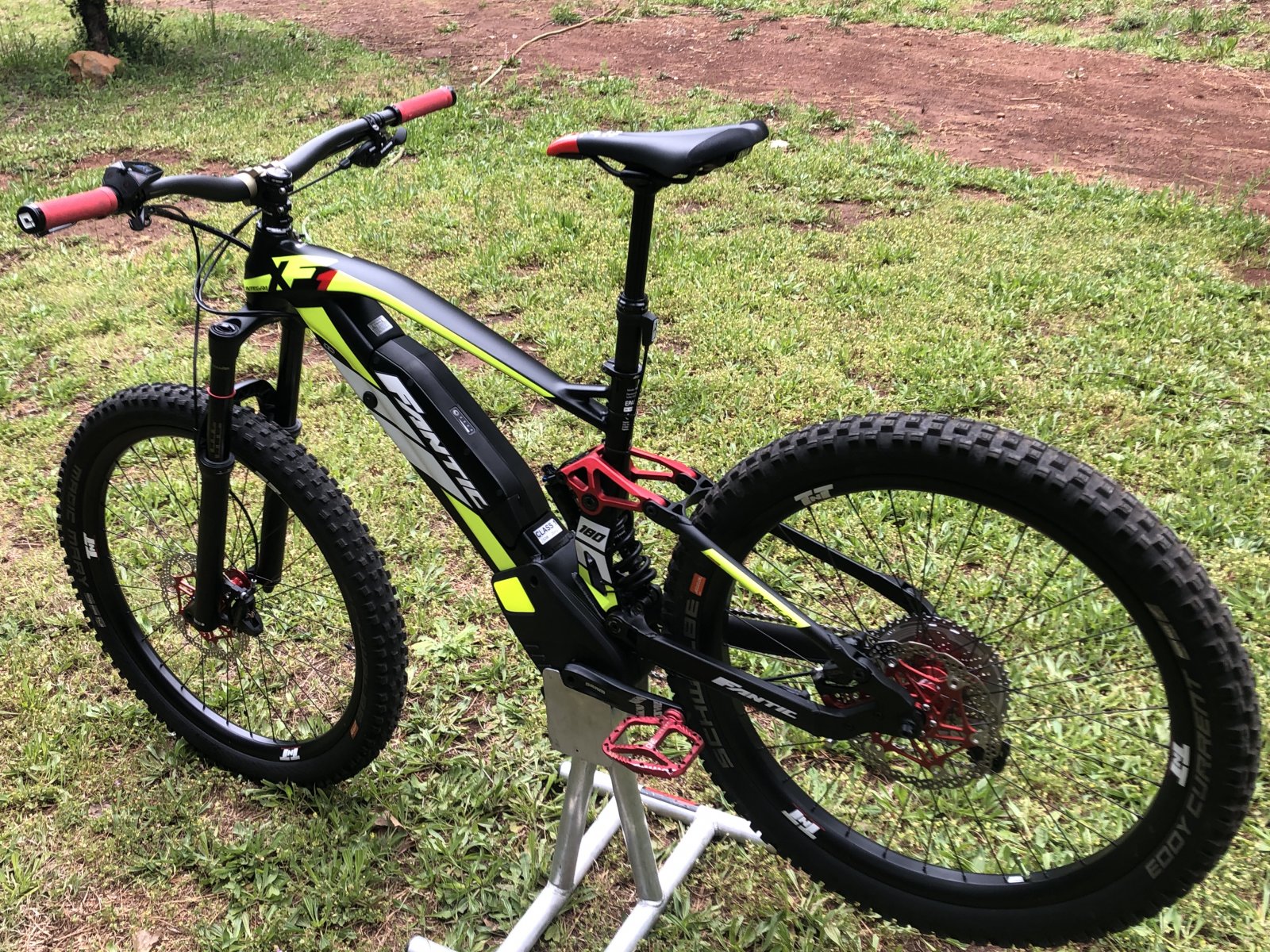

Went 30+ miles today on the 27.5x2.6 Ewild on fire roads, loose on hard, golf ball size rock on loose road, soft Loose, boondockin in thorny bushes and sticks, really loose dry dirt.
I have to say the Ewild is impressive in some areas and it’s really growing on me. My riding partner flatted in the thorns 3 times with her borntrager tires.
Puncture resistance A+
Loose dirt traction A
Loose on hard. C+ to B-
Loose rock on hard surface B-
High speed on hard pack B+
Climbing traction c
Braking traction D
Out of all the rims. 38-40 internal i felt the tire was most predictable.
With the 40 you can run lower air pressure and it holds well in turns and molds to rocks and roots on climbs pretty good.
I say the 2.8 Eddie is like an SUV. it does everything well and super predictable but rolls really slow and lacks life. It molds to the ground regardless of the surface and just grips.
The Ewild is more like a sports car, it’s fast and the casing i think is the perfect combo for aggressive and cruiser type riders, it’s crazy how fast the tire is.
My only real complaint is several times on loose dirt with hard base i came into corners really hot with the intent to pitch it out and once you really pitch it the tire struggles to regain grip on some dirts.
The predictability is decent it hasn’t given me a oh Sh&$t moment.
It’s a good match on the rear with a soft magic Mary 29x2.6 front.
I’m def gonna use this tire in ebike enduro next week as i can’t ignore the speed of the tire and the toughness of the casing.
Just might be the perfect tire case.
For comparison. I say it’s really close to climbing and breaking traction of a high roller 2, case is more lively and hold better then a max DD case but yet has compliance on small chunk and chatter of a EVO case.
I’m taking it off to save it for the races.

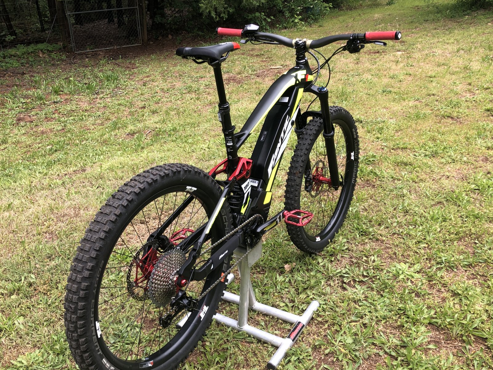

Sorry for the delay, i had sold my 180 and my new bike was delayed.
So started over with a med 2018 180 with 51 offset forks.
Yesterday i rode 26 miles on 2.8 on 34 internal wheel with a tube at 23psi
The dirt was a combo that just about covered everything. Loose over hard, hero dirt, mud, rock, wet granite, wet roots, stumps, pine needles, oak leaves
The 2.8 likes the narrower wheel then schwalbe. I find it feels really well balanced on 34 wheel. Had a little better feel and it breaks traction little more predictably.
I found 23psi was enough support to hold up to race pace speeds and i didn’t have any moments i thought a chunk edge would flat. I have to give this tire the perfect casing award.
Tire little lacking in braking traction on loose or really wet dirt.
Not terrible in mud,, i rate it equal in mud to DHR2, corner traction is really good, climbing in heavy pine needles and wet roots it was really predictable and held its own.
I think i give this tire a slightly better overal rating then the Eddie 2.8 for these reasons.
The tire case is outstanding, speed is good, traction is predictable and solid.
In super chunky and wet it’s not as good as Eddie, but where this tire lacks in Traction the playfulness and robust case and the tires speed it’s a good trade off.
