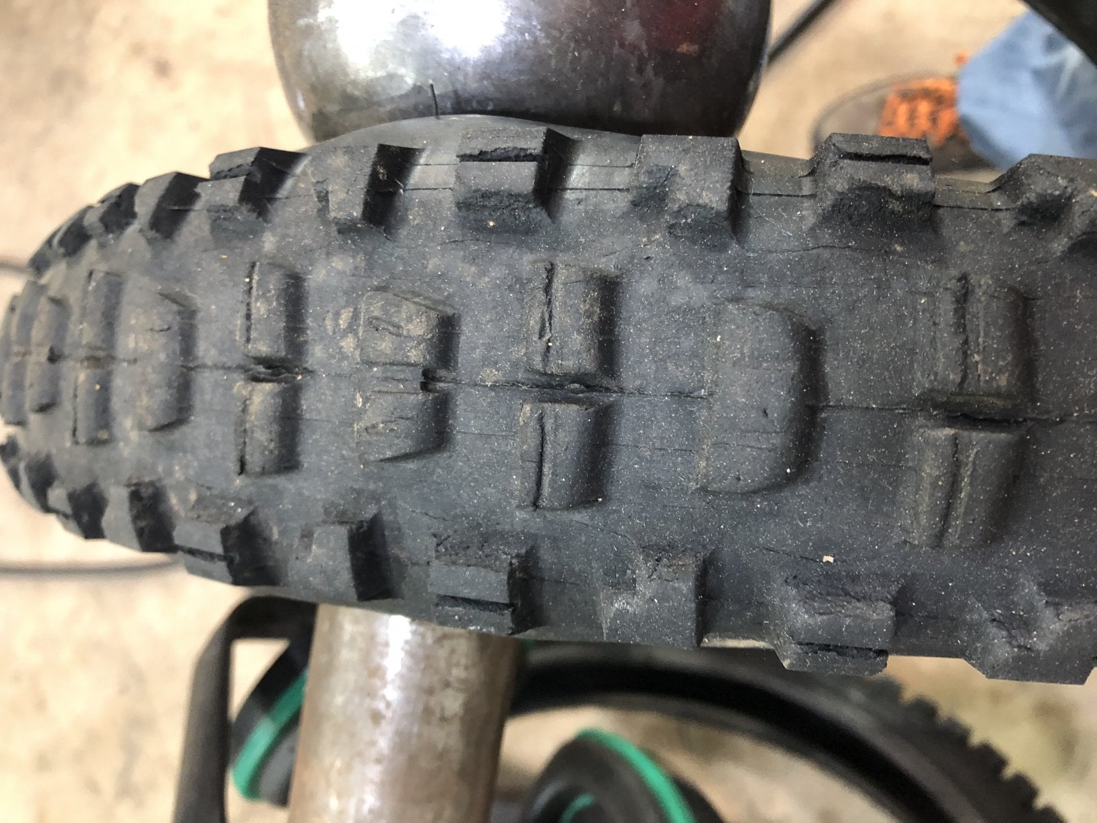

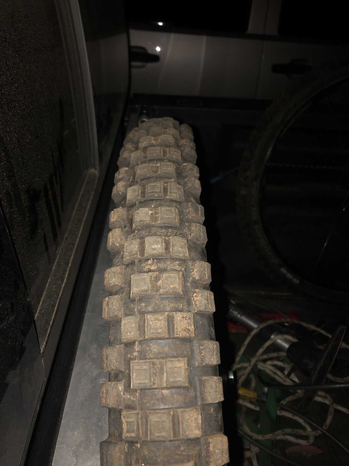

Here a pic of an Eddie with 422 miles on it and it’s a soft compound tire.
And a pic of a DHR2 with 213 miles, same trails, same bike, same dry conditions.
The Eddie has considerably more climbing traction and braking traction
So you understand my riding, I’m a antie skidded, if you ride my bike and skid my tires i go postal on you. Tires to me are life blood of the bike and they need to be sharp and grippy.
As you can see from the pic the DHR2 IS TOTALLY TRASHED.
Eddie looks like it still has 80% life left and it’s already gone double the distance.
That’s what ebike specific parts have to offer if there truly ebike designed.
