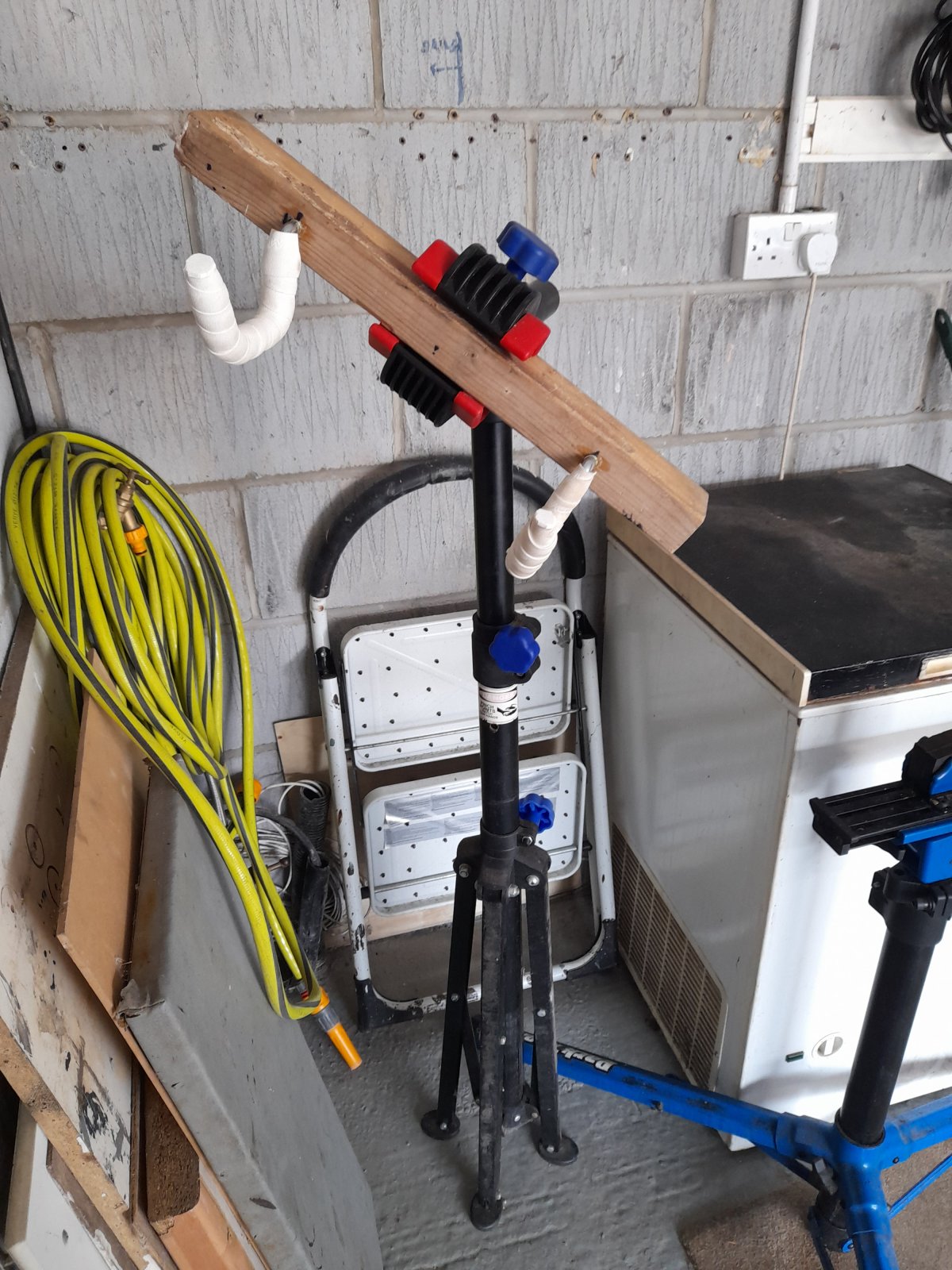

The Whyte frame design does not lend itself to using a normal bike stand with the clamp on the top tube. There is of course the option to use the seat post but I reckon an EMTB is far too front heavy to make that wise. My wife has a Cube Access and that too is difficult to use the top tube for clamping. For most maintenance I use the Park Tool platform stand but today I did a simple DIY hack on the standard bike stand using stuff I had in the garage...so zero cost. It is just a length of timber with heavy duty ladder rack brackets which I cut and bent to the required shape and covered in road handlebar tape.....then screwed them into the timber 28cms apart. I know some guys have done something similar using an old set of drop handlebars. The problem is most drop handlebars are c 42cm total width which is too wide, so you need drop handlebars for a kids bike and that is not too easy to find. My hack was free and both my Whyte bikes and my wifes Cube can now be used with the ordinary stand.

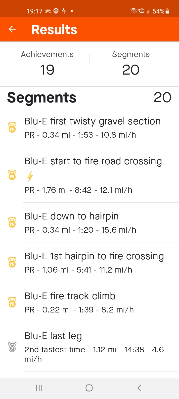

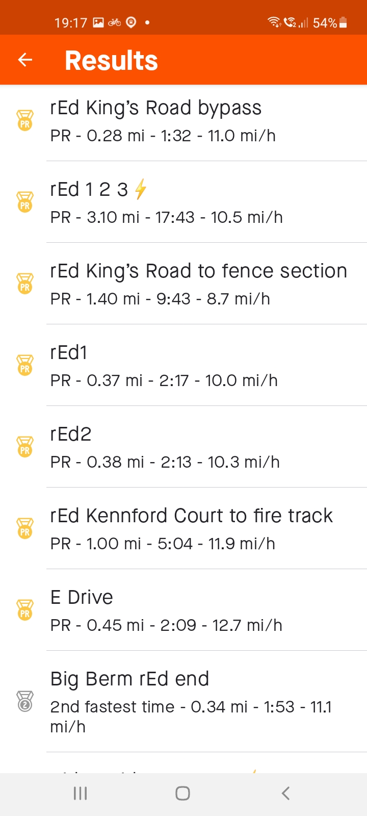

I rode the Blue ,red, and black trails at Haldon Forest yesterday. Results below. My previous runs on these trails were on a Levo and the E180RS. ( My first time on the Black because it only recently reopened). The bike is fast. You never feel a passenger on this bike....
