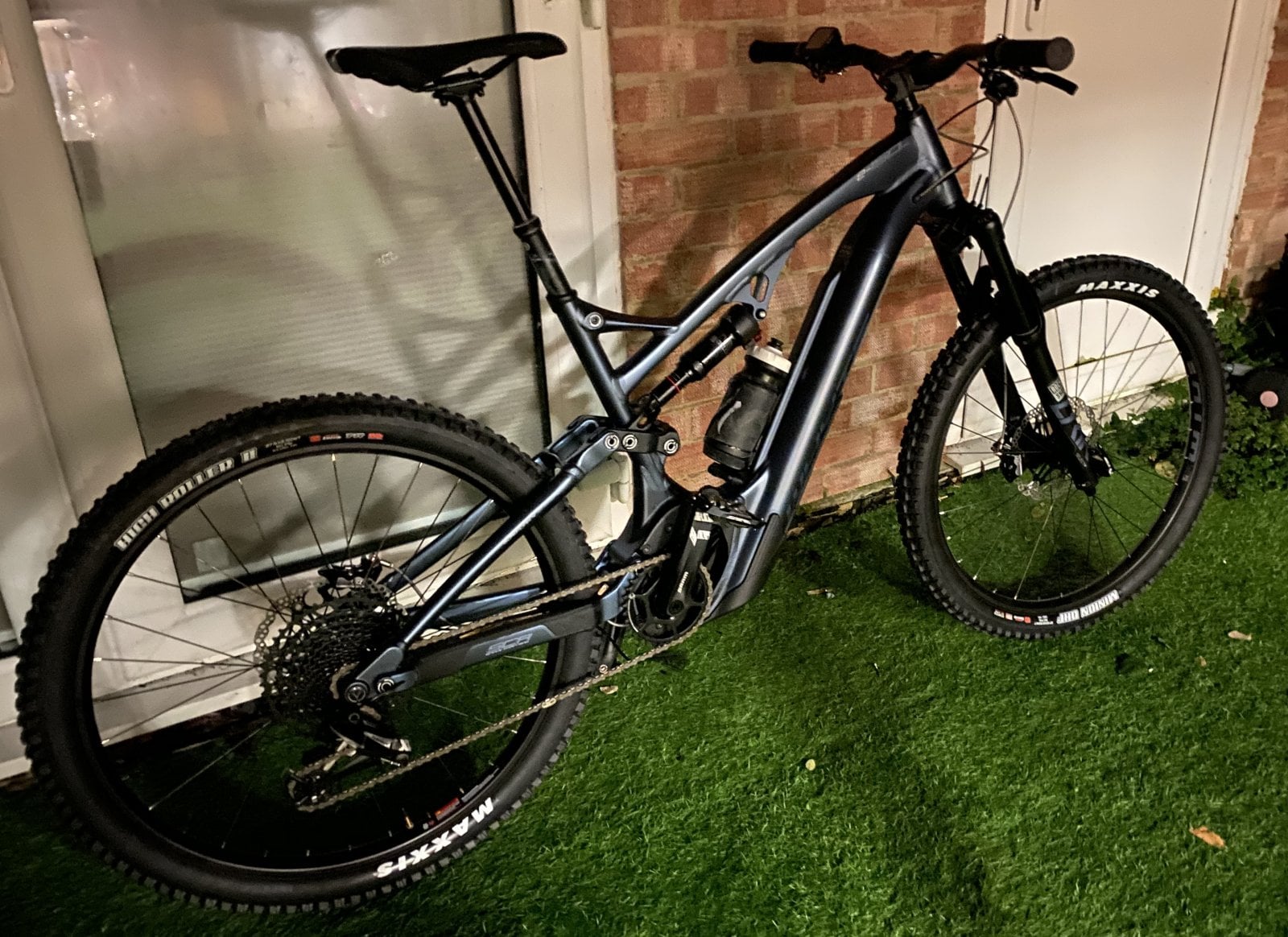

Just had the first service, the rerouting of the cables and a brake bleed. All fine and looks better with the recabling. Great service as ever from Pedals in Ferndown!

can you post a pic of the routing?
Ready for my first ride tomorrow. Upped the forks to 160mm travel, full invisiframe kit and fitted hope v4 front and back. Can’t wait to get out on it.

I cannot get on with the SRAM brake levers, I need something with Biting Point adjustablility.
Why did you change to Hope?

That’s my only gripe. The brakes are not as good as ones I have had previously.

I've moved the brakes inboard a bit, and had to move the dropper bracket outside of the back brake, and it feels much better, so I'll stick with the SRAMs.

I’ve never really got on with SRAM brakes. Hopes you can adjust to exactly how you want them and I find the modulation on them is brilliant.
