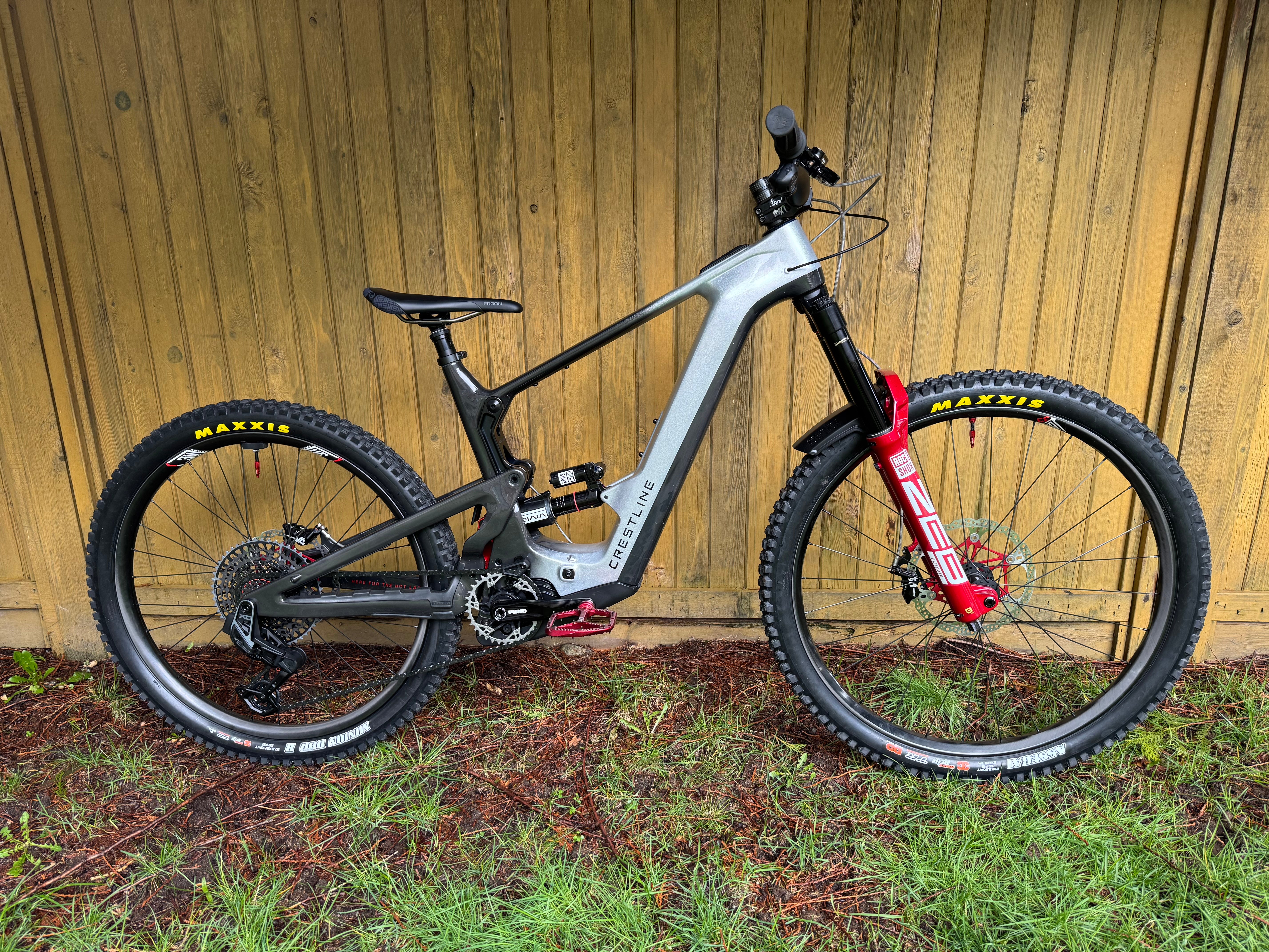

51 lbs coil front and rear with pedals. Rh2 mx 600w
Good work from Crestline! More manufactuers should take note

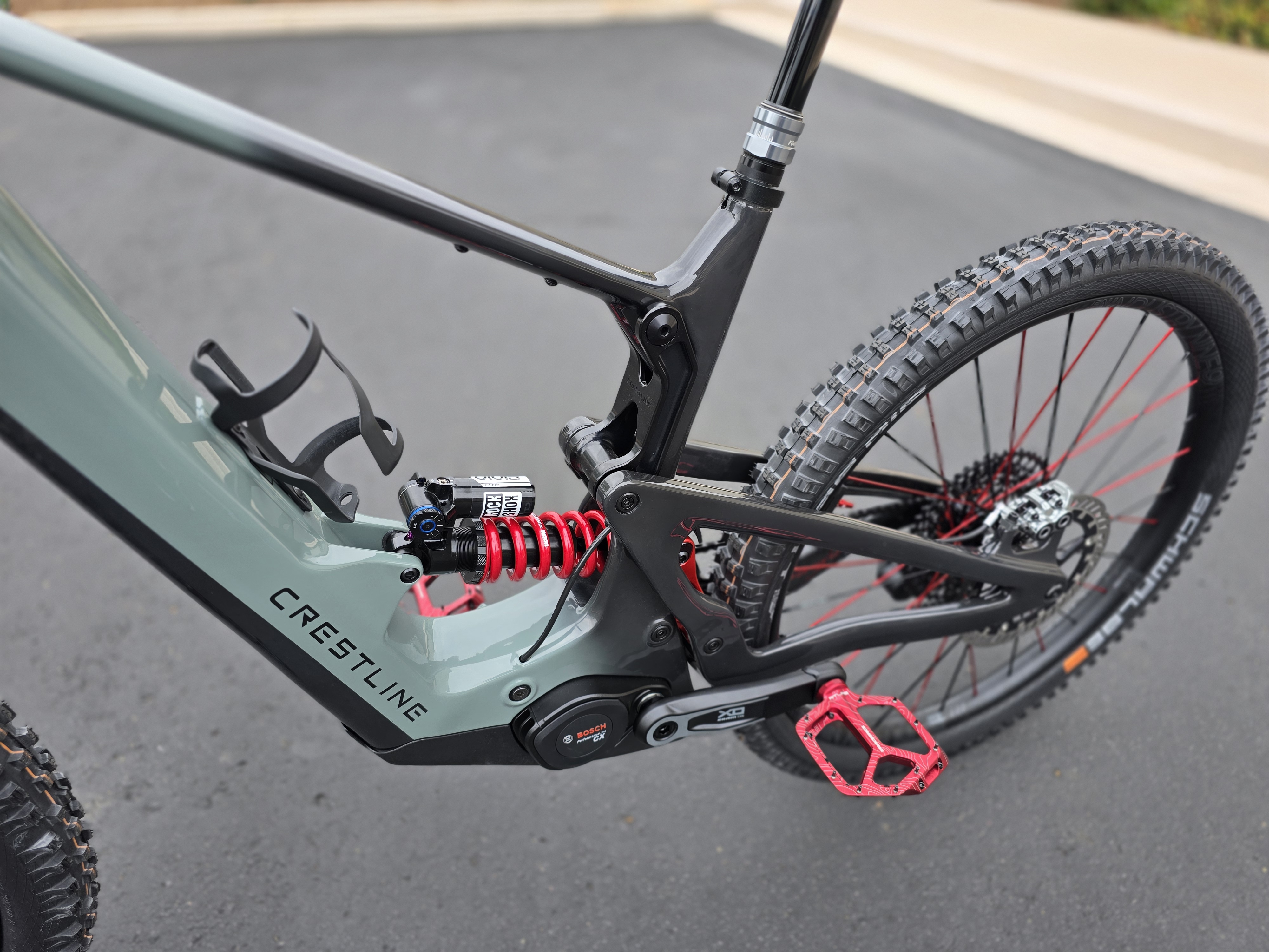

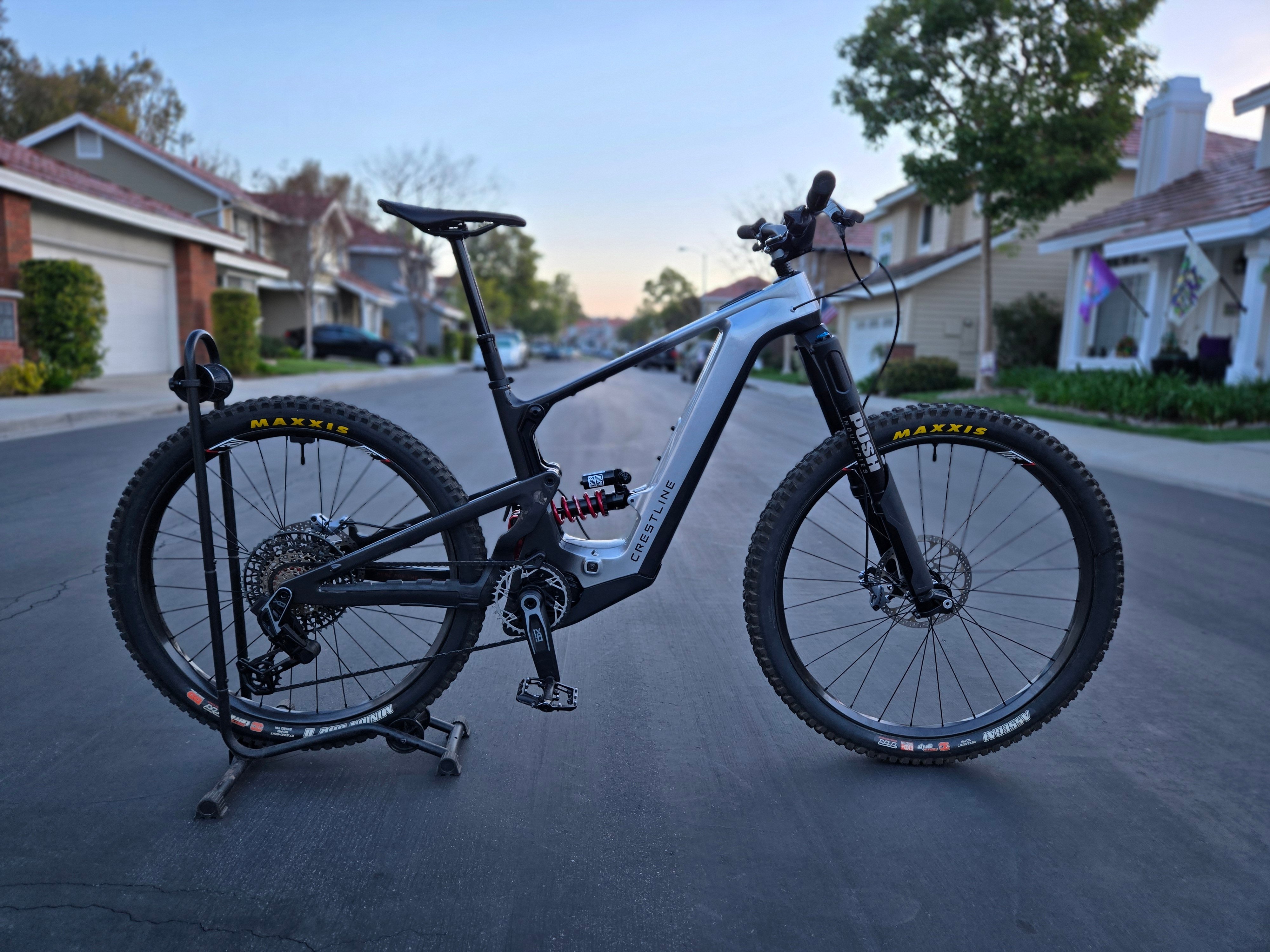

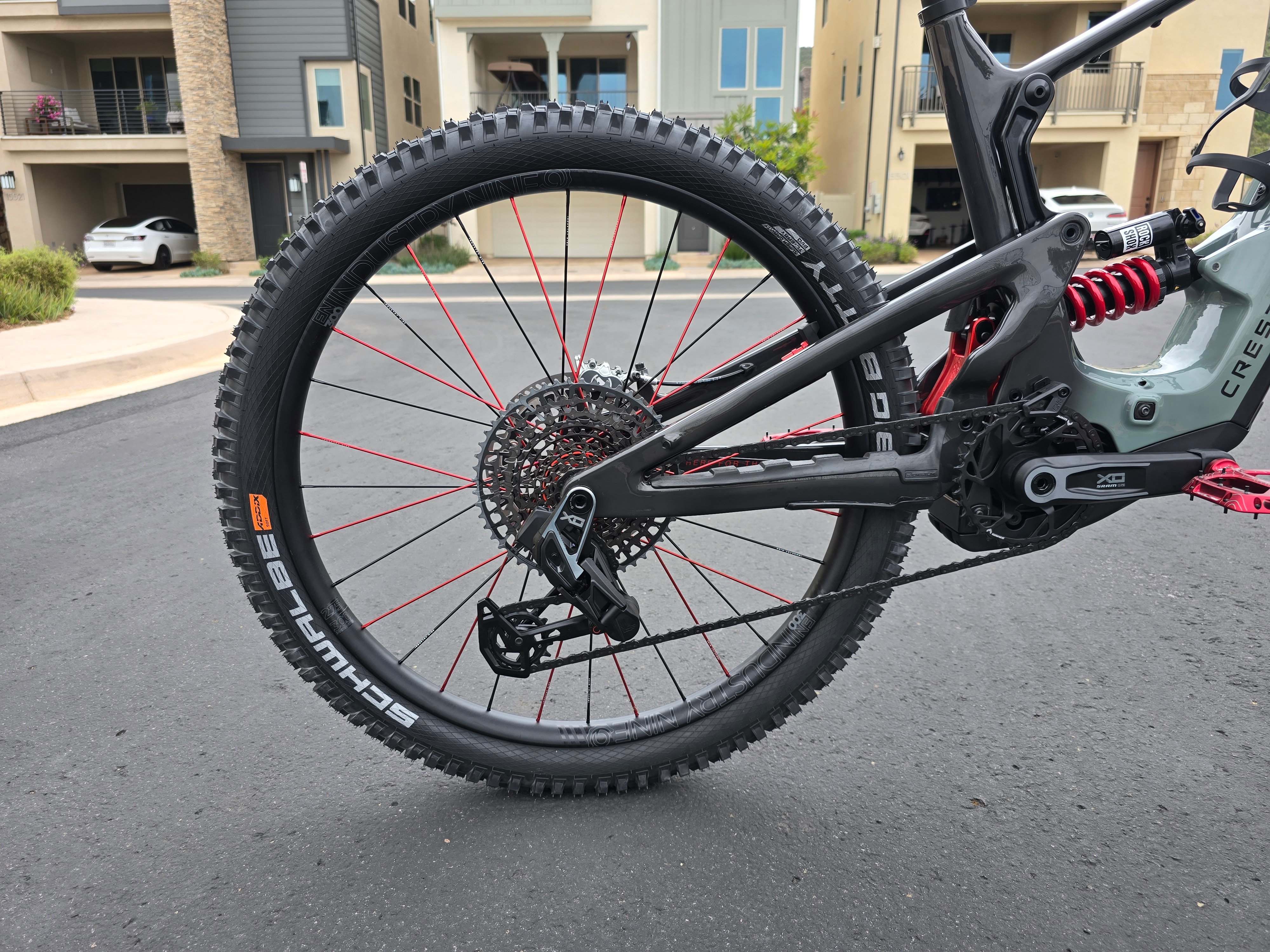

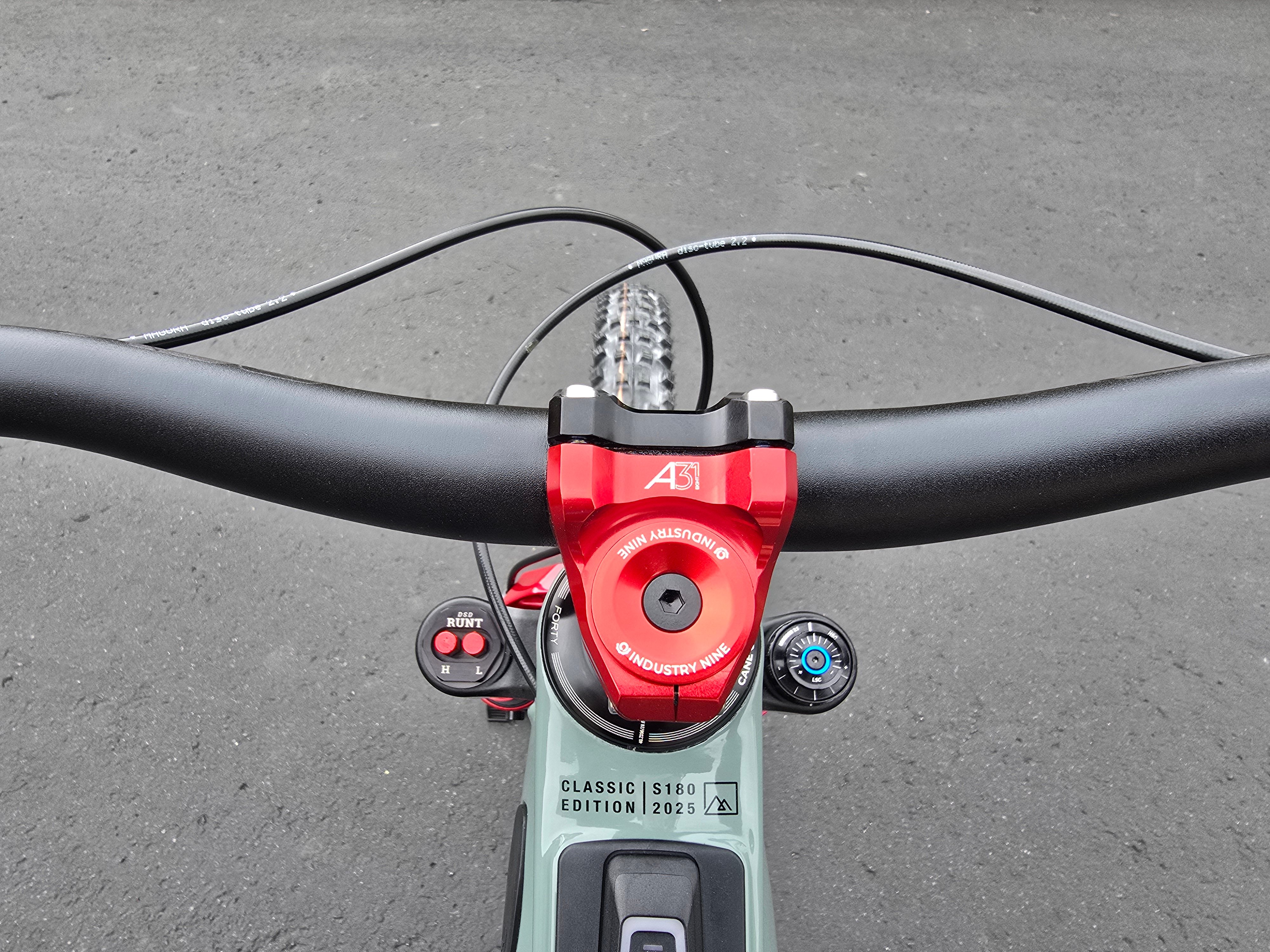

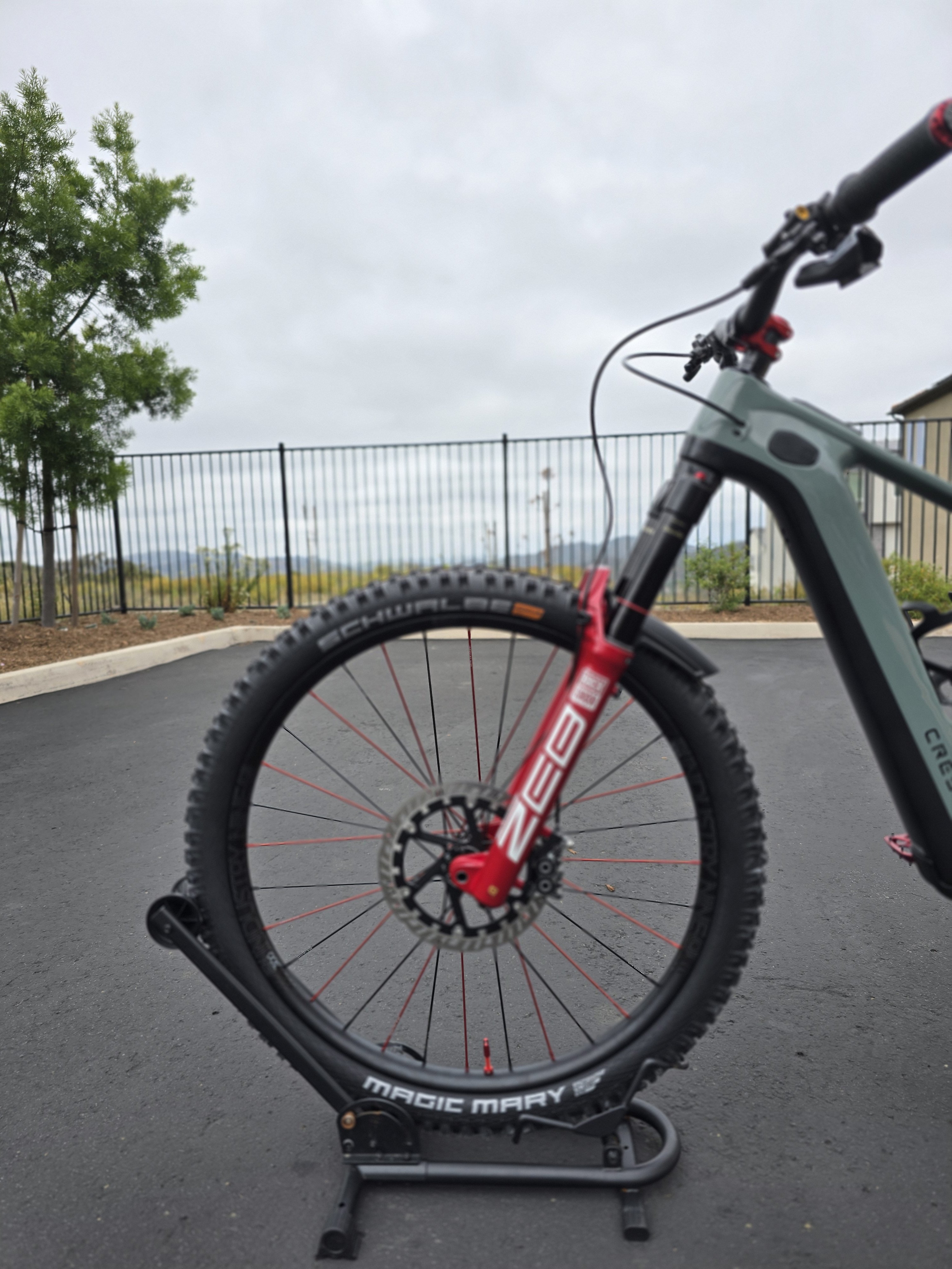

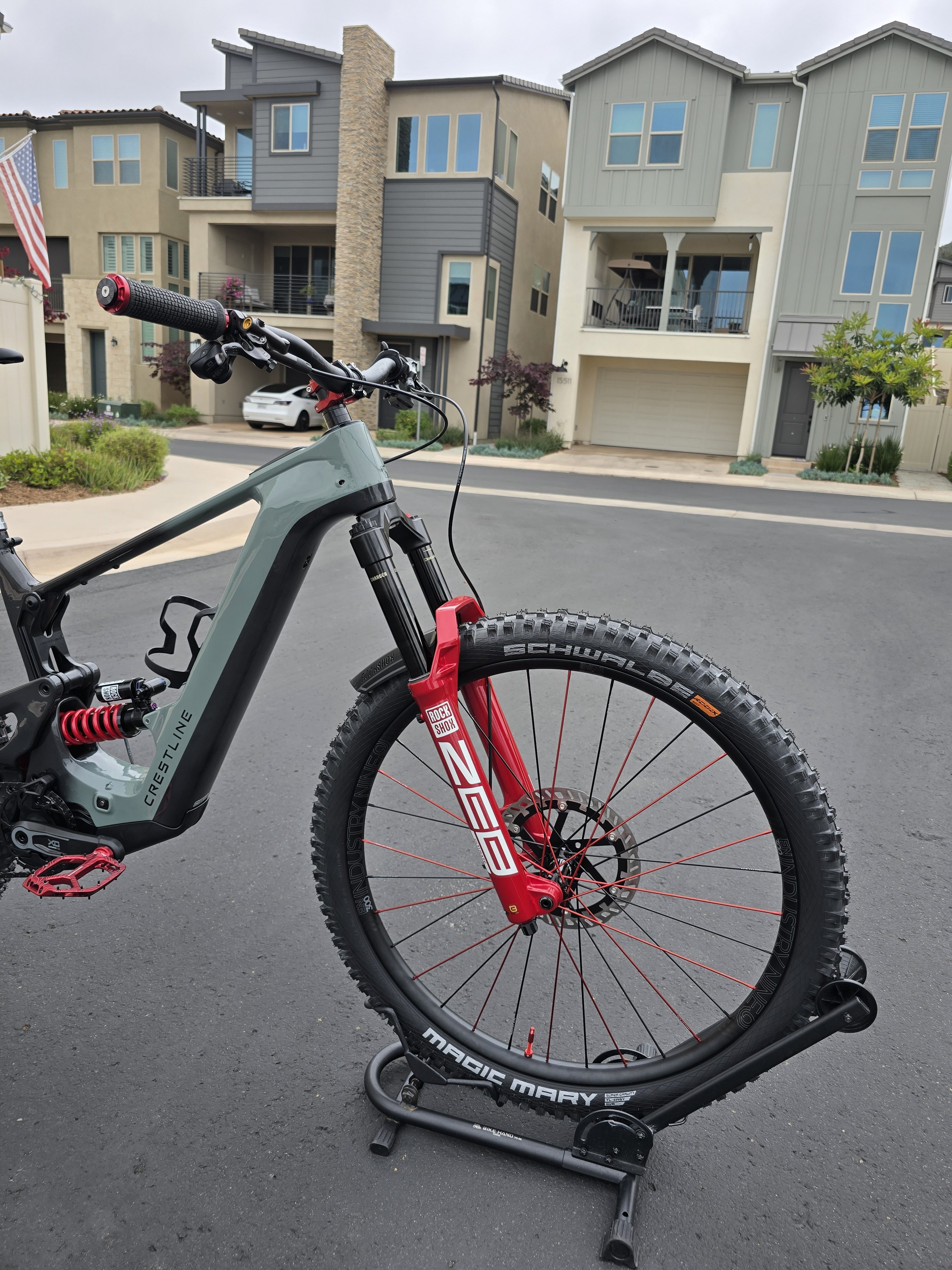

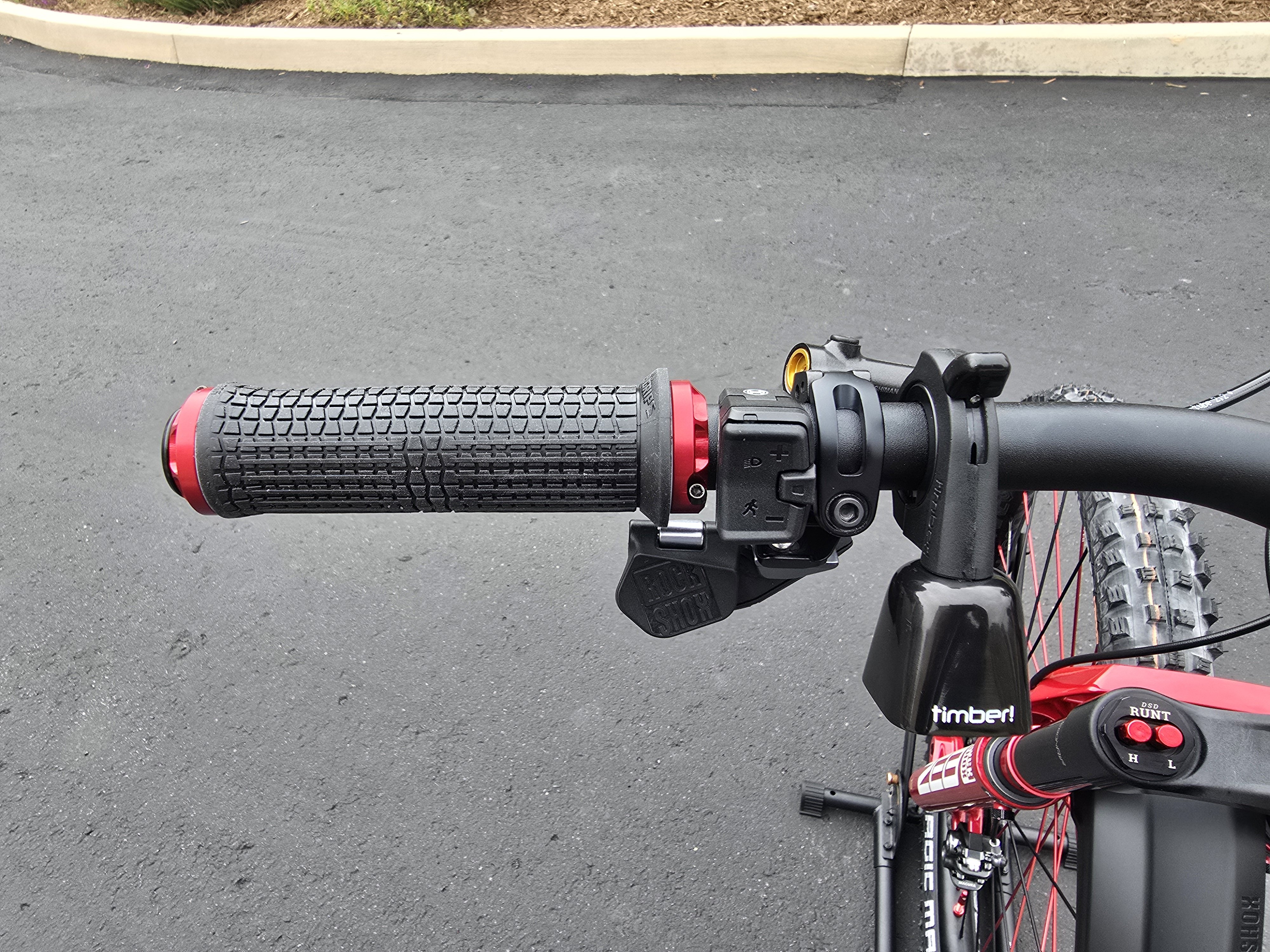

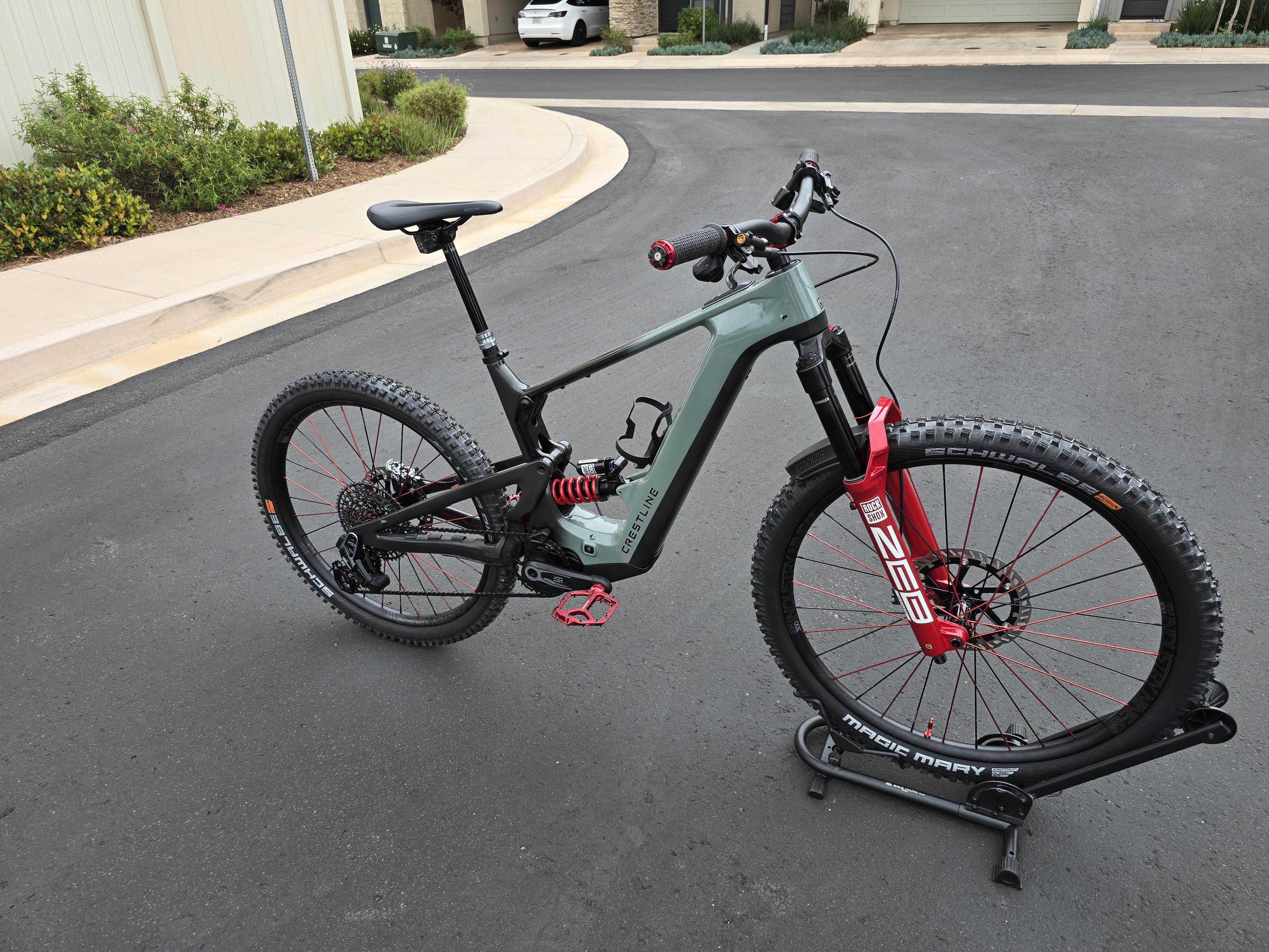

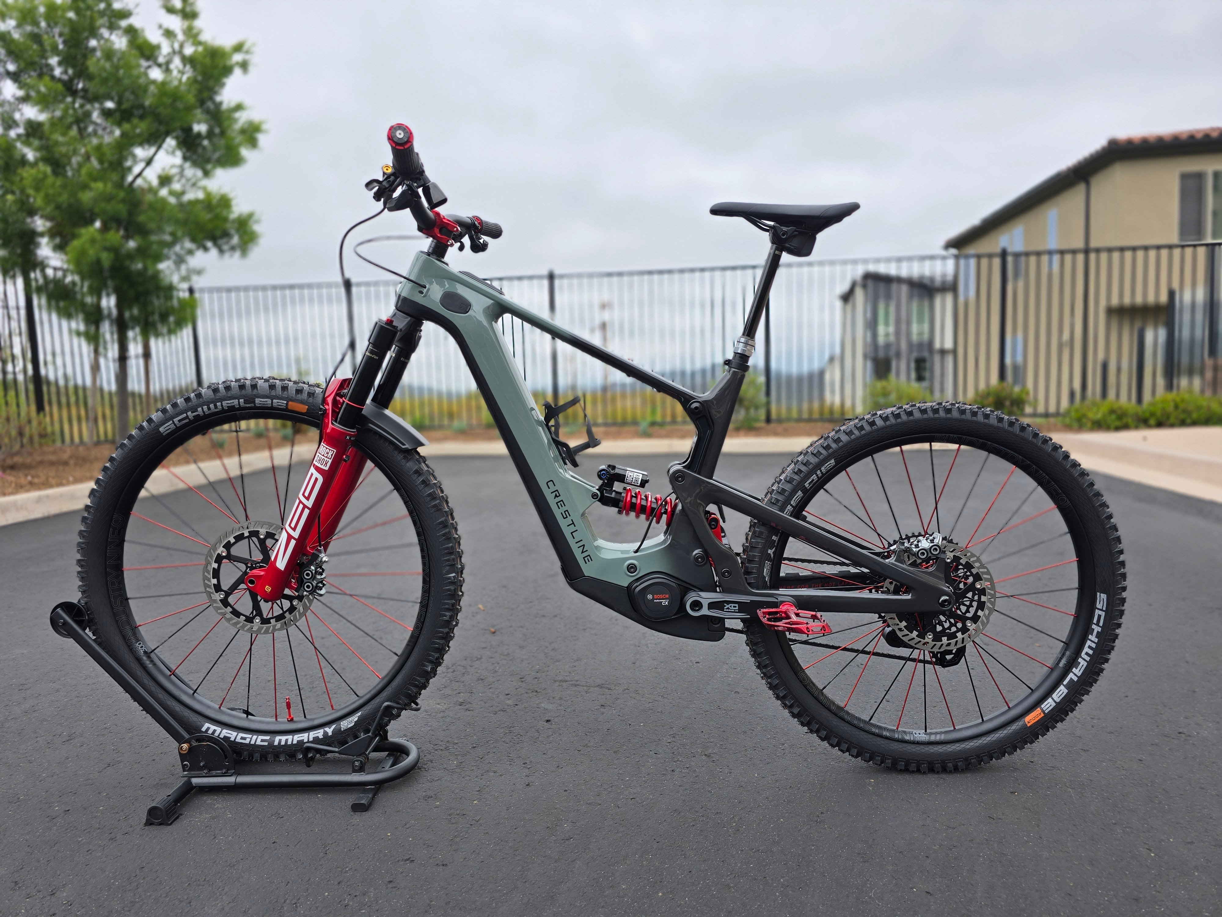

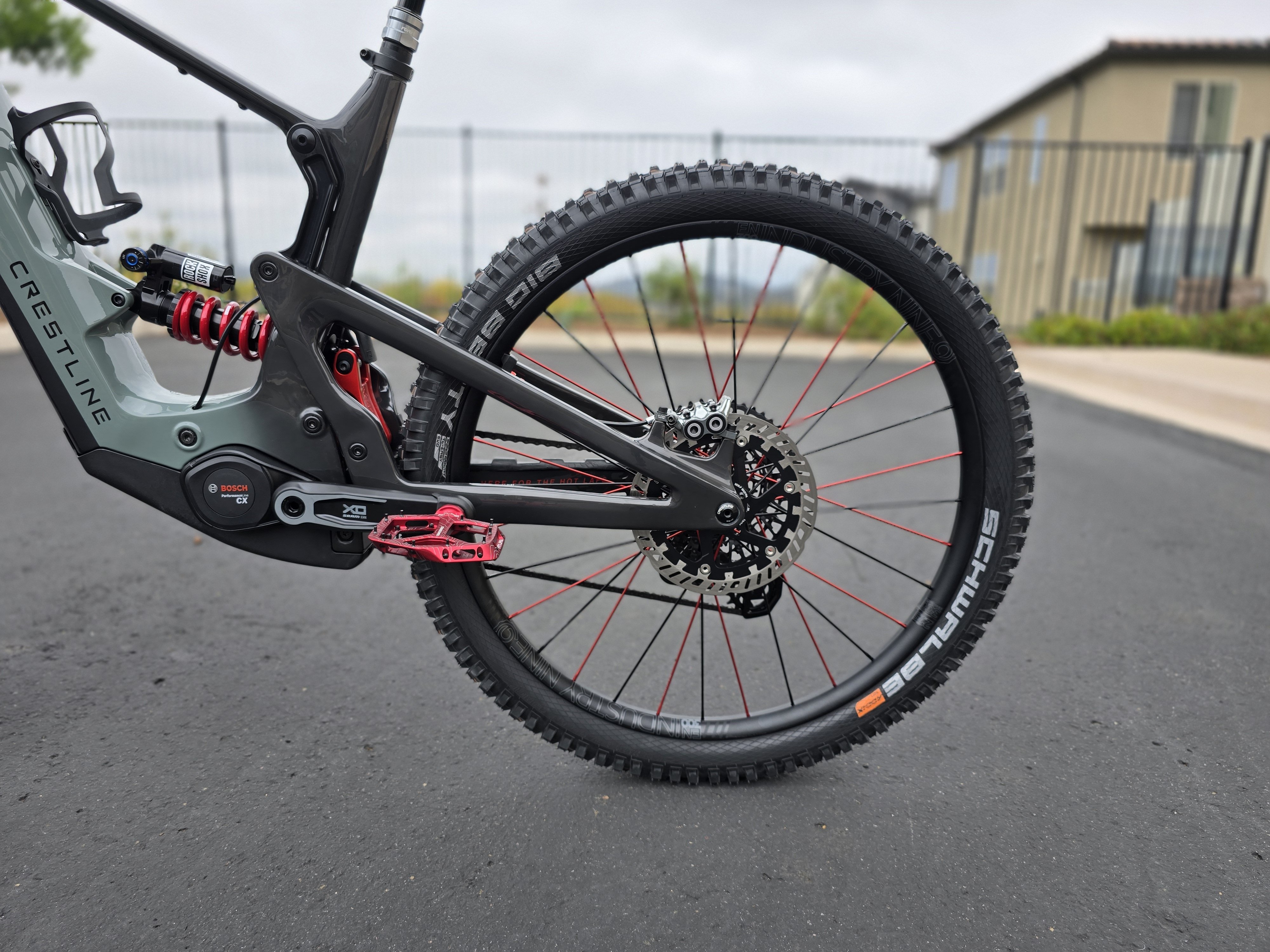

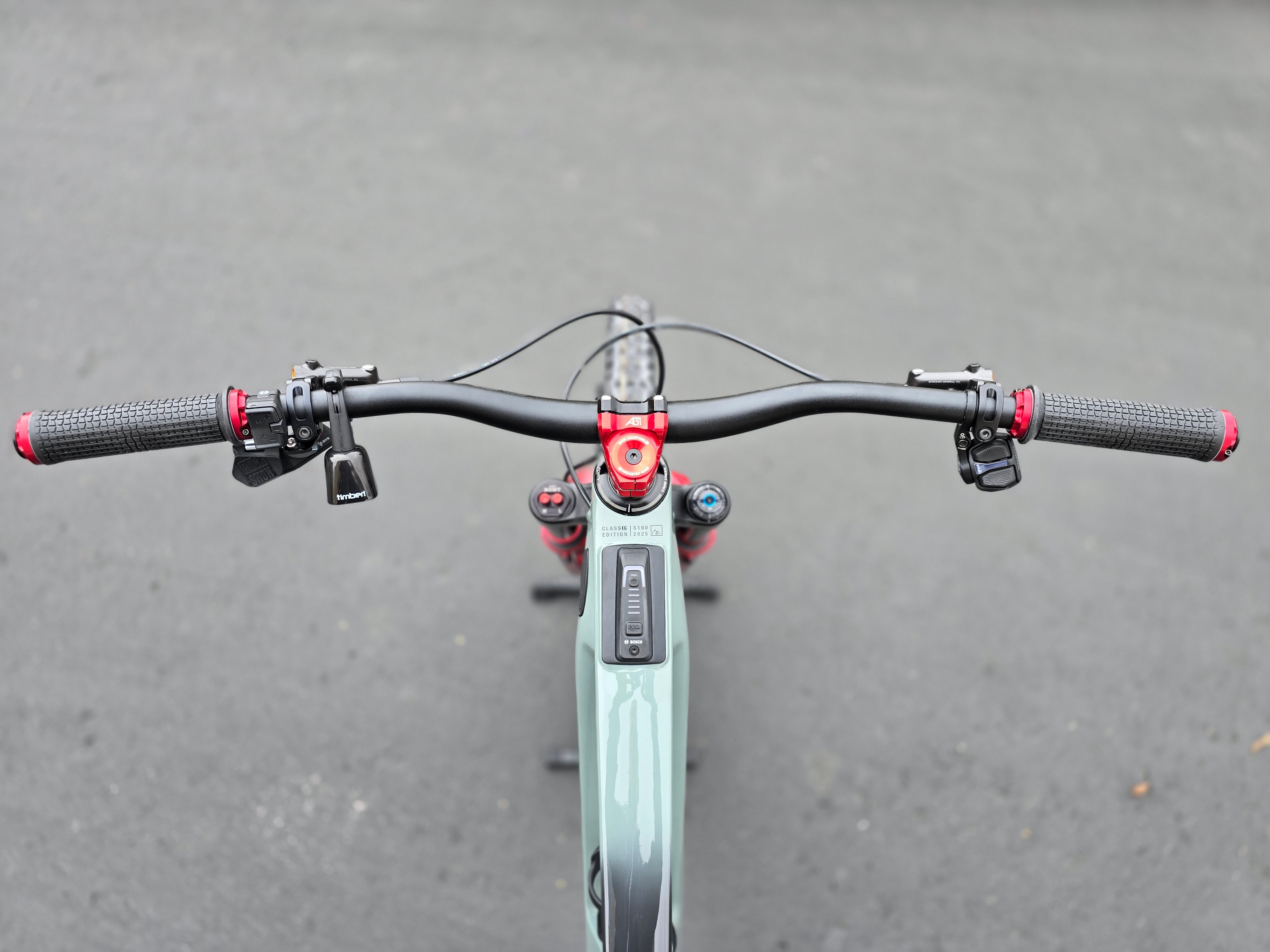

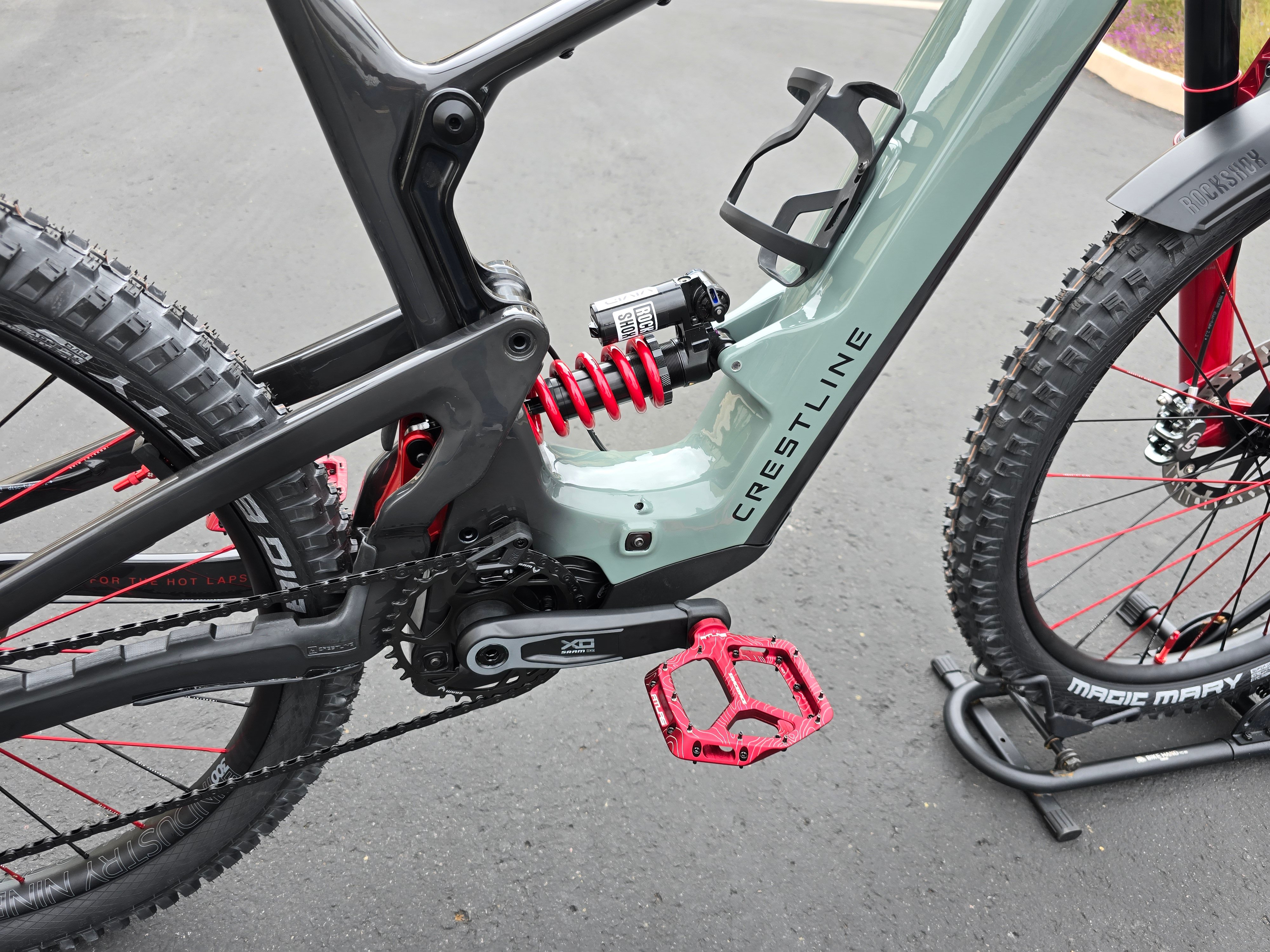

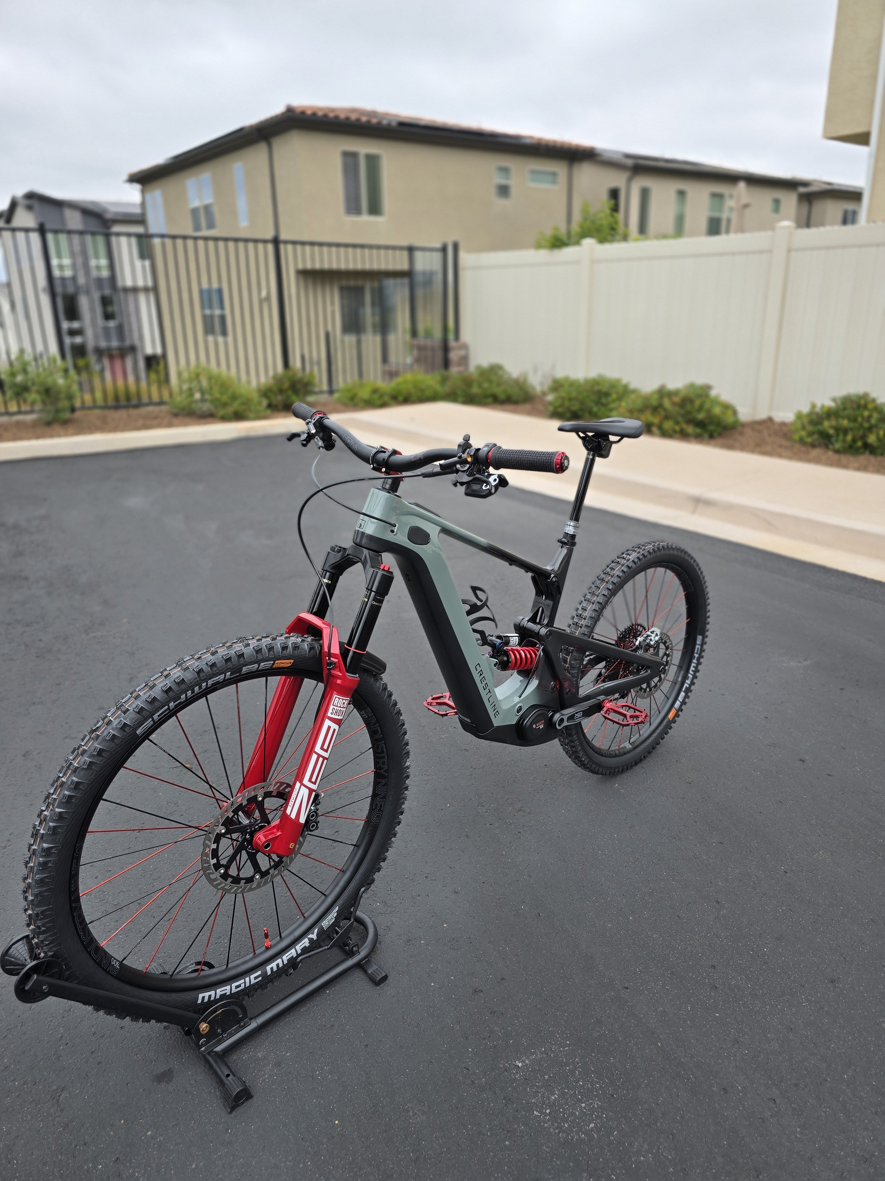

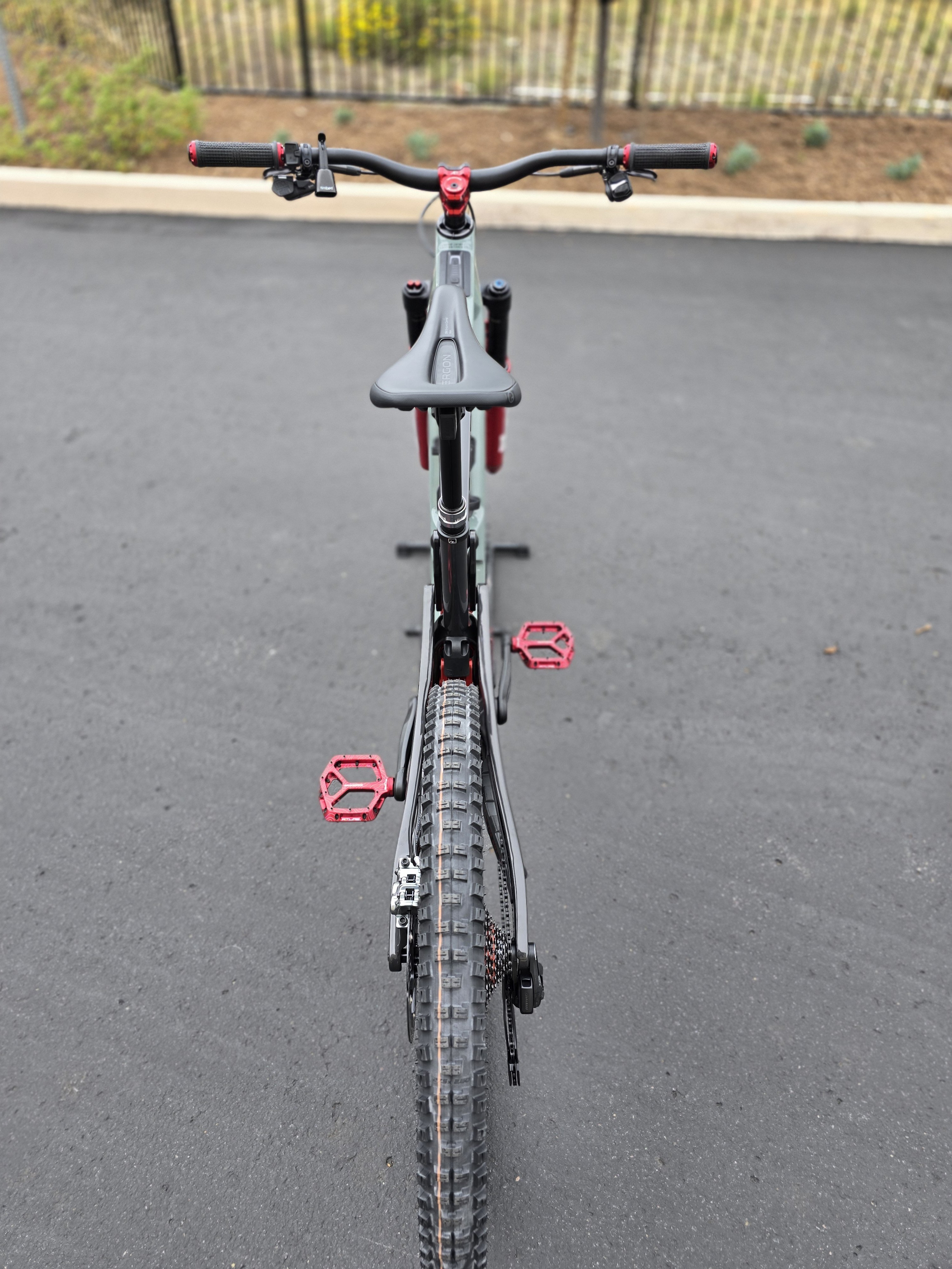

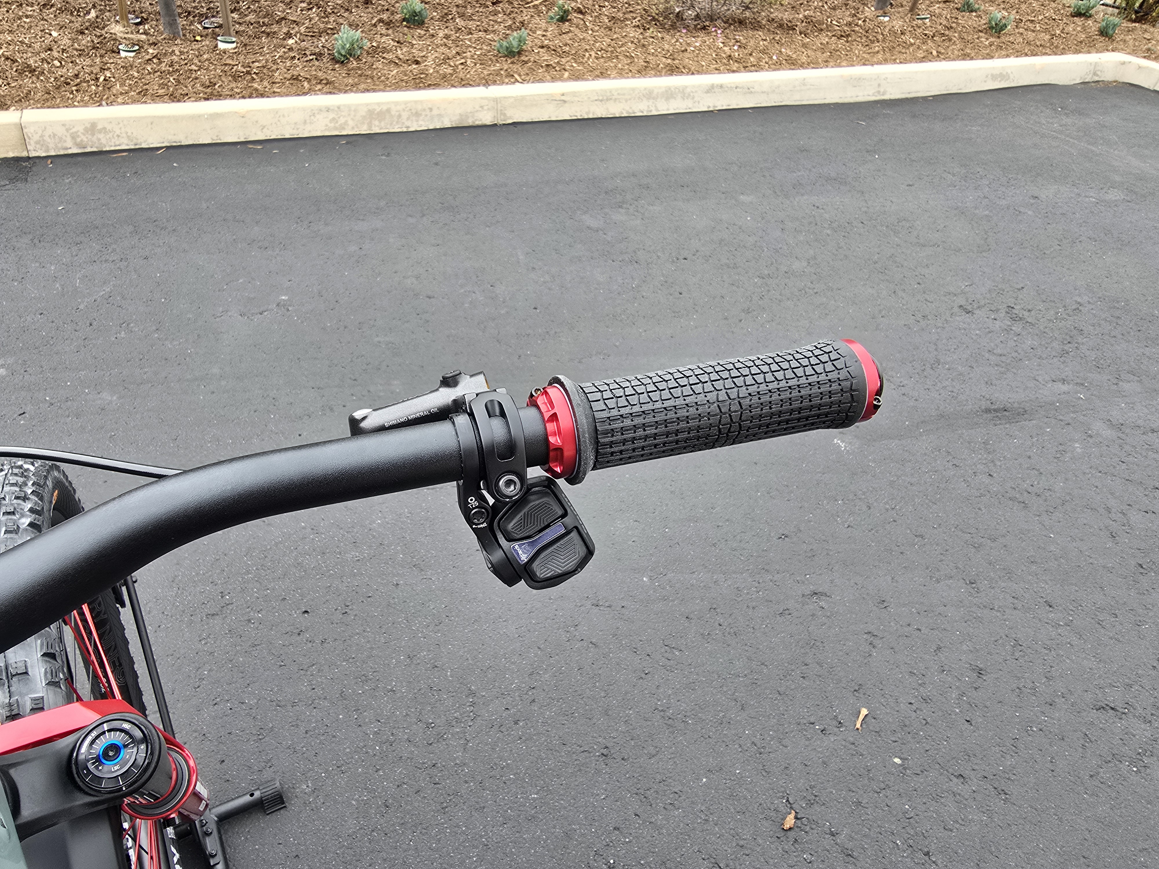

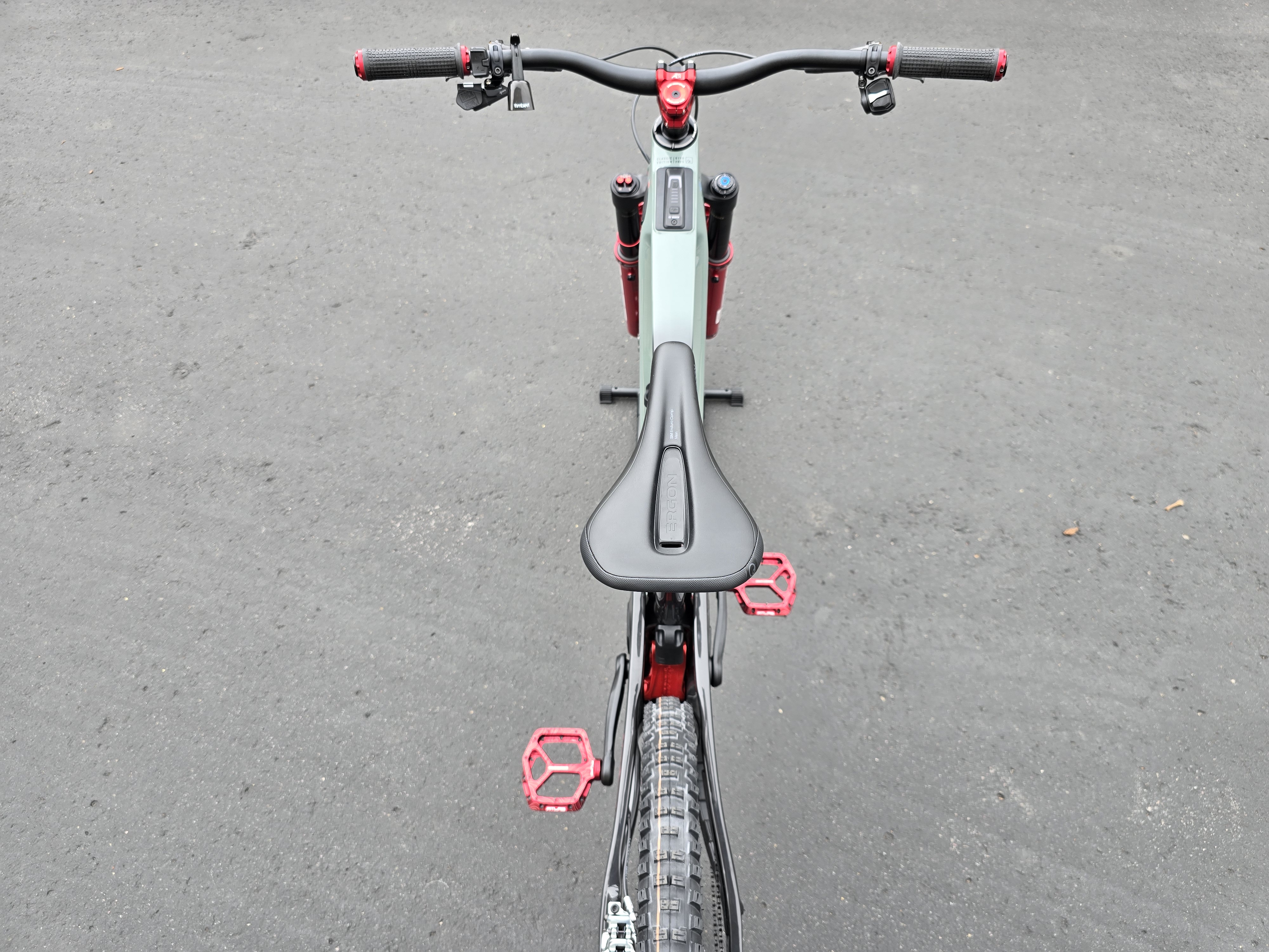

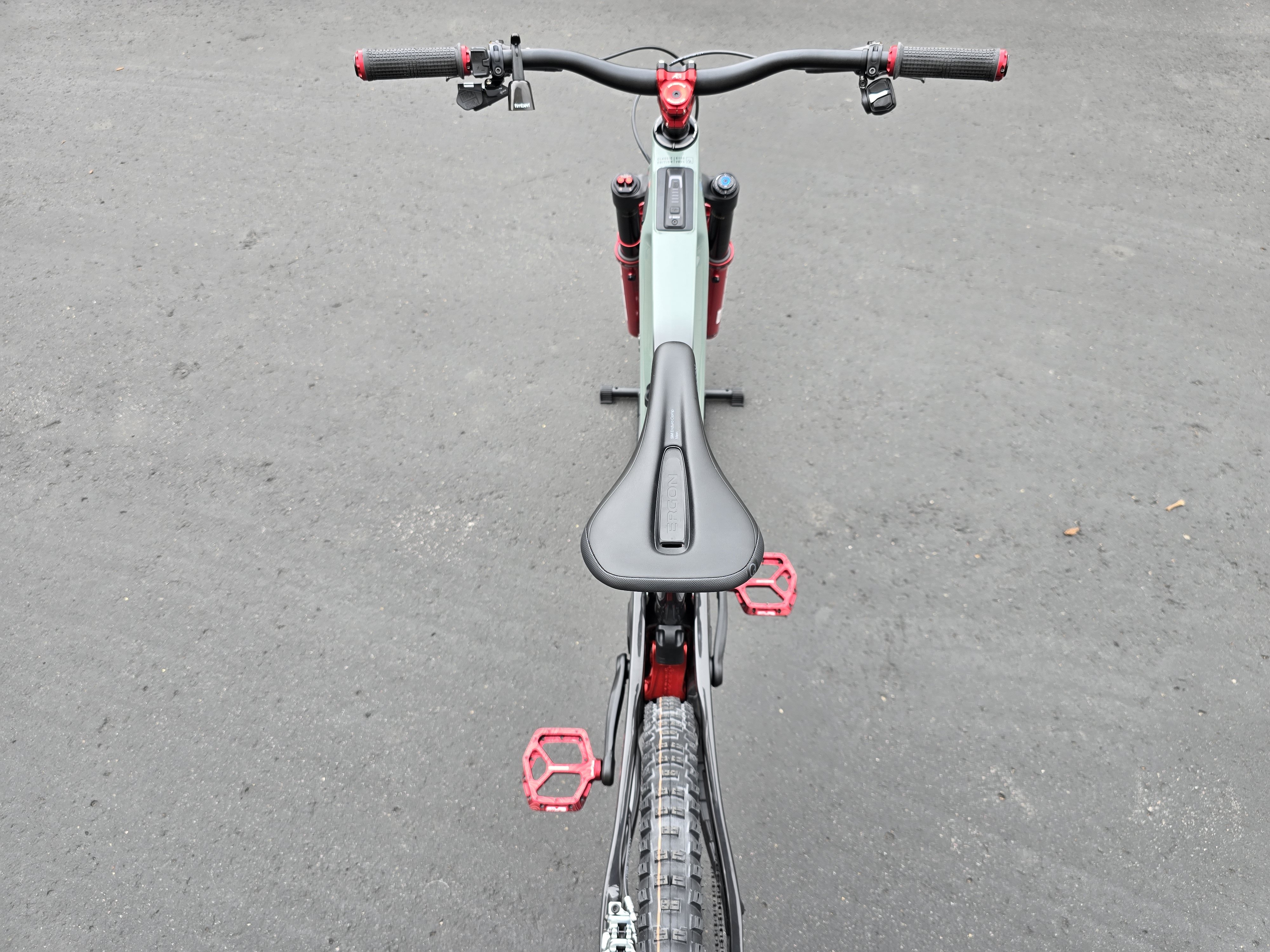

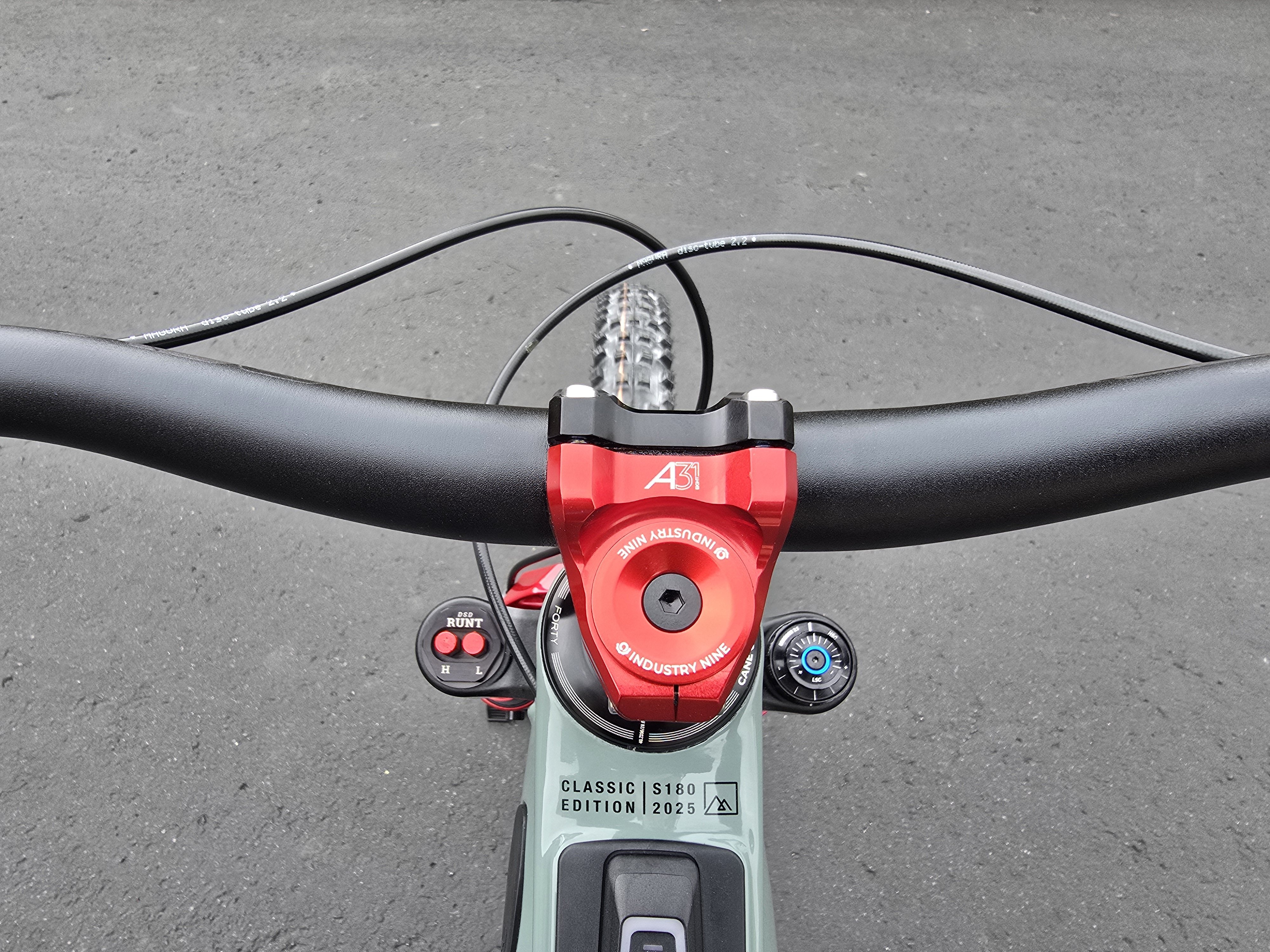

New Crestline S180 is finished, just completed all upgrades. 1st ride this weekend. Hope she rides as well as she looks! @Rob Rides EMTB wanted to thank you for all the information and inspiration! Your videos and insight was a major factor in choosing the bike. Will definitely compliment my Orbea Wild and YT Decoy.
Bike Specs after upgrades:
Crestline S 180 Classic Edition 2025 -
Bosch CS Gen 5 Motor, 800WH Battery
Frame: Crestline Carbon LS 180 frame (180mm rear travel)
Rear Shock: RockShox Vivid Coil Ultimate RC2T 230x65 mm
Fork: Rockshox Zeb Ultimate 180mm
Headset: Works Components Reach Adjust Stem: Industry Nine A318 - 40mm (Red/Black)
Bars: SQlab 3Ox12deg Alloy (45mm Rise, 31.8 x 780mm)
Grips: Rev Grips Pro Series Black/Red Anodize
Seat Post: Rockshox Reverb AXS 170mm x 31.6
Saddle: Ergon SM Enduro Comp
Brakes: SHIRGURA (Shimano Saint Brake Levers/Magura MT7 Calipers) Front Pad - Sport (green)/Rear Pad - Performance (grey)
Front Rotor: Magura MDR-P 220mm
Rear Rotor: Magura MDR-P 203mm
Wheelset: Industry Nine Hydra 2 Enduro
Custom Black/Red spoke pattern
Front Tire: Schwalbe Magic Mary 29x2.6
Rear Tire: Schwalbe Big Betty 27.5x 2.6
Cranks: SRAM X0 Eagle Transmission 160mm ISIS - Black
Chainring: SRAM GX Transmission
Chain: Sram XO T-Type Eagle, 12s, Powerlock
Cassette: SRAM XO Transmission
Rear Derrailleur: SRAM XO Transmission AXS
Shifter: SRAM Transmission
Motor: Bosch CX Drive Unit - BES3 wireless remote/750W-100nm
Battery: Bosch Powertube 800Wh
20250529_133042.jpg 20250529_133050.jpg 20250529_133057.jpg 20250529_133103.jpg 20250529_133116.jpg 20250529_133130.jpg 20250529_133204.jpg 20250529_133159.jpg 20250529_133145.jpg 20250529_133215.jpg 20250529_133223.jpg 20250529_133232.jpg 20250529_133256.jpg 20250529_133301.jpg 20250529_133304.jpg

View attachment 161521 View attachment 161522 View attachment 161523 View attachment 161524 View attachment 161525 View attachment 161526 View attachment 161527 View attachment 161528 View attachment 161529 View attachment 161530 View attachment 161531 View attachment 161532 View attachment 161533 View attachment 161534 View attachment 161535
Beautiful! What size is your bike? Can you slam your axs reverb?

Congrats you literally own one of best E bikes on the planet.
Enjoy

Real nice photos and build. What's the all in weight?
Now go out and ride it like you stole it!
PS have you somehow got the 100nw 750wh upgrade already? i thought it was released in July.
I haven't weighed bike yet. Will update you over weekend. Need to see what specs motor is. Not sure if it's loaded with new software update.
