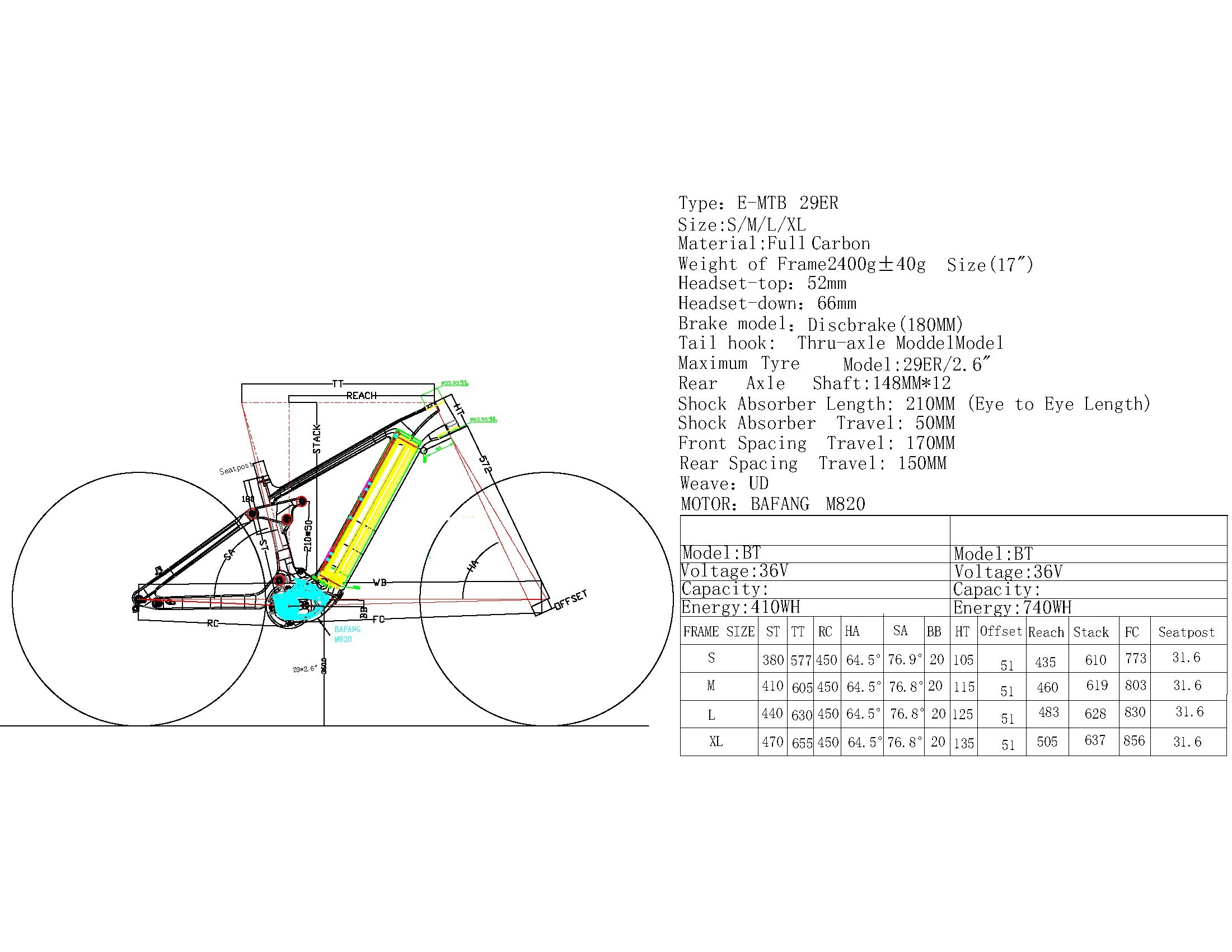

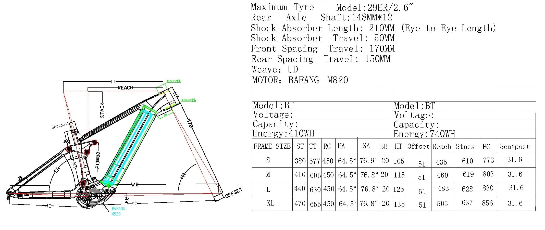

What can you say about this frame? Does she have modern geometry?
Yes, this is quite modern I would say. One thing that surprised me is that they chose to put 740wh battery on a light build. Personally I find that's good, but many will disagree

I like the geo of that vmg but theyre overpriced and their website doesnt give me a lot of confidence in the company. I dont see the rear travel of the enduro typhoon listed anywhere. There is several places it should be listed. The description is bare bones. I guess their bikes are all the same frame just different rear shocks but no mention of that. I could by a giant reign or scott ransom cheaper
You can install a light battery bafang F014 410W. But this battery will not be enough and you will have to hang a second one on top, which will come to a weight of 740W. I like the removable battery, then there is a choice.

Because many have a rear wheel of 27.5 and a front wheel of 29. I also have such a set of good wheels. I also have a Pike fork with a 140mm stroke. If you install such wheels and a fork with a stroke of 140mm on this frame. How badly will the geometry deteriorate?
Mullet setup usually slackens things up by about a bit less than a degree. Over forking has similar effect also.
Can You please provide a link or specify manufacturer and model?
I can't yet. The manufacturer asked not to give this information. Soon this frame will be on sale. We will compare three major manufacturers Dengfu, LightCarbon and incognito. And choose the best frame.
