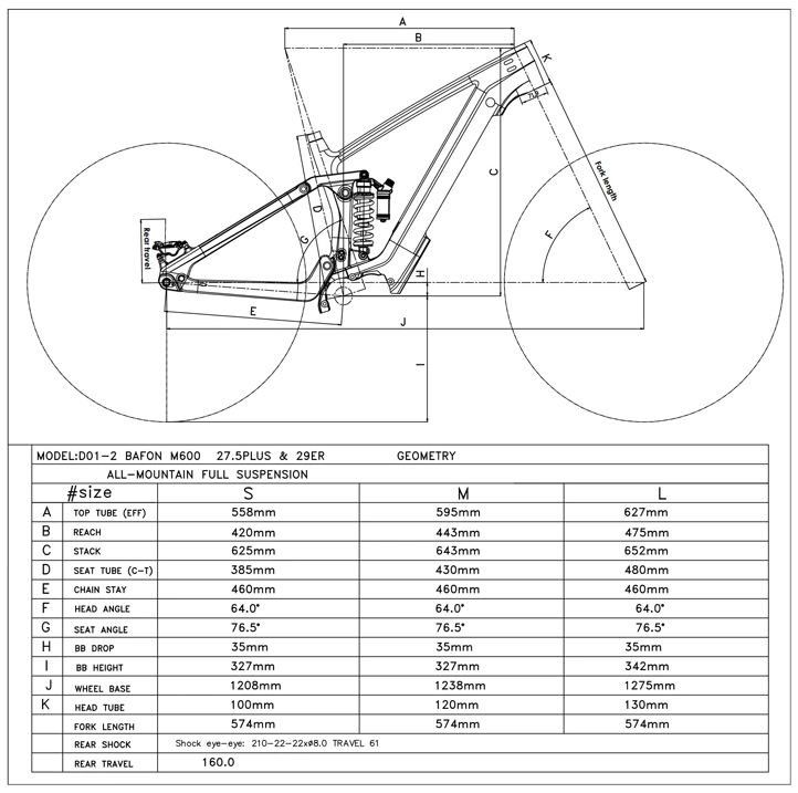

This one looks nice, but BB hight at 327mm is incredibly low for 160mm travel. At full compression the remaining ground clearance is only 167mm. So a very short crank length is mandatory…

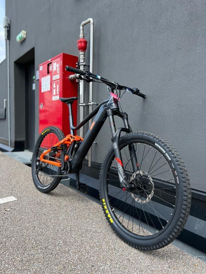

Evidently it was on the Bafang stand at the exhibition. Looks right though, almost a EZesty clone with a more normal engine setup.

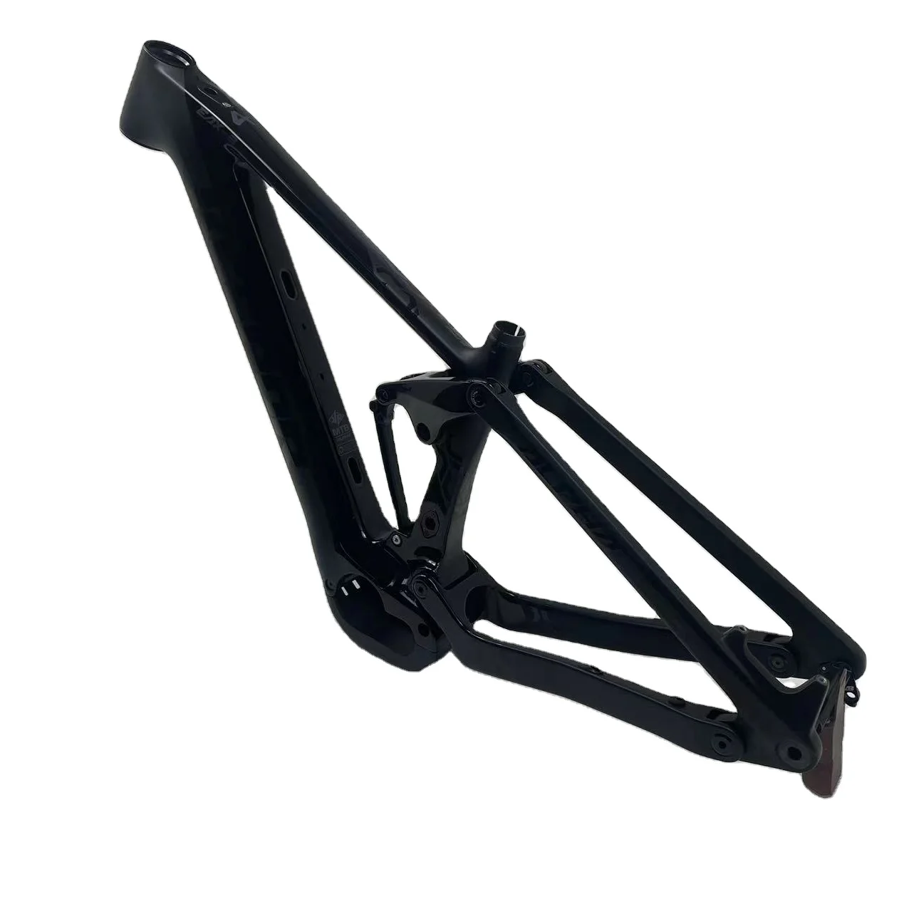

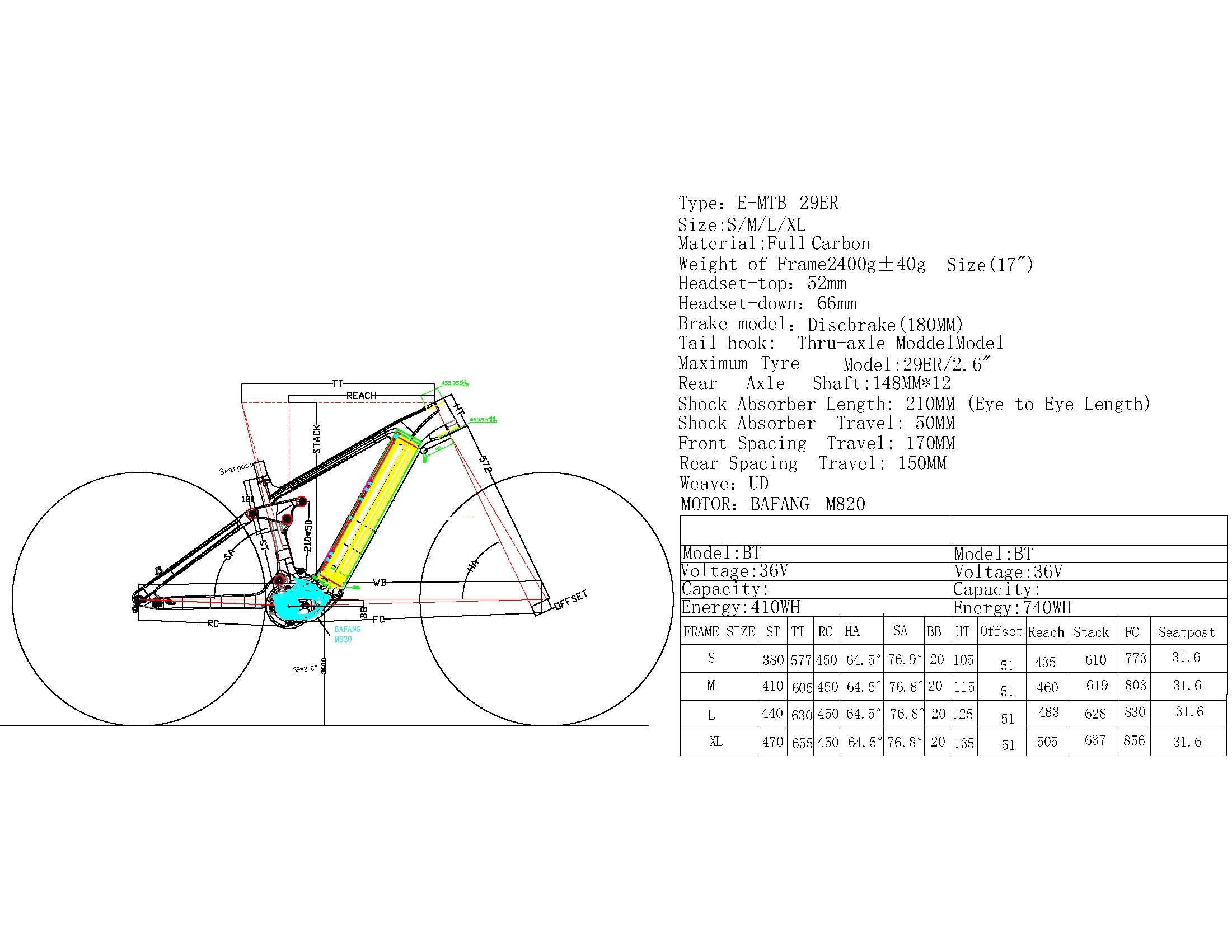

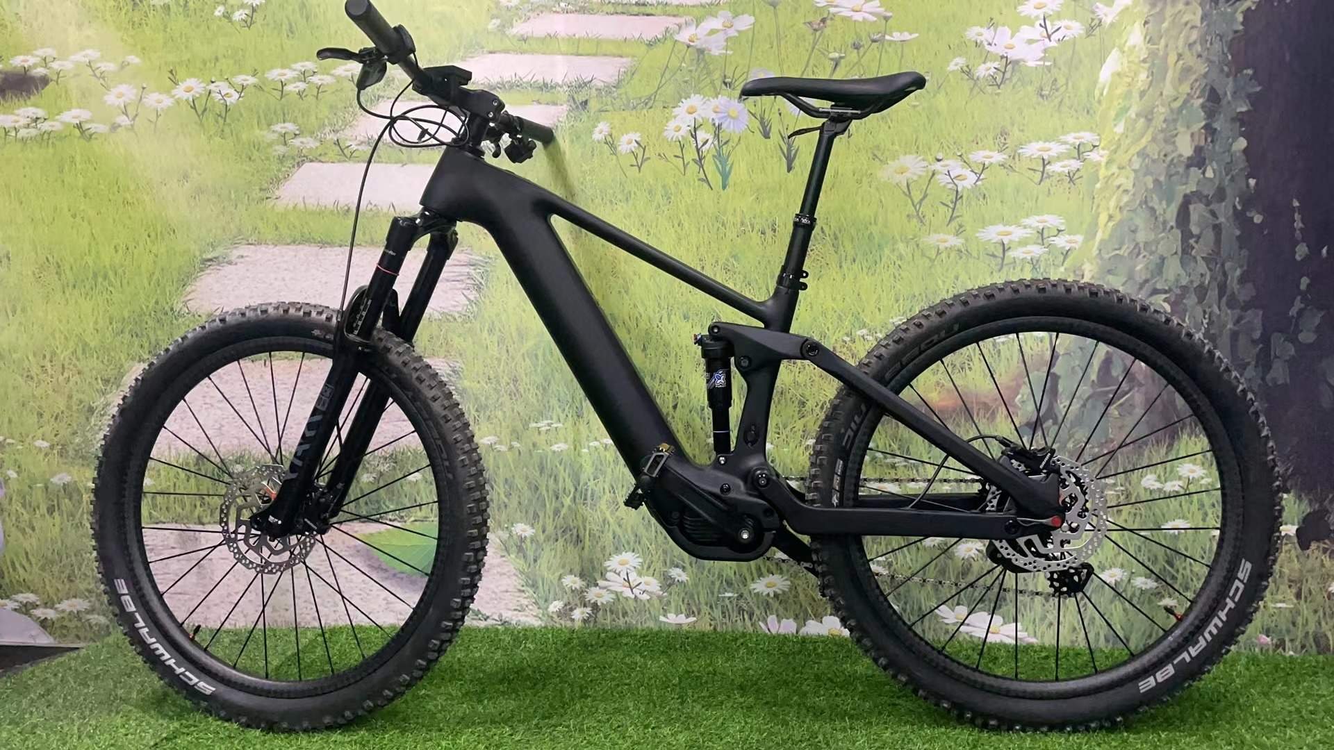

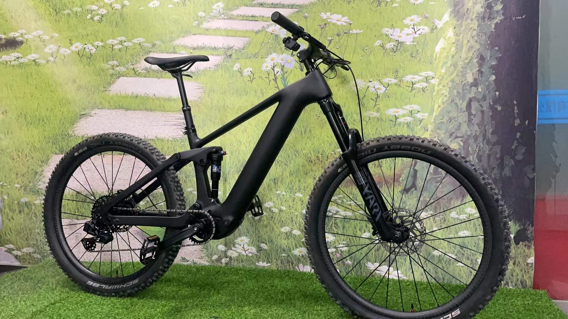

Встречайте, новый, легкий карбоновый велосипед с мотором м820. Раму и мотор я получу в конце января. По моим расчетам вес нового велосипеда будет от 16500-18000 гр. В зависимости от уровня комплектующих.
View attachment 103123 View attachment 103124 View attachment 103125 View attachment 103126
Meet the new, lightweight carbon bike with the m820 motor. I will receive the frame and motor at the end of January. According to my calculations, the weight of the new bike will be from 16500-18000 gr. Depending on the level of components.
Thank you, I forgot to translate
who build this frame ?
Check out this product on Alibaba App China Wholesale E-bike MTB Carbon Fully Frame with Bafang F014 Battery and bafang M820 engine
That’s the frame
I ordered from Jean wang. I liked it very much.

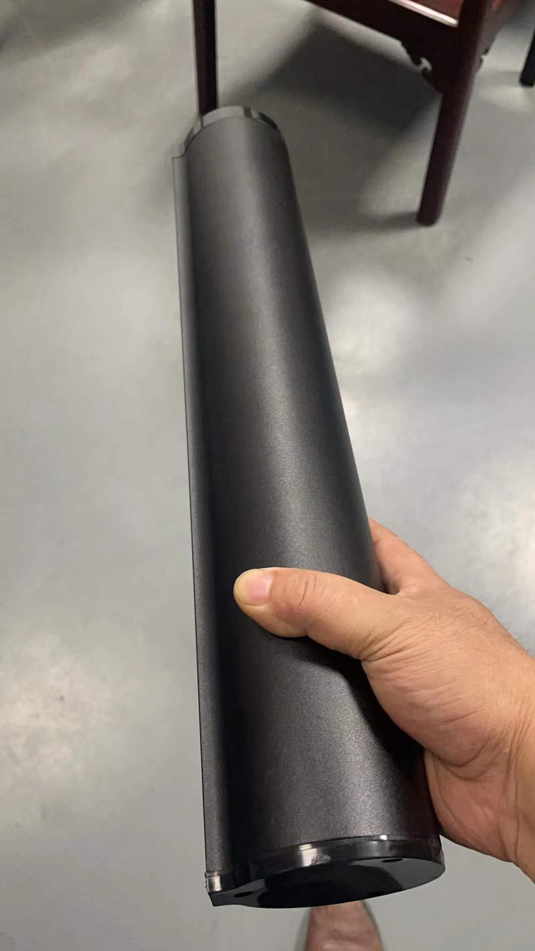

The frame looks great! Do You need to order the frame specific to the battery size? Or can You run both batteries with it? What is this ZS BT 740 battery, do You know the producer / any specifications?
Guys you know this frame manufacturer?Or they are buying from someone else??
That’s the frame
ok thanks, minimum order 2 frame
I will not install the battery, but I ordered it so that I have a set of buttons and wires. I will make myself two light batteries of 1500g each. I will install the battery in a triangular bag. This way I will have a removable battery and a lighter bike -1000gr for the case and battery mount. The housing for the 420 and 740W batteries should be the same.
Hmmm..but they are referring to a Bafang Battery BT F014 which is speced on Bafang Workbook, and a completely unknown Battery type ZS BT 740. No info on that available…
